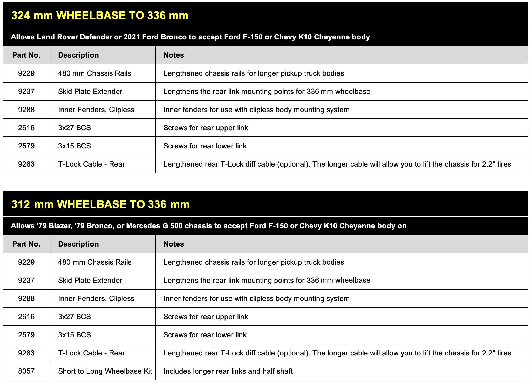

You’ll find the required parts listed below, and making the conversion is just a matter of replacing the noted components. If you’ve got a 312 mm wheelbase model ('79 Chevrolet Blazer, '79 Ford Bronco, or Mercedes-Benz® G 500® 4x4�) you’ll need to install longer rear links and extend the rear driveshaft (easily done, there’s a kit for it), while the 324 mm trucks (Land Rover Defender or 2021 Ford Bronco) can use all their existing suspension and drivetrain parts—no new suspension links required. Let’s take a closer look:
Chassis parts

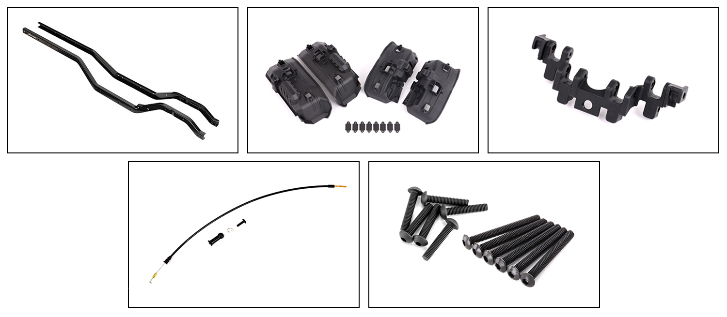

Converting a 324 mm wheelbase TRX-4 to 336 mm requires 9229 480 mm chassis rails, 9288 inner fenders, 9237 skid plate extender, 9283 185 mm rear T-Lock cable, and hardware packs 2616 and 2579.

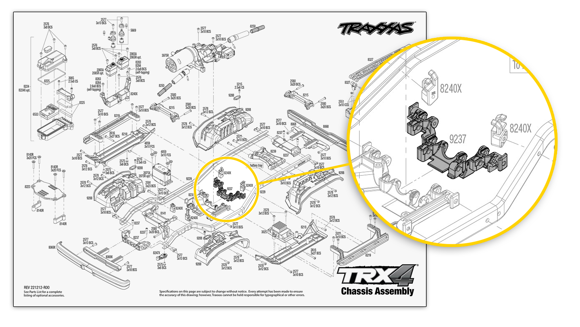

Chassis extender
The skid plate extender is an unusual looking part that might have you wondering where it’s supposed to go. But there’s no need to wonder, just consult the chassis exploded view for the F-150 or K10 Cheyenne.

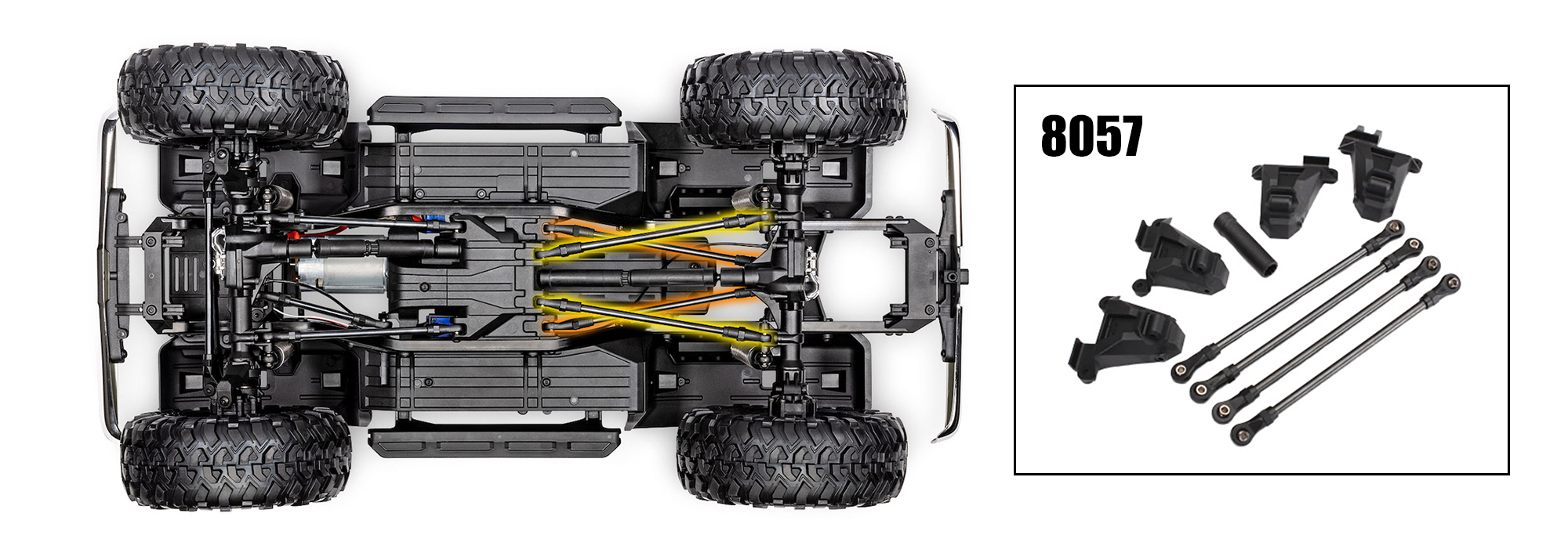

Rear links
If you’re converting a 312 mm wheelbase truck, you’ll need the same parts as the 324 mm conversion, plus the 8057 short-to-long suspension link kit.

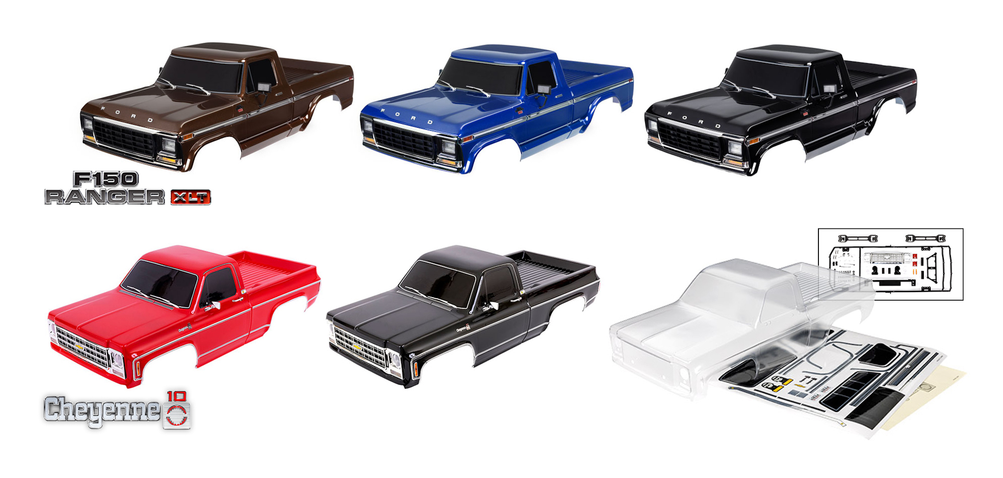

K10 bodies
You can get the F-150 body in brown, blue, black, and clear (not shown). The K10 also comes clear, plus red and black.

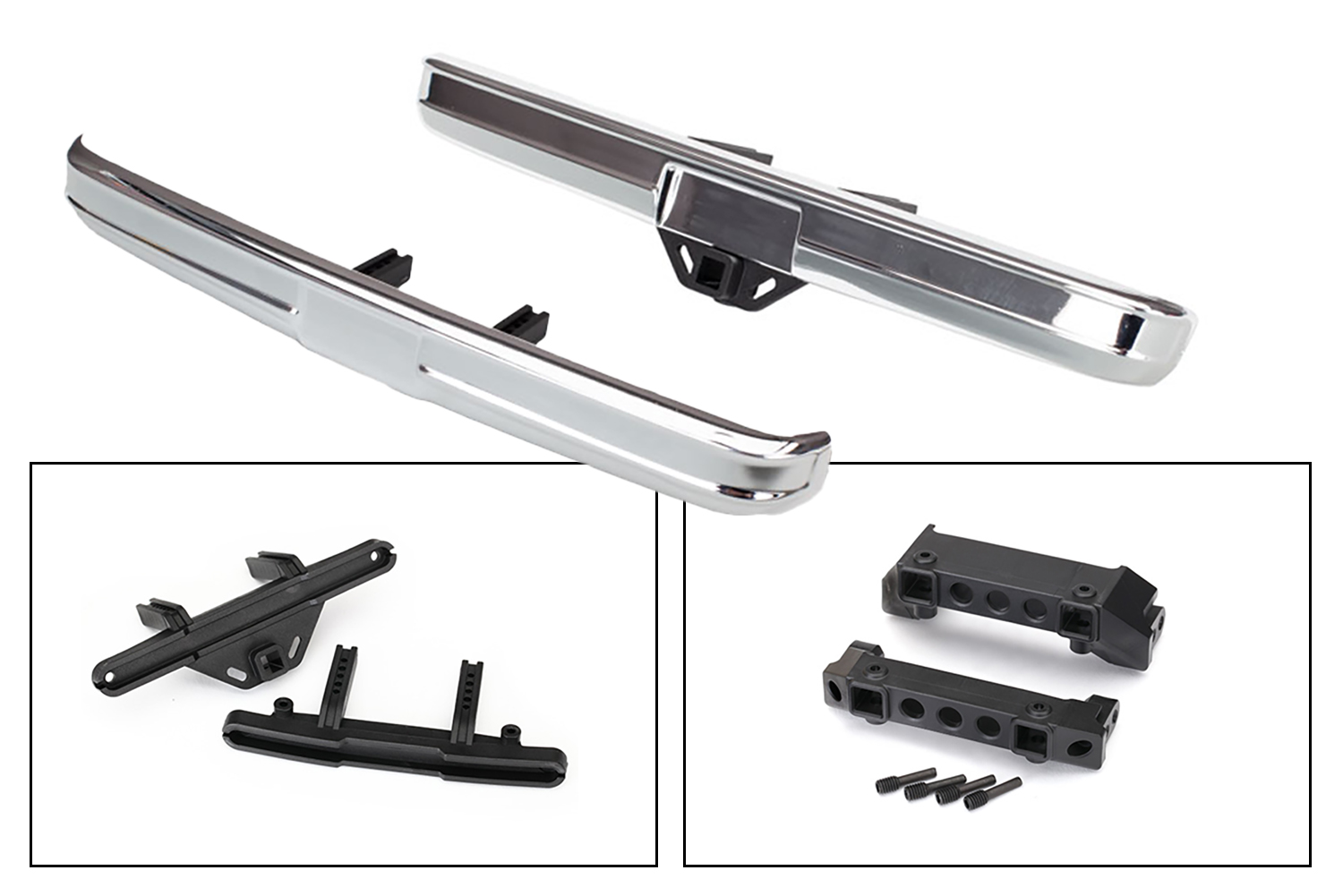

Bumper parts
To give your truck the full F-150 or K10 Cheyenne makeover, install the chrome bumpers that go with the bodies. You’ll find the part numbers for the bumpers and mounts below.
Wheelbase Charts

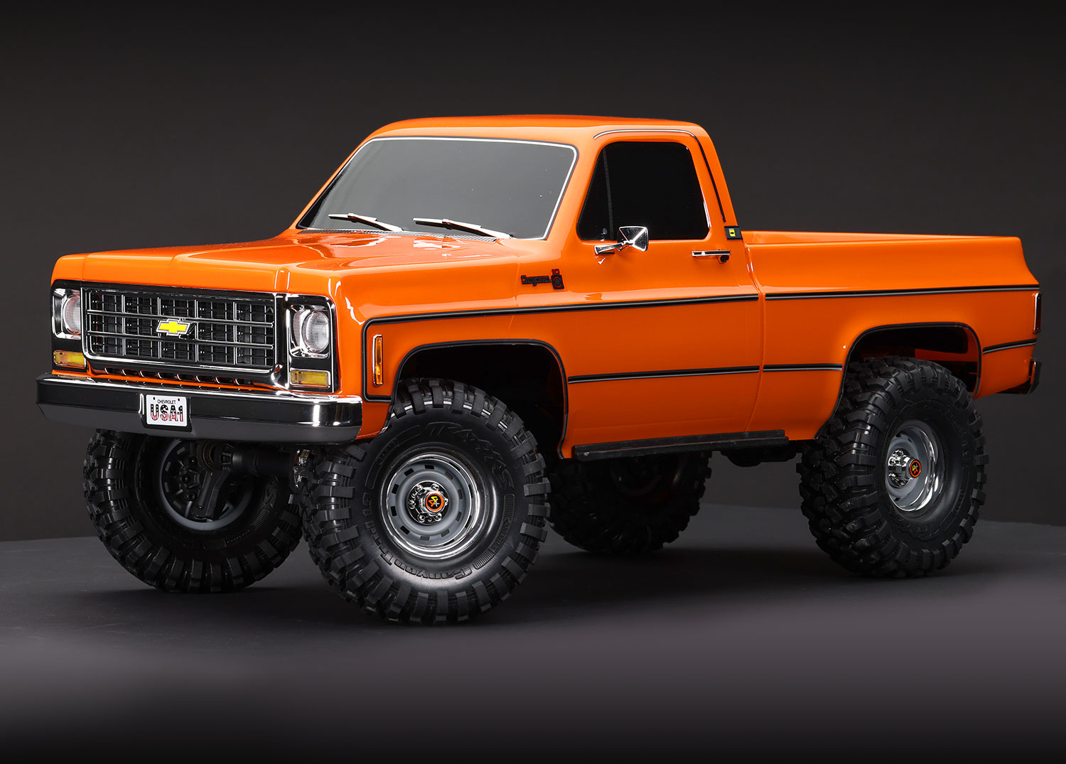

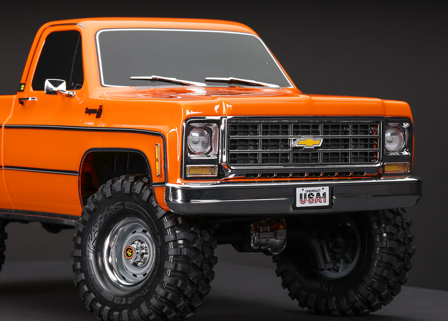

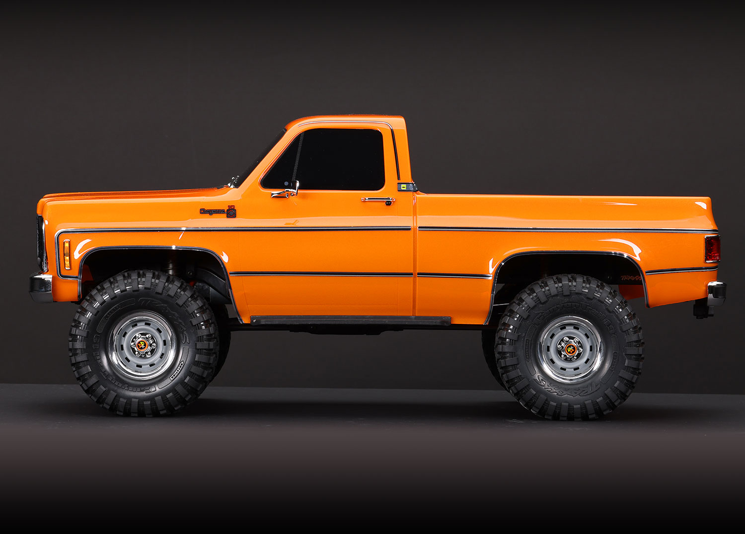

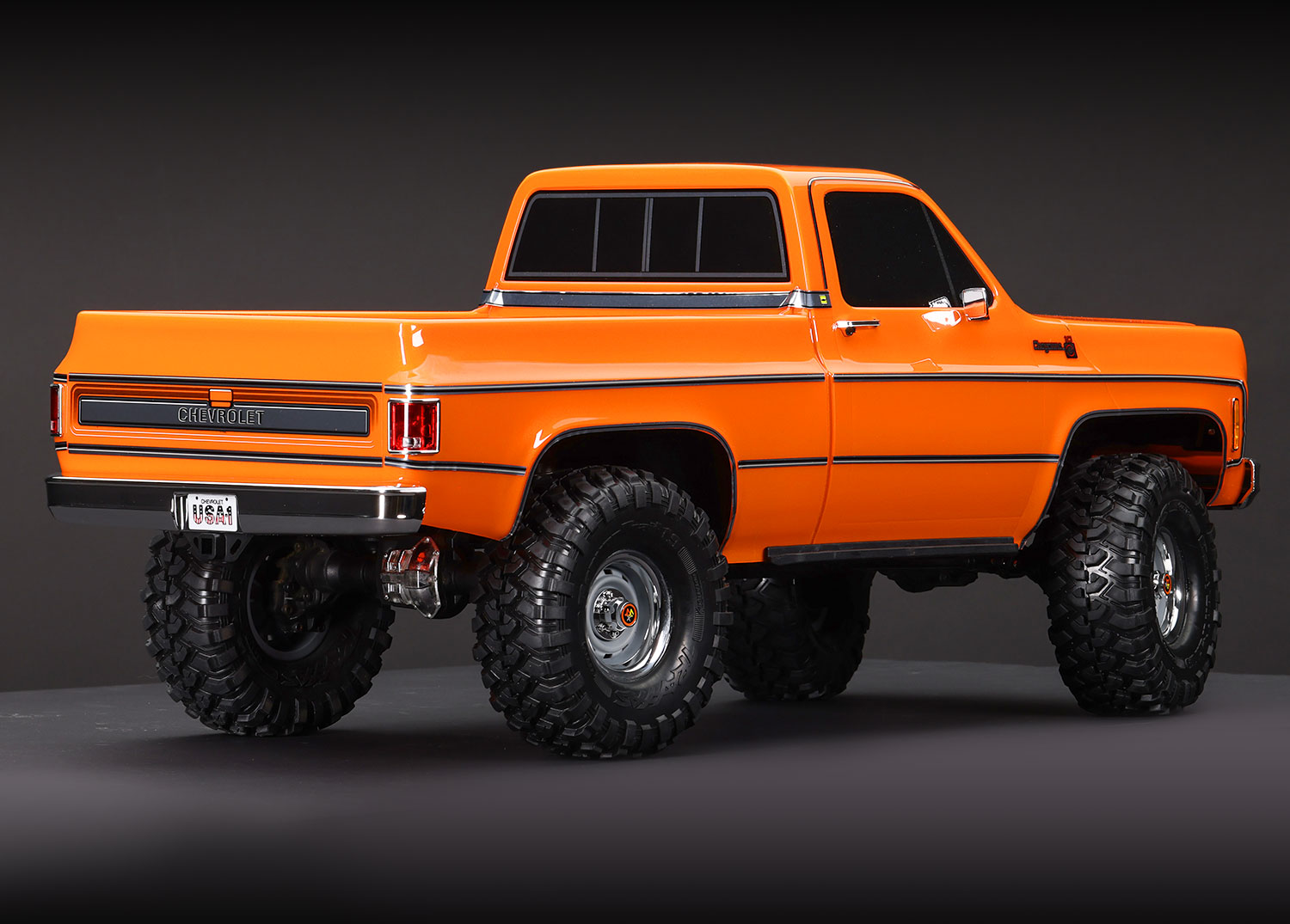

What does it look like to convert a Blazer to a K10? See for yourself! We customized this truck with a 9212 Clear Chevrolet K10 body coated with 5051 Maxx Orange ProGraphix paint to help it stand out from the crowd. We also picked the 8166X Rally Wheels for a more factory look.

Chassis Parts List
    • 9229 480 mm Chassis rails
    • 9237 Skid plate extender
    • 9288 Clipless inner fenders
    • 2616 3x27 button-head screws
    • 2579 3x15 button-head ccrews
    • 9283 185 mm rear T-Lock cable
    • 8057 Short to long wheelbase conversion kit (required for 312 mm to 336 mm conversion only, not required for 324 mm trucks
    Bumper Parts – Chevy K10 Cheyenne
    • 8237 Front and rear bumper mounts - chassis
    • 8067 Front and rear bumper mounts – inner bumper
    • 8137 Chrome front bumper
    • 8136 Chrome rear bumper
    Bumper Parts – Ford F-150
    • 8068 Chrome rear bumper
    • 8069 Chrome front bumper with mount
    Ford F-150 Body Sets
    Chevrolet K10 Cheyenne Body Sets
