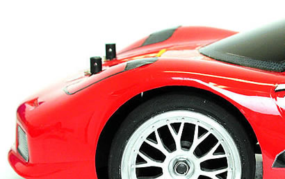

Raise the body in the front by installing the lower body clips on higher holes on the body posts. Raise the rear of the body by loosening the mounting screws and raising the rear body posts. You may also need to enlarge the wheel cutouts (wheel wells) as well to insure that the tires do not rub on the body.
