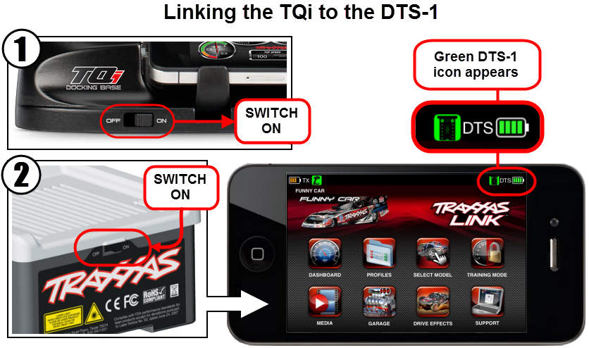

STEP 4: Link the TQi to the DTS-1
1. Switch on the TQi  transmitter and launch the Traxxas Link application.
2. Switch on the Starting Line console. Since they have been previously bound, the transmitter and DTS-1 should link automatically, and the DTS-1 icon will  glow green in the upper right corner of the Traxxas Link screen.

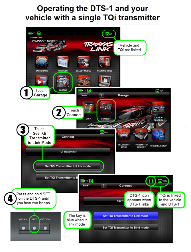

The TQi transmitter can be linked to the DTS-1 and a model at the same time, so you can operate the DTS-1 and race a vehicle with the DTS-1 using  one transmitter. If you have not already bound the TQi to your model and the DTS-1, do so now. This will allow the model and DTS-1 to link to the TQi at the same time. It does not matter if you link the vehicle first, or the DTS-1 first. Follow these steps:
Linking car DTS
1. Power on the TQi transmitter and launch the Traxxas Link application.
2. Power on either your model or the Starting Line console.
3. The transmitter and model or console will link automatically. The DTS-1 icon or Veh icon will show green in the Traxxas Link status bar, depending on what you've linked to.
4. At the Traxxas Link home screen, touch the Garage icon.
5. Touch the Connect icon to access the Connect screen.
7. Touch Set TQi Transmitter to Link mode. The key will turn blue, indicating the TQi is in Link mode.
8. Power on the second device you wish to link to. It will link to the transmitter automatically.
The Connect screen may also be used to bind two devices to one TQi transmitter. Follow the instructions above using the Set TQi Transmitter to Bind mode key instead of the Set TQi Transmitter to Link mode key.

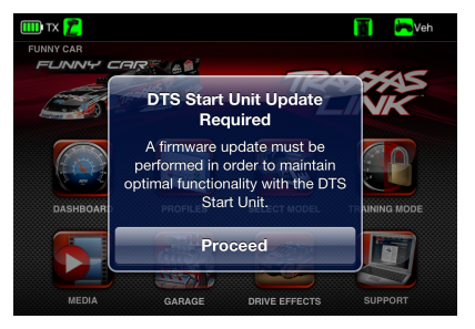

Updating Firmware
Update Required
When you Bind the TQi transmitter to the DTS-1 console, the Traxxas Link App may ask you to update firmware. Follow the prompts to complete the firmware updates. The App will indicate the progress of each update as it proceeds. Once the update has completed successfully, touch the Leave Update Screen key, and then power off the transmitter and device.
