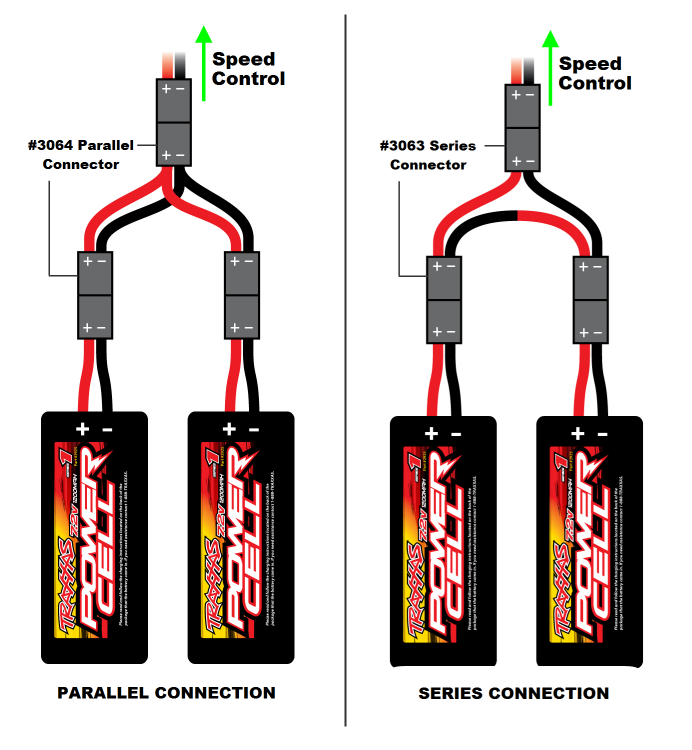

Parallel Connection = Increased Capacity = Longer Run-Time
The illustration above left shows two Traxxas 1200mAh Power Cell 7.2 volt batteries connected in parallel. Note that both positive battery leads (in red)attach to the positive terminal on the connector that leads to the speed control, and both negative battery leads (in black) attach to the connector's negative terminal. When assembled in parallel, the combined packs will still have an output of 7.2 volts, but their total capacity will be 2400mAh (1200mAh X 2 = 2400mAh). Your vehicle will not be any faster, but its run-time will nearly double. All Traxxas 1/16 models can be operated with dual batteries and the #3064X Parallel Connector.
Series Connection = Increased Voltage = Higher Speeds
The illustration above right shows two Traxxas 1200mAh Power Cell 7.2 volt batteries connected in series. Note that the negative (black) lead of the pack on the right is connected to the positive (red) lead of the pack on the right. When assembled in series, the voltage of the batteries is combined, but capacity is unchanged. In the example illustration, the combined packs will still have 1200mAh capacity, but their total voltage will be 14.4 volts (7.2 volts X 2 = 14.4 volts). Your run time will not increase, but your vehicle's speed will nearly double (as long as its speed control is rated to handle the extra voltage). Dual batteries connected in series using the #3063X Series Connector may ONLY be used in Traxxas' VXL brushless 1/16 models.
