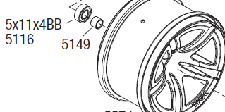

- Bushings or ball bearings in wheel hubs are worn
- Inspect the bearings in the wheels to check for wear. If they have developed slop from wear, replace them with new bushings or ball bearings.
