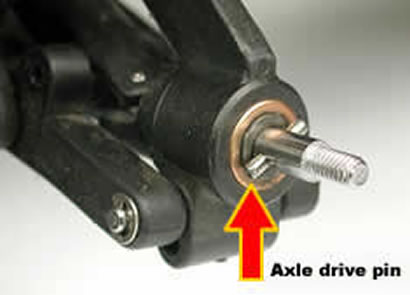

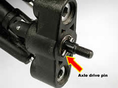

Installing axle drive pins
If you have removed the wheels for tire gluing or routine cleaning, make sure that the drive pins are installed in the axles when the molded hex hubs are pushed back on. The hex hub might stay in the wheel when removed, which can cause the drive pin to fall out of the axles. If the hex hub is installed without the drive pin, forward (and reverse) drive will not be possible on the wheel without the drive pin, or the wheel on the opposite side thats driven by the same differential.
