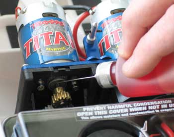

Brushed motors equipped withbushings requires timely maintenance in order to stay in top runningcondition. These bushings are locatedat each end of the motor can and support the motors armature, allowing it torotate smoothly. Failure to lubricate the bushings regularly may result inshorter motor lifespans. Use an oil made for electric motors such as 3-in-1Oil, or a special motor bushing lube found at your local hobby shop.
For landvehicles:
Re-oil the motor bushingsevery hour or so of operation. You can also use electric motor spray to keepthe motor free of debris and dust.
Forboats:
Re-oil the motor bushingsbefore every day of running. Periodically re-oil the bushings in the outdrivehousings and the driveshaft tubes. There are metal oiling nipples in each driveunit to accommodate oiling the driveshaft tube bushings.
