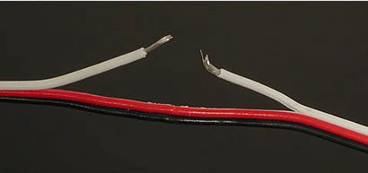

If the wire has been completely cut or it's hanging on by a few strands ofcopper wire and you’re skilled with a soldering iron you can repair the cutwire yourself. Repairing damaged wiring is easy and it can save you time andmoney, but care must be taken any time a soldering iron isused.

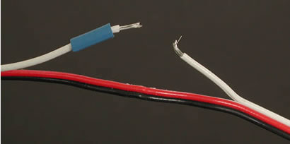

First, slide a piece of thin gauge heat shrink tubing over thewires.

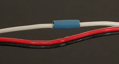

Next, splice the wires together and tin the wire with a small amount ofsolder.
Finally, cover the solder joint with the heat-shrink tubing and heat the areawith a heat gun or blow dryer.
