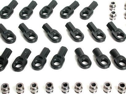

Conversely, a worn out rod end can cause play between the hollow ball connector and rod end, which contributes to unnecessary slop in the steering system. Traxxas offers a rod end/ball connector set (Part #1942) that includes 16 long and 4 short rod ends and 18 hollow ball connectors. it's a good idea to have these parts in your toolbox.

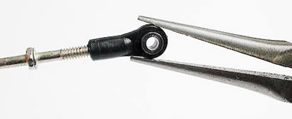

Sometimes you can fix a binding rod end/hollow ball connector by applying a slight amount of pressure on the sides of the molded rod end with a pair of pliers. Don't use too much pressure when tightening the ball connector or the binding problem could get worse.
