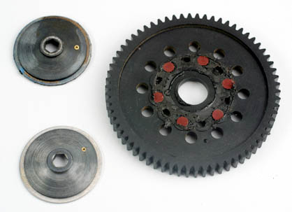

3. Install friction pegs
Transfer the six friction pegs from the old spur gear to the new spur gear. The friction pegs can easily be pushed out of the old spur gear and pushed into the holes of the new one. Make sure that all six pegs are installed, and located into every other hole.
Important: Do not reuse friction pegs that are excessively worn or melted. If the old friction pegs are worn down to the plastic of the spur gear, then they need to be replaced.
4. Install new spur gear
Make sure that the pressure ring and the pressure plate (currently on the slipper shaft) are keyed into each other, and fit the new spur gear (with fiction pegs) onto the bronze bushing followed by the outer pressure ring and pressure plate. Note: The notch in the pressure ring must key in with the pin in the pressure plate. Tip: You can use a small dab of CA to hold the rings on the plate.
Slide the slipper spring over the slipper shaft and secure the assembly with the 4.0NL. Tighten the slipper nut until the spring is stacked solid, then back off � turn.
