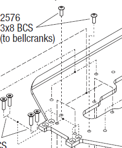

- Screws that secure the steering bellcrank system are loose (Maxx Trucks)
- Tighten up the 3 x 8mm BCS screws that secure the bellcrank posts from above.
