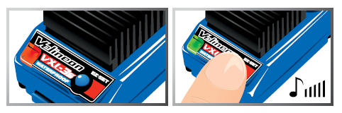

If the LED glows GREEN when the ESC is on, Low Voltage Detection isactivated
How to TurnLow Voltage Detection ON
If your Traxxas speed control with Low Voltage Detection displays a redlight when switched on, it means that Low Voltage Detection is switched OFF. Toturn it ON, first turn on your transmitter and speed control. With the speedcontrol already on, press and hold the EZ-Set button until you hear anascending tone (if you have a VXL speed control) or two beeps (if you have anXL-5 speed control). Release the EZ-Set button and the speed control's LED willlight green to show Low Voltage Detection is ON. If it does not light green, donot operate your model with a LiPO battery. Repeat the procedure. Call888-TRAXXAS if you cannot activate Low Voltage Detection.
If the LED glows RED when the ESC is on, Low Voltage Detection isDEACTIVATED.
To turn Low Voltage Detection on, press and hold the EZ-Set button until youhear an
ascending tone (VXL speed controls) or two beeps (XL-5 speed control).
