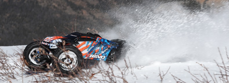

E-Revo snow
Winter Operating Tips
Winter is here and it’s time to shred some snow! There are some important things to understand before running your Traxxas vehicle in cold weather conditions. As temperatures drop, plastic loses its flexibility and becomes more brittle. The same crash that didn’t faze your Stampede in the summer might result in a broken suspension arm in the winter. Batteries also lose some power when temperatures approach freezing. Your 3000mAh battery may run 15 minutes in the summer, but might only run 10 minutes in the winter. Finally, nitro-powered Traxxas models require special break-in procedures and retuning in cold weather. This article will cover the basic precautions of cold and wet weather operation, and give tips for a successful winter outing.
