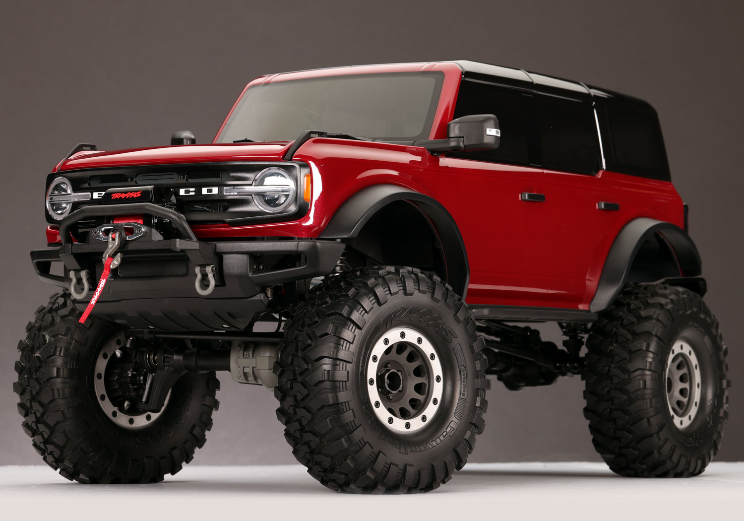

The Chevy K10 Cheyenne is the first TRX-4 to get the High Trail Edition treatment, which adds high-lift suspension and 2.2″ tires for an extra-tall stance and superior ground clearance to rigs rolling on 1.9″ tires. And in the case of the Cheyenne, it also gets a wheelbase stretch to 13.2″ for correct scale proportions. You can give your own TRX-4 High Trail style and performance by adding the Long Arm Lift Kit, like we did with this 2021 Ford Bronco. In addition to looking amazing, the taller, fatter tires offer even greater ground clearance and a larger footprint to help your rig span gaps, grab edges, and ride higher in soft terrain. You’ll find a full parts list after the photos.
Traxxas Bronco High Trail Custom Build
The 2021 Ford Bronco looks tough right out of the box, but the Method 105 wheels and 2.2″ Canyon Trail tires literally take it to another level. That is one rugged looking 4X4.

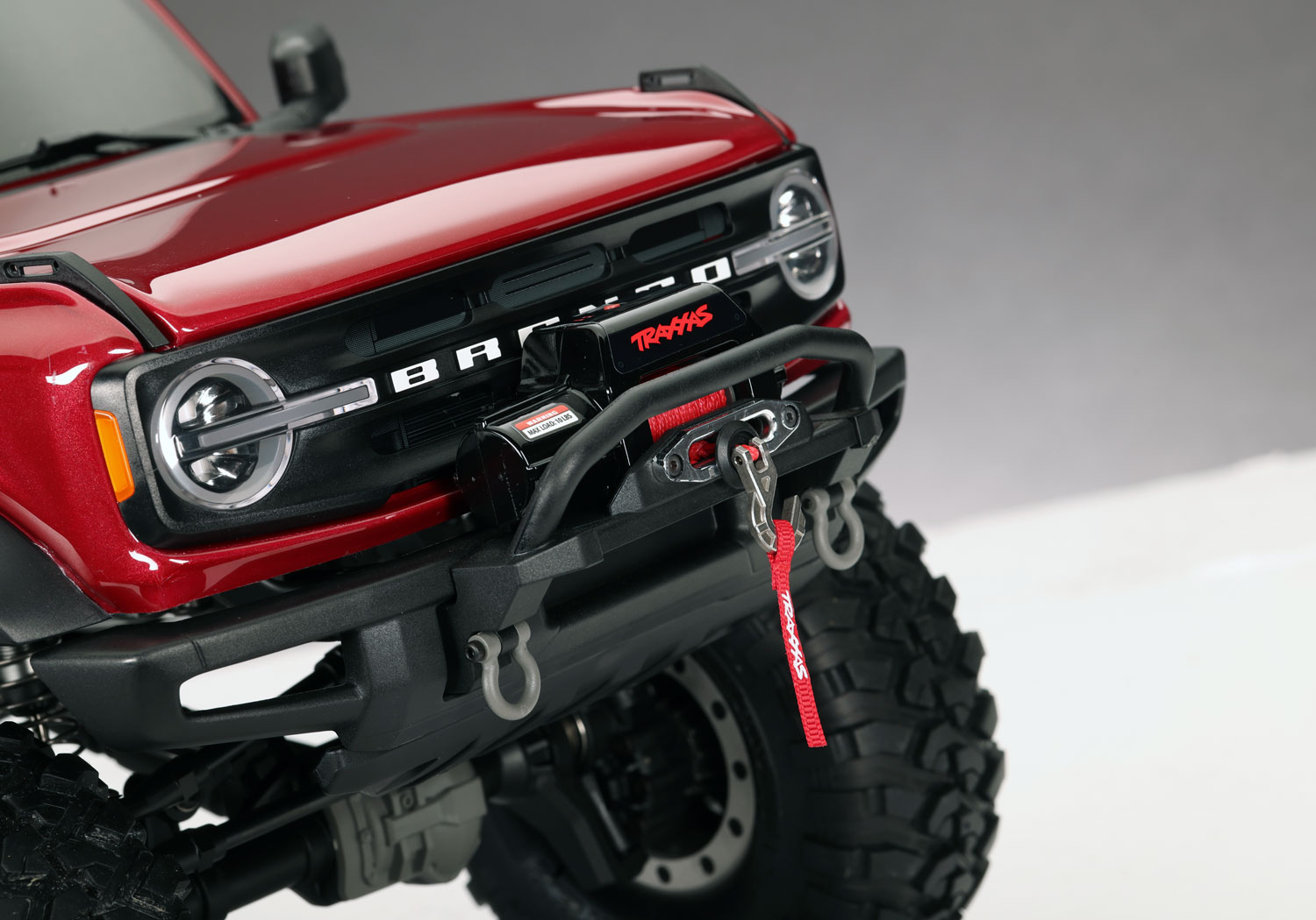

And how about a Pro Scale Winch? The Bronco’s bumper is winch-ready for a fast and easy installation. For other TRX-4 models, just add the winch-compatible bumper for your model and another 60 seconds to install it. You’ll find all the bumpers here (just scroll down).

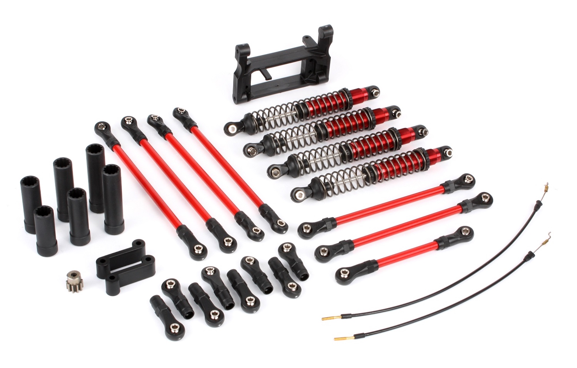

Just as with full-size trucks, there’s a right way and a wrong way to do a lift. The wrong way is to crank the shocks’ preload collars down to eliminate all down travel; or install longer shocks but make no accommodation for the extra travel; or fake the lift by just raising the body. The right way to lift a TRX-4 is with a Long Arm Lift Kit, which does none of those things. The kit uses proper length suspension links, longer shocks, and a revised servo mount to lift your TRX-4 and accommodate 2.2″ tires without compromising suspension travel, steering geometry, or drivetrain performance. A full-color instruction book is included, and you can also check out our full how-to video on the Traxxas Support channel.
Traxxas Long Arm Lift Kit
The Long Arm Lift Kit includes everything you need, right down to longer T-Lock cables. You can get the kit with red or blue links and shocks, or with black links and silver shocks.

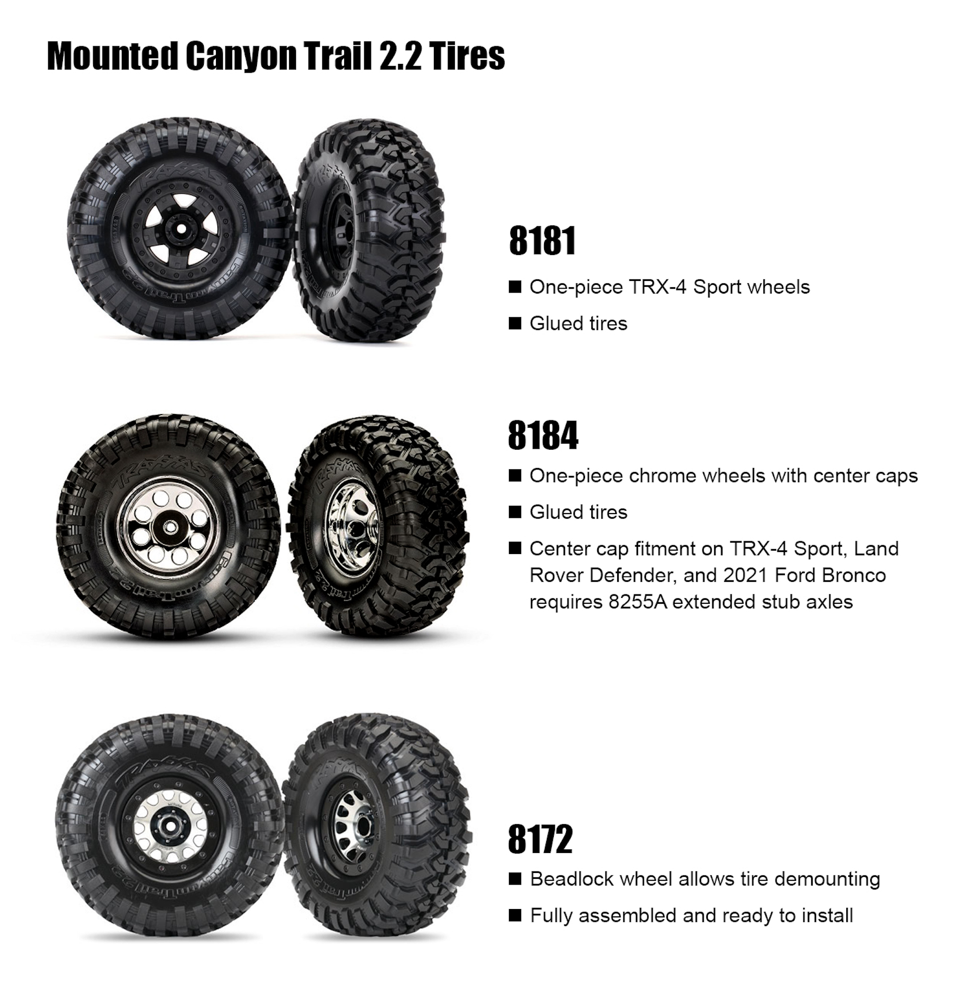

The fastest, lowest-cost way to get into 2.2″ tires is with the two glue-mounted options:
One-Piece Wheels with Glued Tires
    • 8181 Canyon Trail 5.3 x 2.2″ tires on TRX-4 Sport wheels (pair)
    • 8184 Canyon Trail 5.3 x 2.2″ tires on chrome 8-hole wheels with center caps

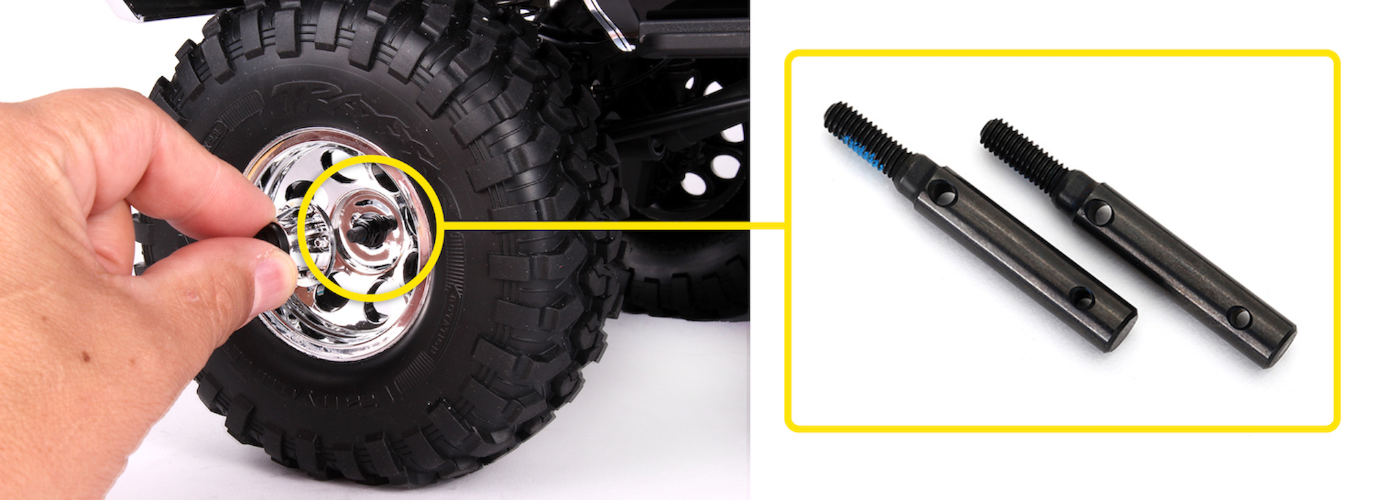

Note that the #8184 wheels require longer axles (#8255A). The longer axles extend farther past the nut so the caps can be threaded over the nuts. If your TRX-4 has the standard-length axles, the wheels will still fit securely, but you won’t be able to install the center caps.
Beadlock Wheels – Factory Mounted or Mix-and-Match
For the ultimate in versatility and realism, choose Method 105 replica beadlock wheels. The functional beadlock design holds the tires without glue, so you can remove and reinstall tires at any time. Traxxas offers the 2.2” black-chrome Method 105 wheels and Canyon Trail tires fully assembled in pairs with black beadlock rings as #8172. Or, you can get the wheels and rings separately and choose your own color and finish combination. The wheels are available in charcoal gray and black chrome, and the rings are offered in red, blue, green, black, and satin.

If you choose #8184 chrome wheels with center caps, you’ll need the longer #8255A axles in order to install the caps.
