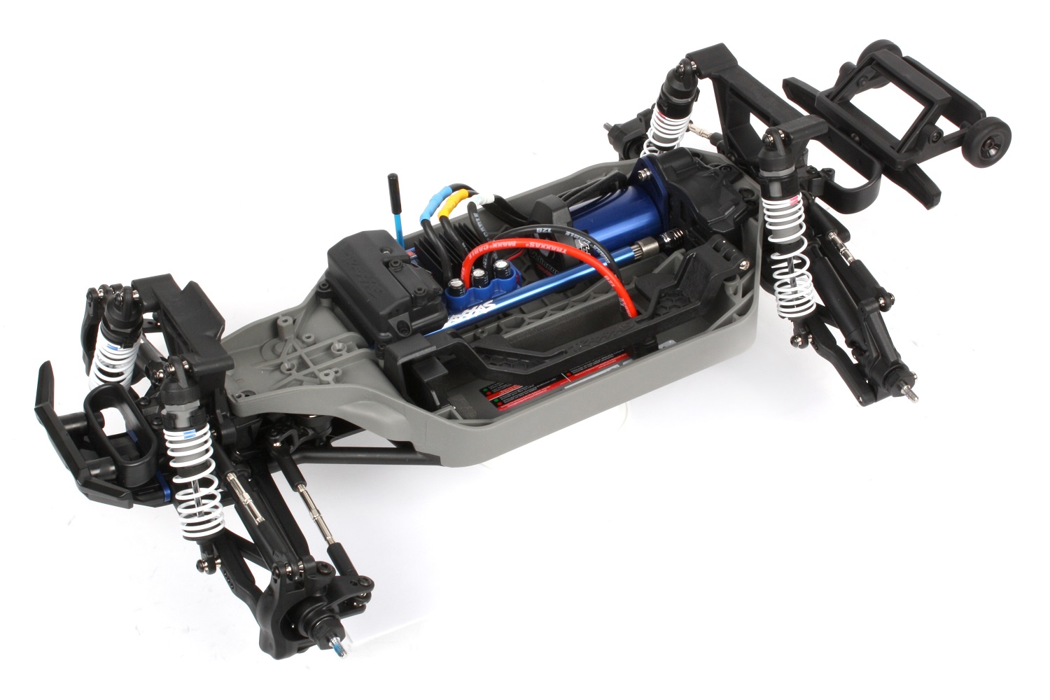

The two keys to this build was simple: pull off the look of the full size car, and pull wheelies at will. The (58076-21) Slash VXL OBA was selected as a base, thanks to its powerful VXL power system, rear-favoring weight bias, and the availability of an aftermarket body that closely replicated the 55.
Traxxas Funny Car rear tires helped to achieve the drag race feel, while Bandit dished front wheels completed the look up front. Aftermarket 14 mm hex/5 mm axle adapters required for Funny Car rear tires.

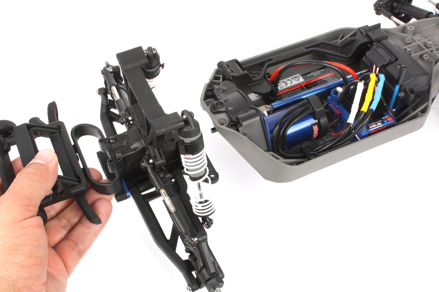

Traxxas (2750R) Bandit arms, (2441) camber links, and (1651) axles were used to narrow the rear track and keep the tires snug inside the rear quarter panels.
Up front, to widen the stance and adjust the wheelbase appropriately for the wheel openings, Traxxas (5531) Jato suspension arms were modified to accept the Slash shock setup, and longer (5539) camber and (5538) toe-links were installed.
To keep the car functional and durable, a (5835) Slash bumper was cut down to protect the front end in impacts.

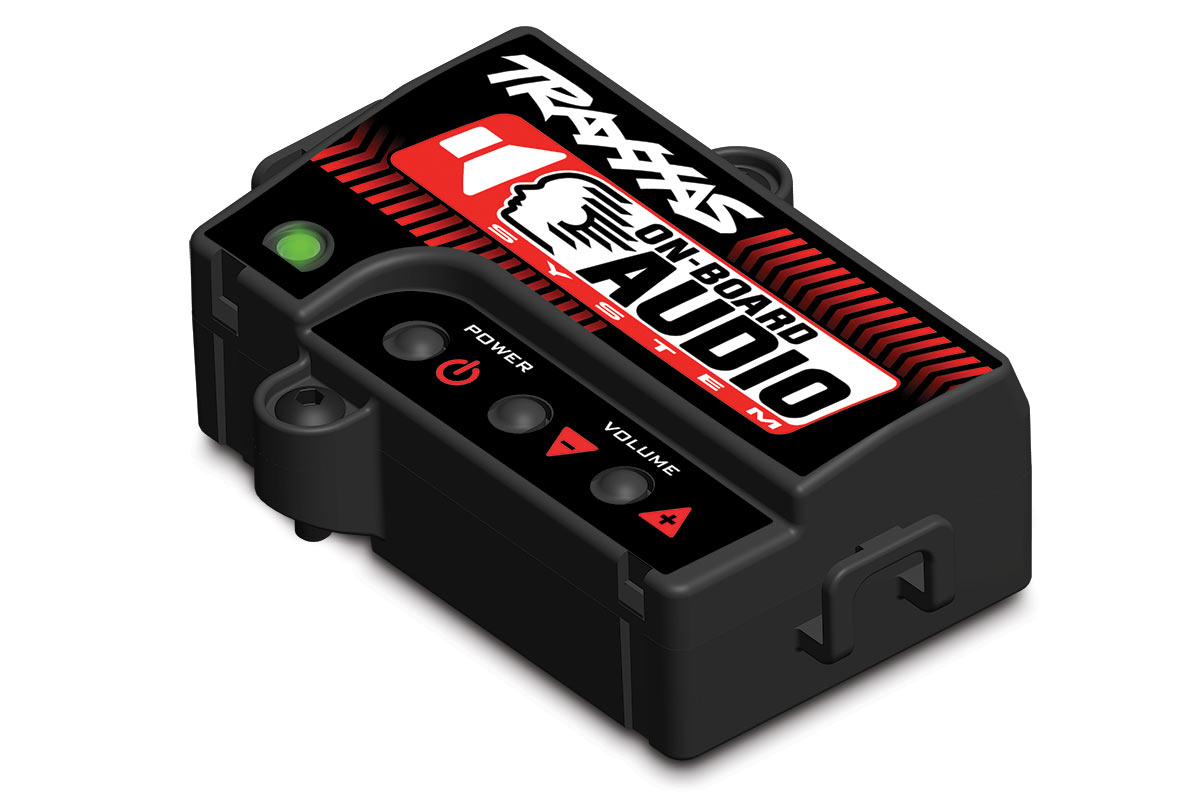

No Blasphemi replica would be complete without some V8 rumble. The Traxxas OBA system was installed into the 55 body.

Out back, a (3678) Traxxas wheelie bar with (5186A) rubber tires and aluminum wheels keeps the back end planted and stable during hard launches.
