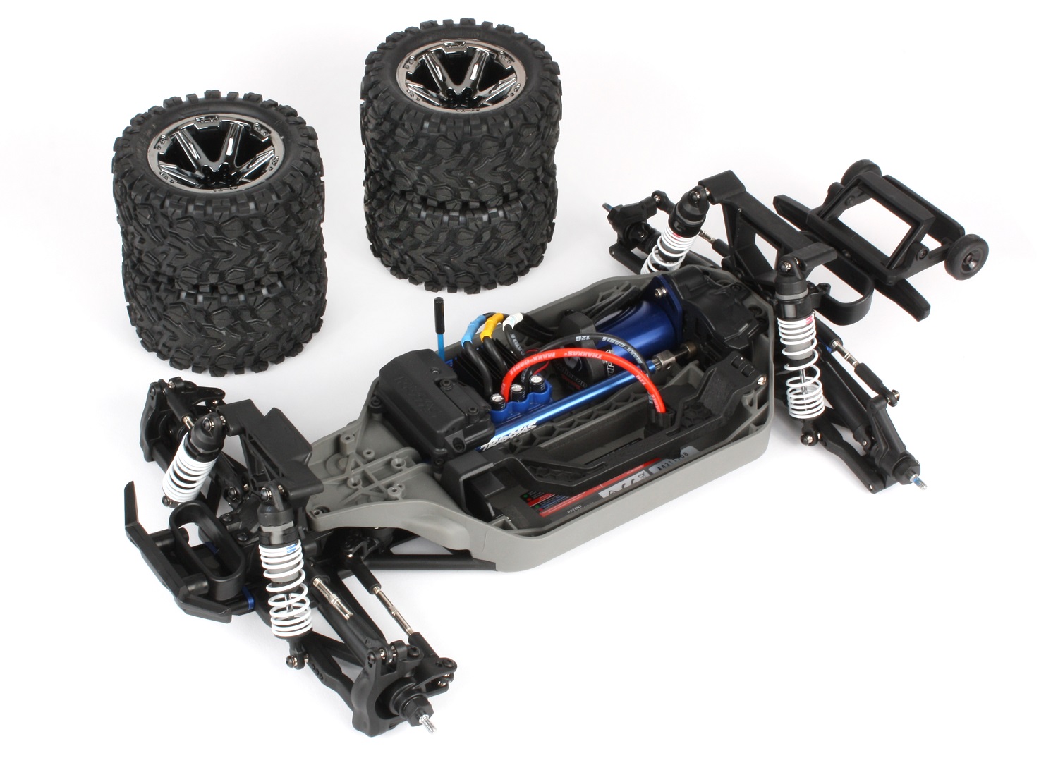

Use Long-Format Batteries in the Second Generation Rustler Chassis
The Traxxas Rustler 4X4 features a chassis with a 162 mm battery tray to accept “flat” 7-cell NiMH batteries, and LiPo batteries with similar dimensions. If you have a first-generation Rustler 4X4 that only accepts hump-style NiMH 7-cell batteries and “short” LiPos, you can easily upgrade your model to the new chassis configuration using the parts listed below. This how-to applies to both the Rustler 4x4 and Rustler 4x4 VXL models.

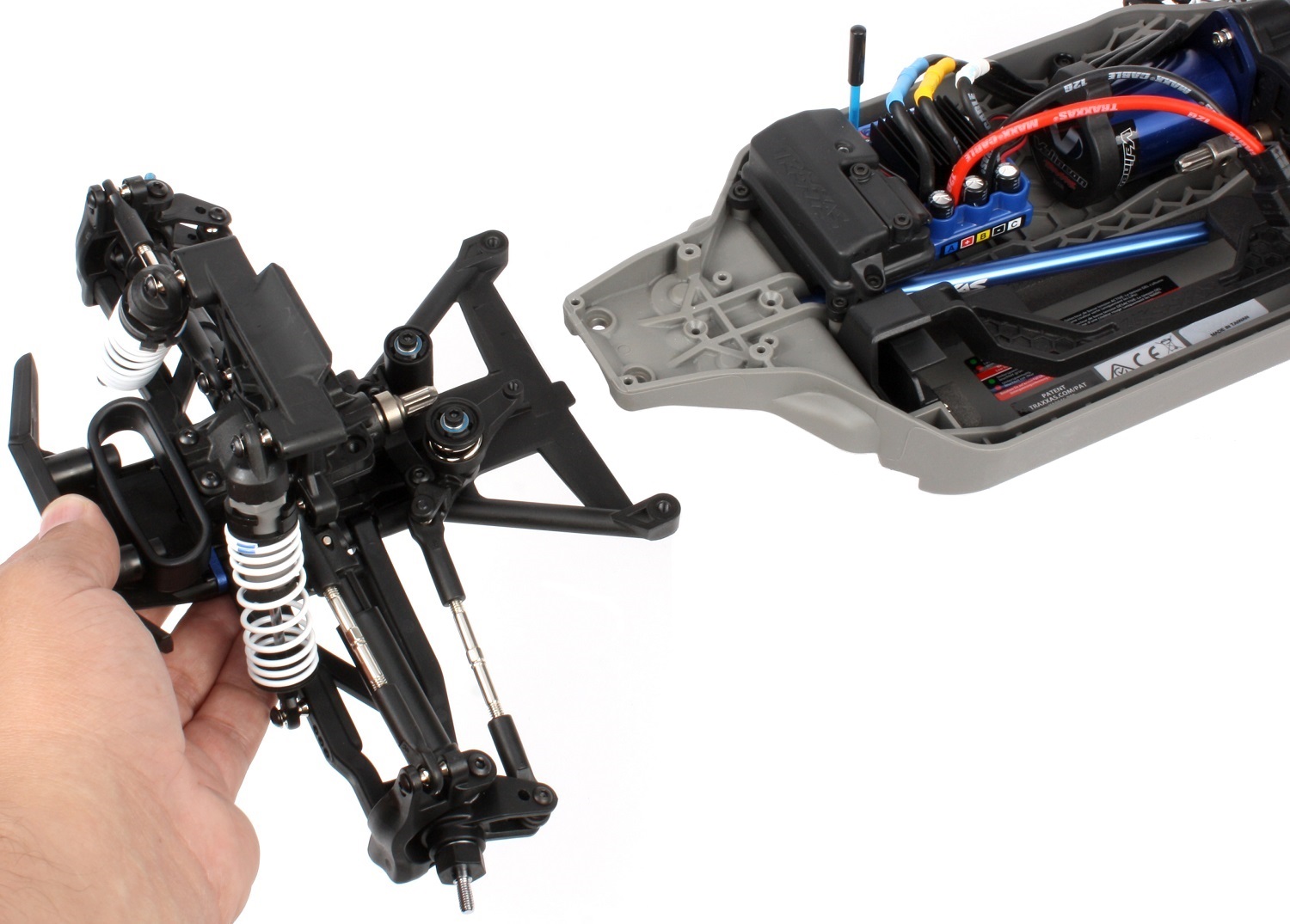

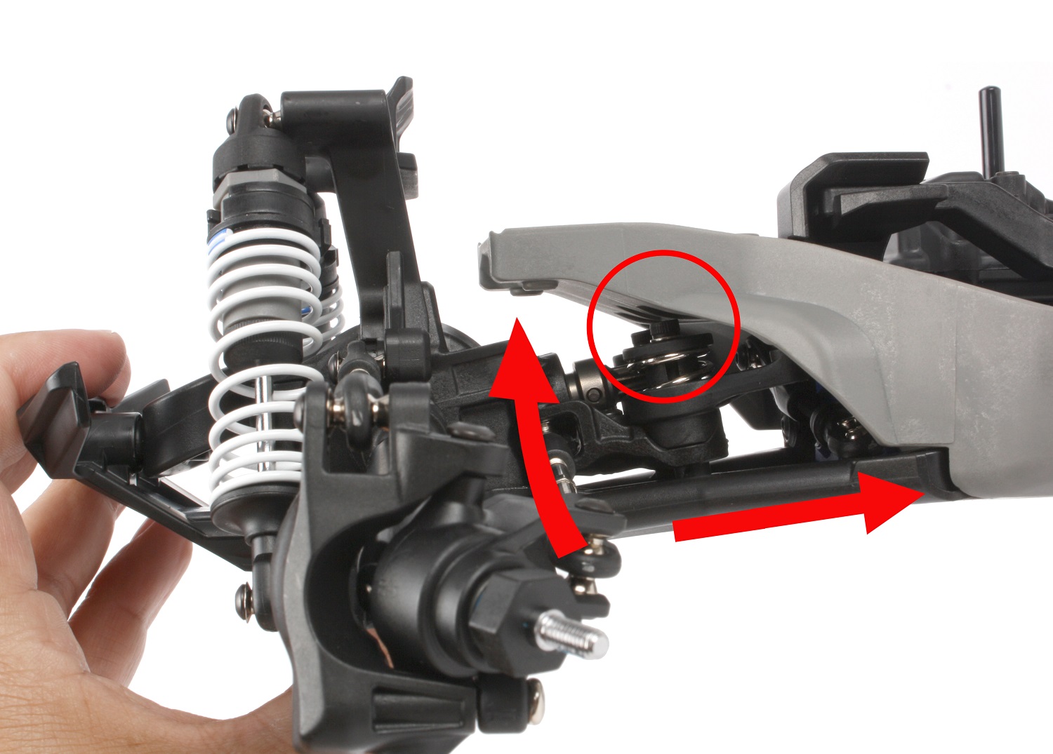

Turn the model over and remove the 3x15 mm screw that secures the steering linkage. Once the steering link is free, pull forward on the front clip to separate it from the chassis. If your model has a plastic driveshaft, it will remain attached to the front suspension.
Remove the steering linkRemove the steering link
Remove the front sectionRemove the front section

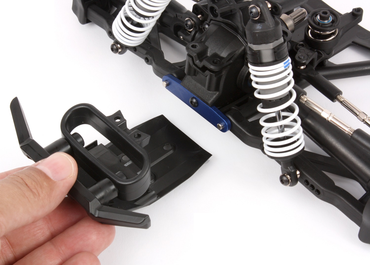

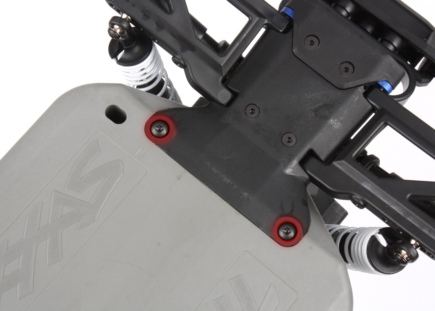

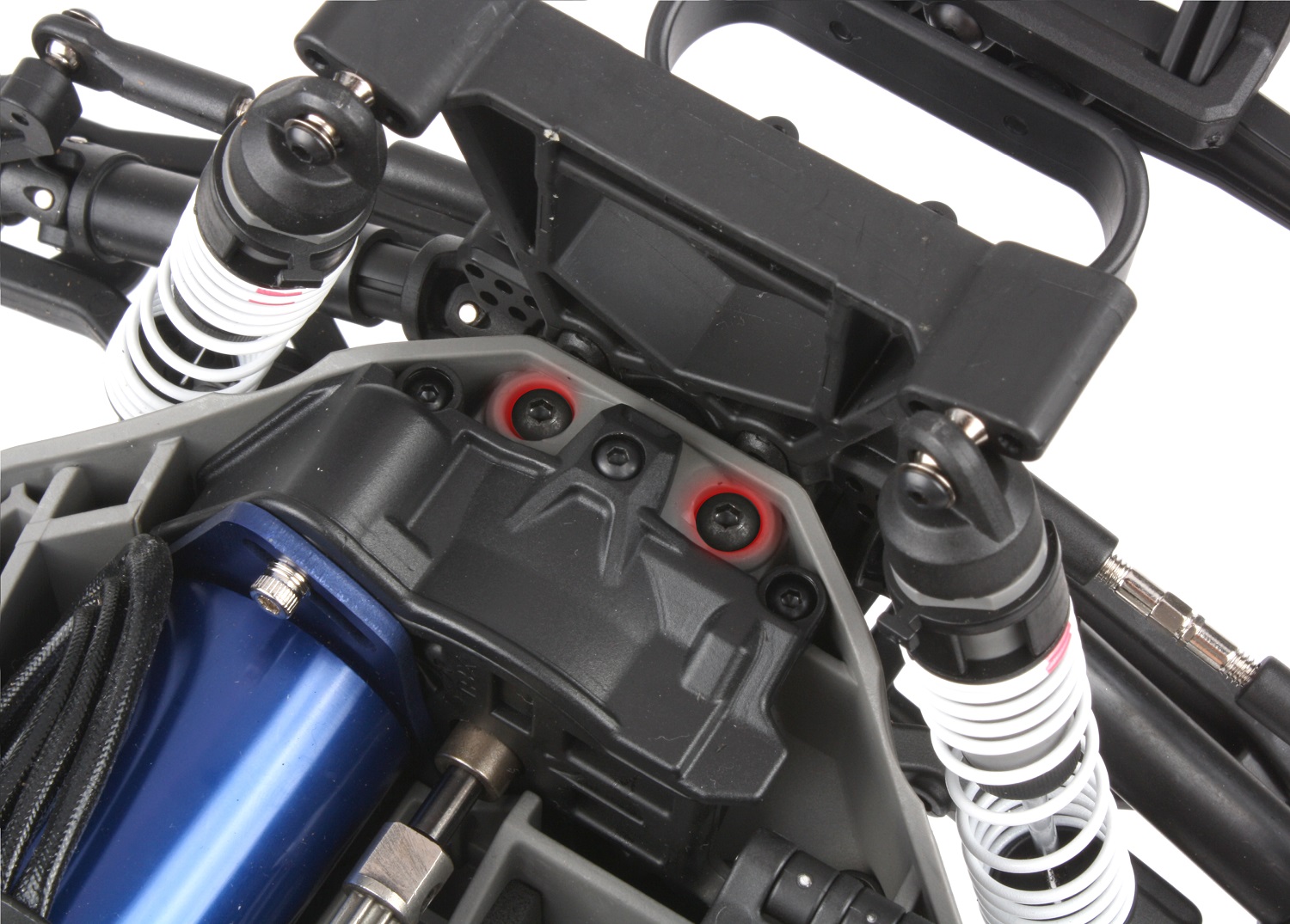

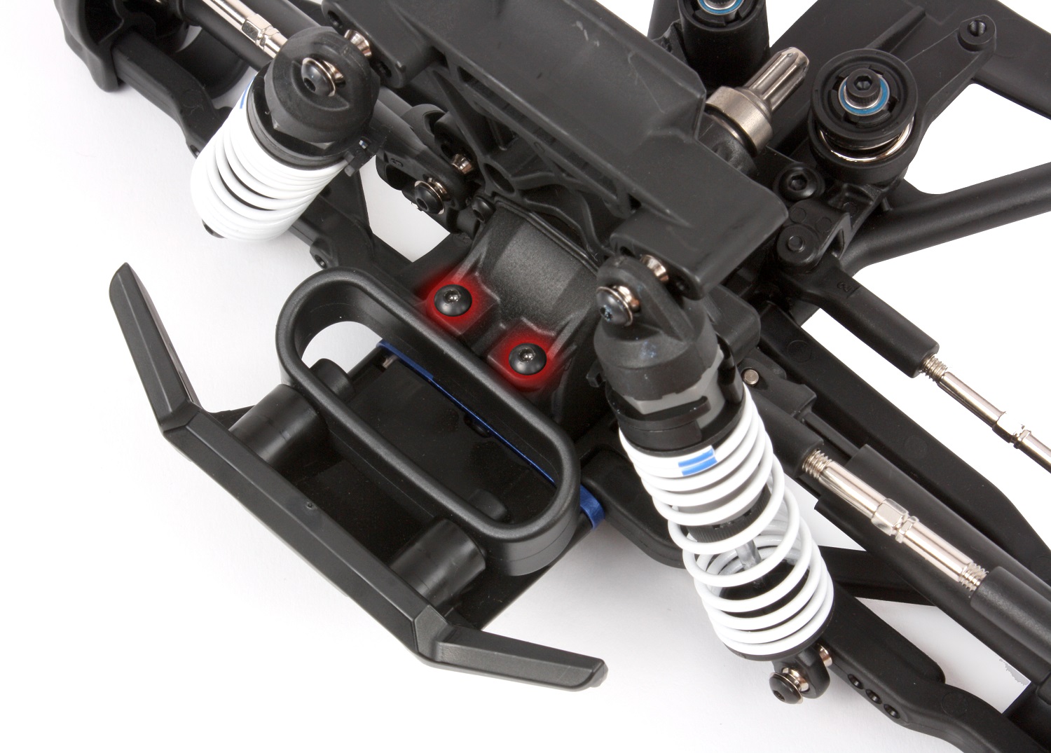

Remove the 4x10 and 4x12 mm screws from the underside of the front suspension, then remove the 3x15 mm screws from the top of the front gearbox. You can now remove the front bumper assembly.
Remove skid plate screwsRemove skid plate screws
Remove bumper support screwsRemove bumper support screws
Remove the front bumperRemove the front bumper

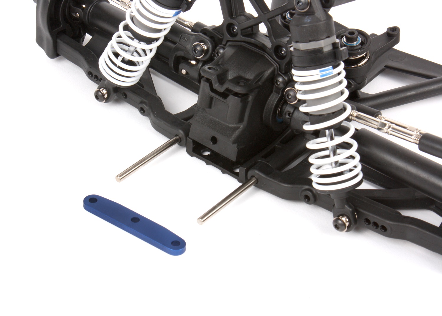

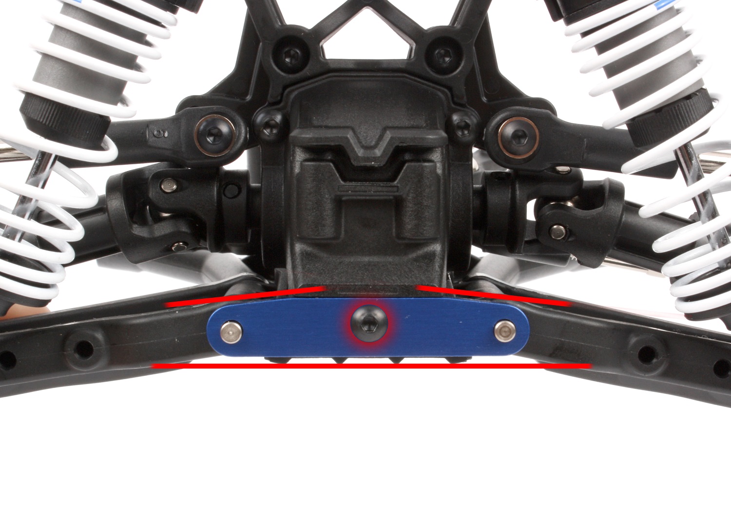

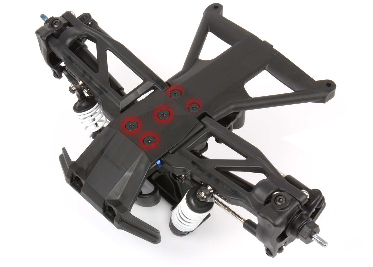

Remove the 3X15 mm screw from the bulkhead tie-bar, and slide the suspension pins out of the arms and bulkhead. Note that the top of the tie-bar has angled sides and the bottom is flat.
Remove the bulkhead screwRemove the bulkhead screw
Remove the suspension pins and bulkheadRemove the suspension pins and bulkhead

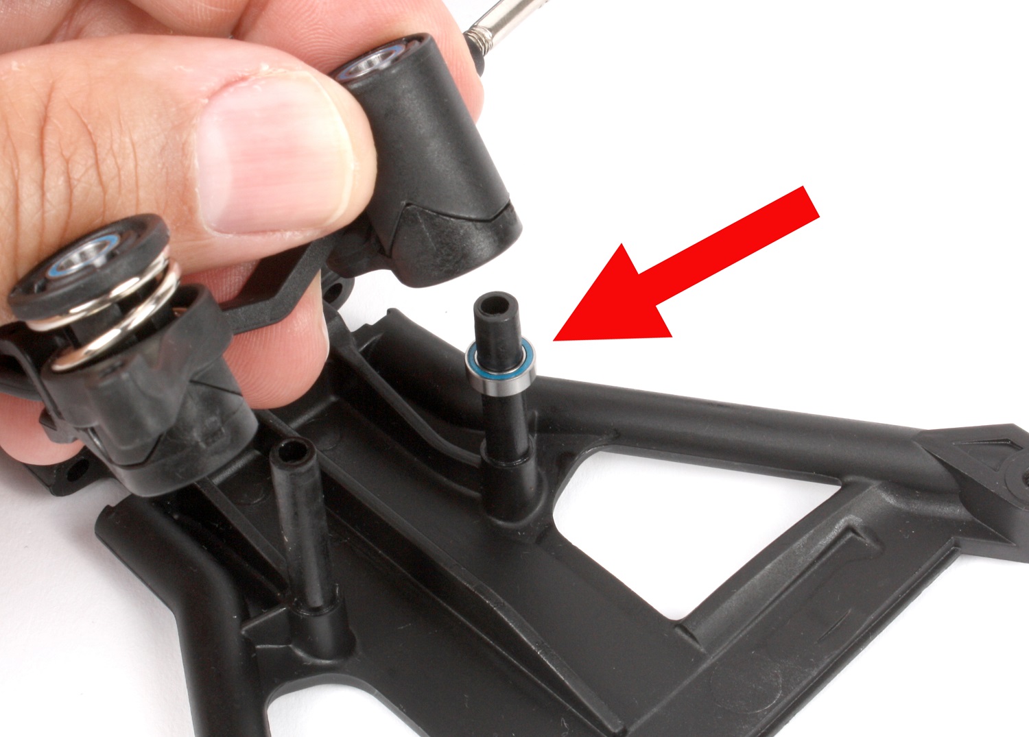

Remove the 3x8 mm screws and washers from the bellcranks, and slide the bellcranks off their posts. Be sure to remove the lower bearings from each bellcrank post and reinsert them back into the bellcranks.

Install the new 7430R front bulkhead by reversing steps 3 through 5. Remember to install the tie-bar with the flat side down and then set the front suspension module aside.
Remember to install the flat side downRemember to install the flat side down
Completed front suspension moduleCompleted front suspension module

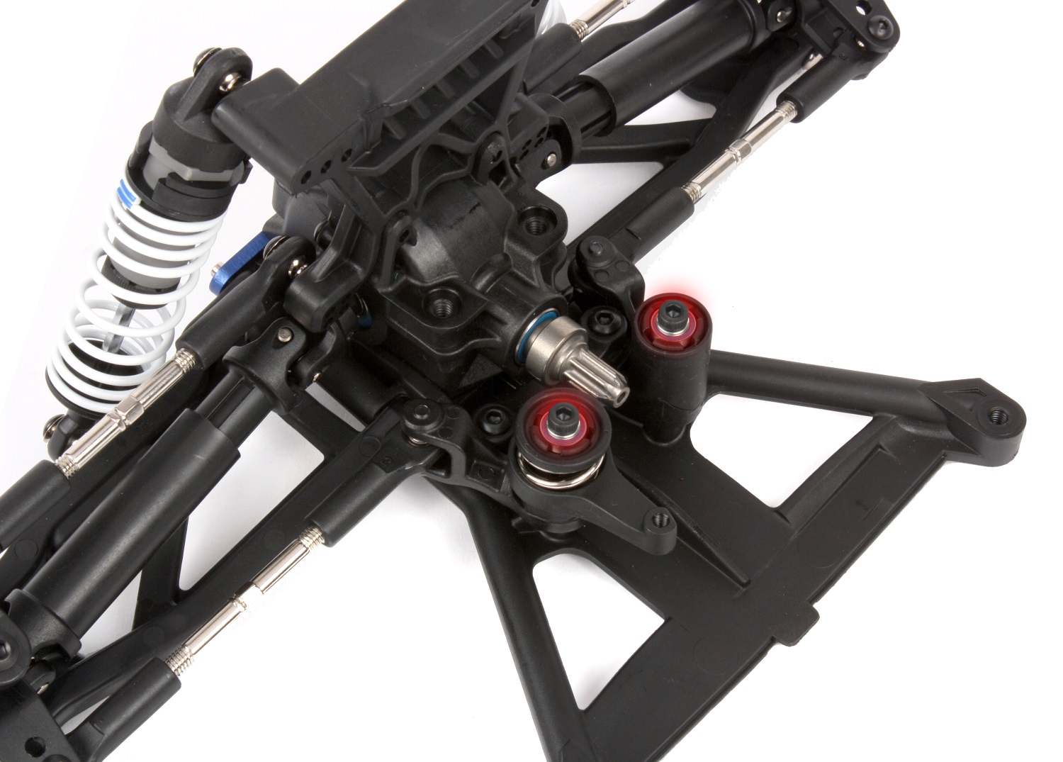

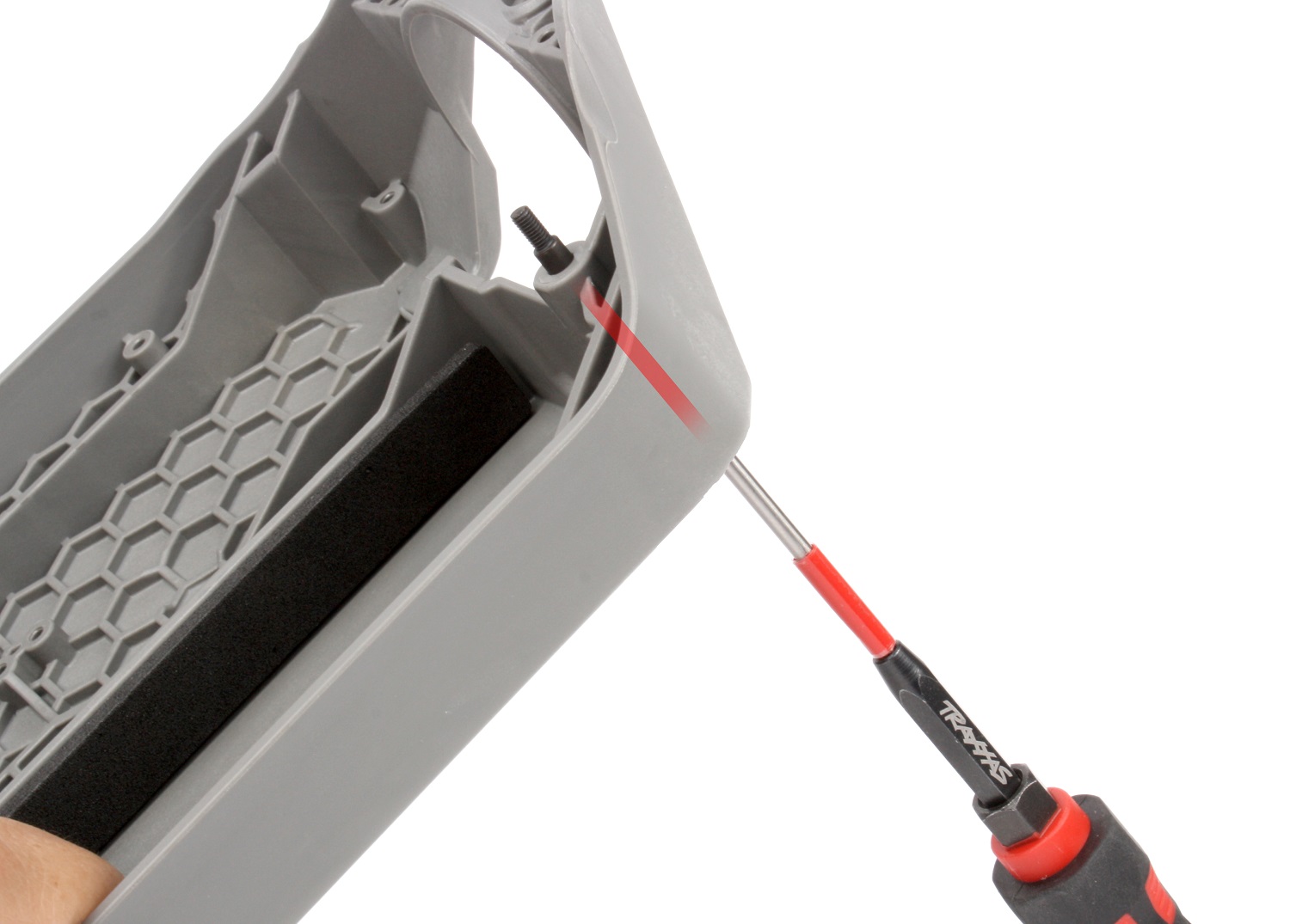

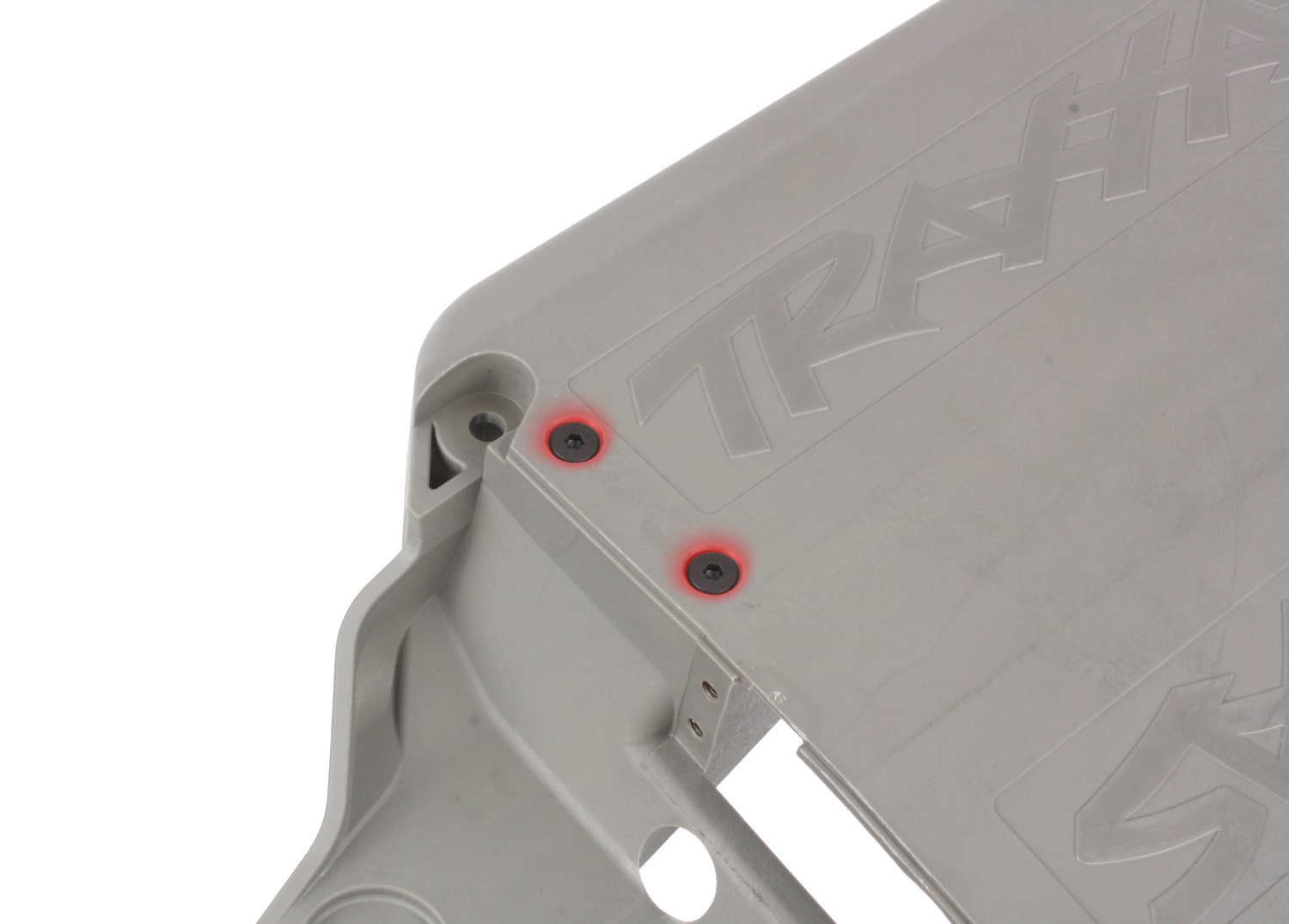

Now we can move on to the rear suspension module. Remove the 4 mm screws from the top and bottom of the chassis, and remove the suspension module by pulling it straight back. The slipper clutch assembly will probably come out along with the suspension module; if it doesn’t, remove it from the chassis now.
Remove the top screwsRemove the top screws
Remove the lower screwsRemove the lower screws
Remove the slipper clutchRemove the slipper clutch

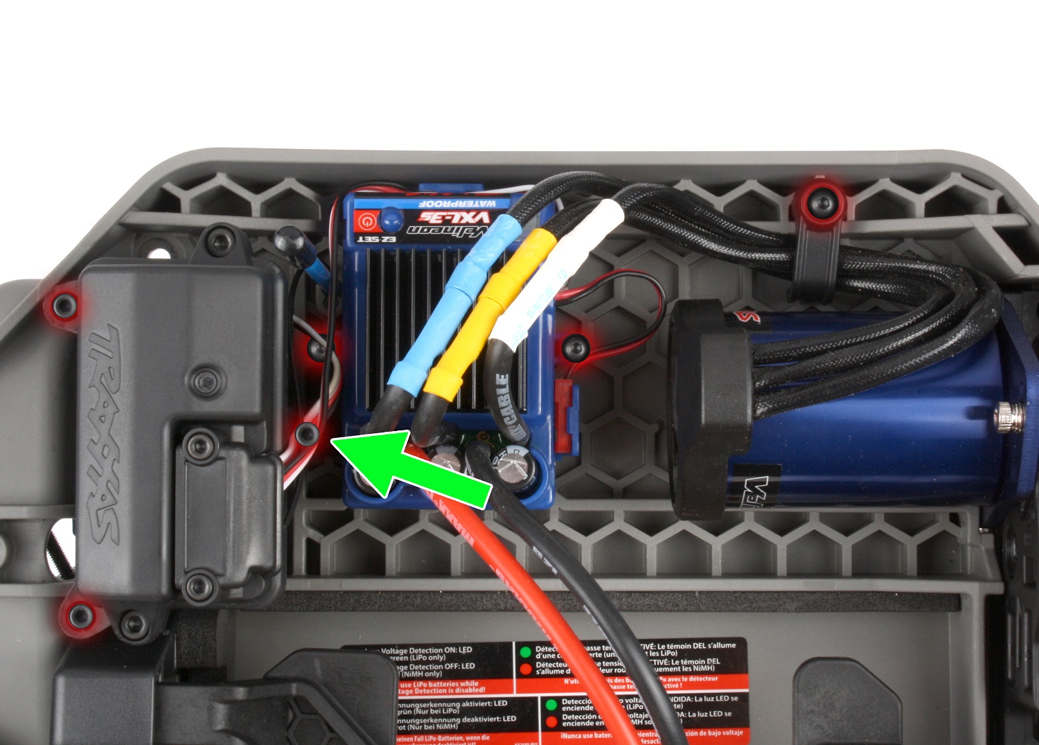

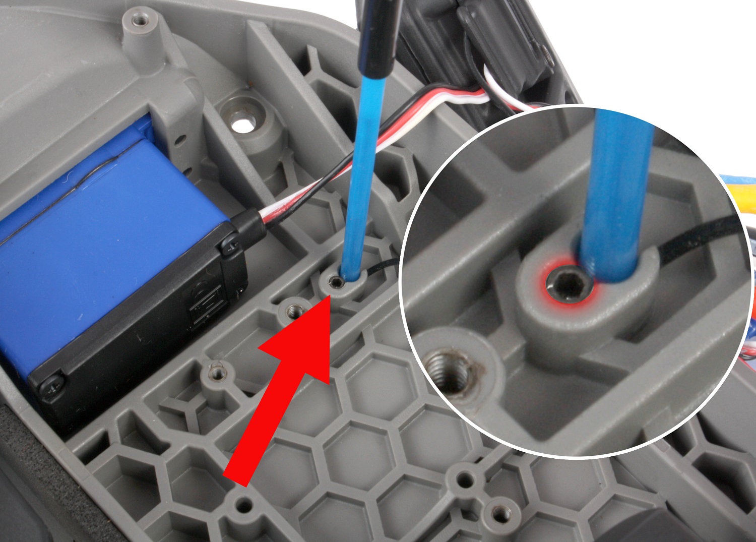

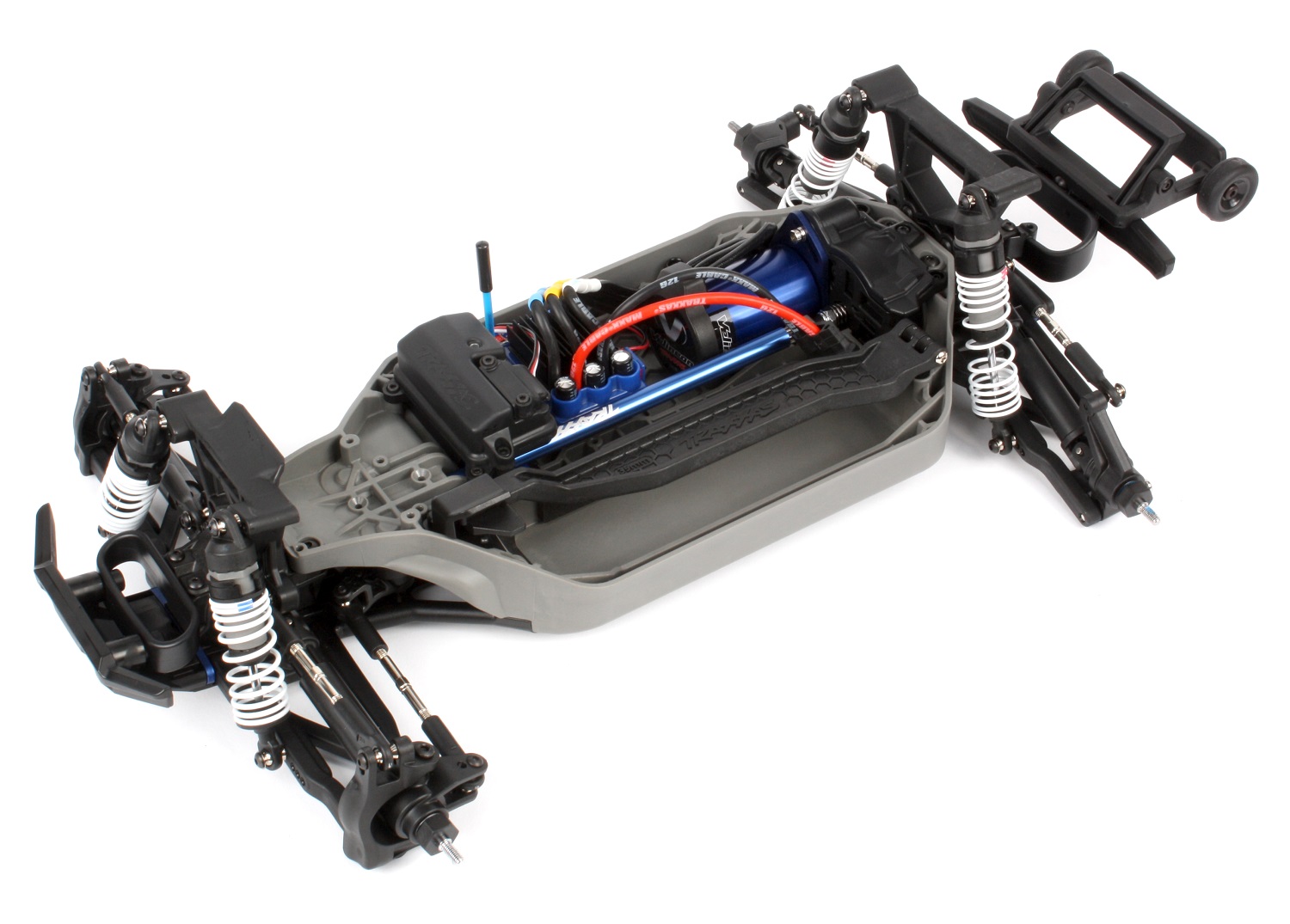

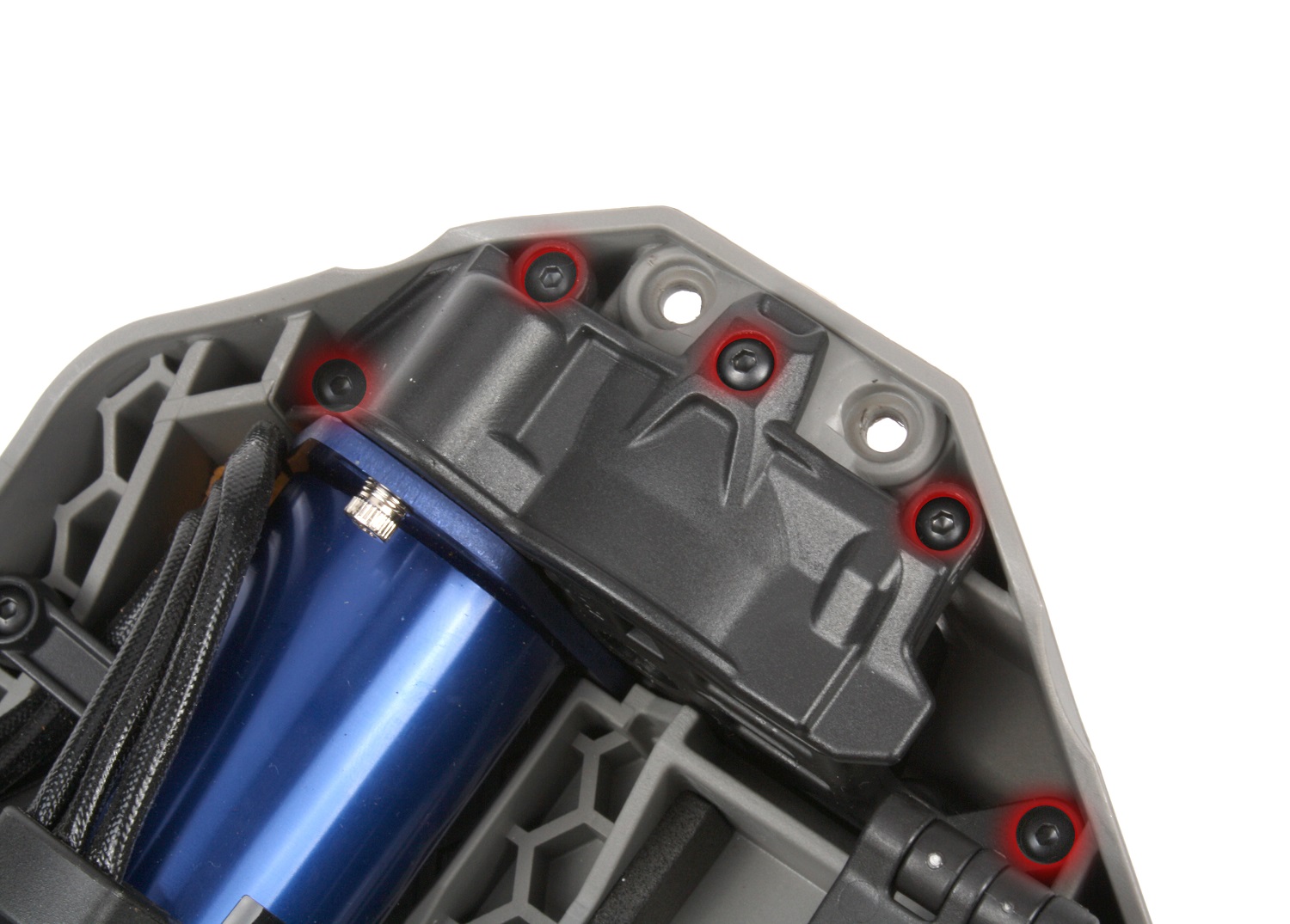

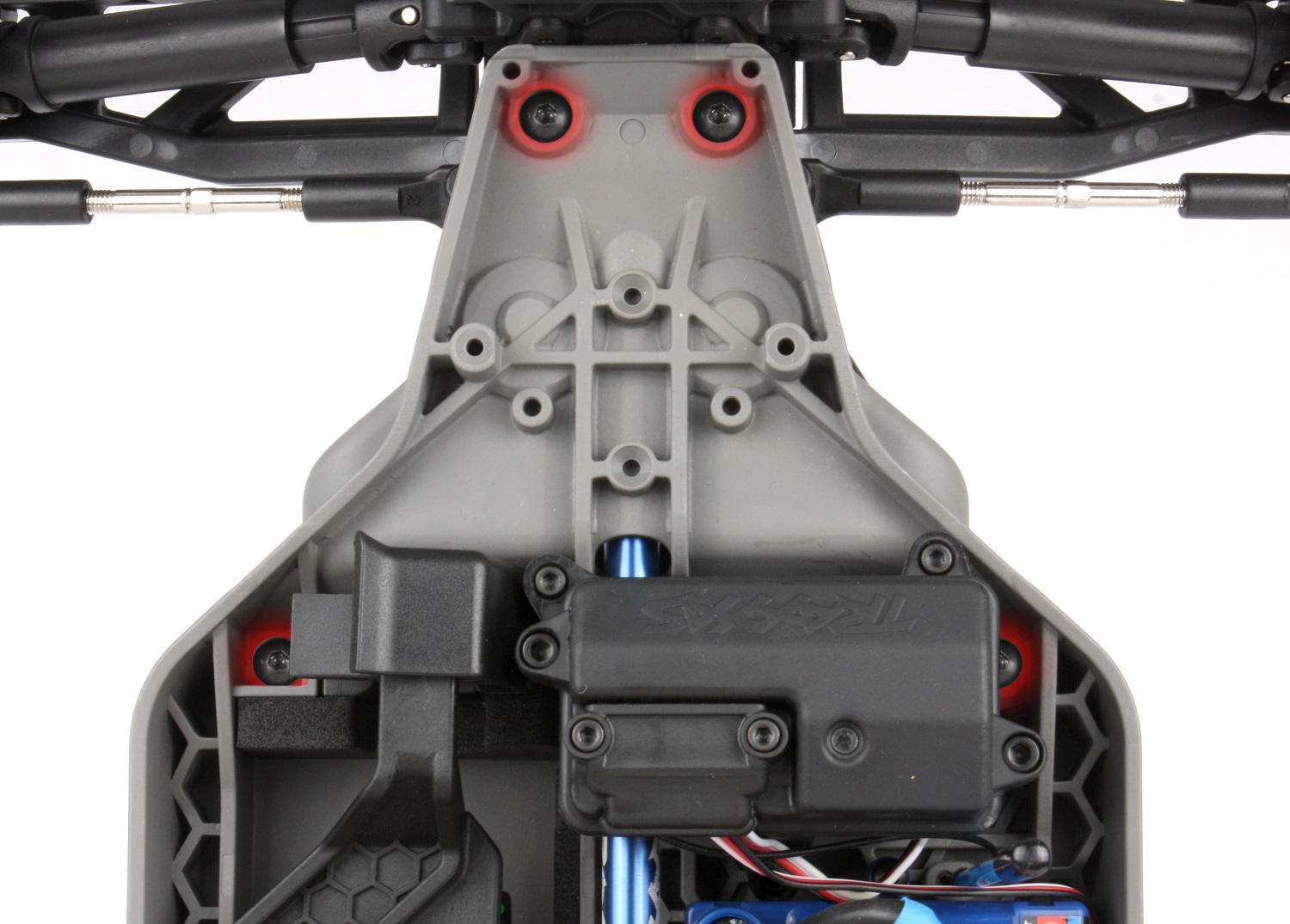

Now we’ll go back to the chassis for electronics removal. Remove the upper and lower 3X10 mm screws from the motor mount, and the 3x6 mm screw that secures the gear cover. Set the gear cover aside. Next, remove the 3x6 mm screw that secures the wire hold-down, the 3x15 mm screws that secure the speed control, and the three 2.5x8 mm screws that hold the receiver box in place (one of the screws is easy to miss—see the green arrow). Also remove the grub screw that holds the antenna tube, and pull the antenna tube out.
Remove motor mount screwsRemove motor mount screws
Remove ESC and receiver screwsRemove ESC and receiver screws
Remove antenna screwRemove antenna screw

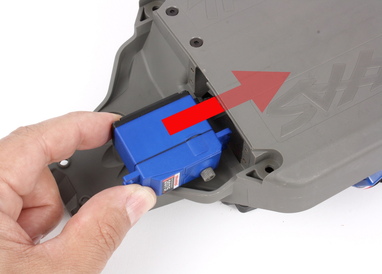

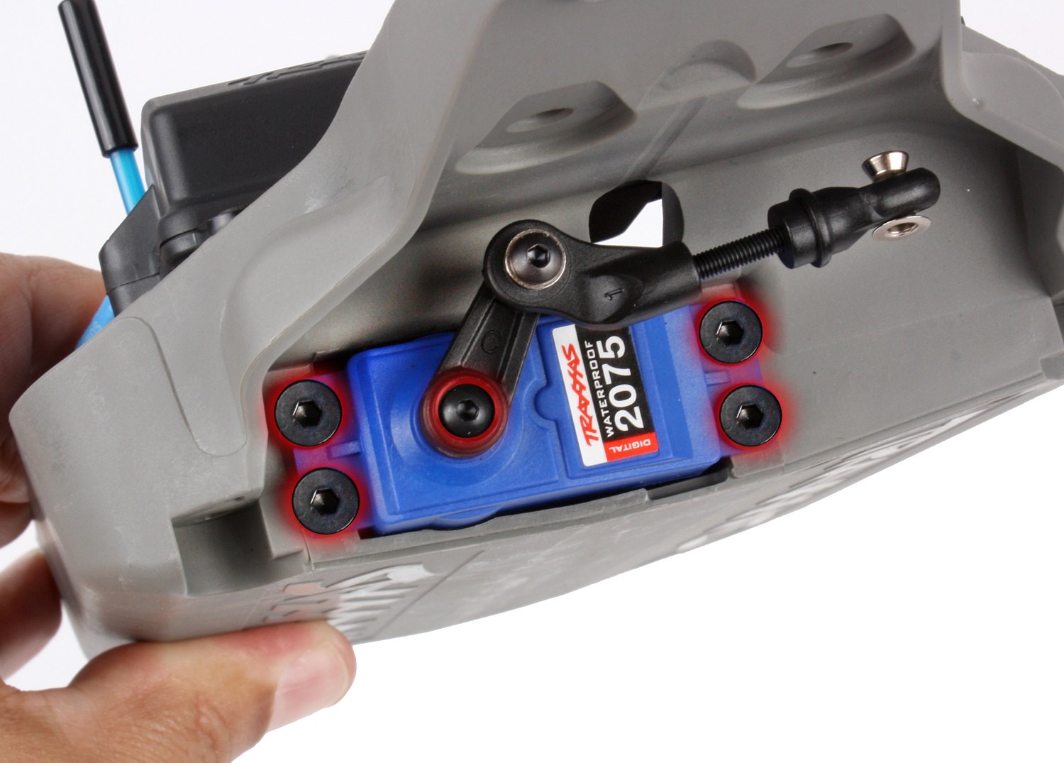

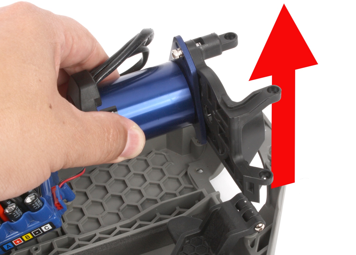

Remove the servo arm and the four screws holding the servo in place. You can now remove the electronics by pulling straight up on the motor and its mount, and lifting up the speed control and receiver box off the chassis. To remove the servo, pull it forward out of the chassis, then turn it sideways and push it back through the opening.
Remove the servo screwsRemove the servo screws
Turn the servo sidewaysTurn the servo sideways
Lift straight up on the motorLift straight up on the motor

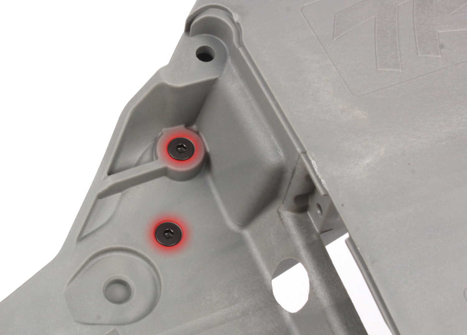

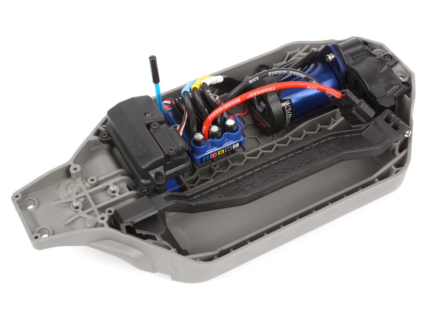

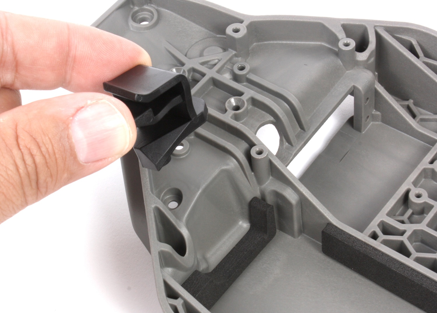

Remove the screws securing the battery hold-down clip onto the old chassis. Use these screws to install the clip included with the 6726X hold-down set onto the new 6723R chassis. Secure the new clip in the new chassis with the screws you removed from the old chassis.
Remove the clip screwsRemove the clip screws
Install clip on new chassisInstall clip on new chassis
Secure the new clipSecure the new clip

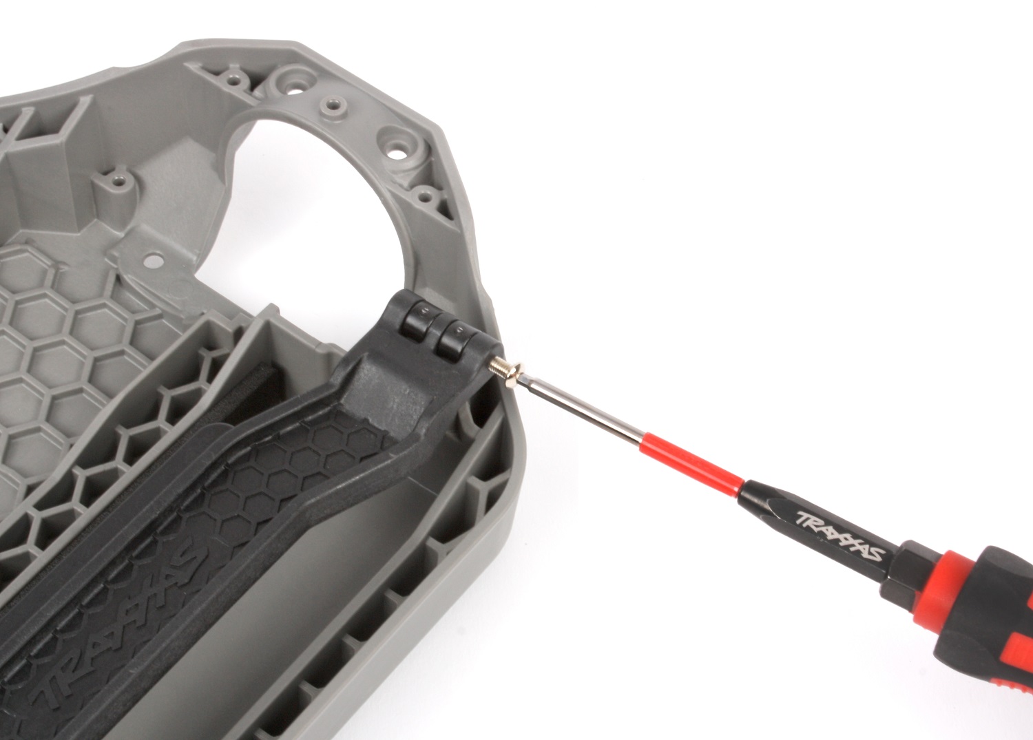

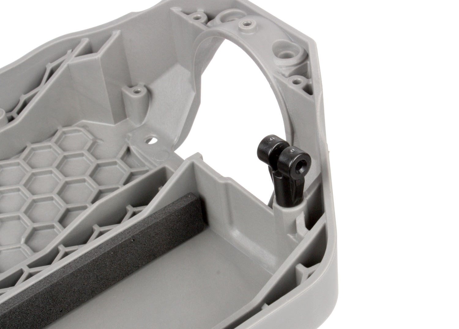

Install the battery strap hinge by inserting the pivot post included with the 6726X battery hold-down set through the hole in the underside of the chassis, and threading it into the hinge.
Insert the pivot post through the chassisInsert the pivot post through the chassis
Tighten the pivot postTighten the pivot post

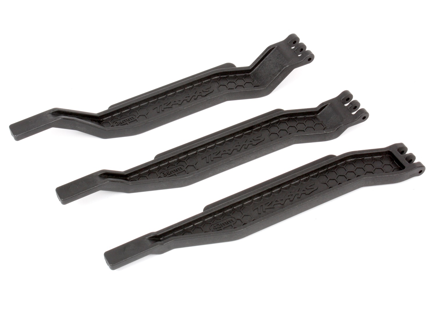

Attach the battery strap using the screw pin. Three straps are included in the set, choose the one that best fits your battery.
Choose your battery strapChoose your battery strap
Tighten down the battery strapTighten down the battery strap

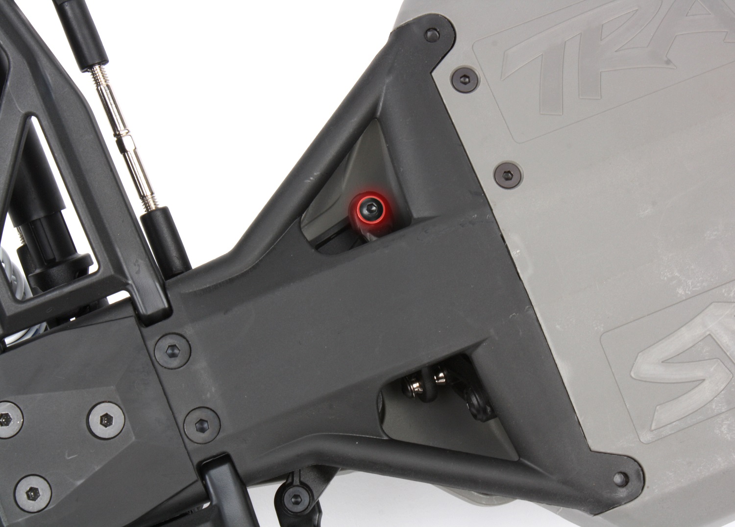

Secure the front suspension module with the 4 mm screws that you removed in Step 2, and reattach the servo linkage.

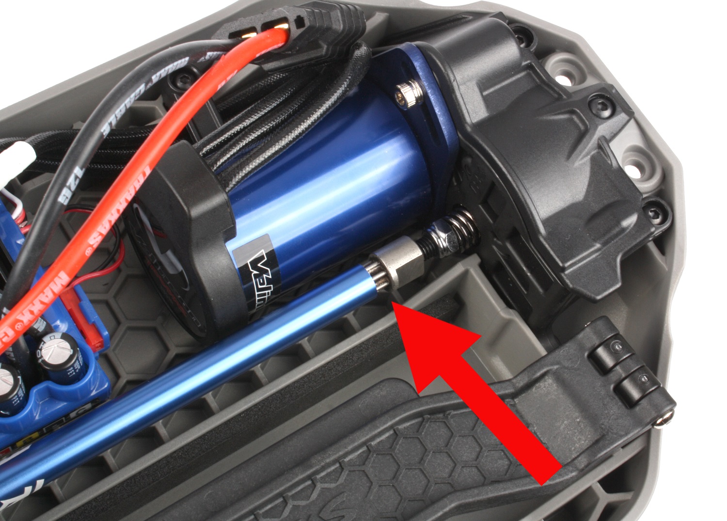

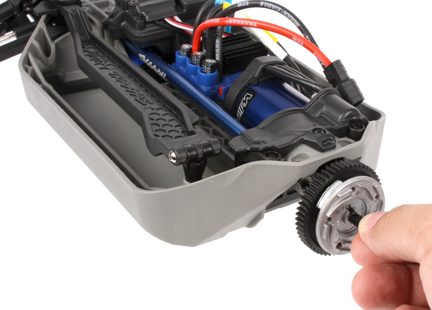

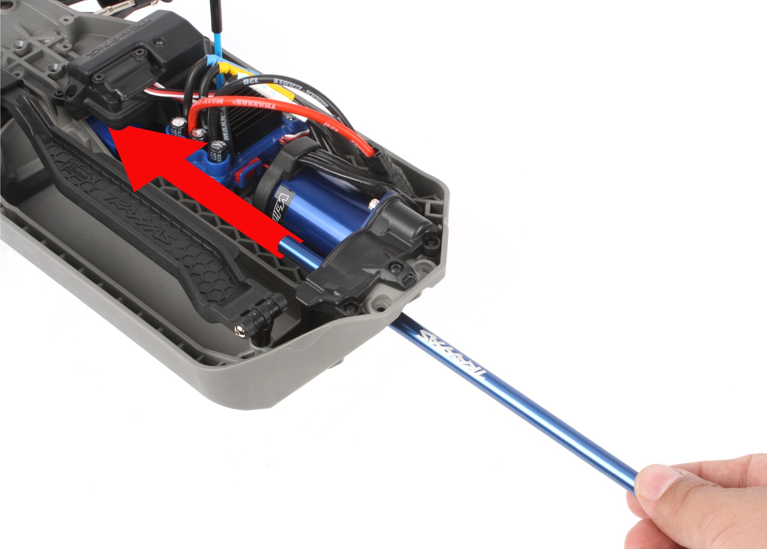

Reinstall the drive shaft through the motor mount and slide it all the way forward until it engages the front gearbox’s splined input. Next, slide the slipper clutch assembly into the chassis.
Reinstall the driveshaftReinstall the driveshaft
Reinstall the slipper clutchReinstall the slipper clutch
Step 17

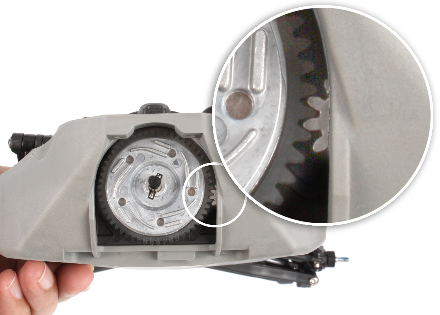

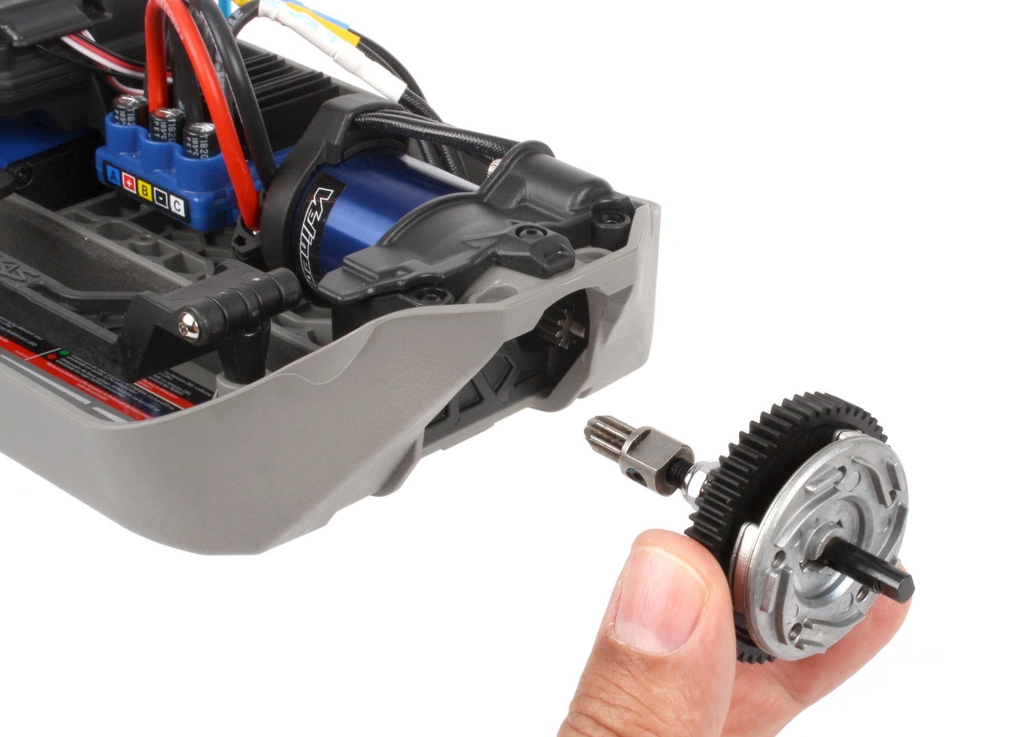

When installing the slipper clutch, ensure that it seats fully in the motor mount and that the splines engage with the driveshaft. Also make sure to align the spur and pinion gear so that the teeth will mesh.
Align the splines with the shaftAlign the splines with the shaft
Check the gear meshCheck the gear mesh

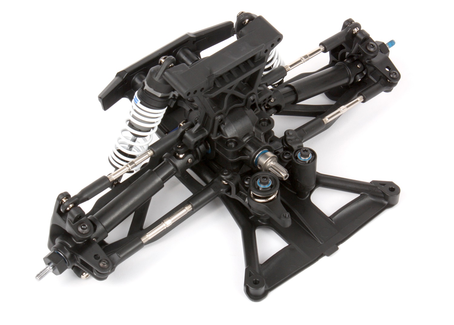

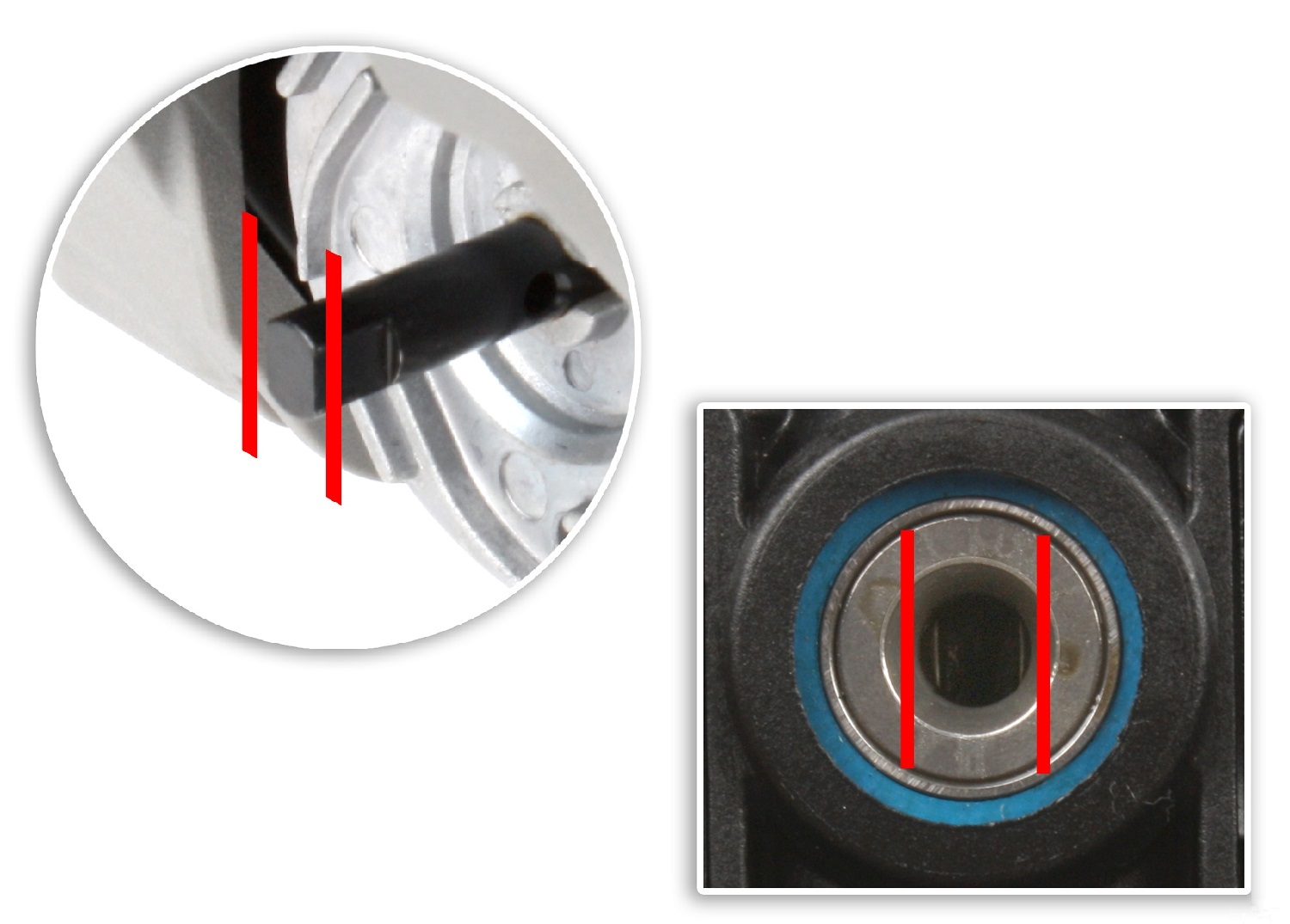

Now we can reattach the rear suspension module. Position the flat spots on the slipper clutch shaft and the slotted opening in the gearbox so they are both vertical, and slide the suspension module into the chassis. If it doesn’t seat fully, jiggle the driveshafts to help the slipper shaft engage the rear gearbox. Reinstall the screws you removed in Step 7 to secure the assembly.
Align the flat spotsAlign the flat spots
Reinstall top chassis screwsReinstall top chassis screws
Reinstall lower screwsReinstall lower screws
