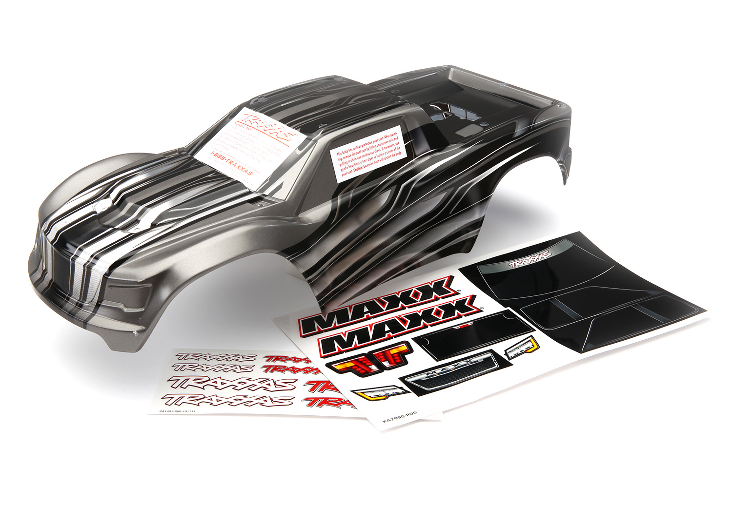

Pre-Painted bodies are ready to mount right out of the package.

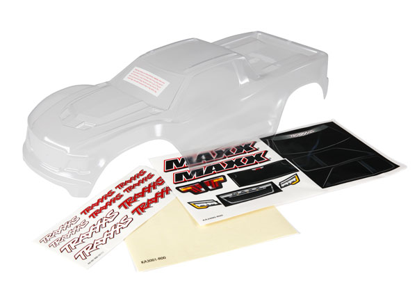

Choose a clear body for complete customization.

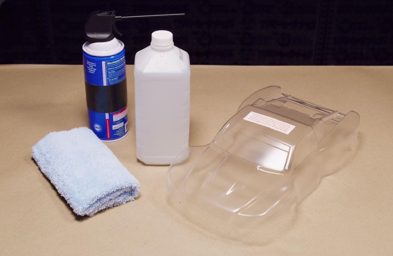

Before painting any body, it's important to prepare the surface for proper paint adhesion. Traxxas bodies include a protective film on the outside to protect against overspray. Be sure to leave the film on until you're finished painting. Clean the inside of the body using isopropyl alcohol and a soft lint-free cloth or microfiber towel. The alcohol will remove any oils and fingerprints that cause adhesion problems with the paint. Use compressed air to remove any lint or dust.
Good pre-paint preparation is the key to pro-quality results.

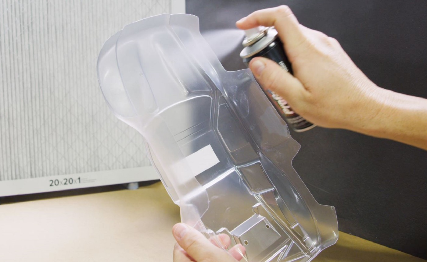

Traxxas designed ProGraphix paint cans with wide caps to avoid finger fatigue when painting. The nozzles deliver a fine mist of paint to avoid blobs and other paint irregularities. It’s important to move the can in a steady side-to-side motion to get even coverage across the body. For best results, apply several light coats and allow the paint time to dry between sprayings. Several light coats will achieve the same effect, while reducing the risk of drips and runs. Hold the body up to a light source to ensure even coverage.
Apply the paint in a steady side-to-side motion about 6" from the body.

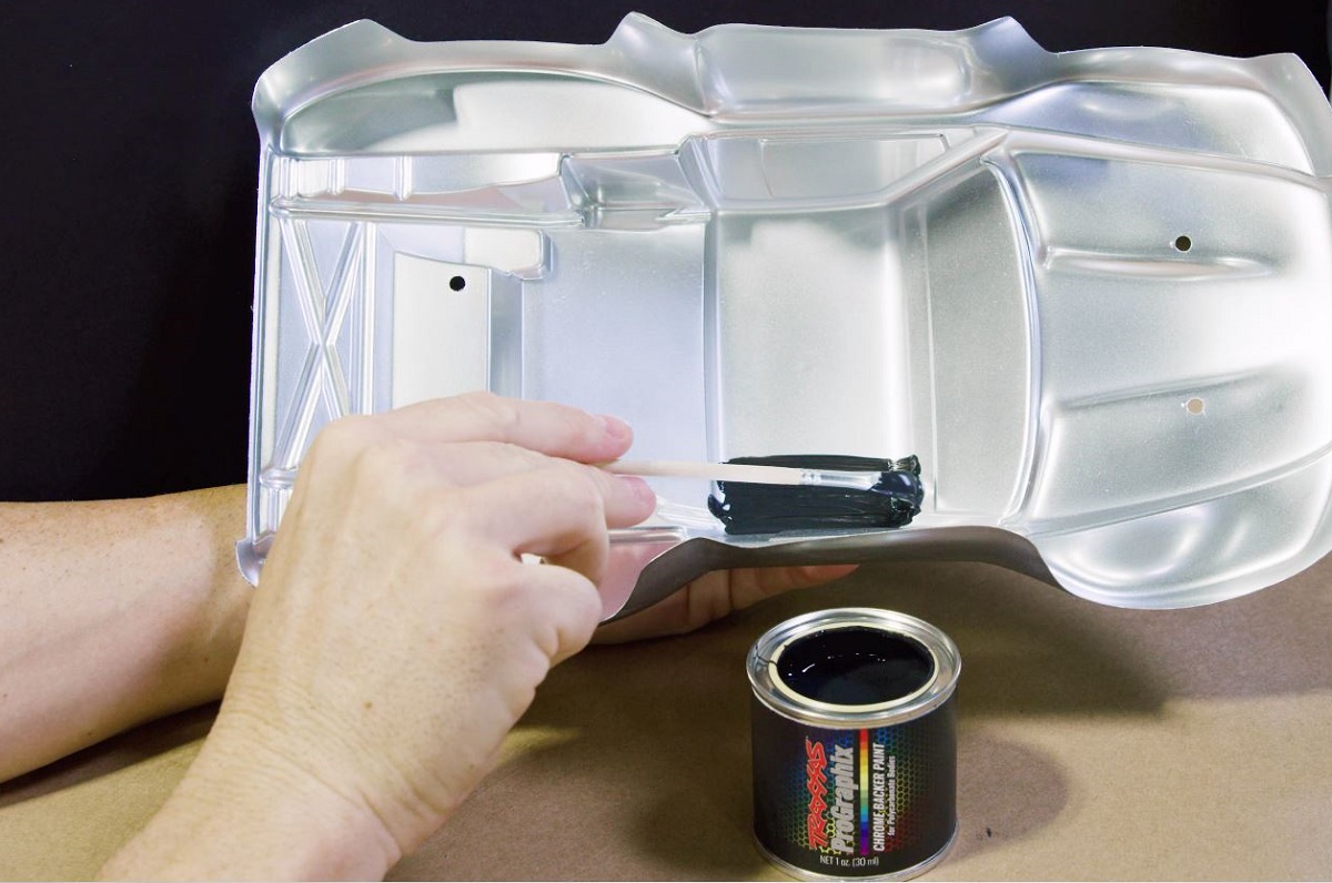

Once the chrome paint has dried completely, it’s time to apply the backer. This is an important step to achieve that pro-quality shine. The backing paint deepens the mirror effect and allows more light to reflect back from the chrome. It also provides a protective layer to prevent scratches and other wear and tear to the chrome finish. Traxxas high-quality ProGraphix chrome backer comes in 100 mL cans and goes on with a brush. Apply the backing paint on top of the chrome layer and allow it to dry before handling.
Apply the backer with a brush for a deep, mirror-chrome shine.

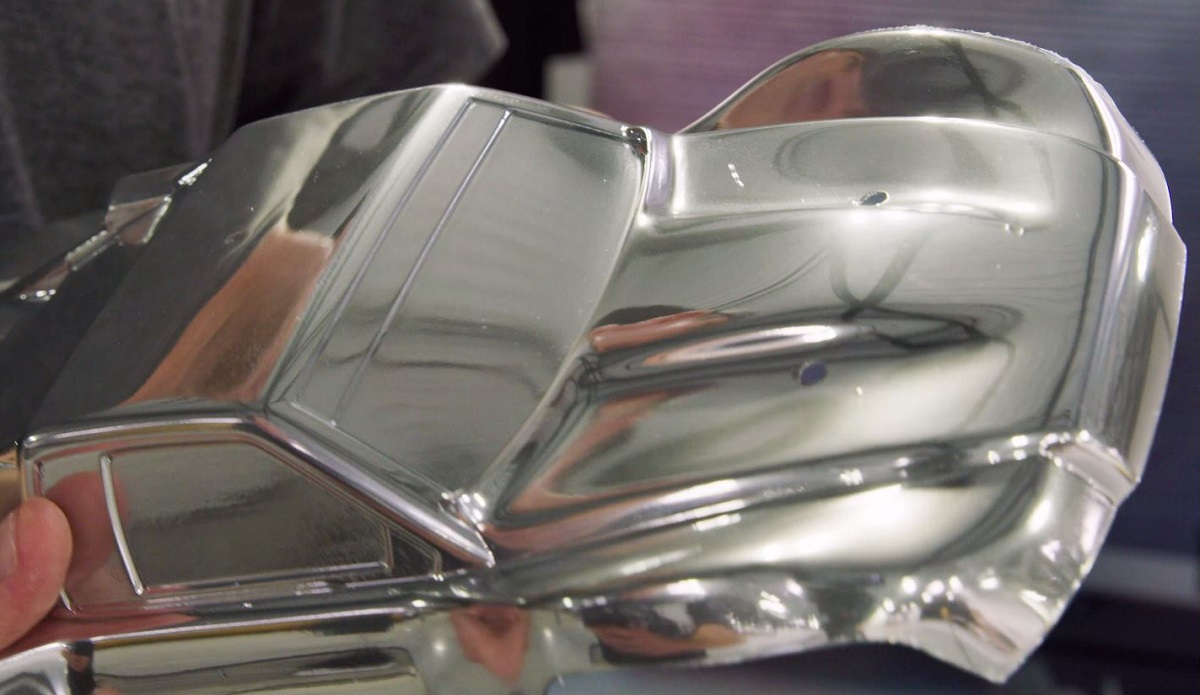

Success!
After the backing paint has dried completely, remove the protective film to reveal a mirror-like shine. Add your decals and any additional body trim pieces at this time and you’re ready for action!
Remove the protective outer film to reveal a mirror-like shine.
