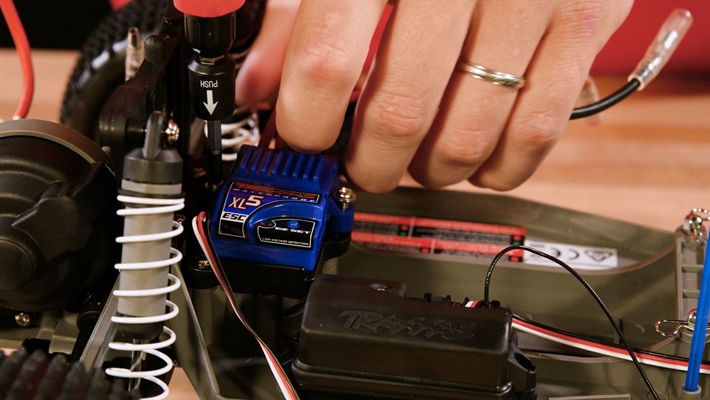

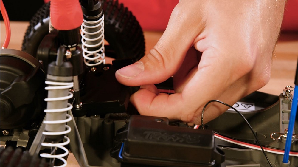

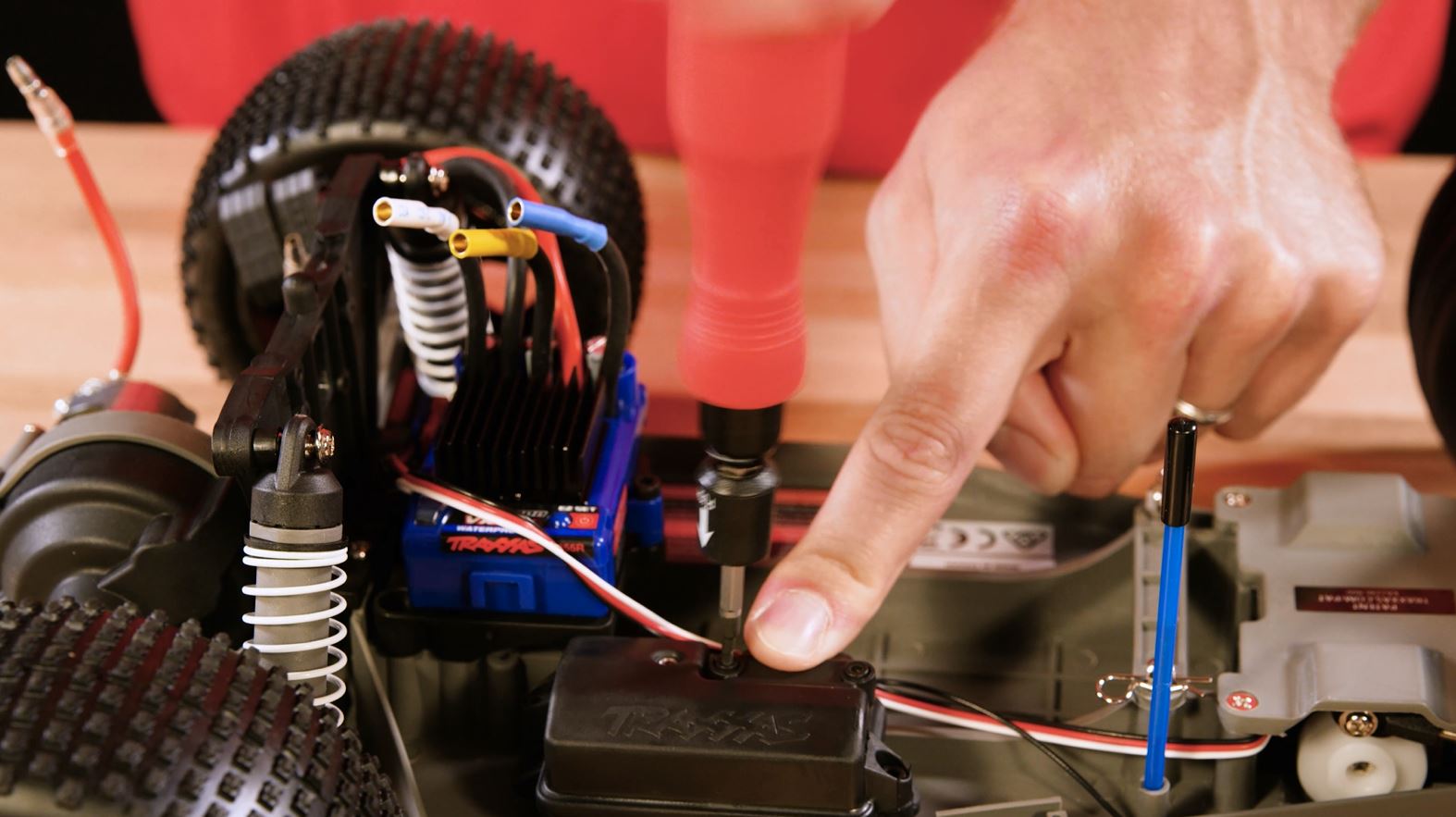

Unplug the two wires connecting the motor to the ESC. Next, open the waterproof receiver box; remove the plug from channel 2 of the receiver; and pull the wire though the box opening. Once your XL-5™ is disconnected, unscrew it from the mounting plate.
Unplug the motor wiresUnplug the motor wires
Unplug ESCUnplug the ESC
Remove the ESCRemove the XL-5 ESC

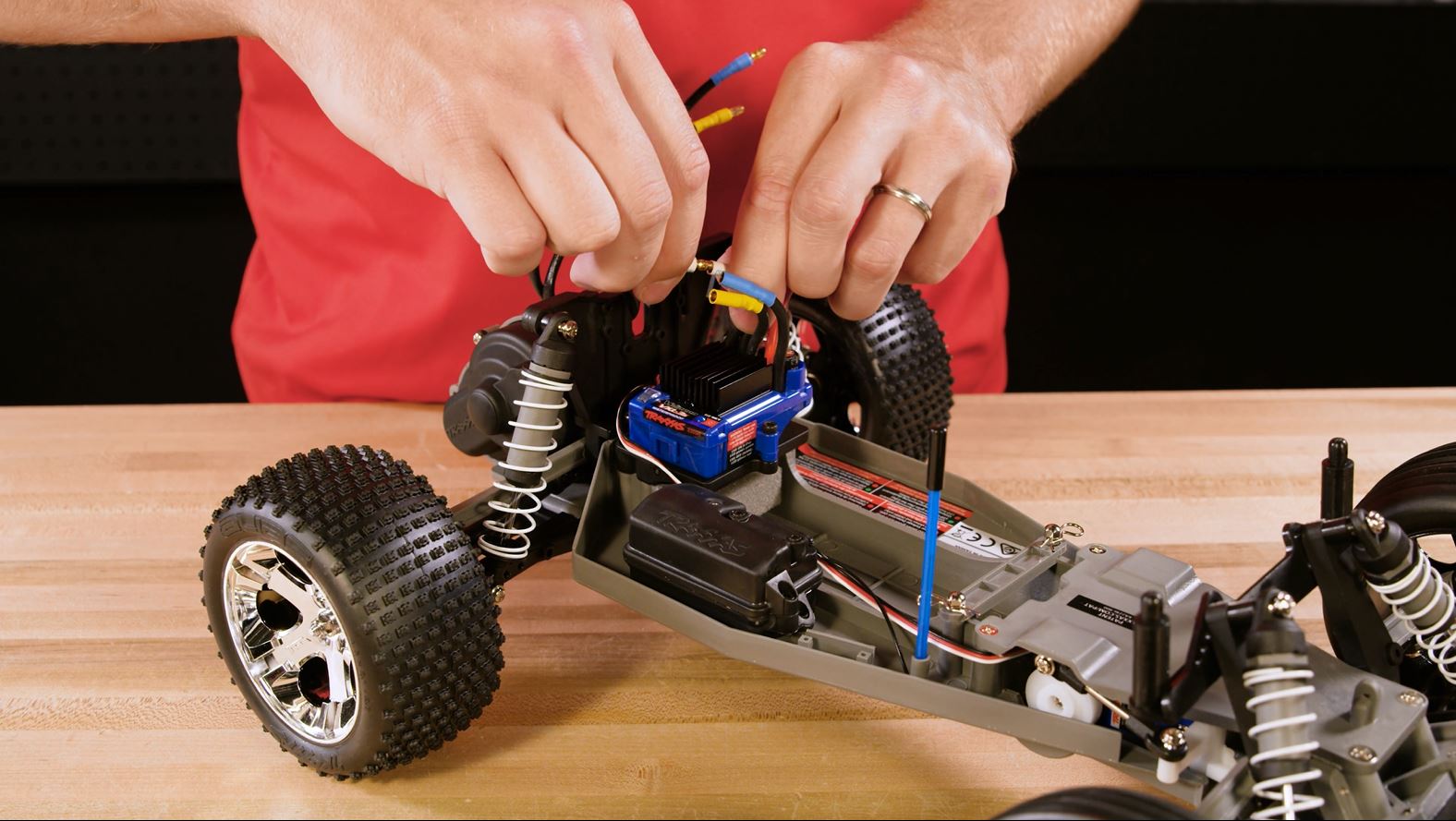

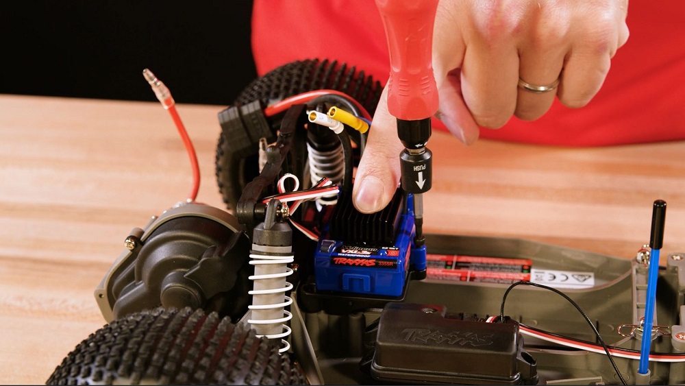

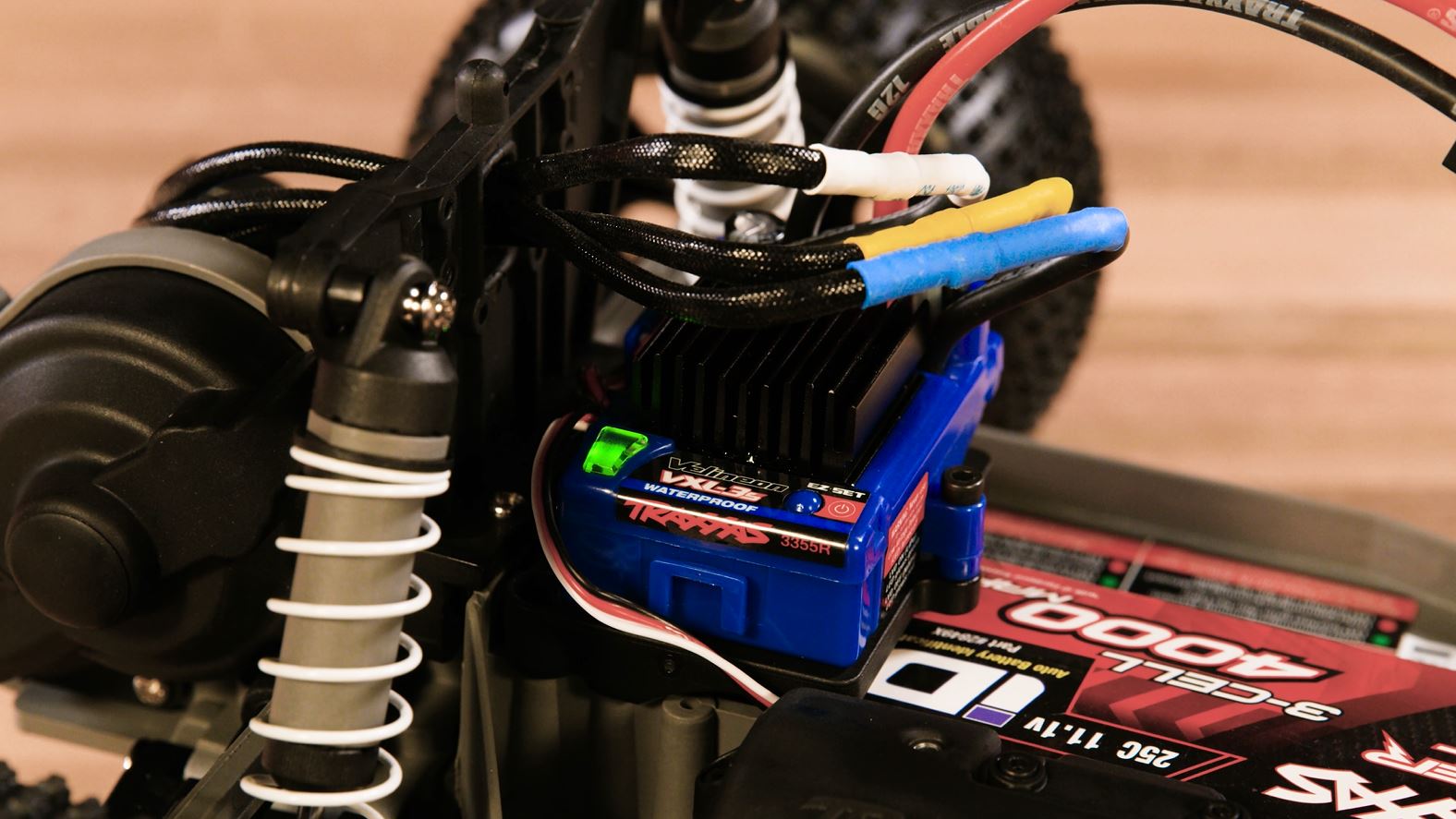

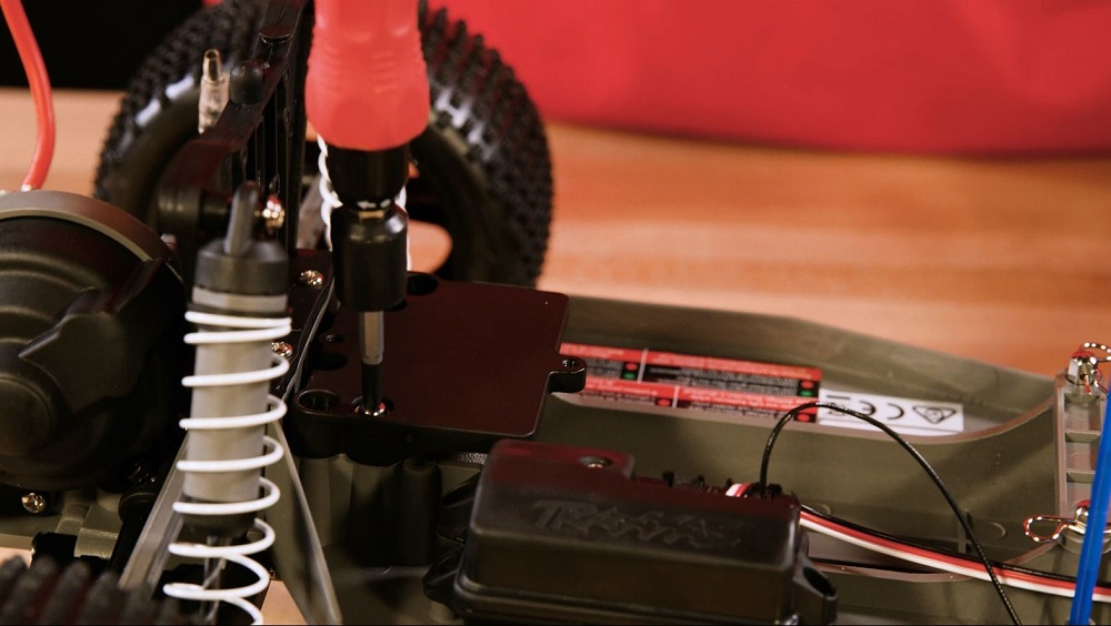

Remove the old plastic ESC mounting plate and install the new one that came in the kit. Secure the new VXL-3s ESC to the mounting plate.
Remove ESC mountRemove the old ESC mount
Install the new ESC mountInstall the new ESC mount
Install the VXL-3s ESCInstall the VXL-3s

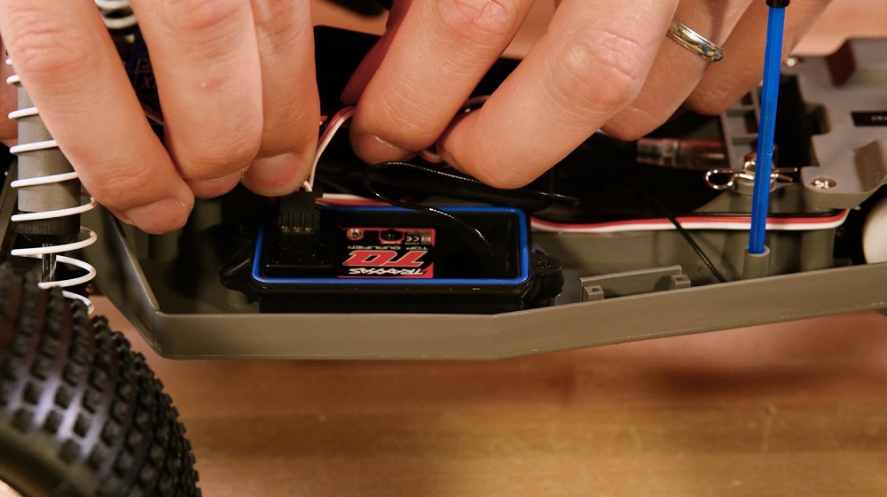

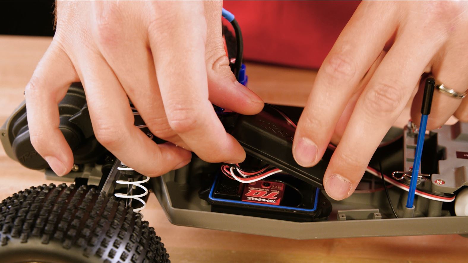

Run the new wire from the VXL-3s into the receiver box and plug it into channel 2 of the receiver. Once plugged in, reseal the receiver box. Next, remove the right rear wheel from the Rustler.
Plug in the VXL-3sPlug in the VXL-3s
Reseal the receiver boxReseal the receiver box

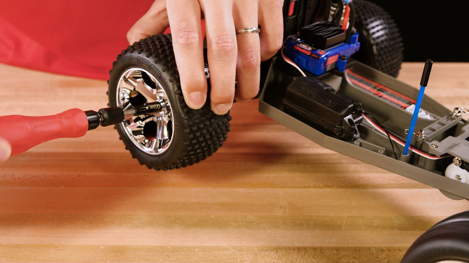

Remove the right rear wheelRemove the right rear wheel

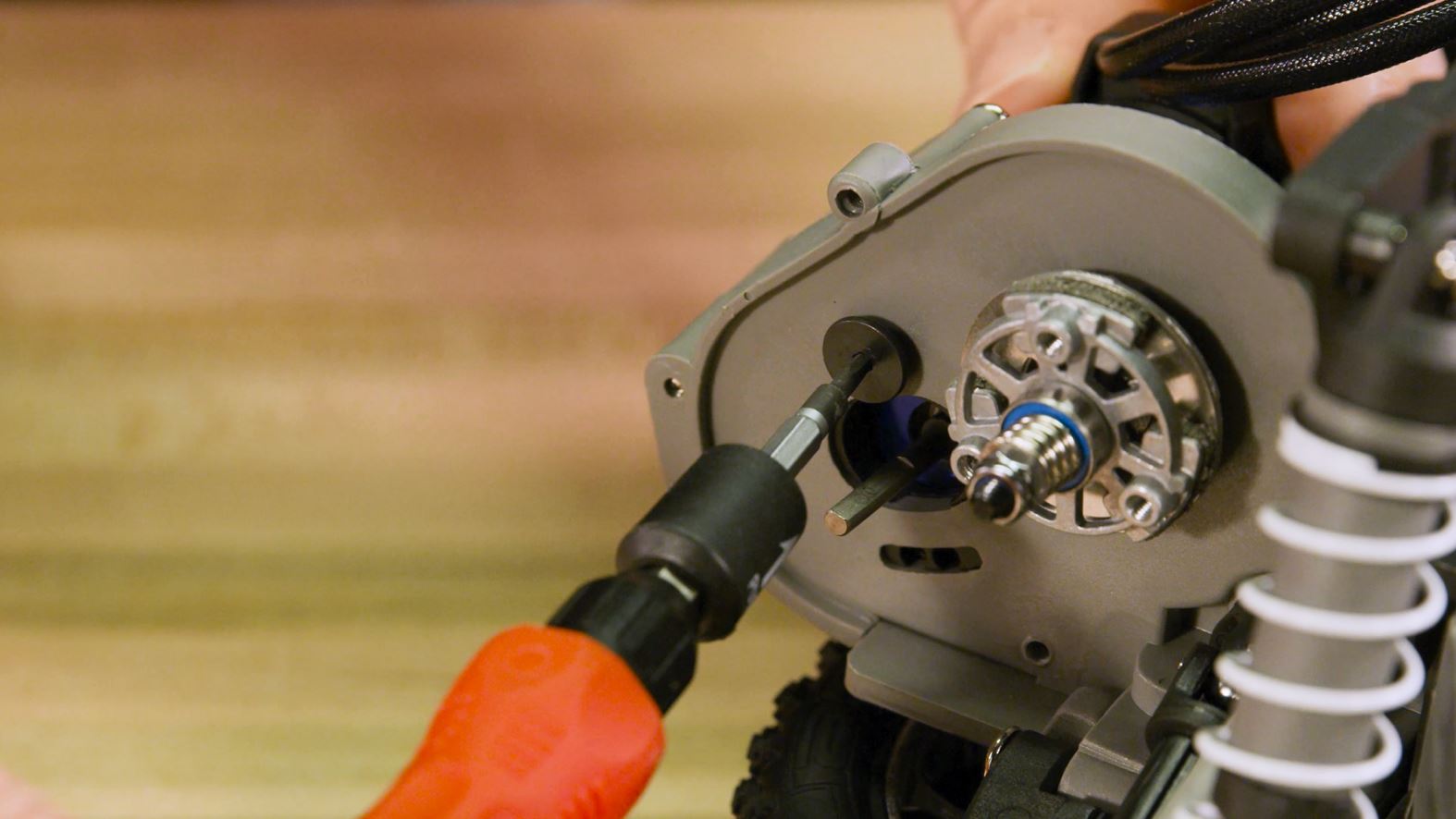

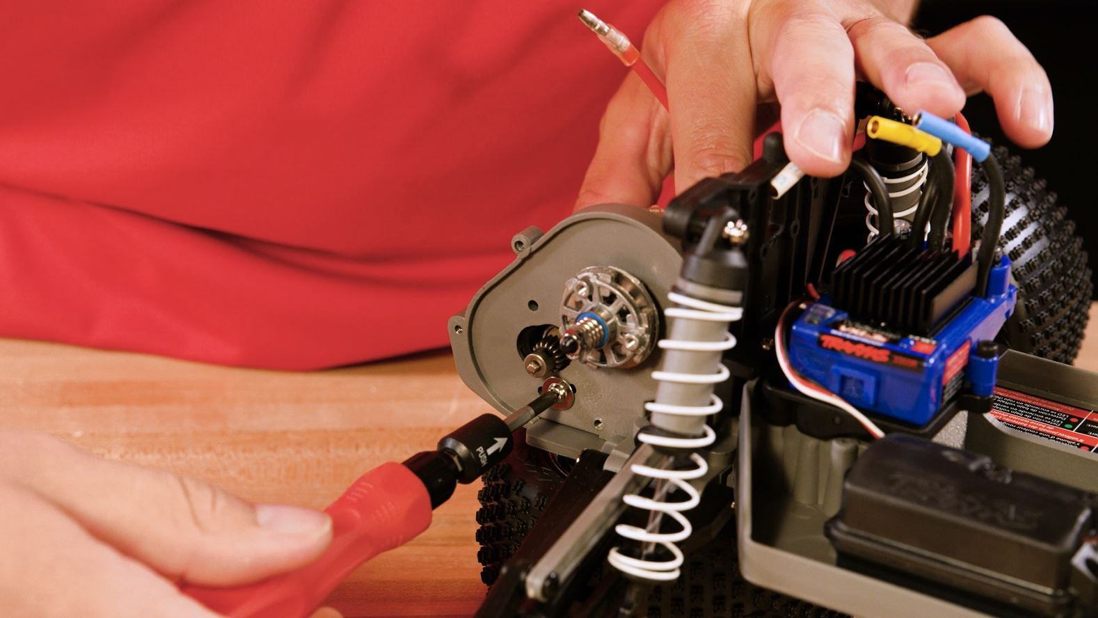

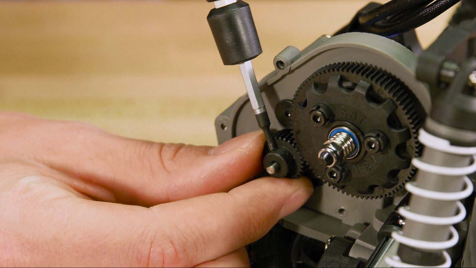

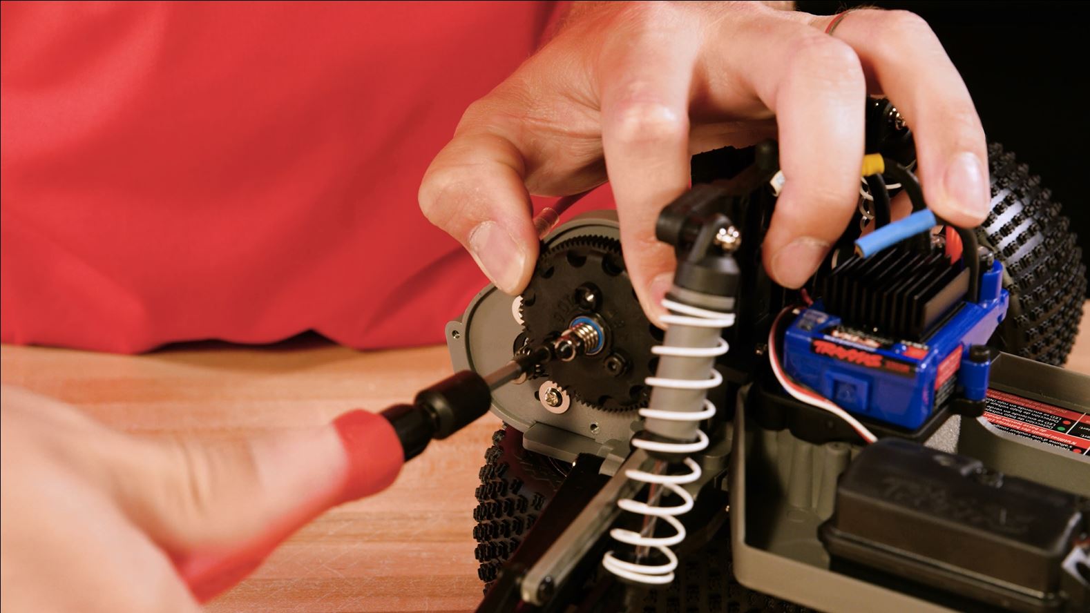

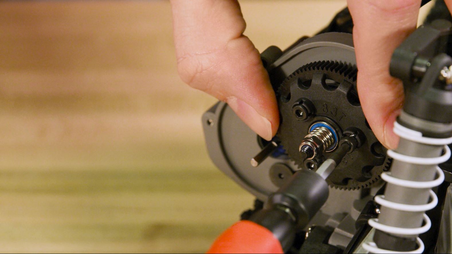

With the rear tire removed, unscrew the transmission cover and set it aside. Unscrew the original spur gear by removing the three screws holding it onto the slipper clutch. Remove the two chromed screws that hold the motor to the transmission case and pull it out. If you already have a large pinion gear installed, you may need to remove it for the motor to come out.
Remove the transmission coverRemove the transmission cover
Remove the spur gearRemove the spur gear
Remove the original motorRemove the original motor

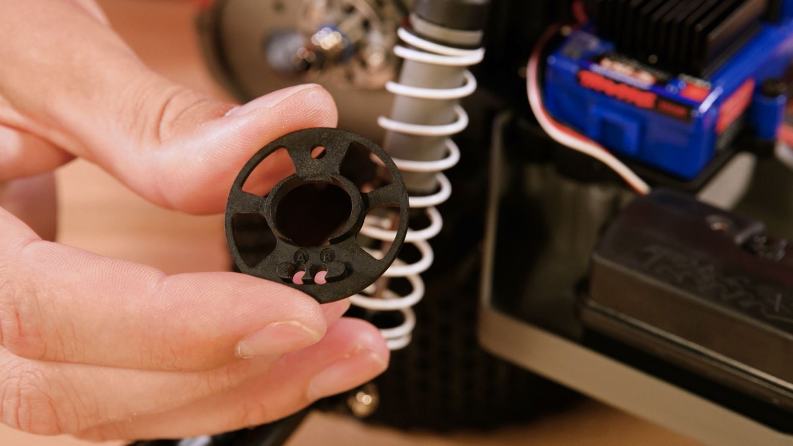

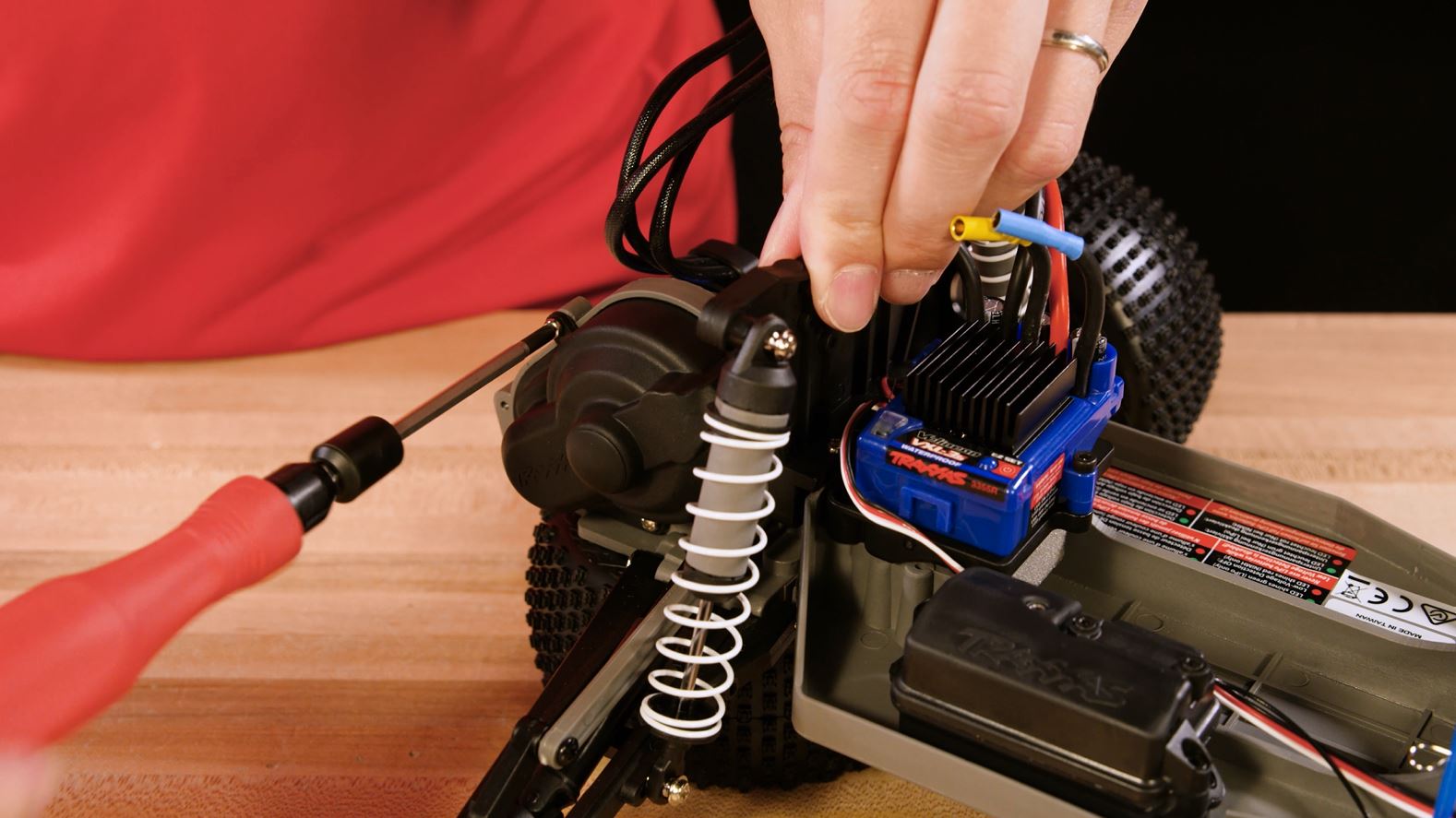

Begin by installing the fixed gear adapter marked "A B." Some models include fixed gear adapters in the kit. These helpful spacers make setting gear mesh as simple as turning a screw. They will also help keep the motor in place despite the massive bump in power. For this gearing, use the hole marked "A." Tighten the motor down and then install the new spur gear.
Install fixed gear adapterInstall fixed gear adapter marked A B

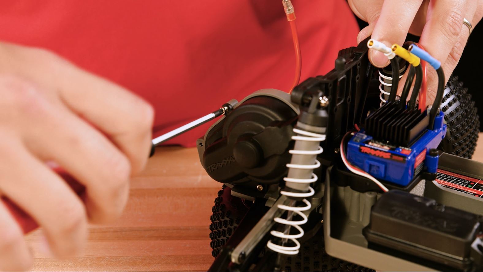

Install the new pinion gear onto the motor shaft. Be sure the set screw has a small amount of blue thread locker on it to prevent loosening. Reinstall the transmission cover and reattach the rear wheel.
Install the new pinion gearInstall the new pinion gear
Reattach the transmission coverReattach the transmission cover
Reattach the rear wheelReattach the rear wheel
