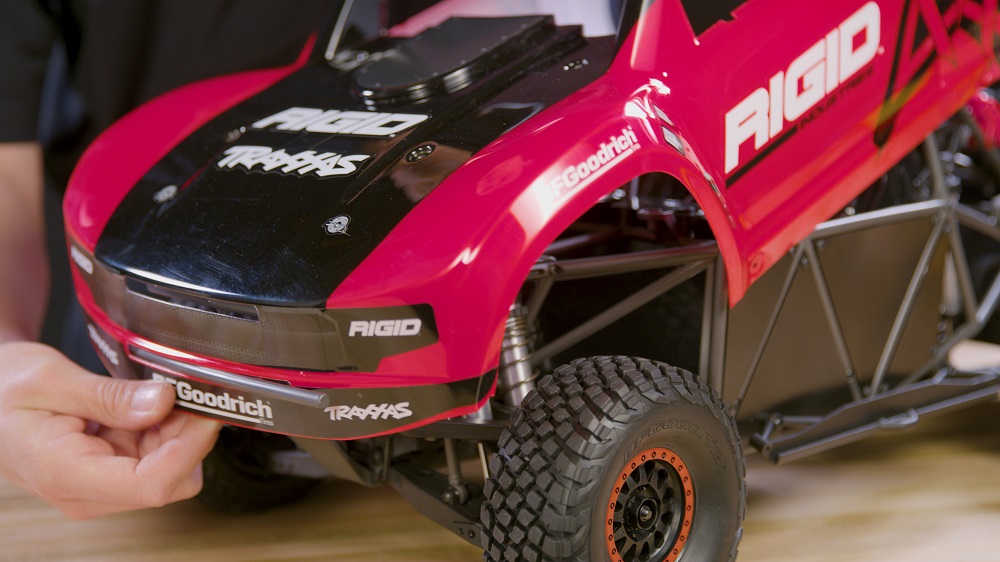

Remove the body
Begin by removing all the screws that secure the Desert Racer body to the frame. Once the body is loose, pull it over the front bumper and set it aside with the screws.

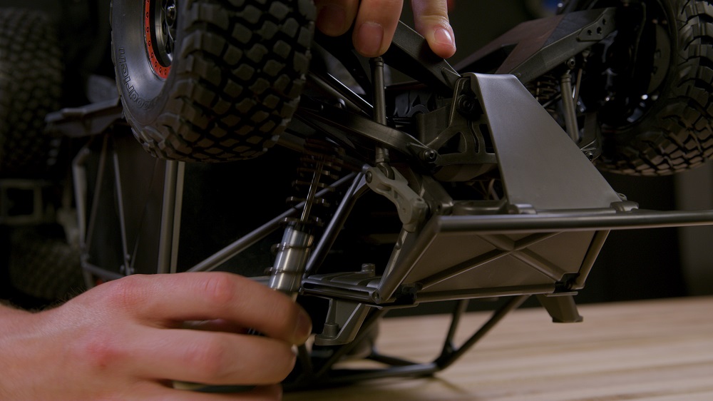

Remove the front bumper
Remove the front bumper and support to access the shock attachment screws. There are three screws securing the support per side.

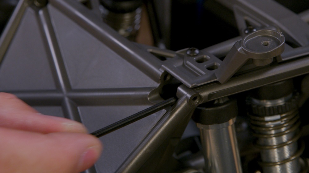

Remove the shock screw
With the support off, remove the long shock attachment screws to release the top of the shocks.

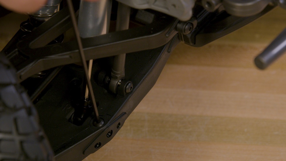

Release the retention screw
To release the bottom of the shock, remove the retention screw directly ahead of the shock closest to the front.

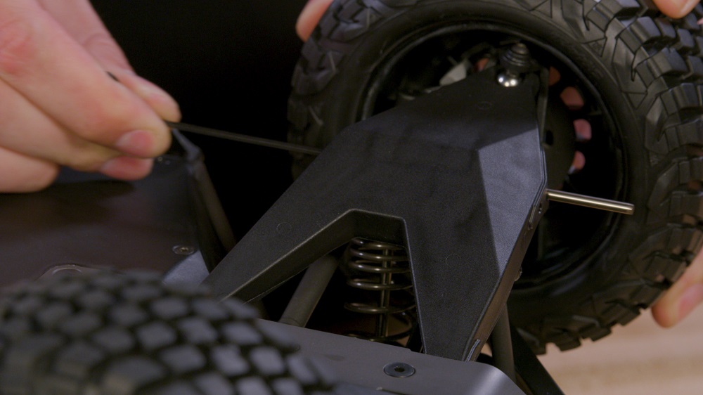

Remove the retaining pin
Flip the truck over and push the retaining pin forward through the rear of the suspension arm. This will release both shocks from the suspension arm.
