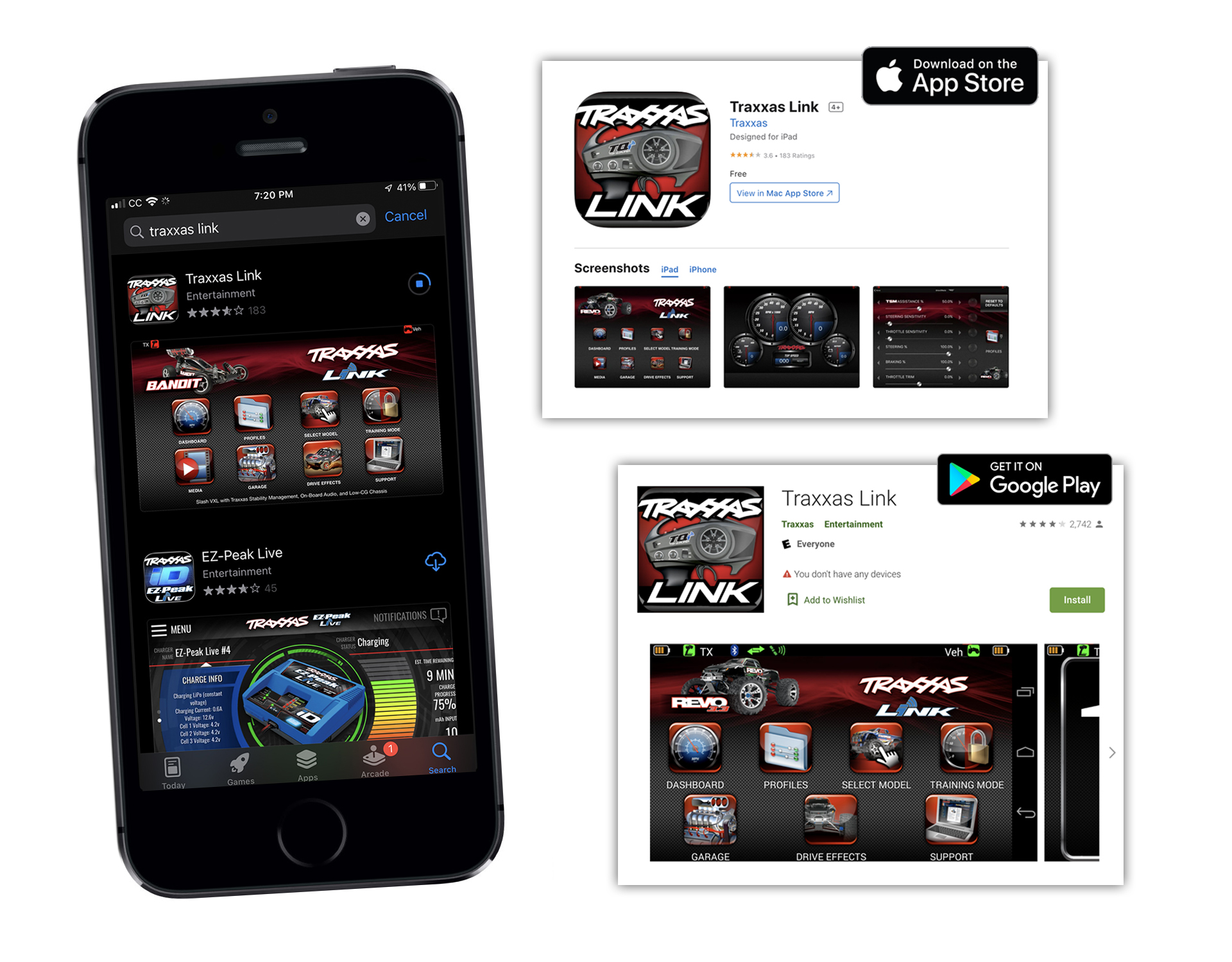

The Traxxas Link app is available via Google Play and the Apple App Store. Simply install it as you would any other app.

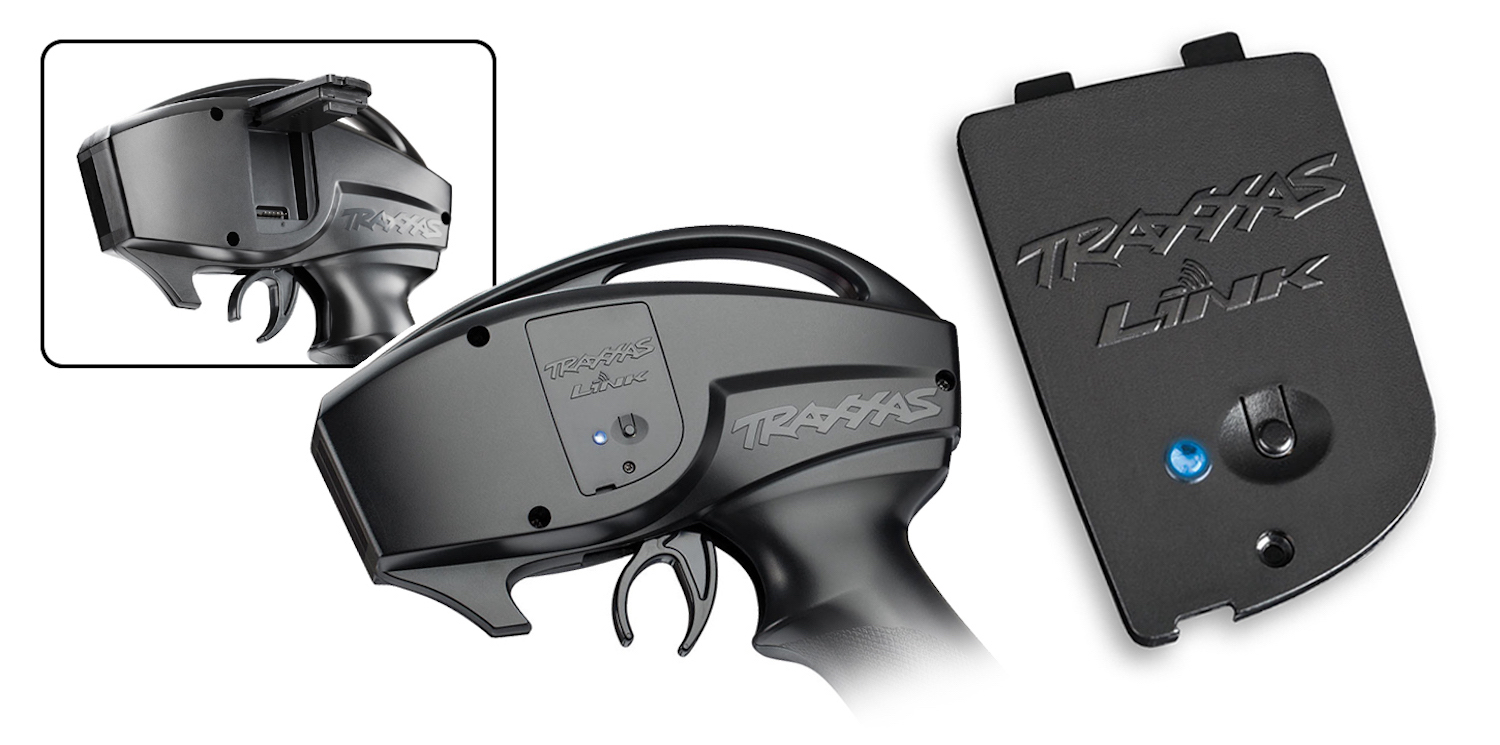

Turn your TQi transmitter over. Using a hobby knife, slice through the decal placed over the module port cover. Use a 1.5 mm hex wrench or driver to remove the screw that secures the cover, then lift the cover out.
Step 3: Install the Traxxas Link Wireless Module
The module simply replaces the cover. Hook the module’s tabs into the port’s slots, then lower it into place and resecure with the 1.5 mm screw.

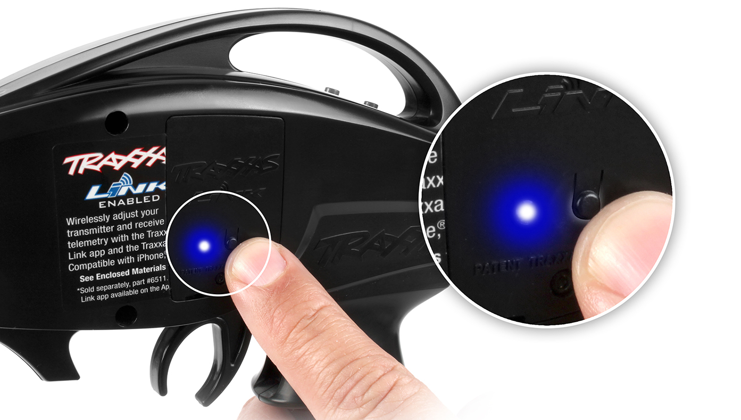

Go to your device’s settings menu and activate Bluetooth. Open the Traxxas Link App and tap the Traxxas Link Wireless Module icon to access the Setup screen. Press the module’s Link button and touch the blue bar on the Setup screen—connection will be nearly instant. Go back to the Home screen and you’ll see the transmitter icon has turned green and the TQi’s battery level is displayed.

Press the Link button on the module.

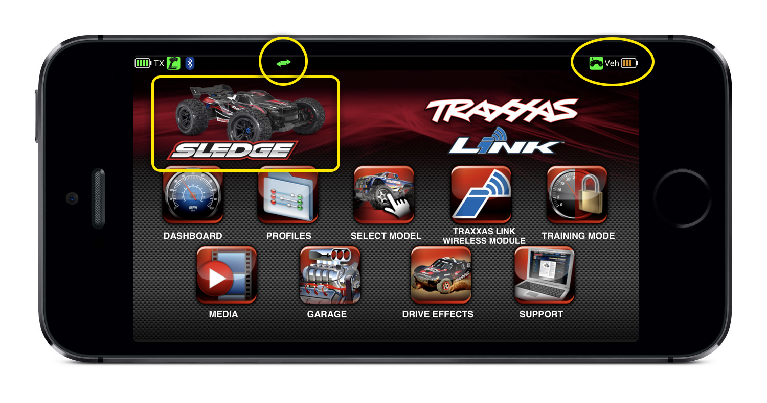

Power up your Sledge. The Traxxas Link home screen will update to show Sledge, the vehicle icon will turn green, and the communication icon will light green to show the transmitter, app, and Sledge are connected. After a moment, the Home screen will also show Sledge’s battery level.
The Home screen instantly updates to show the connected model, communication status, and battery levels.

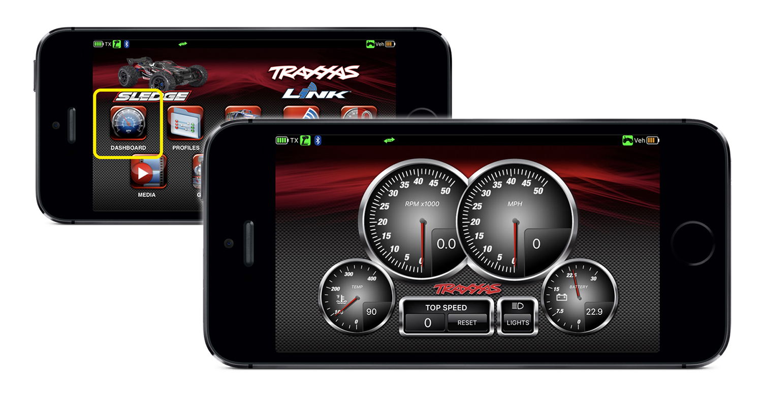

Touch the Dashboard icon to view the default Gauge Cluster design with realistic tachometer, speedometer, speed control temperature, and battery voltage gauges. There is also a window for the saved Top Speed, and the Lights button pulls up controls for compatible Traxxas lighting systems. The Dashboard is fully configured and ready to use, and you’ll see the RPM and MPH needles move as you drive. Of course, you’ll need to keep your eyes on the Sledge, so Traxxas Link records the Dashboard for playback automatically—more on that next.
Tap the Dashboard to view the Gauge Cluster display.

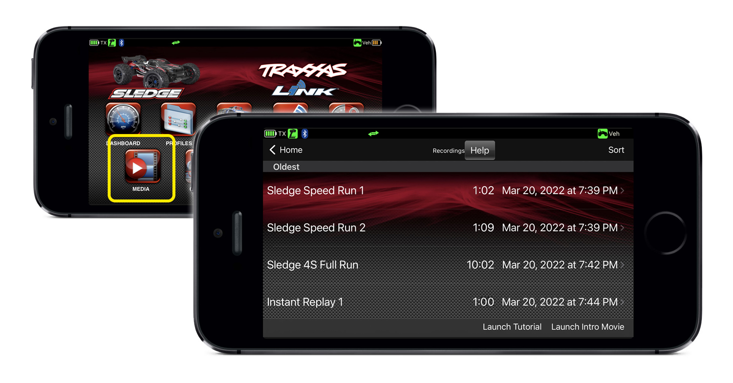

To view your telemetry recordings, go back to the Home screen and tap Media. You’ll see all your recordings listed by the names you’ve given them. Just tap the recording you wish to view. To rename or delete a recording, drag it left and an Edit button will appear.
The Media screen allows you to view, rename, and delete recordings.

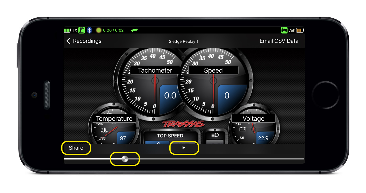

As you view a telemetry recording, you can tap the screen to display a progress bar and controls to pause and share the playback. Slide the bar’s tab to move forward and back through the replay and tap Share to send the paused dashboard image via text or email, or post it to social media (the available social media options will vary depending on which you’ve installed on your device).
The slider makes it easy to quickly scan your recordings.

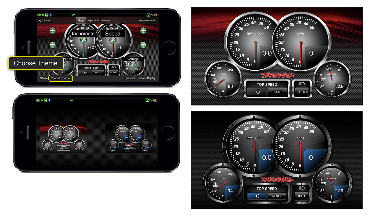

Touch anywhere on the dashboard to view the editing controls. In the lower left corner, touch Choose Theme to change the Gauge Cluster color scheme. In the upper right corner, touch Select Dashboard to choose the Grid Dashboard or Large Digital Speedometer displays. To edit the gauges, just touch the green Plus icon on the gauge you wish to edit. You can change the name of the gauge, set a warning level that will trigger an alert if exceeded, or remove the gauge and install another in its place.
Traxxas Link includes two color schemes for the Gauge Cluster Display.
You can switch from the Gauge Cluster to the Grid Dashboard or Large Digital Speedometer with just a touch.

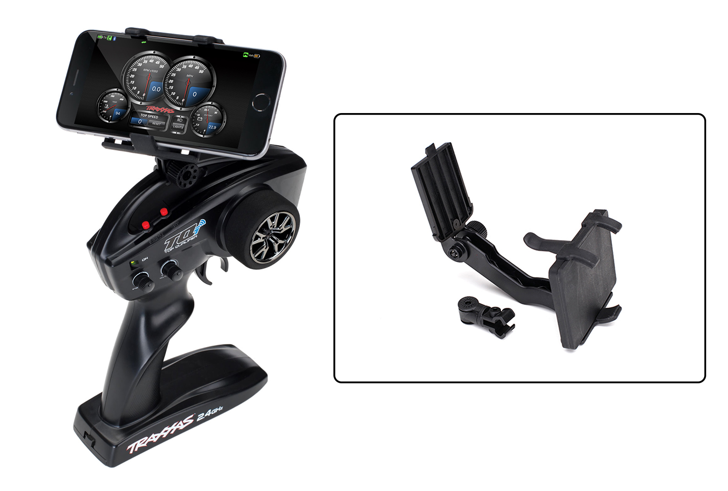

The optional 6532 phone mount installs without tools and holds your device securely for easy viewing and instant app access while you enjoy your Sledge—or any of your other Traxxas Link-enabled models. The padded spring clamp expands to hold larger phones, and the mount swivels and tilts so you can get the viewing angle just right.
