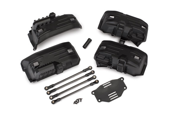

Converting a TRX-4 to a 312 mm wheelbase is easy thanks to the all-inclusive 8058 Chassis Conversion Kit. The kit includes the shorter rear links and half-shaft required for a 312 mm wheelbase, plus front and rear inner fenders and a front battery tray. If you prefer not to use the inner fenders, you can retain the stock shock towers—we’ll cover both setups in this article. Don’t worry if you want to go from a short to a long wheelbase, there’s a kit for that too! The 8057 Chassis Conversion Kit does the job and installs in just the same way as the kit we're showing here.

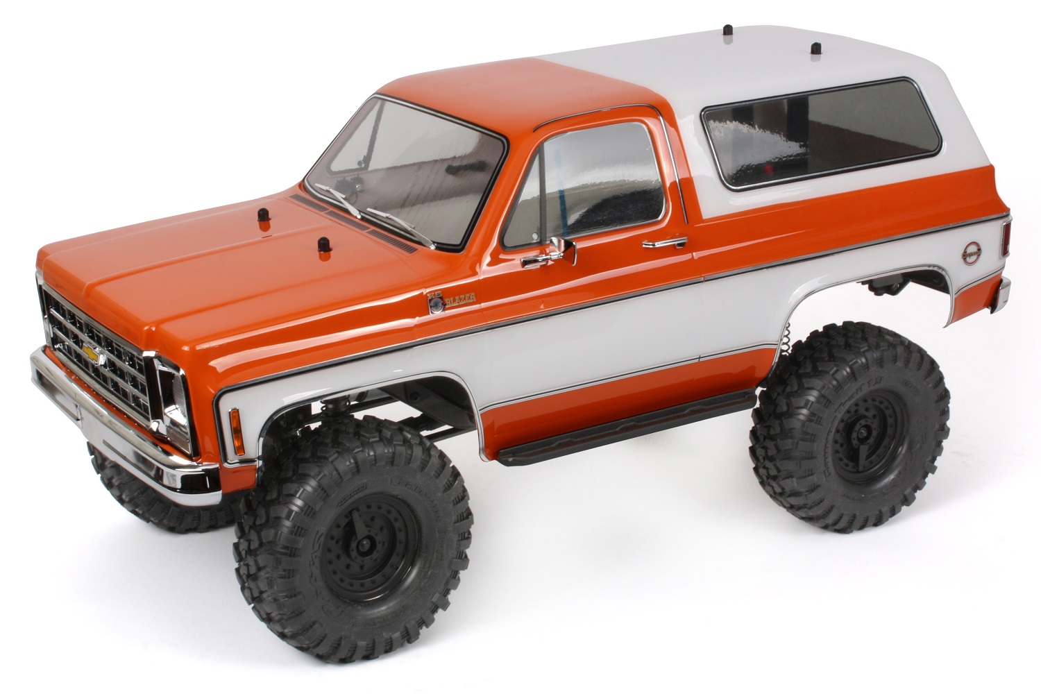

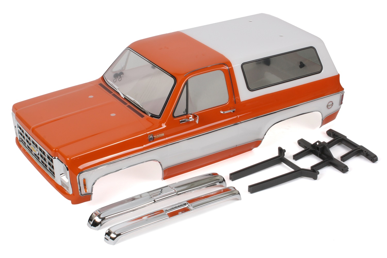

The inner fenders supplied with the 8058 conversion kit are standard width, as used by the Chevy Blazer and Ford Bronco models. If you would like to fit the Sport body to your TRX-4 chassis, you will need to use the 8080 Narrow Inner Fenders. For this how-to, we’re going to convert a Tactical Unit to 312 mm and install the 8130X Chevy K5 Blazer body in orange and white. You can also get the Blazer in red and black, 8130R. Both Blazer body kits come pre-assembled so they're ready to mount right out of the box.
Blazer Body KitBlazer body kit
Orange Blazer bodyOrange Blazer body

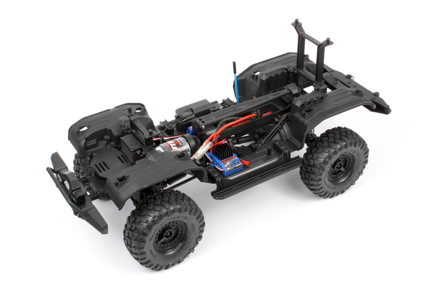

1) Begin by removing the body and wheels. Next, remove the four screws that secure the front and rear body mounts. Set the body mounts aside.
Remove the body and wheelsRemove the body and wheels
Remove the front body mountRemove the front body mount
Remove the rear body mountRemove the rear body mount

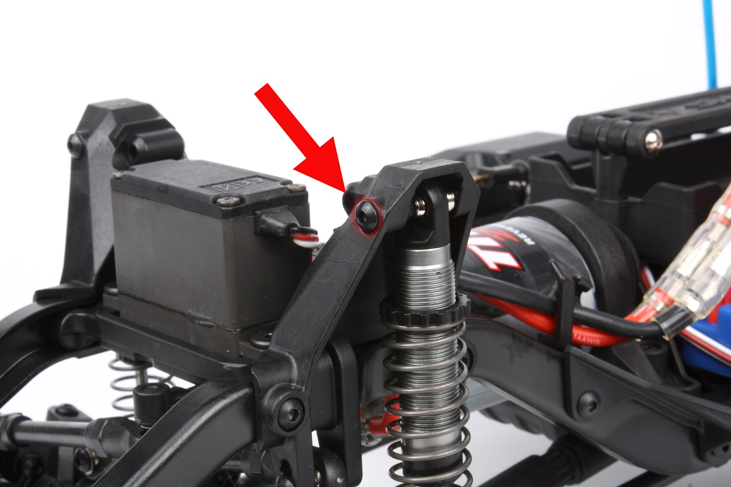

2) Remove the screws that secure the shocks to the shock towers.
Remove the front shocksRemove the front shocks
Remove the rear shocksRemove the rear shocks

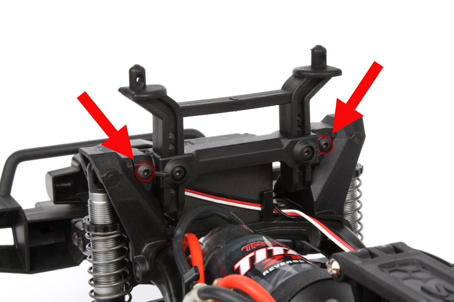

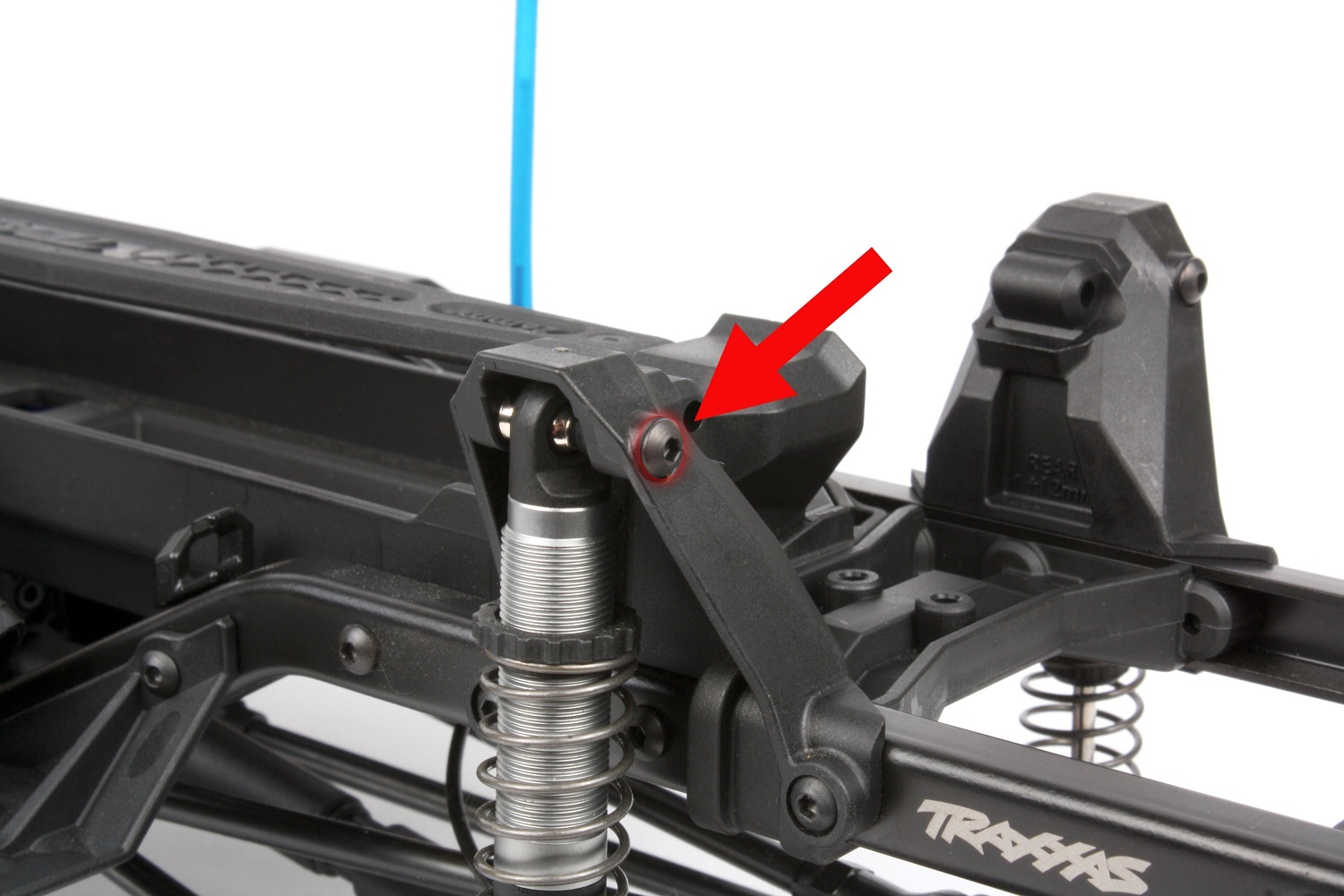

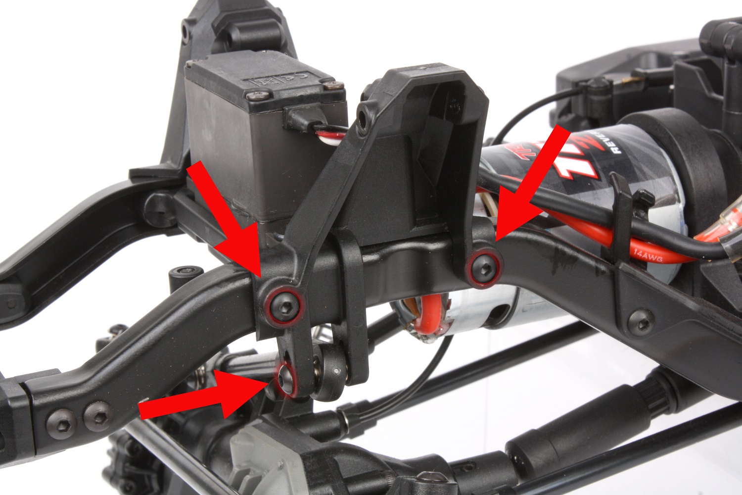

3) Remove the screws shown from each of the shock towers, and remove the Panhard bar screw from the left front shock tower. Also remove the screw that passes through the chassis rail into the battery tray.
Remove the front shock towersRemove the front shock towers
Remove the rear shock towersRemove the rear shock towers

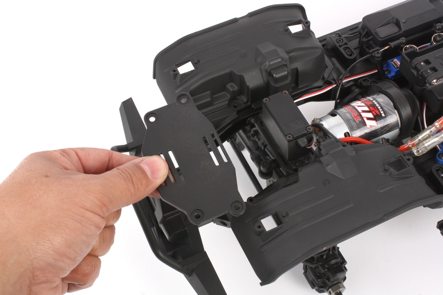

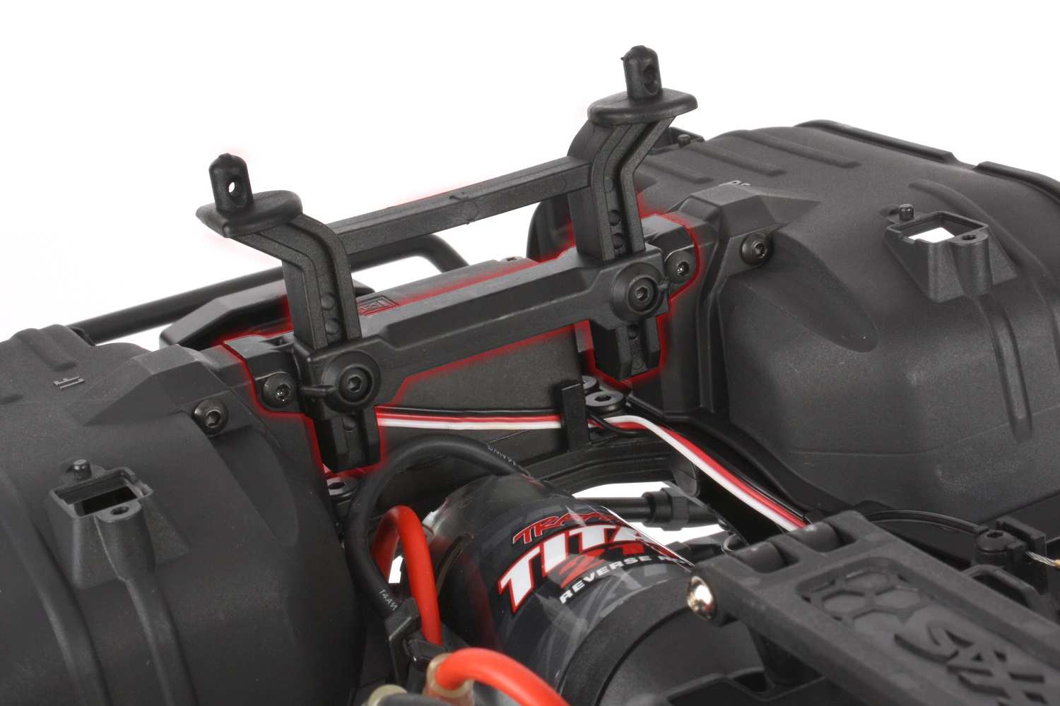

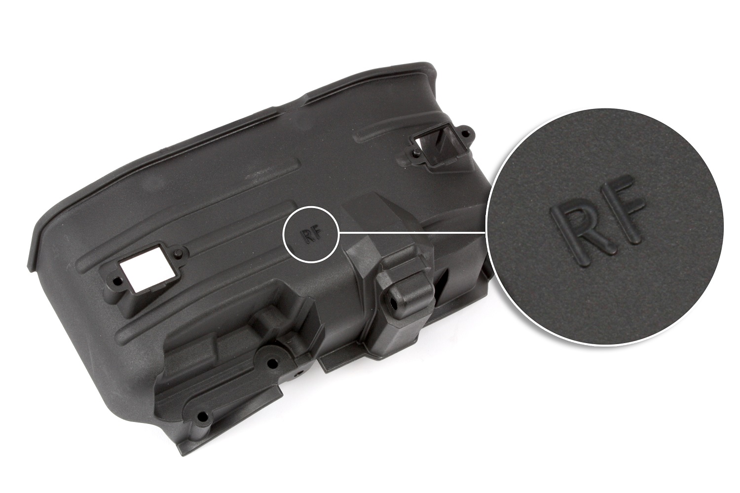

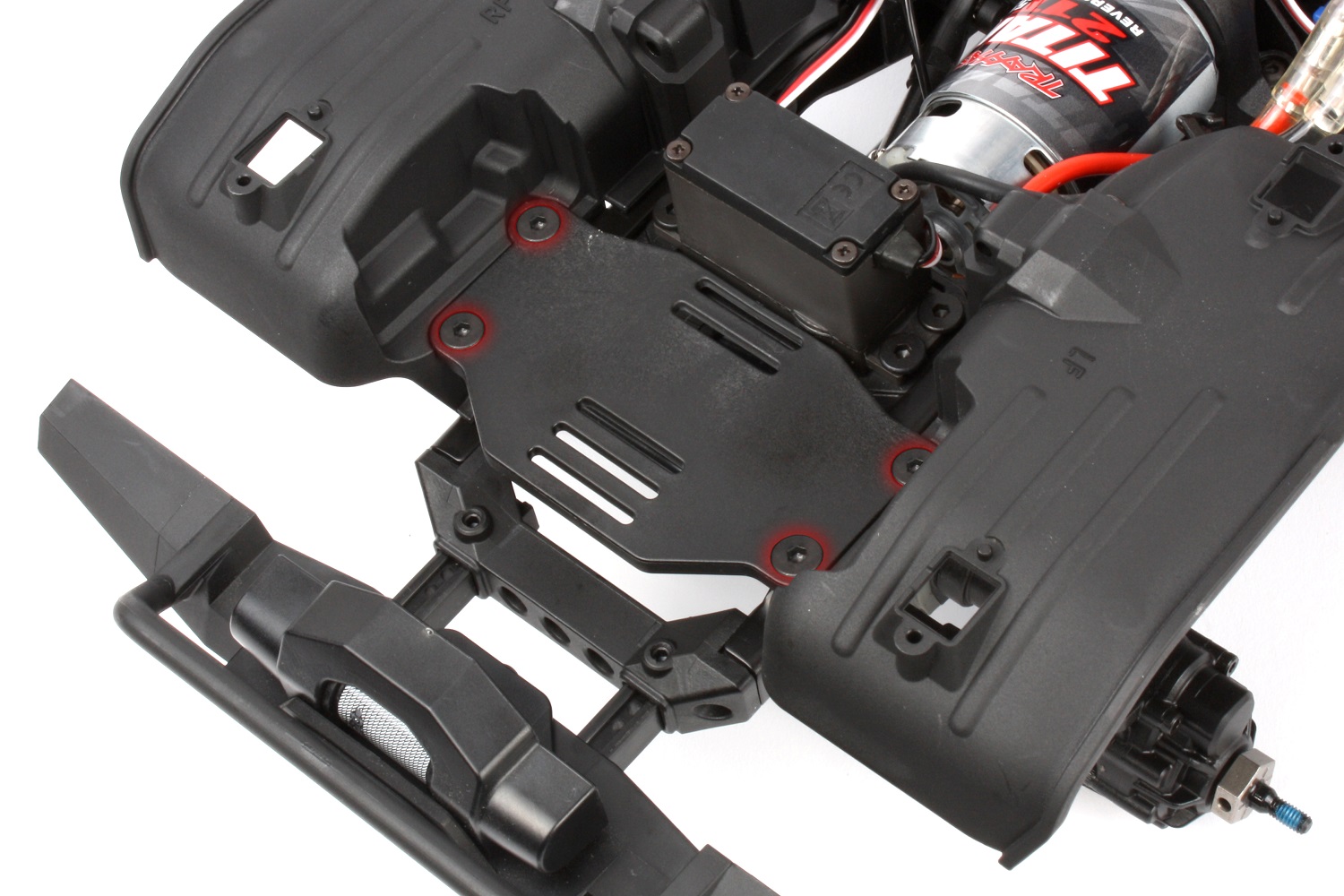

4) Install the inner fenders in place of the shock towers, using the hardware removed in step 3. Note that the fenders are labeled RF (Right Front), LF (Left Front), etc. for goof-proof placement. Next, install the front battery tray using the supplied 5x8 mm flat-head screws.
Check the labelCheck the label
Install the battery trayInstall the battery tray

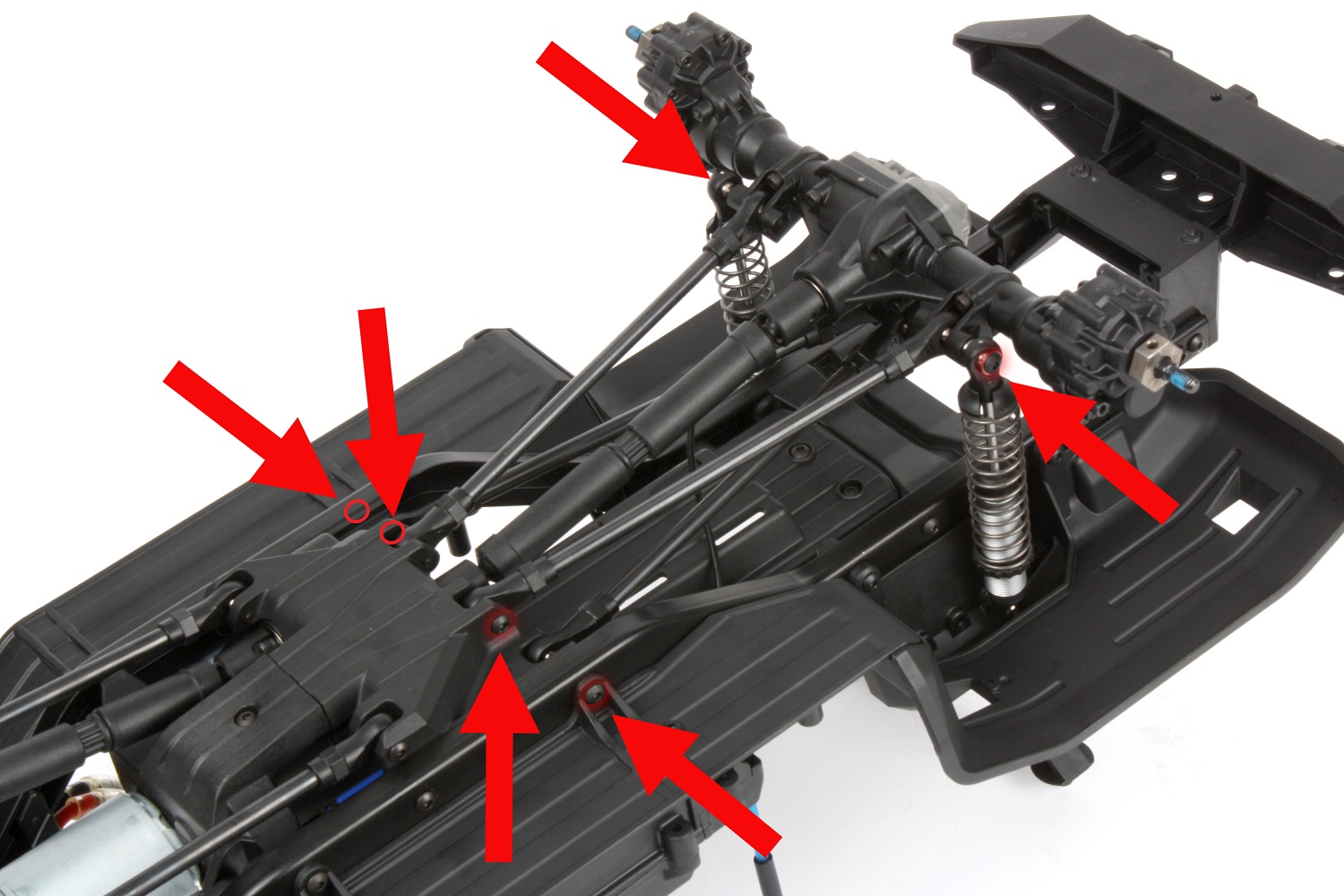

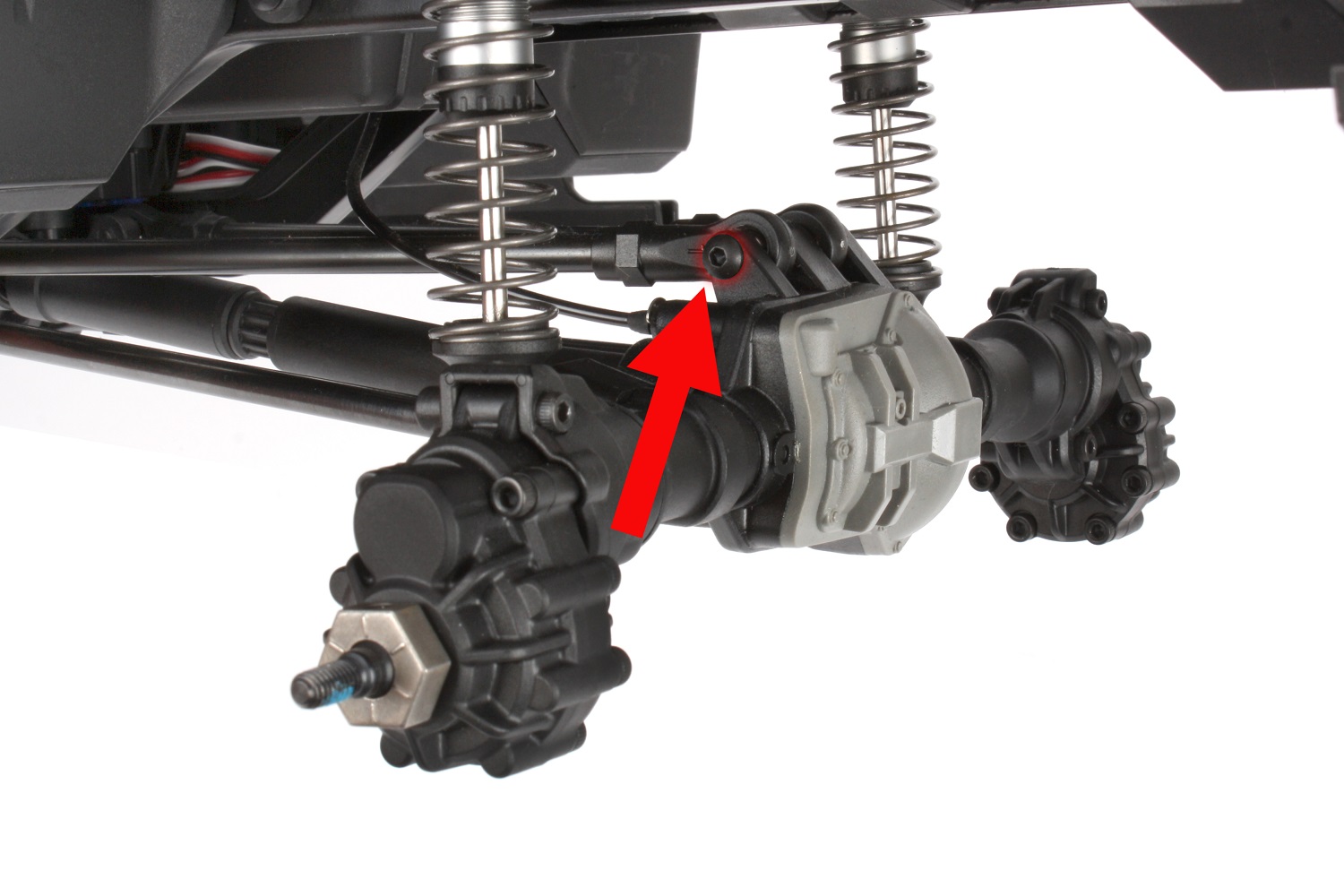

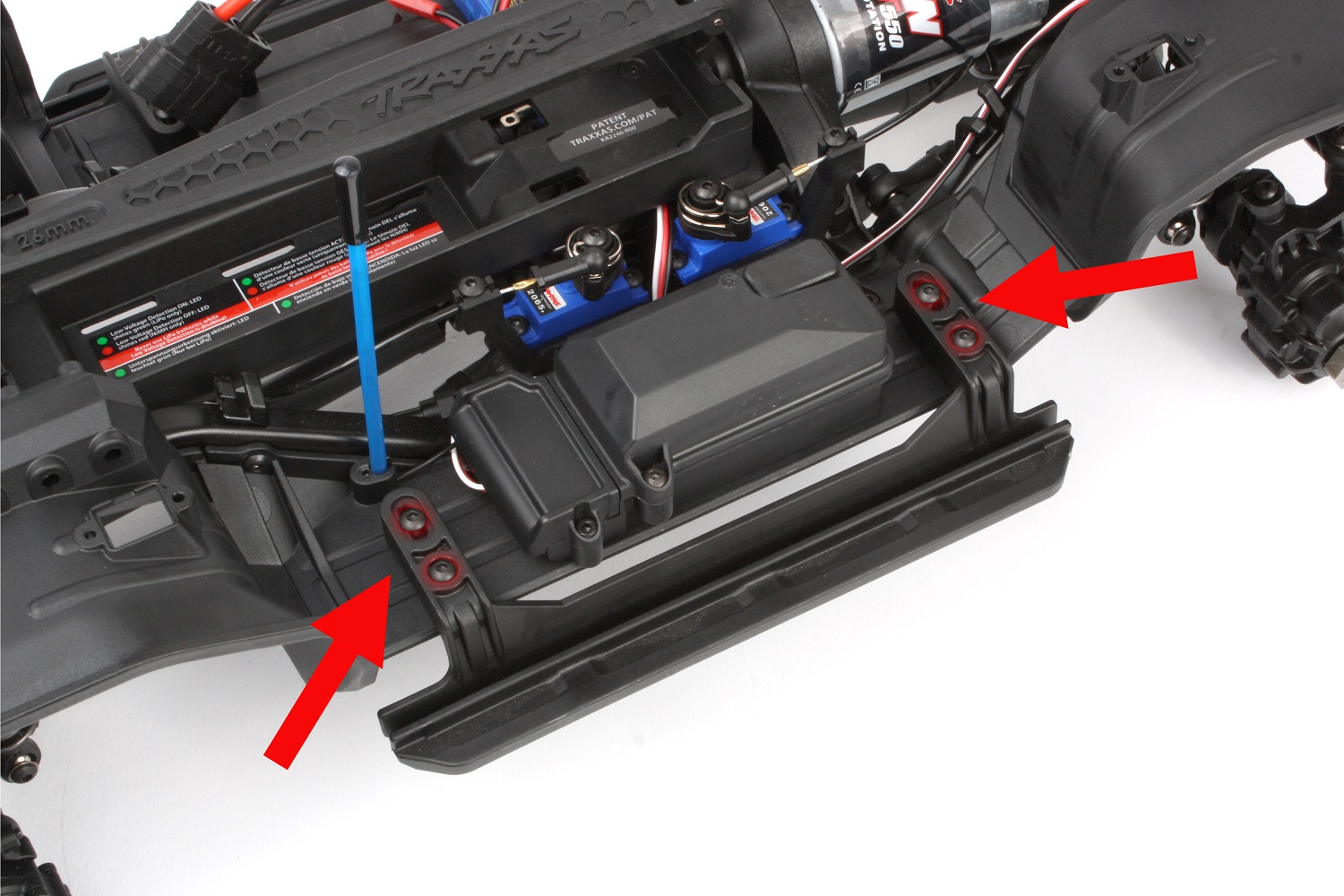

6) Remove the screw that secures the rear upper links to the rear axle. Next, remove the rock sliders for easier access to the screws we’ll be taking out in the next step. Four screws secure each rock slider. Finally, flip the chassis over and remove the screws that secure the lower links to the axle, and remove the screws that secure the upper and lower links to the chassis.
Remove the axle screwRemove the axle screw
Remove the rock slidersRemove the rock sliders
Remove the link screwsRemove the link screws

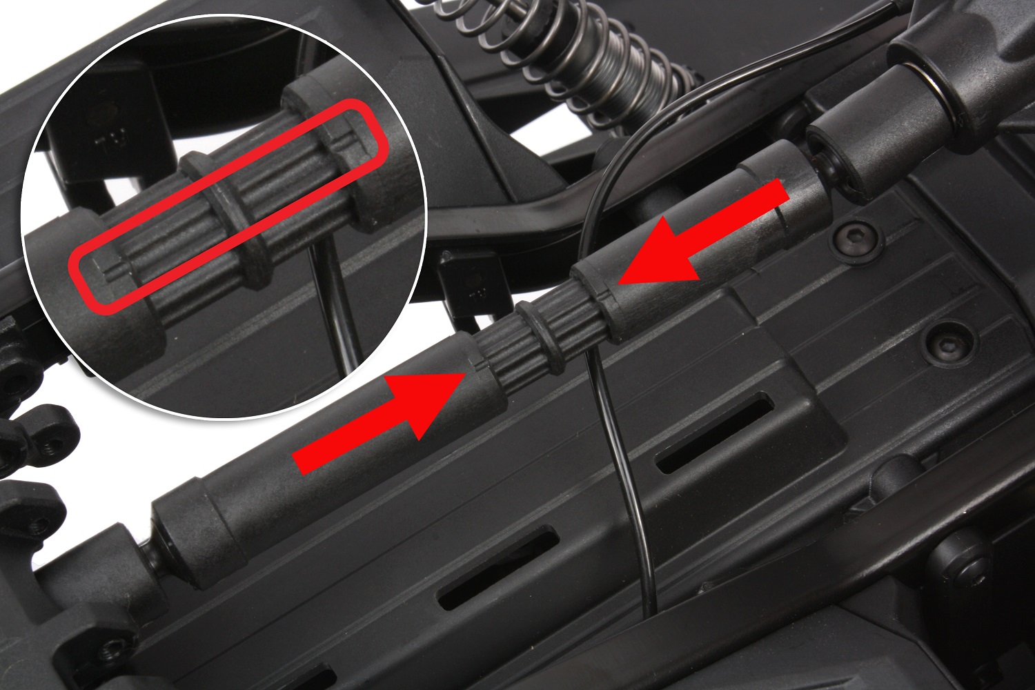

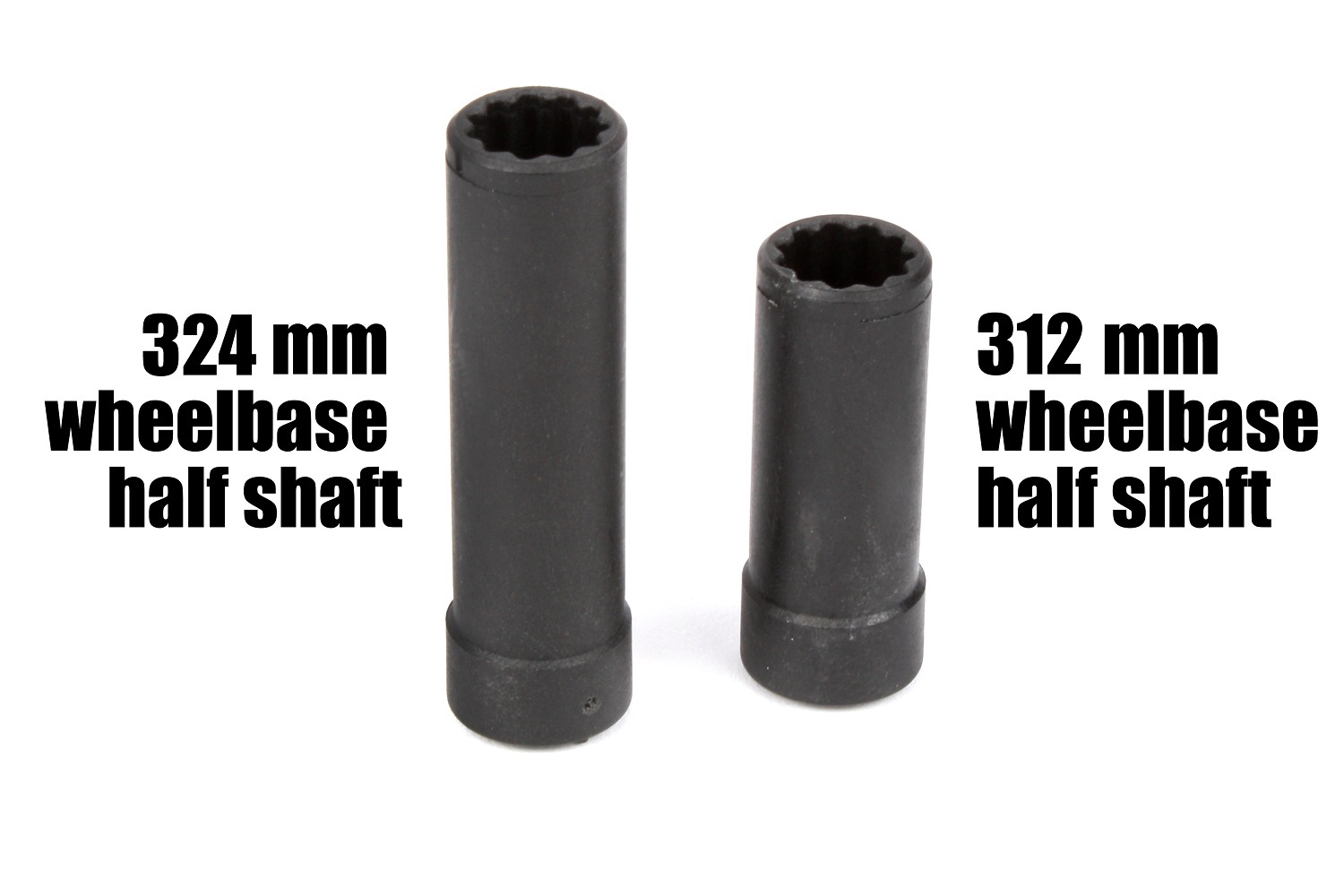

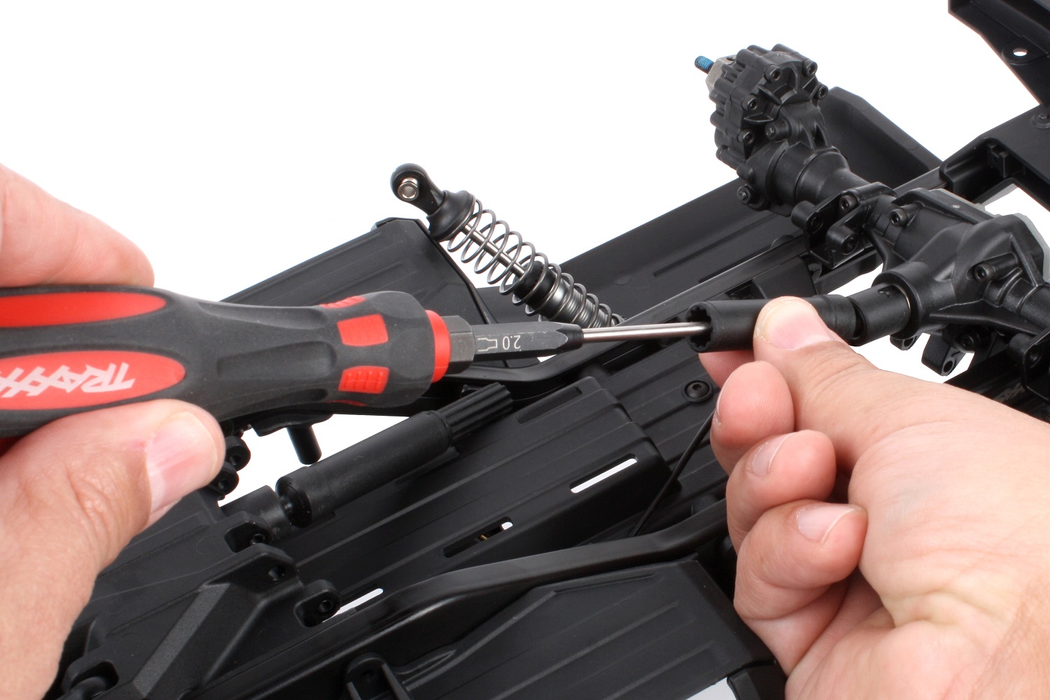

7) Separate the female half shaft on the axle side of the driveshaft, and remove the half shaft by inserting a 2 mm driver into the shaft and removing the screw that secures it to the input drive. Install the shorter female half shaft supplied with the conversion kit, and reassemble the driveshaft. Be sure to line up the alignment marks molded into the driveshaft halves.
Remove the halfshaftRemove the halfshaft
Halfshaft comparisonHalfshaft comparison
Align the halfshaftsAlign the halfshafts

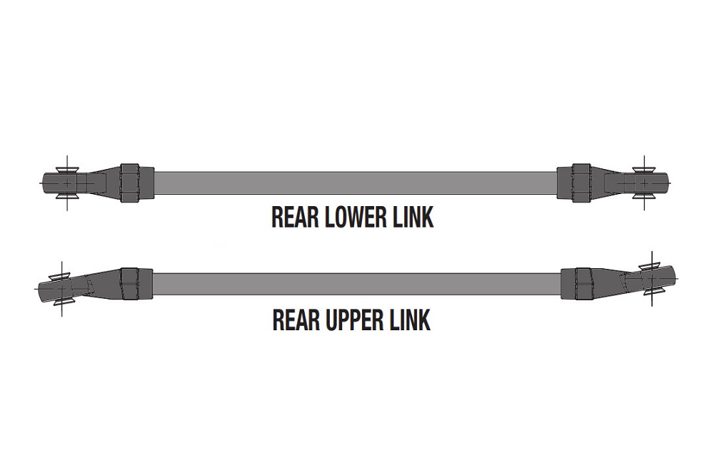

8) Reverse the procedure in step 6 to replace the stock links with the new, shorter links supplied in the conversion kit. Note that the upper links have angled rod ends, while the lower links have straight ends. Turn the chassis right side up. Reinstall the rock sliders and wheels, and your TRX-4 is ready for the body of your choice.

Since we started with a TRX-4 Tactical Unit, the chassis already had the long rear body posts installed. The Blazer body kit includes the longer posts in case you need them. That marks the end of our TRX-4 wheelbase conversion! If you're not using the inner fenders in the conversion kit, read the next section to see how to convert your truck without them.
Finished BlazerHere is the finished Blazer

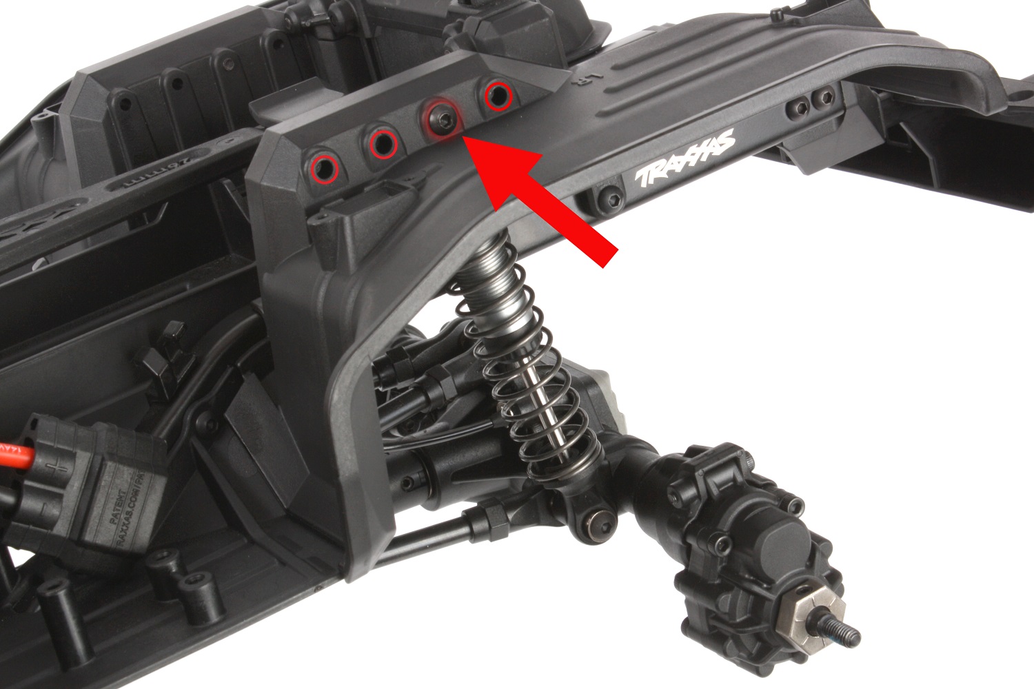

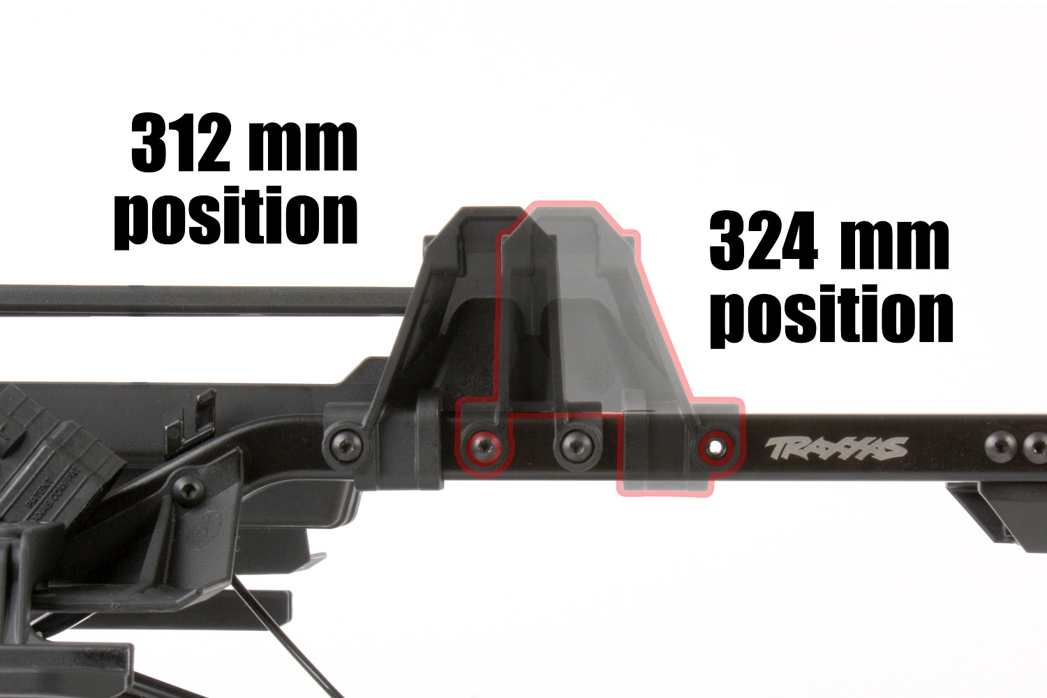

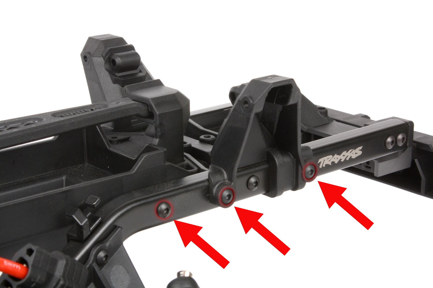

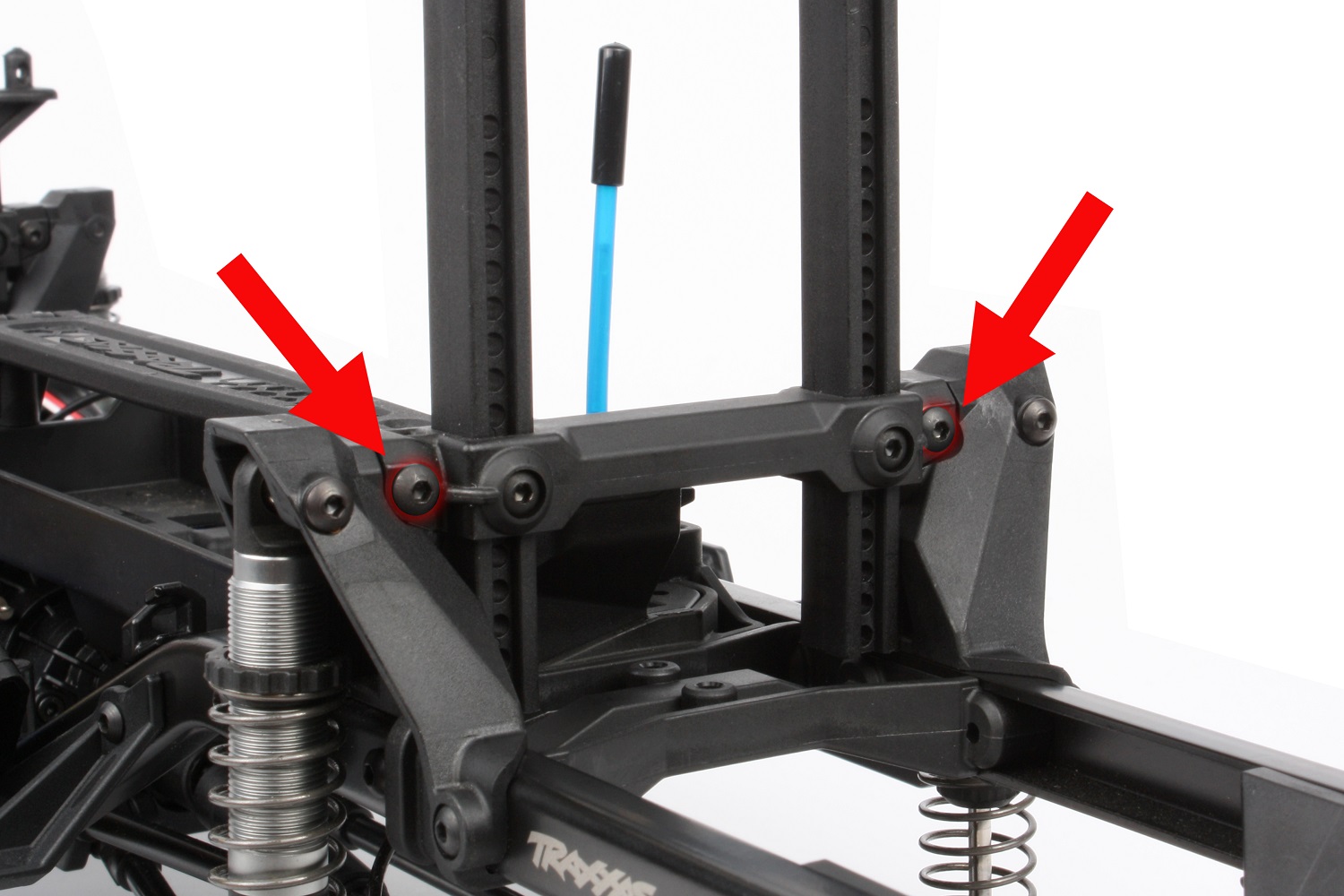

2) Remove the screws that secure the shocks to the rear shock towers. Next, remove the screws shown from each side of the chassis, and remove the rear shock towers. Finally, swap the shock tower positions from left to right, and reinstall the towers on the chassis “one hole forward” from their previous positions, as shown. Reinstall the 3x23 mm screws that secure the shocks to the towers.
Unscrew the rear shocksUnscrew the rear shocks
Rear shock tower positionRear shock tower position
3) Remove the screw that secures the rear upper links to the rear axle. Next, flip the chassis over and remove the screws that secure the lower links to the axle, and remove the screws that secure the upper and lower links to the chassis.

4) Separate the female half shaft on the axle side of the driveshaft, and remove the half shaft by inserting a 2 mm driver into the shaft and removing the screw that secures it to the input drive. Install the shorter female half shaft supplied with the conversion kit, and reassemble the driveshaft. Be sure to line up the alignment marks molded into the driveshaft halves.

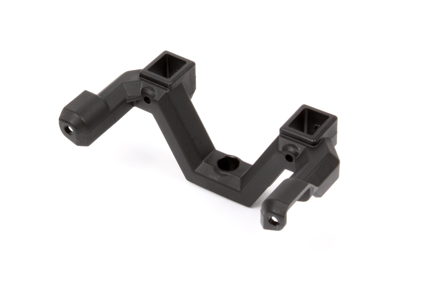

5) Reverse the steps in part 3 to replace the stock links with the new, shorter links supplied in the conversion kit. Note that the upper links have angled rod ends, while the lower links have straight ends. Turn the chassis right side up. Install the offset body mount supplied with 8215 body mount set using the 3x20 mm screws you removed in step 2, and an additional 3x8 mm screw where the mount attaches to the chassis crossmember. Transfer your TRX-4’s original body posts to the new body mount.
Replace the stock linksReplace the stock links
Install offset body mountInstall offset body mount
Install body postsInstall body posts
