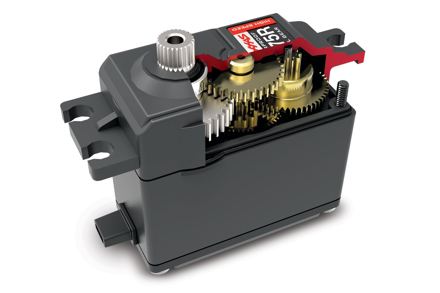

Boost the durability and steering authority of your Traxxas Slash® 2WD model by replacing the included plastic-gear 2075 steering servo with an optional Traxxas metal-gear servo. Installation only takes a few minutes, and it’s easy to do.
2075R cutaway view
We’ll be installing a 2075R servo, which improves durability with its metal gears and offers quicker steering compared to the standard 2075 and optional 2075X. Or, you can dramatically increase steering power with the 2250 and 2255 servos, which offer 164% and 220% more steering torque respectively over the Slash’s standard 2075 servo. Each of these servos is a drop-in fit for the Slash. Follow along with the steps below, or watch the full video.

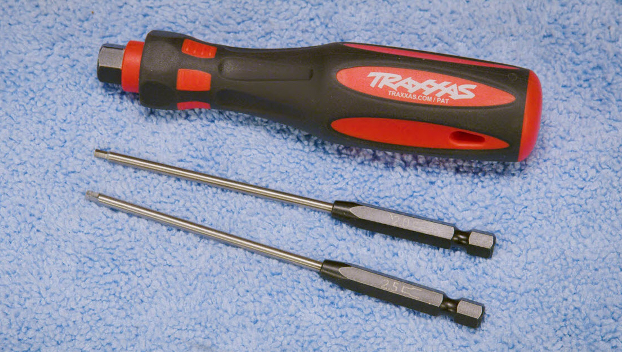

You’ll need 2.5 mm and 2 mm hex drivers to install the servo. The Traxxas 7-Piece Metric Hex and Nut Driver Essentials Set 8712 includes all the bits you need (and more), and comes complete with a convenient storage case.

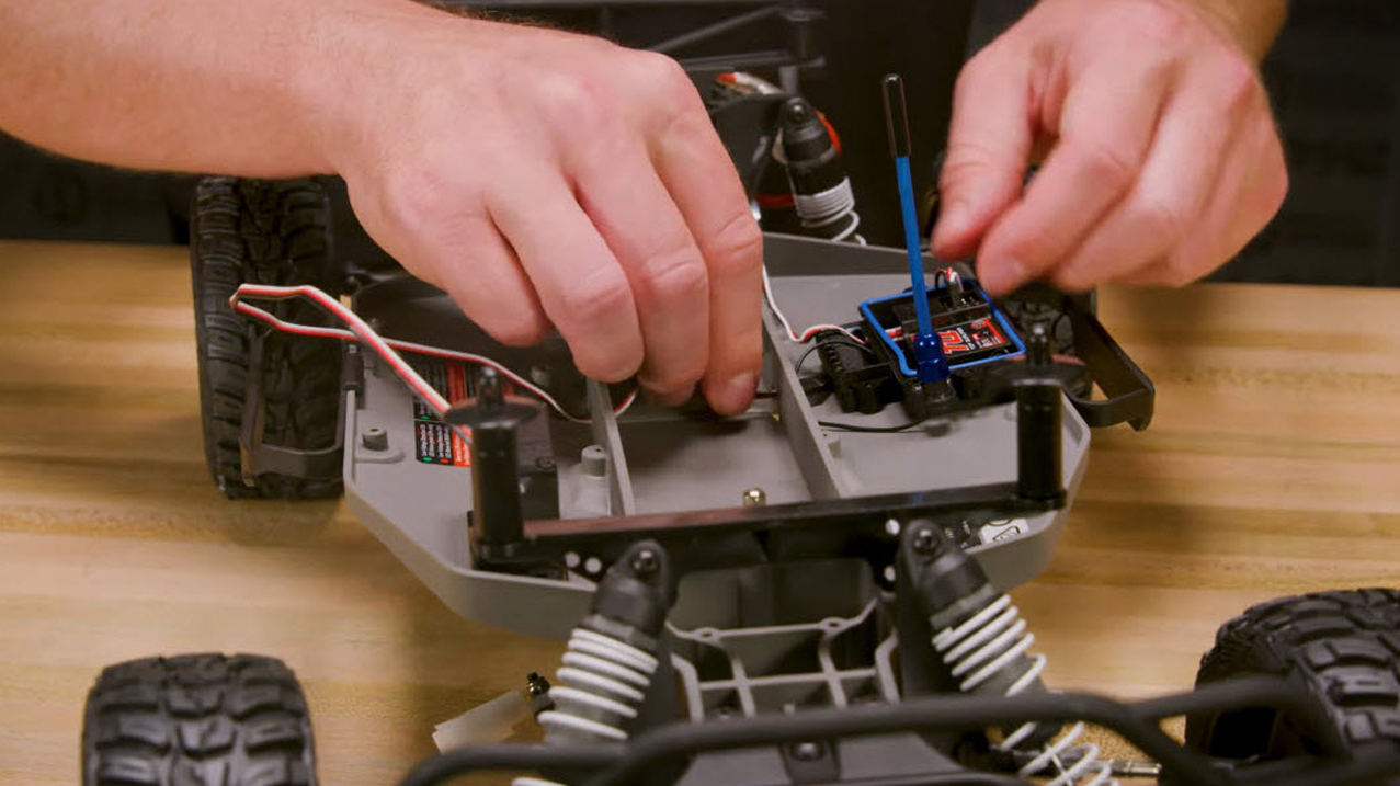

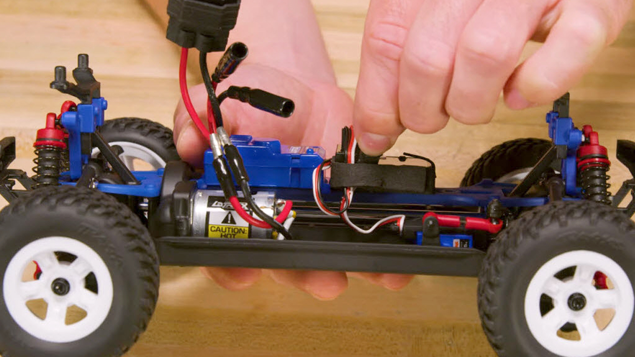

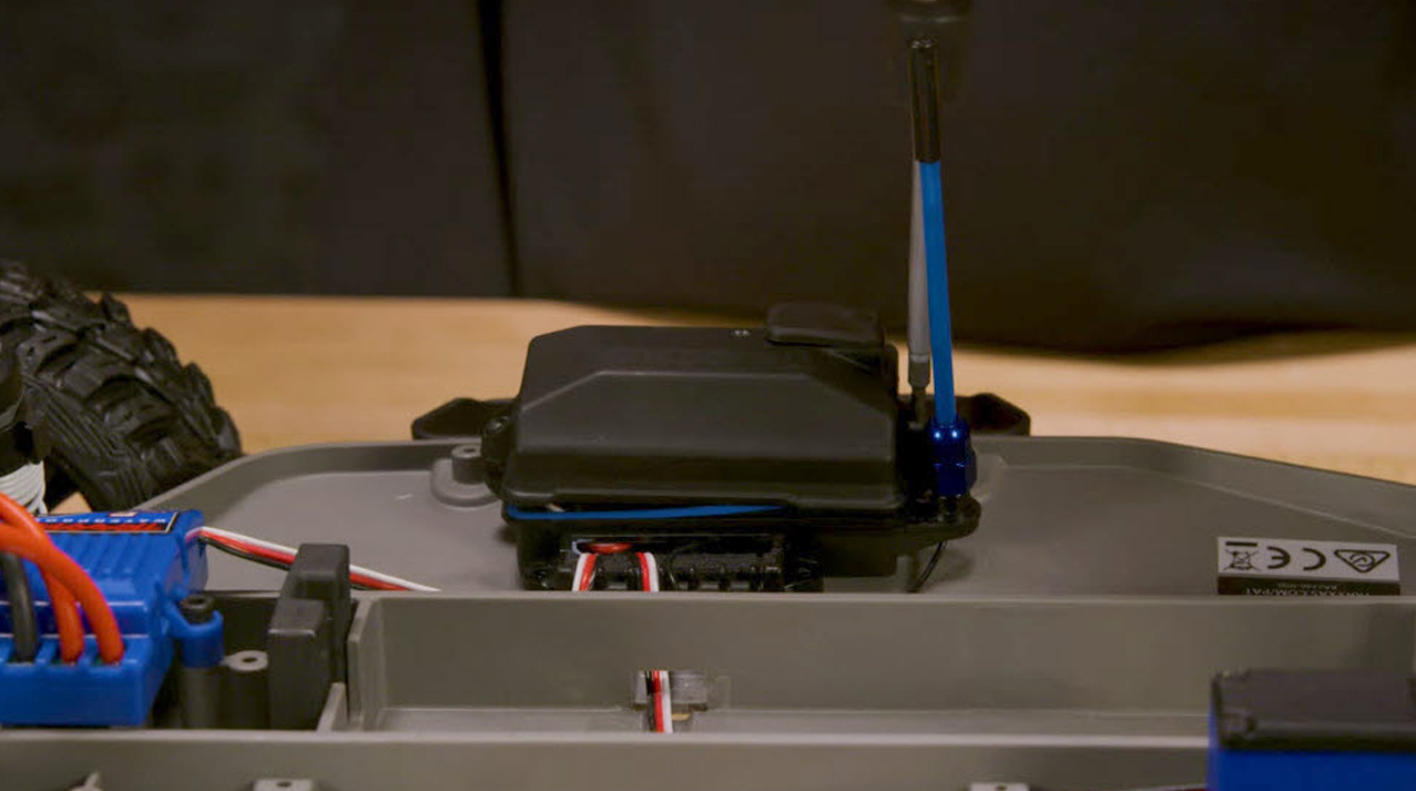

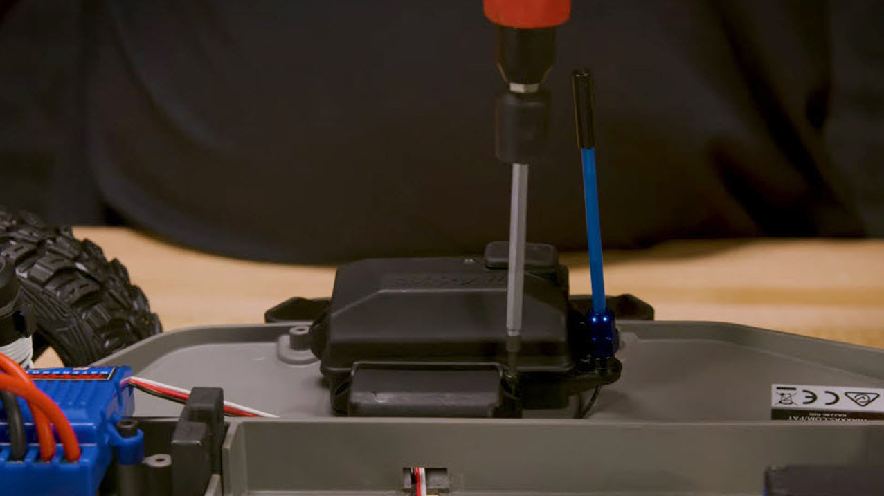

Begin by removing the body and the battery. Access the receiver by using the 2 mm driver to remove the screws that secure the wire clamp and the receiver box cover.
Remove the Body and BatteryRemove the Body and Battery
Unscrew the Receiver Box CoverUnscrew the Receiver Box Cover
Remove the Box CoverRemove the Box Cover

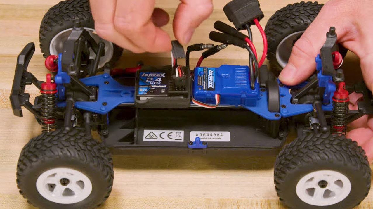

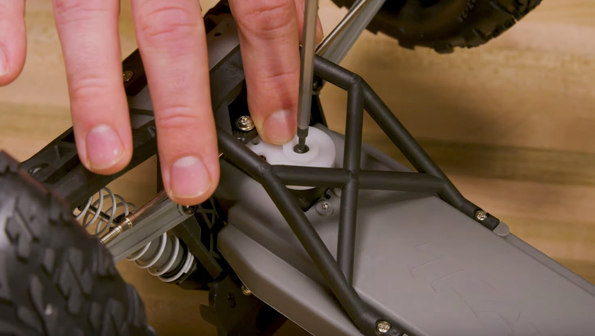

Unplug the steering servo. It is plugged into the channel-one (CH1) port. Pull on the plug to remove it, do not tug directly on the wires. Thread the servo wire out through the receiver box and the slots in the chassis. If your model has clear tape over the chassis’ wire clearance slot, you may remove it. Turn the model over and use a 2 mm driver to remove the screw that secures the servo saver. Pull straight up on the servo saver to remove it.

Remove the Servo SaverRemove the Servo Saver

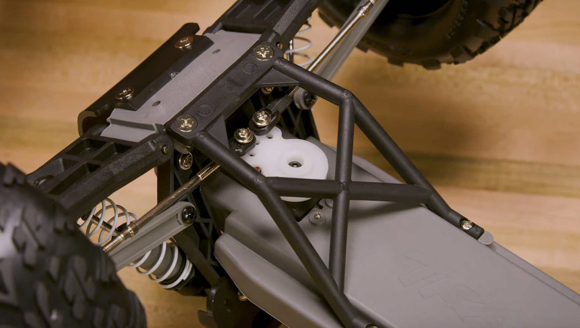

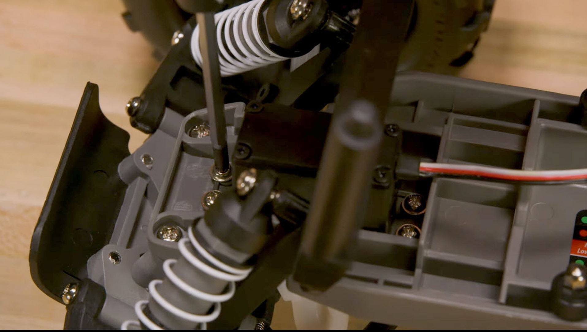

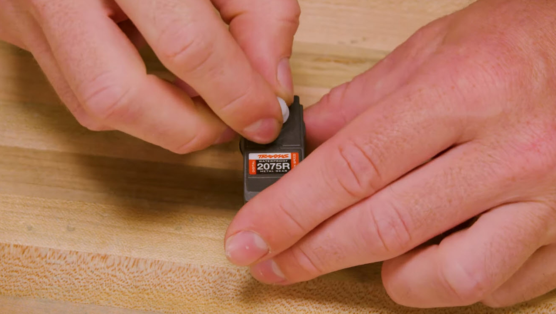

The servo-saver adapter may remain on the servo. Use a flat-blade screwdriver to gently pry it off if you cannot remove it with your fingers. Press the servo-saver adapter onto the new servo’s output shaft. Use a 2.5 mm driver to remove the four screws that secure the steering servo, and lift it out of the chassis.
Remove the Servo Saver AdapterRemove the Servo Saver Adapter
Place the Adapter on the New ServoPlace Adapter on New Servo

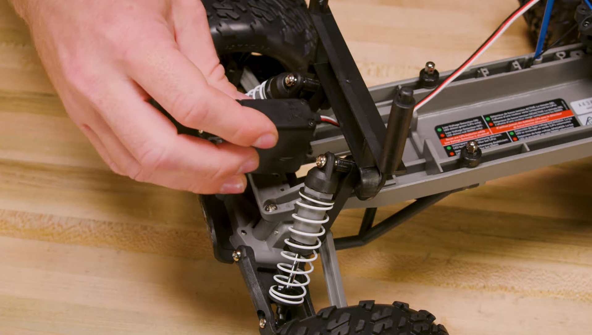

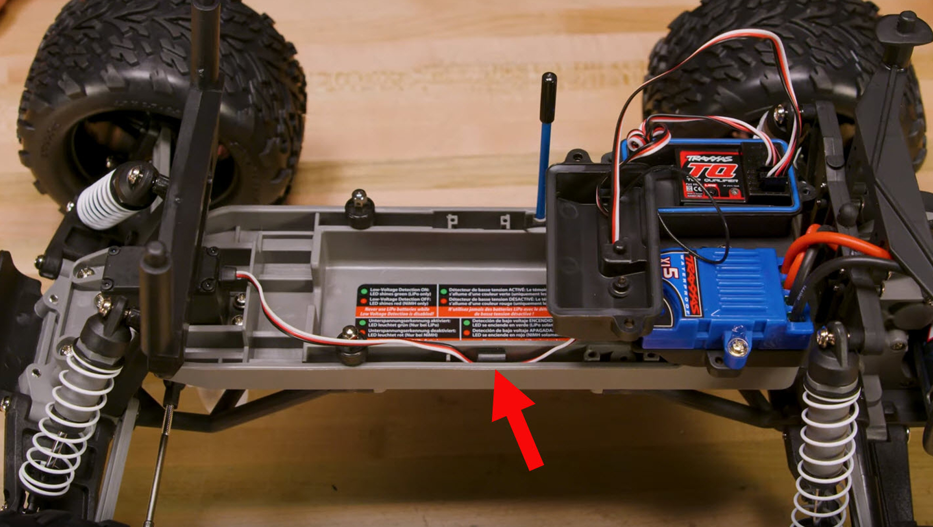

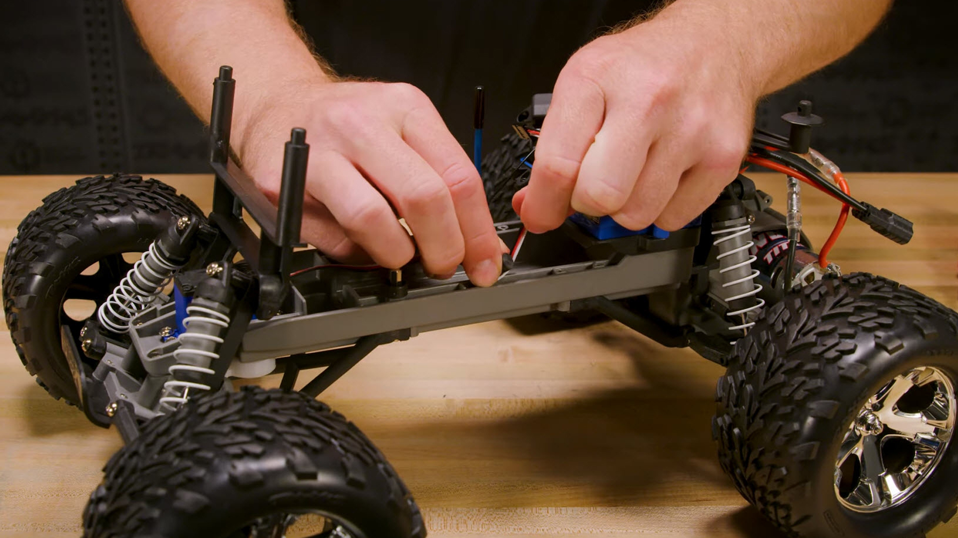

Insert the new servo into the chassis and secure it using the screws you just removed. Position the servo so the servo wire faces the front of the model as shown. Thread the servo wire through the battery tray slots and into the receiver box via the wire-clamp slot.
Place Servo into PositionPlace Servo into Position
Ensure Proper OrientationEnsure Proper Orientation
Route the Servo WireRoute the Servo Wire

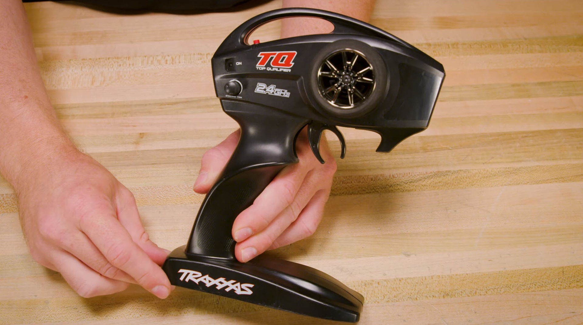

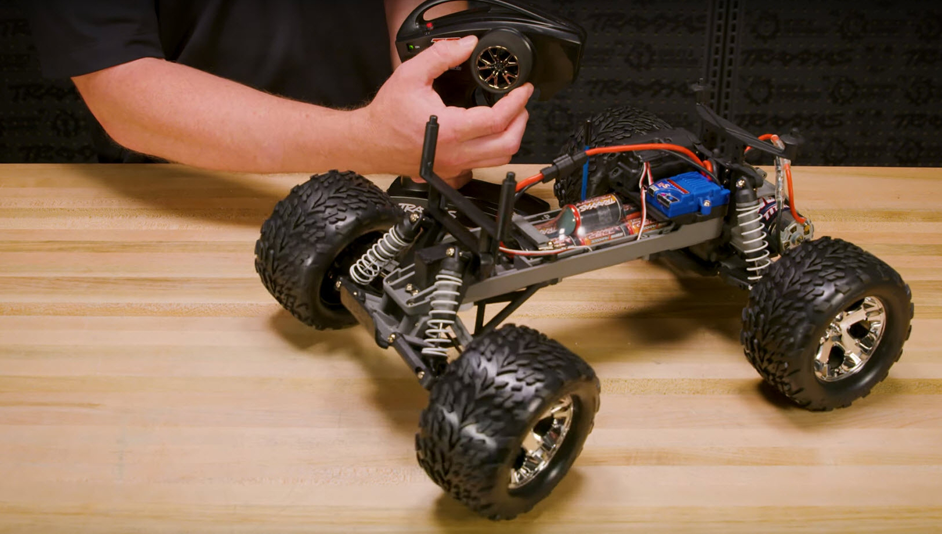

Plug the servo info the channel-one (CH1) port. There are two CH1 ports, you can use either one. Reinstall the receiver box cover first, followed by the wire clamp. Carefully bundle any excess wire so it is not pinched by the cover, and make certain the blue O-ring that seals the receiver box is properly seated in its channel before securing the cover. We need to “center” the steering servo before reattaching the servo saver. Power-on the transmitter and your model.
Plug Servo in ReceiverPlug Servo in Receiver
Seal Receiver BoxSeal Receiver Box
Power On Transmitter and VehiclePower On Transmitter and Vehicle

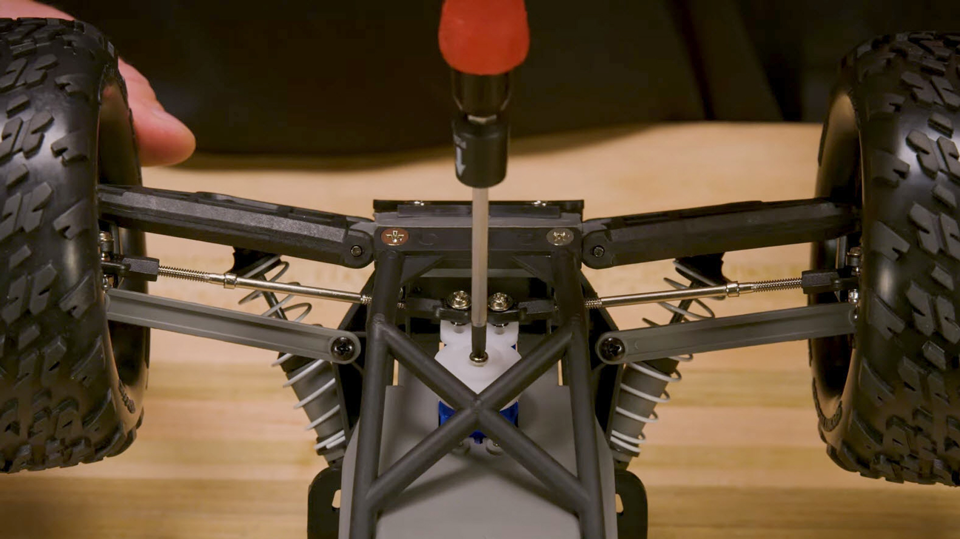

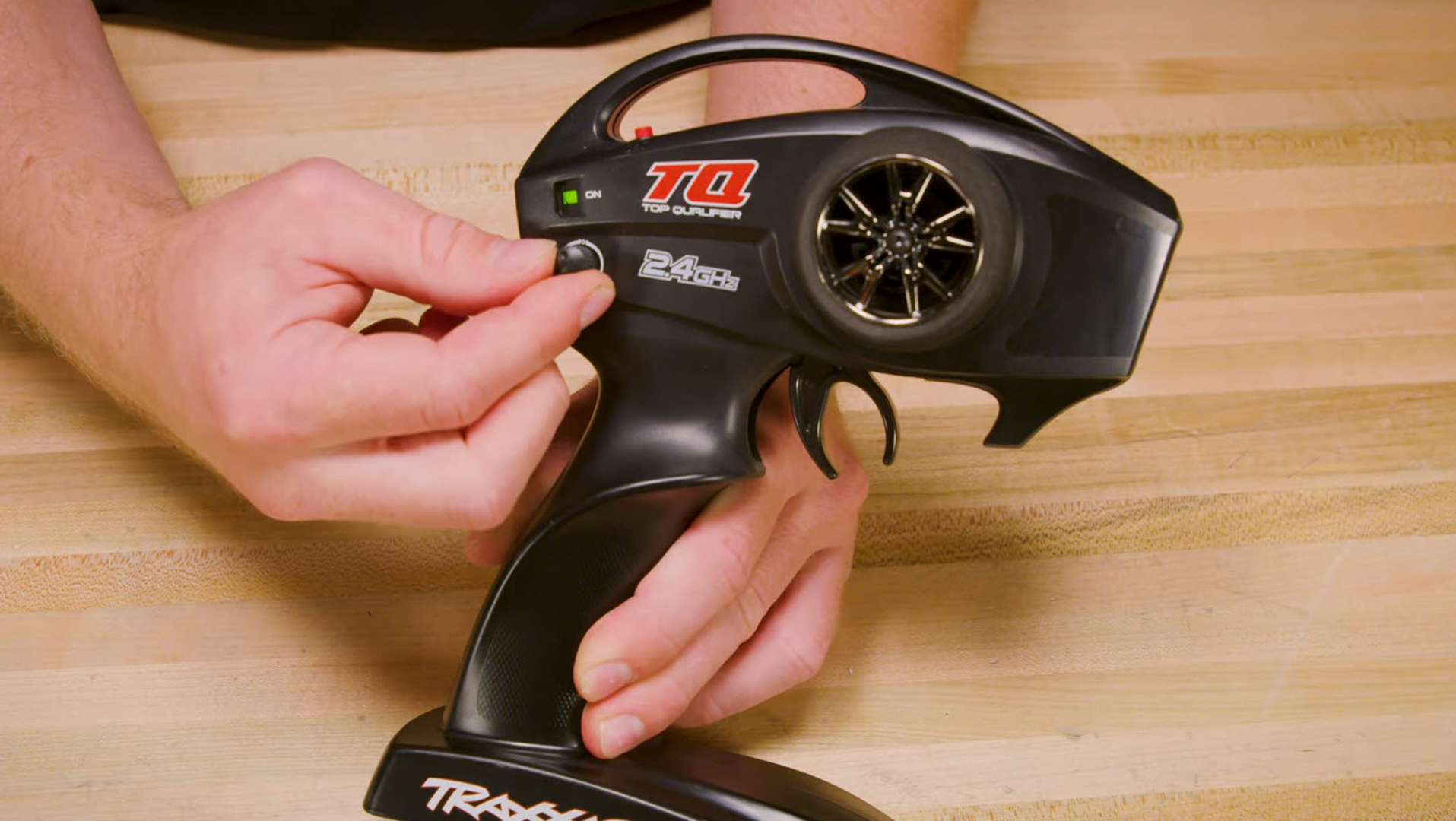

Turn the steering trim knob on the transmitter to the 12 o’clock position (straight up). Position the front wheels so they point straight ahead, then reinstall the servo saver and secure it using the 2 mm driver. When properly installed, the steering linkage servo saver will be oriented like this.
Turn the Steering Trim KnobTurn the Steering Trim Knob

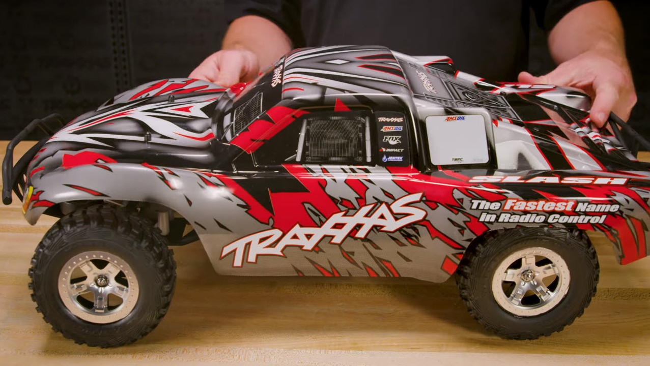

Confirm the model steers properly. If the wheels do not point precisely straight ahead when the steering is at neutral, use the transmitter’s steering trim knob to fine-tune the center point. Reinstall the body, and you’re ready to enjoy enhanced steering authority, precision, and durability.
