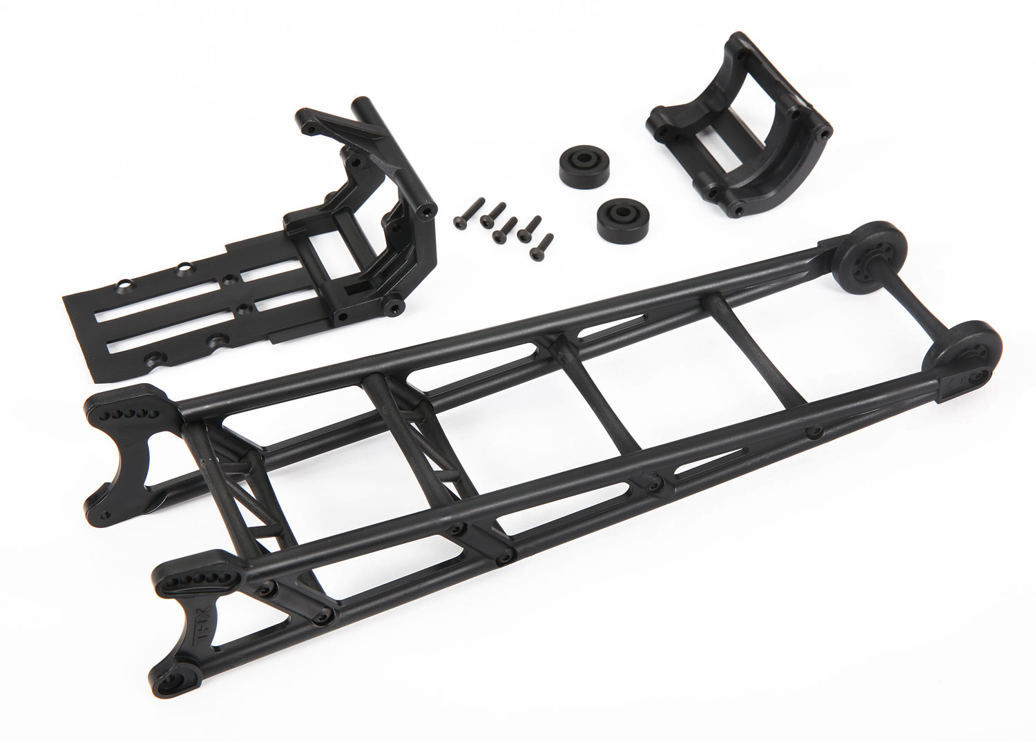

9460 Wheelie Bar
The 9460 wheelie bar includes all the parts and hardware required for installation on a Bandit, 2WD Rustler, or a 2WD Slash with the LCG chassis. You can also install 9460 on the Slash 4X4 and Rustler 4X4—more on that coming up.

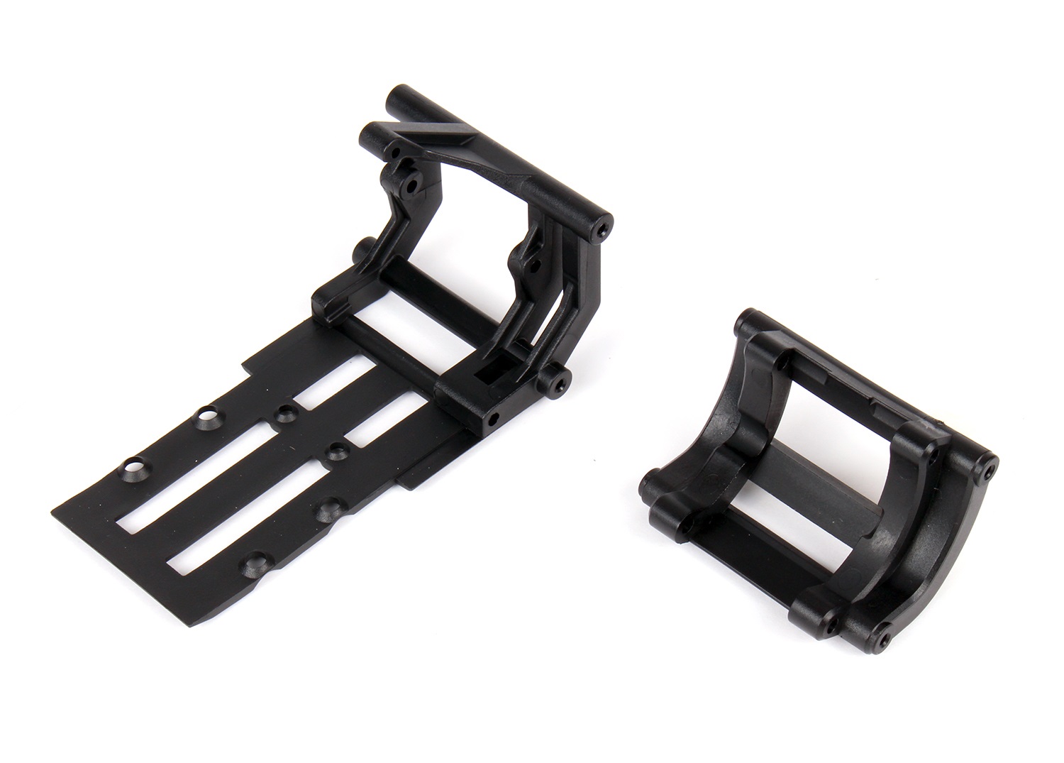

Skid and Mount
Two mounts are included. The mount with the integrated skid plate is for installation on the Bandit, 2WD Rustler, and LCG-converted 2WD Slash trucks with the original Magnum 272 transmission. If you’ve upgraded to the Pro Series Magnum 272R , use the mount without the skid.

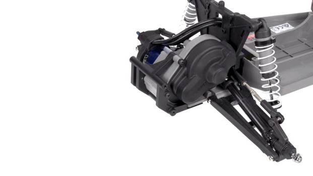

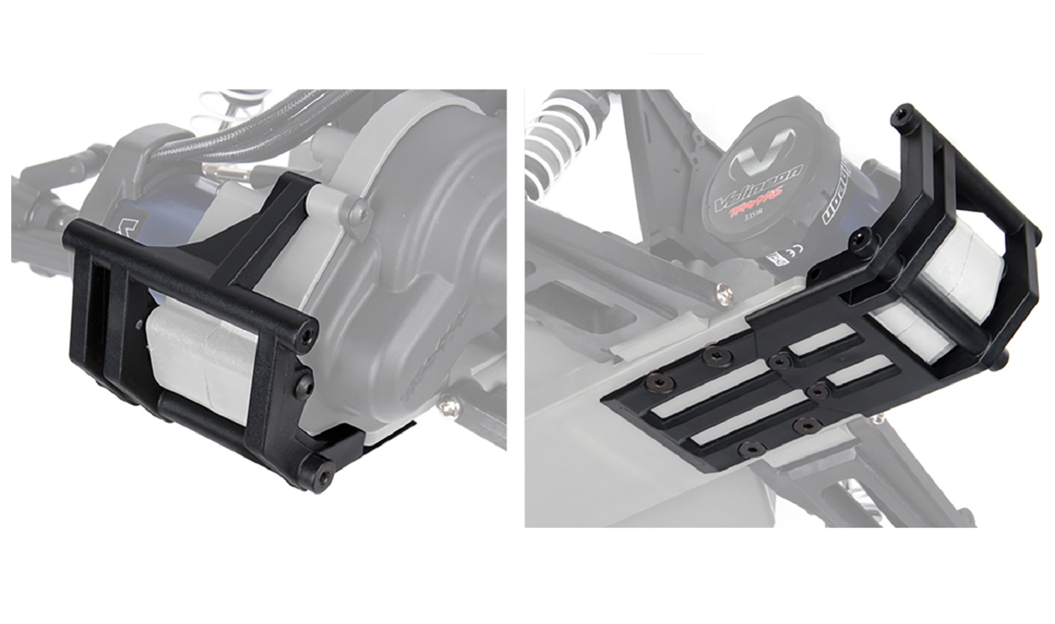

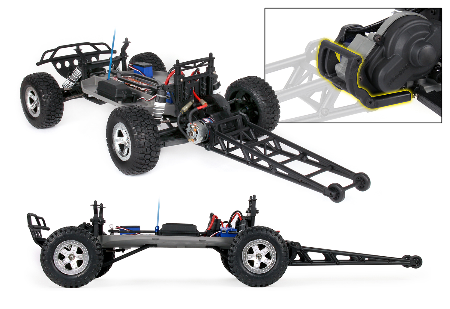

New mounts
The new mount wraps over the transmission and under the chassis to hold the wheelie bar securely.

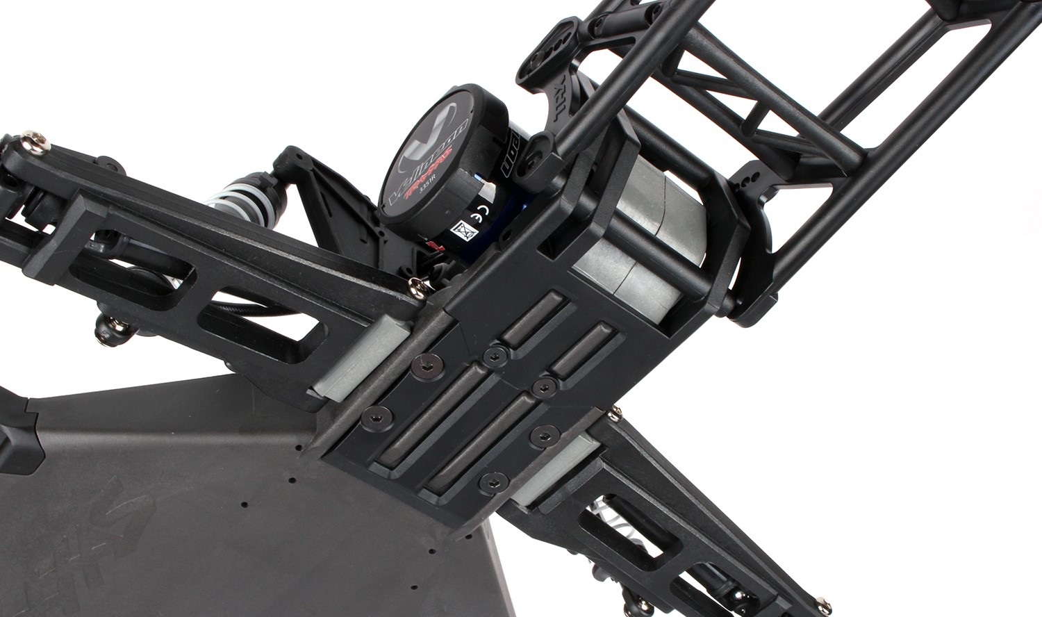

LCG chassis
Here’s the mount on an LCG Slash chassis. The slots provide clearance for the chassis’ ribs.

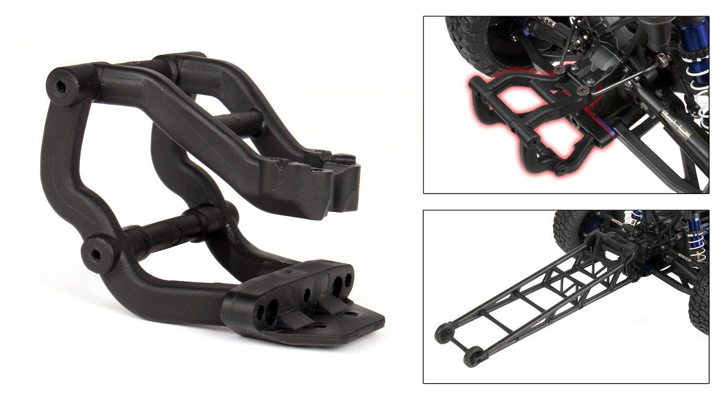

Old wheelie bar mount
The new mount is also compatible with the 3678 wheelie bar and offers additional support to keep the bar in place if your car or truck takes a tumble.

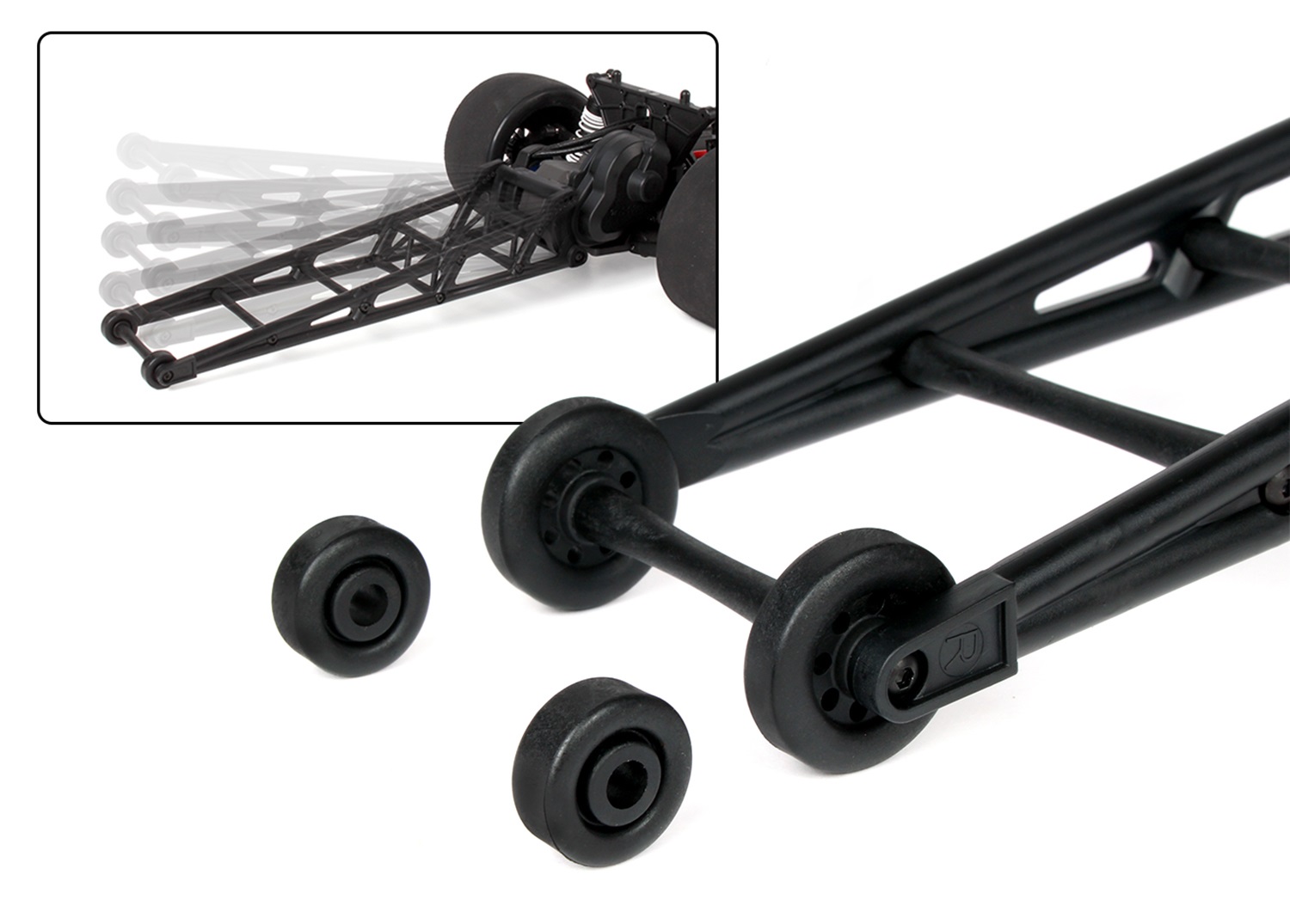

Choose Your Wheel Size
The wheelie bar includes 18 mm wheels that can be swapped for the installed 26 mm wheels. The two wheel sizes combined with the wheelie bar’s five positions give you ten height settings to fine-tune how closely the wheels hug the track (or how high they lift for big wheelies—your call).
Wheel sizes

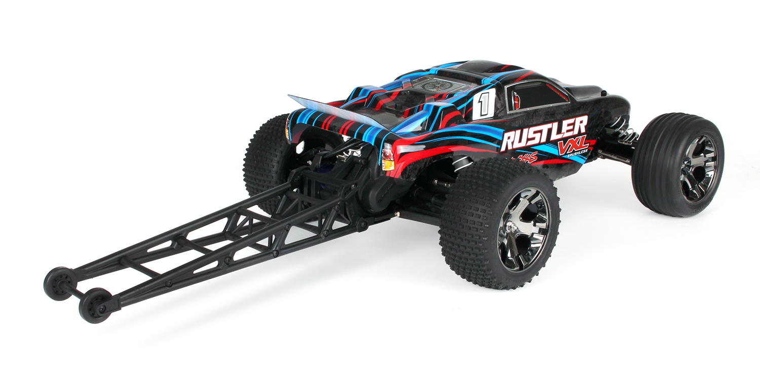

4X4 mounting
This Rustler VXL is ready to unleash big brushless power with wheelies on lockdown.
