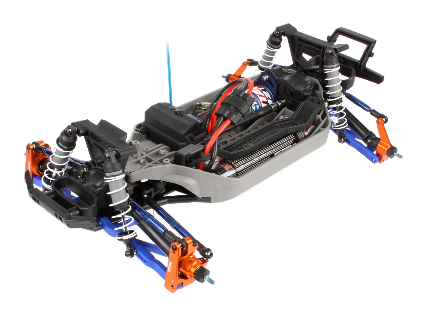

PHASE 1: Aluminum Suspension Components & HD Arms
Parts List

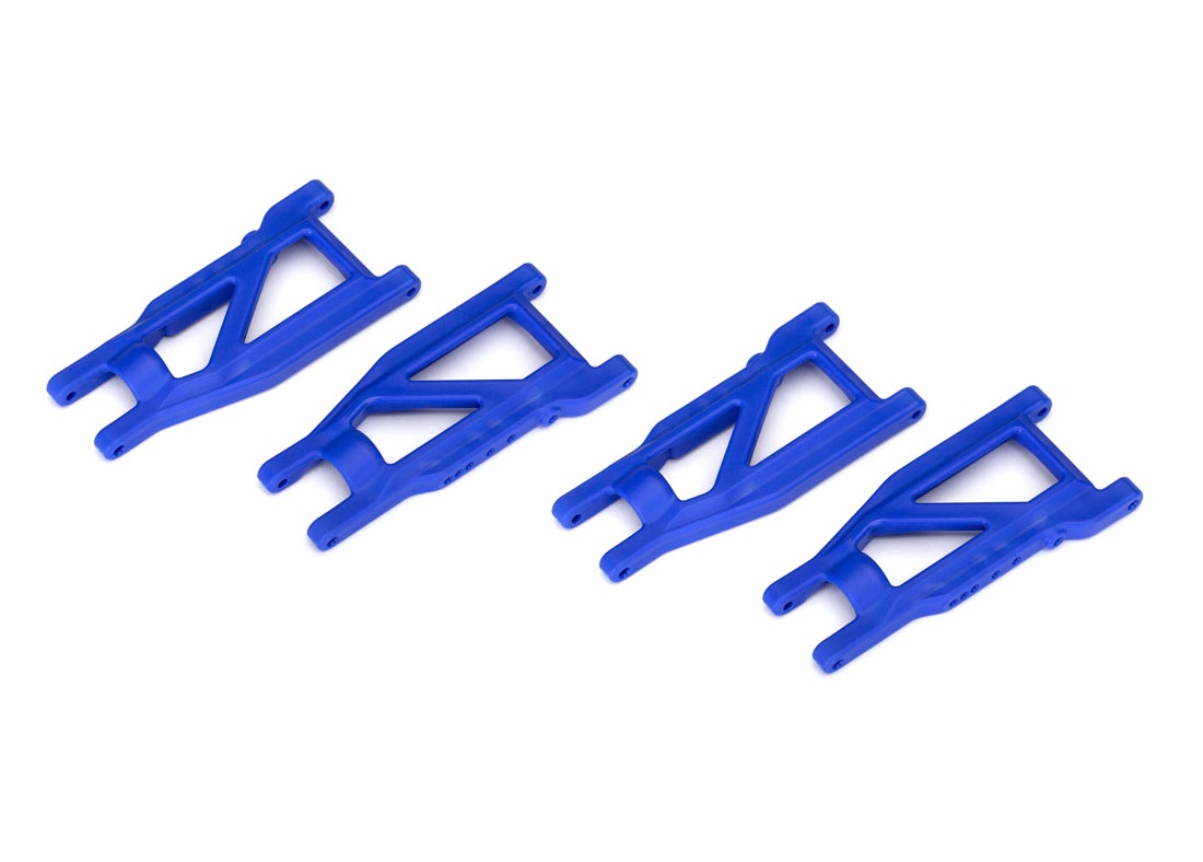

    • 3655P Heavy-Duty Arms, blue (x2)
    • 3643X TUBES blue-anodized camber links
    • 3644X TUBES blue-anodized camber links
    • 6837A Aluminum steering blocks, orange
    • 6832A Aluminum caster blocks, orange
    • 1952T Aluminum rear carriers, orange

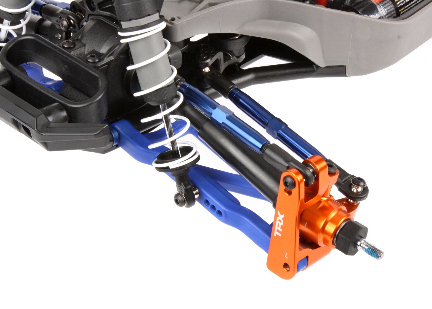

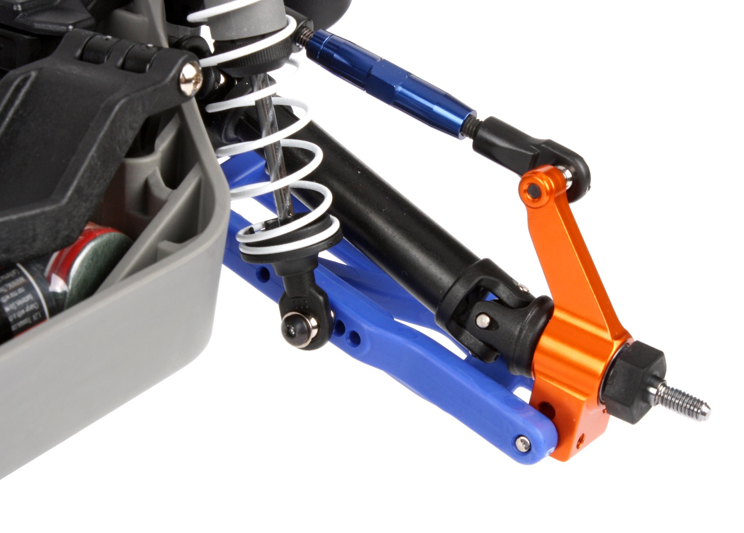

Rustler 4X4 features suspension arms made from the same material developed for the E-Revo VXL, X-Maxx and Maxx trucks. Traxxas formulated this heavy-duty composite for superior strength, even in cold conditions that make other plastics brittle. Black arms are standard on the Rustler 4X4, but as a style mod, we’re swapping them for a set of blue arms (the other options are red, green, orange or white). We’ll pair up the blue arms with orange-anodized aluminum caster blocks, steering blocks, and rear carriers for a contrasting look. All the aluminum parts are machined from 6061 aluminum for high strength, easy installation, and precise fit. The caster blocks get extra machining after anodizing for a two-tone effect, with etched TRX logos.
HD arms are formulated for superior strength, even in cold weather
Full set of orange aluminum parts
Genuine Traxxas aluminum upgrades offer the best performance, precision, and value

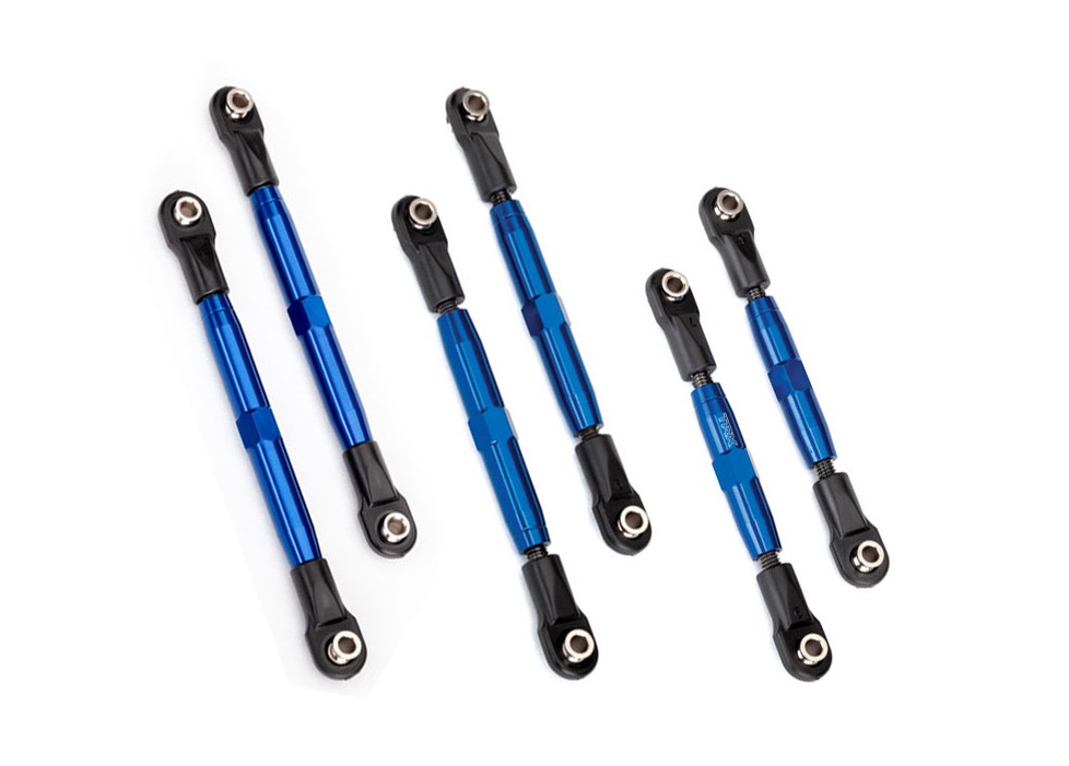

TUBES camber and toe links are the finishing touch. In addition to looking great, the links make it easy to fine-tune camber and toe-in without disassembly.
TUBES feature hybrid aluminum and steel construction for high strength and low weight

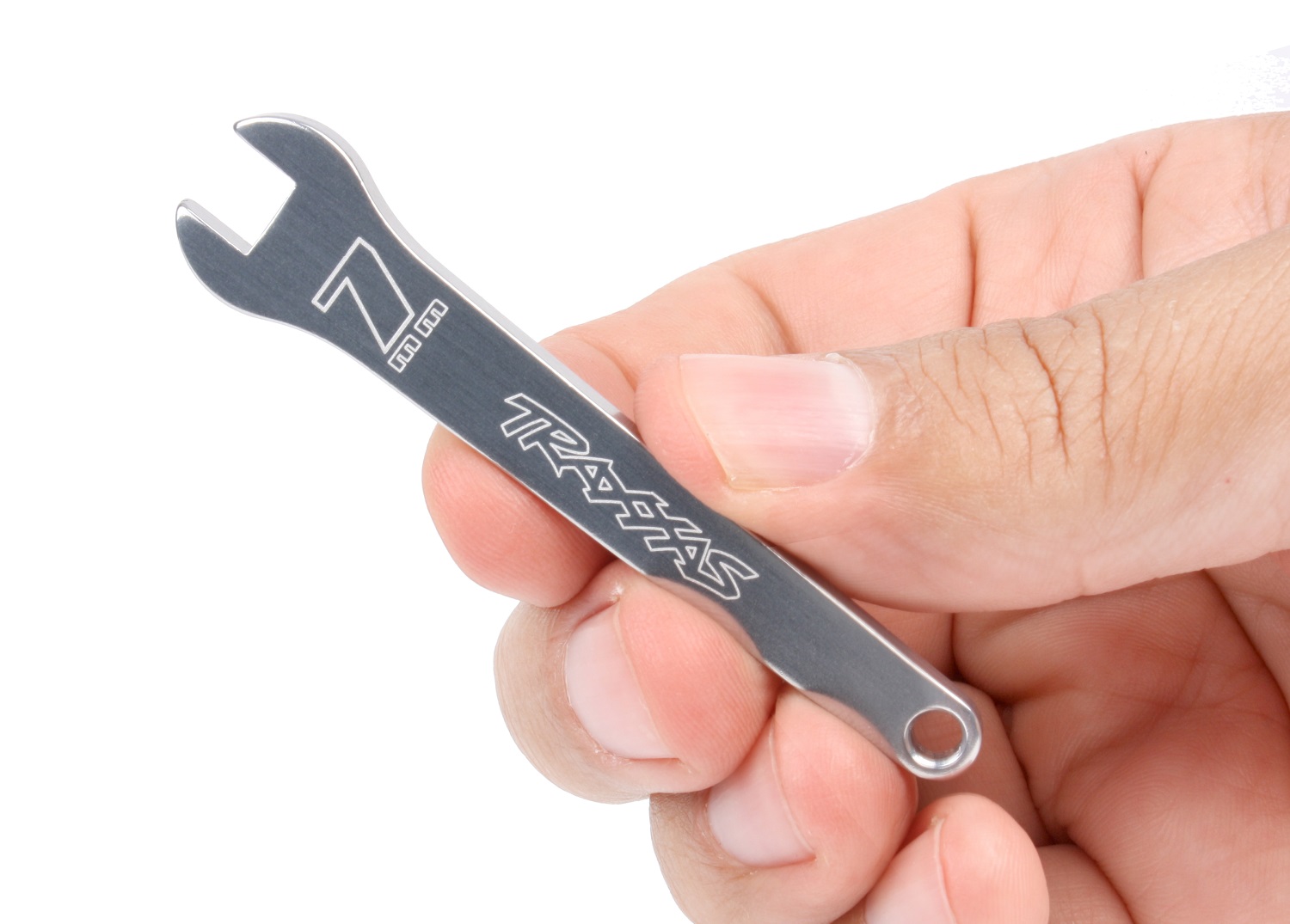

TUBES include an aluminum 7 mm wrench for easy adjustment
Completed front suspension
Completed rear suspension
Completed chassis

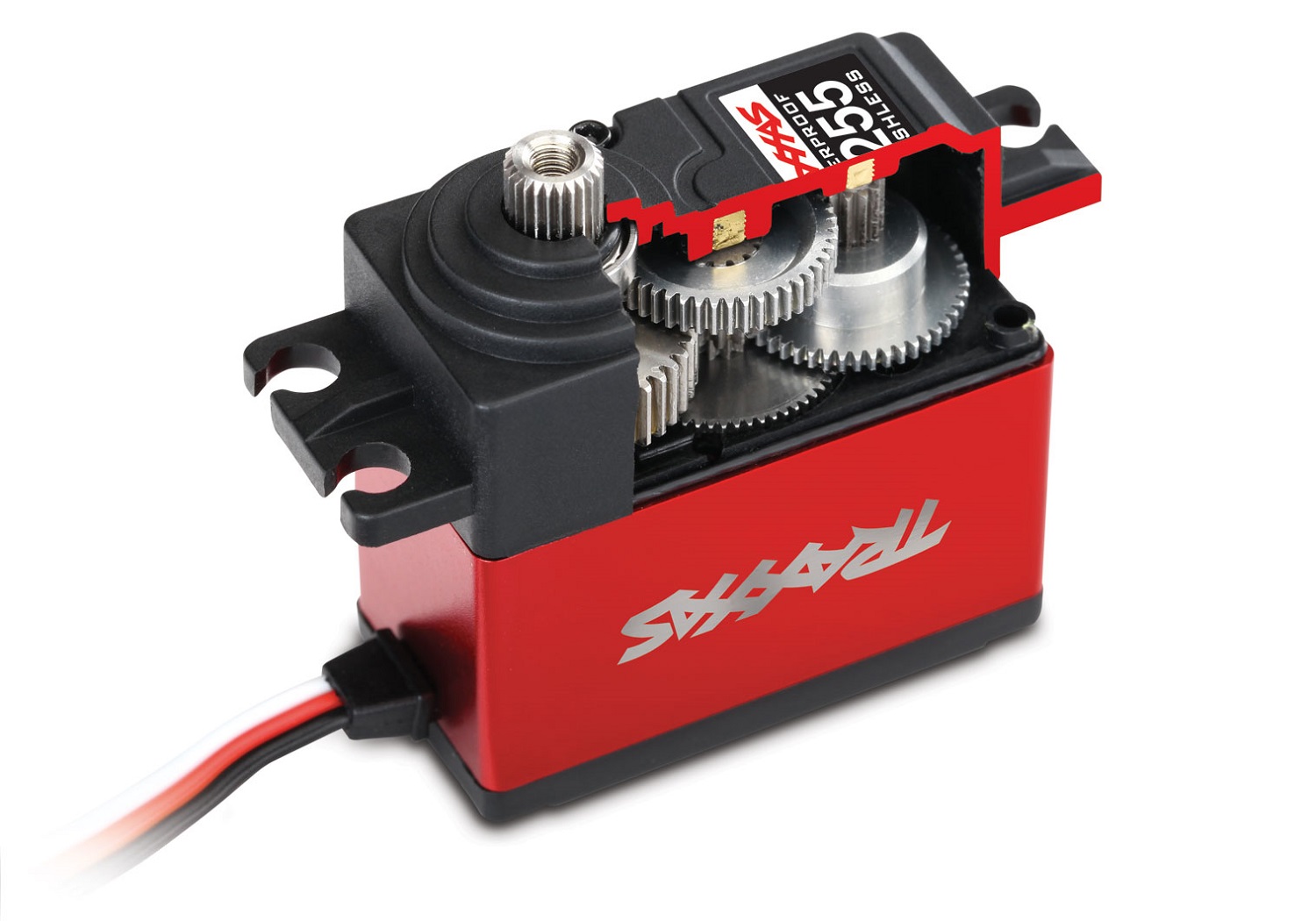

    • 2255 High-Torque 400 Red Brushless Digital Servo

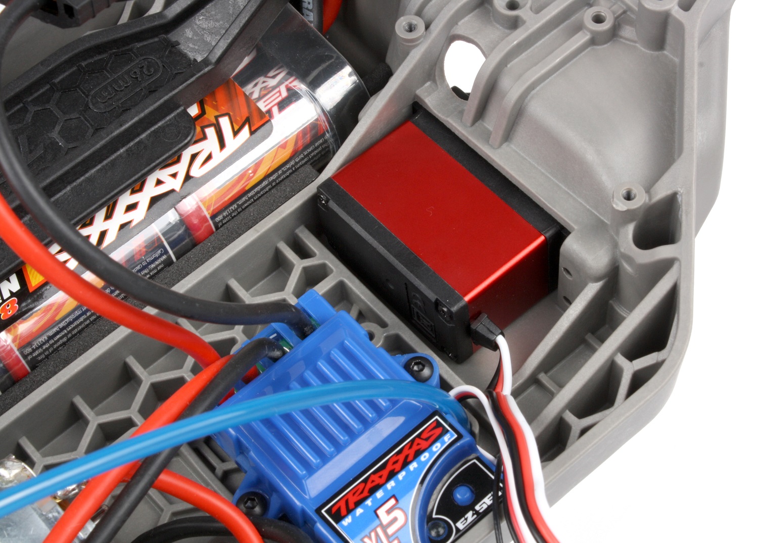

The High-Torque 400 is an incredibly powerful metal-gear servo, delivering over five times the power of the Rustler’s standard 2056 servo. The 400’s brushless motor gives it superior speed and precision, and 400 oz.-in. of torque to easily aim the Rustler’s fat tires. The red aluminum mid-case looks trick, but it’s not just about style: it also pulls away heat and stiffens the case.
All-metal gears and a brushless motor
Remove the front suspension module to install the servo
Here's a look at the installed servo
Here's a look at the servo installed in the chassis

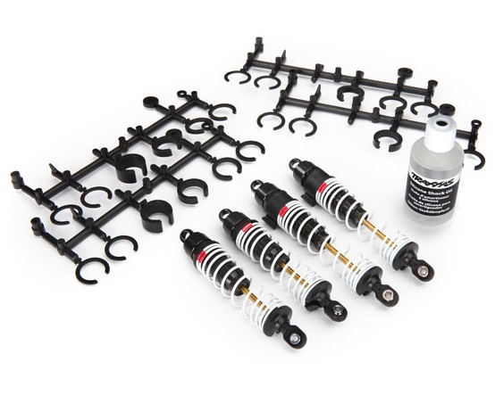

Our Rustler 4X4 is also getting a set of aluminum shocks for maximum durability and long-lasting performance. The shocks' precision-machined bodies are hard-anodized with slick PTFE-coated bores, and scuff-resistant Titanium Nitride-coated shafts reduce friction on the X-ring seals to the absolute minimum. The shocks include progressive-rate springs and silicone shock oil, just fill them up and bolt them on!
Big Bore shocks
Big Bore shocks
Big Bore shocks

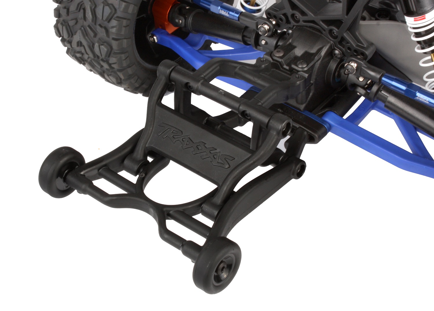

    • 3678 Wheelie bar
    • 6777 Wheelie bar mounts

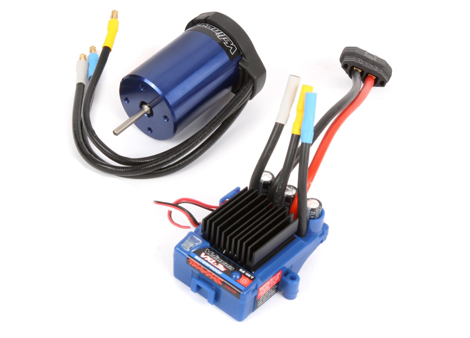

You can get the Rustler 4X4 brushless from the start as the VXL version, but since we’re starting with the brushed model, the Velineon VXL-3s brushless power system is going in as an upgrade. The 4X4 Rustler is already fast at 30+mph with its stock Titan 550 motor, but Velineon power puts over 65mph in reach when you install a 3-cell Power-Cell LiPo battery.
Brushless Velineon power systemBrushless Velineon power system
Installed Velineon systemInstalled Velineon system

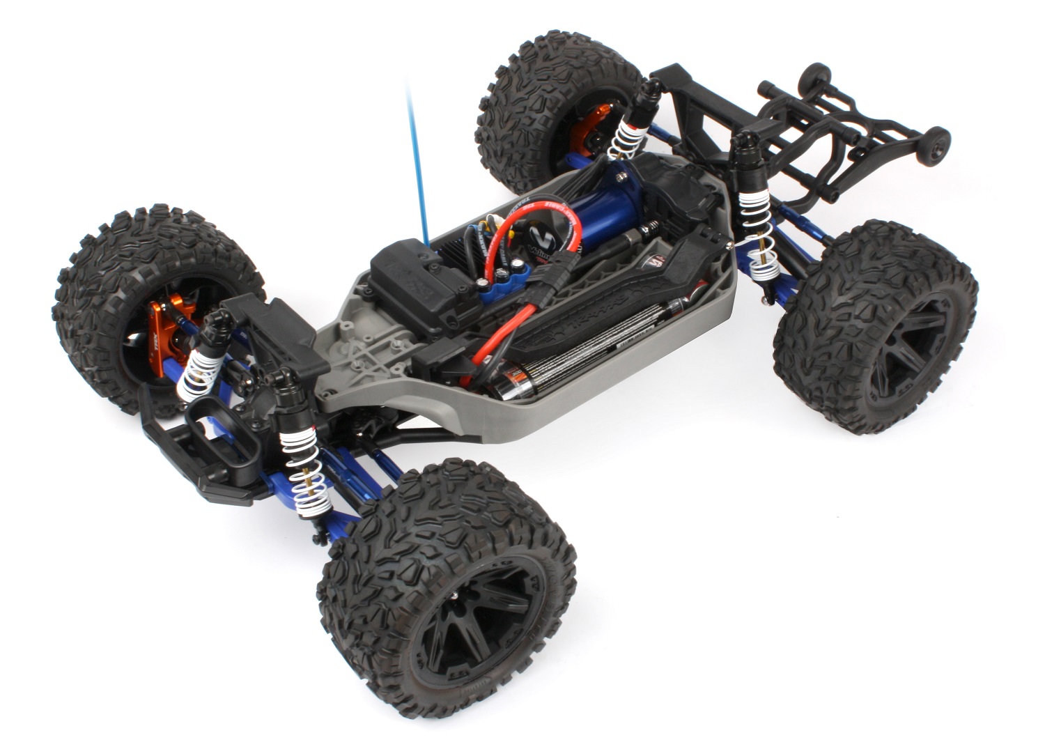

While we were at it, we replaced the stock 10-tooth pinion with an 11-tooth, as used in the Rustler 4X4 VXL. All that power also makes the Rustler 4X4 a wheelie machine, so we’ll add a wheelie bar. Instead of installing the fixed-height 6776 wheelie bar from the Rustler 4X4 VXL, we’ll add a Stampede 4X4 rear bumper so we can install the 4-position adjustable version.
11-T pinion gear11-T pinion gear
Installed wheelie barInstalled wheelie bar
That's the end of our Rustler 4X4 3-Phase upgrade. We installed plenty of high-performance parts on our truck, but still barely scratched the surface. Head on over to the Rustler 4X4 accessory page to see even more performance and convenience upgrades.
Completed Rustler 4X4

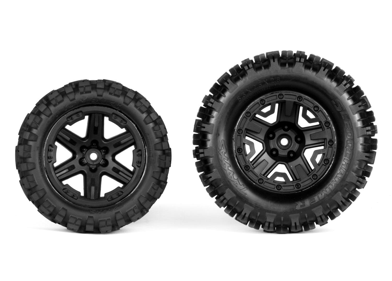

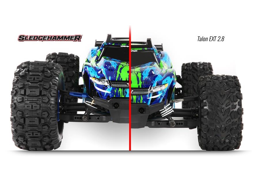

This 3-Phase build was the perfect opportunity to try our latest tire, the Sledgehammer. This new design features tall, aggressive lugs and bars that clear mud and debris easily for incredible traction in rugged terrain and on loose surfaces. The Sledgehammer's larger overall diameter delivers an extra 10 mm of ground clearance.
Stock Talon tire (left) vs Sledgehammer (right)Stock Talon tire (left) vs Sledgehammer (right)
Sledgehammers provide 10 mm extra ground clearanceSledgehammers provide 10 mm extra ground clearance
Sledgehammer Gearing
In addition to raising the Rustler 4X4’s ground clearance, the Sledgehammers’ larger diameter also means the Rustler rolls almost an inch farther with each revolution of the tires. That will help the truck go even faster on hard, smooth surfaces, but it will put extra strain on the power system when running off road. We swapped the 11-tooth pinion for a 6745 9-tooth pinion to compensate for the taller tires and keep our Rustler 4X4 roosting with the perfect blend of speed, power, and torque.
