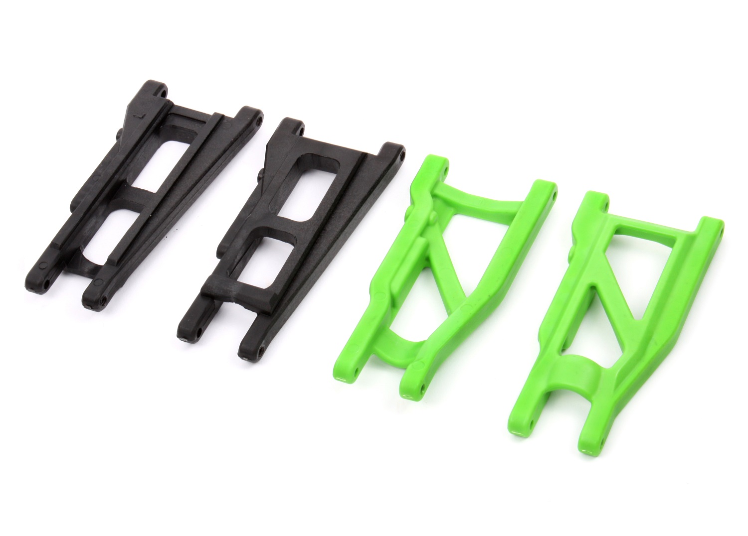

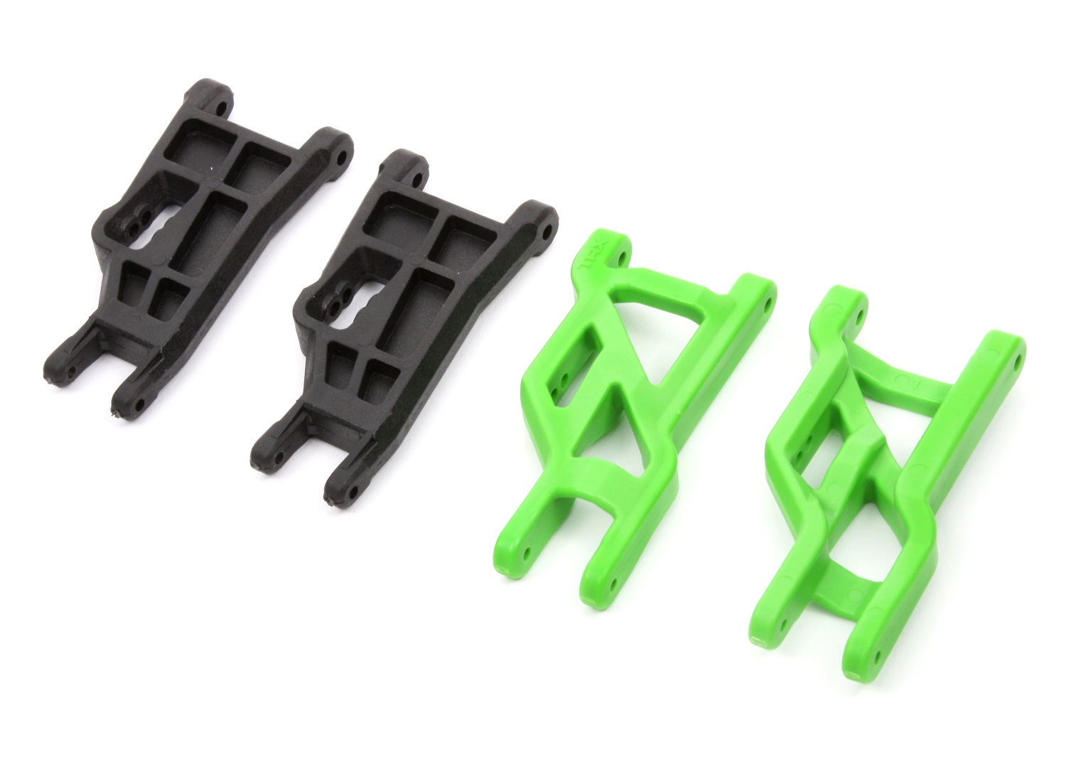

The super-strong, extra-resilient composite plastic Traxxas developed for the E-Revo VXL, X-Maxx, and Maxx trucks’ suspension parts is now available for the Stampede, Slash and Rustler. The Heavy Duty (HD) arms are even stronger than the Stampede’s stock parts, and the composite formula maintains its flexibility in cold weather. They even come in colors: you can choose blue, orange, green, red, black, or white. Here you can compare the green HD arms with the stock black parts.
Stock front arms and HD armsStock front arms and HD arms
Stock rear arms vs HD armsStock rear arms vs HD arms

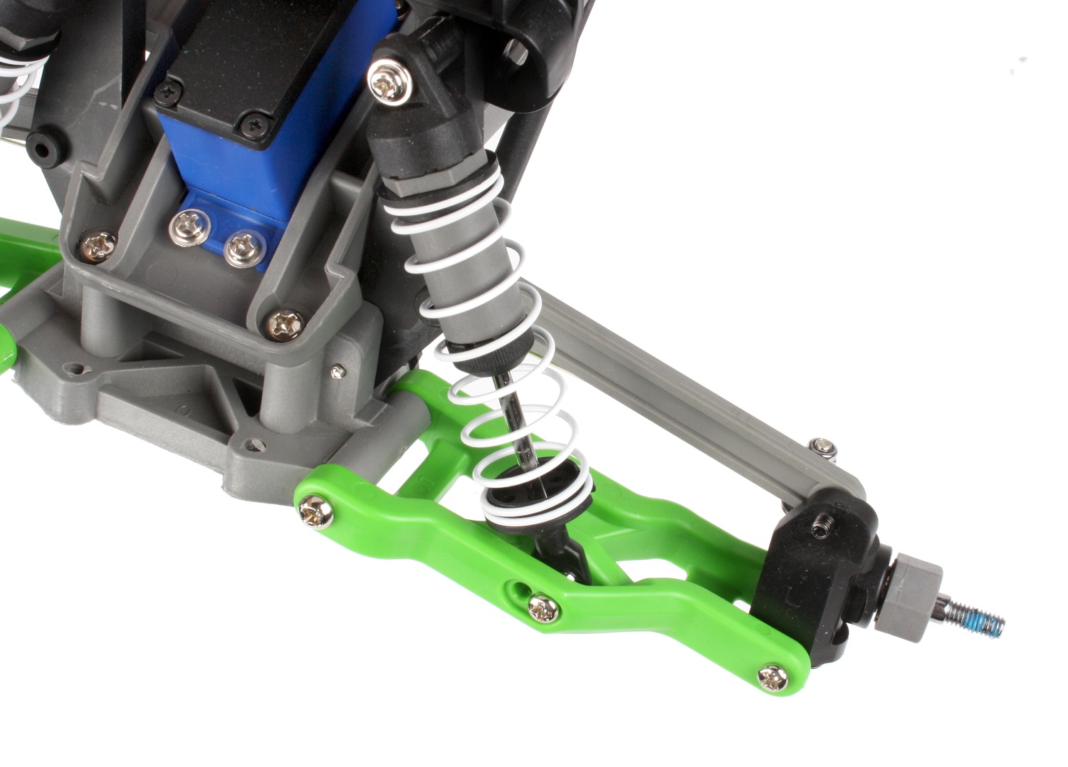

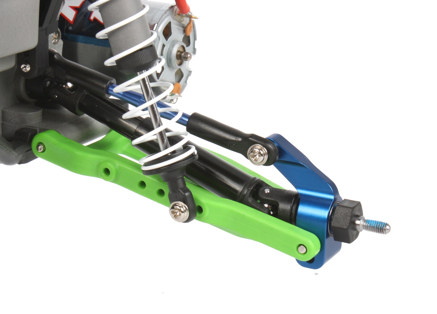

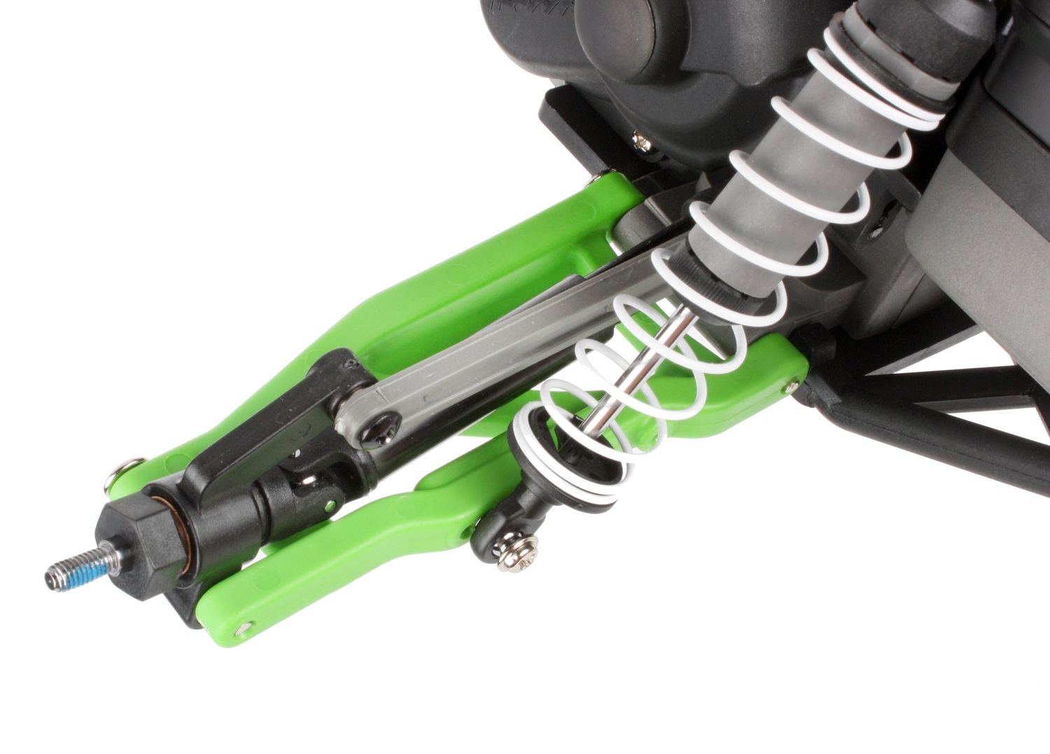

The Heavy Duty arms are shaped to balance rigidity and flex for maximum performance and durability. Installation is easy: just remove the old arms and replace with the new parts. If you forget which screw goes where, you can consult the Stampede’s exploded views here. Installation takes only a few minutes with just three screws per arm to remove.
Front HD arms installedFront HD arms installed
Rear HD arms installedRear HD arms installed
Adding HD arms is an inexpensive and simple way to boost the durability of your Stampede. If you break or wear out an arm, take the opportunity to upgrade—and add some color to your crusher, if you like.

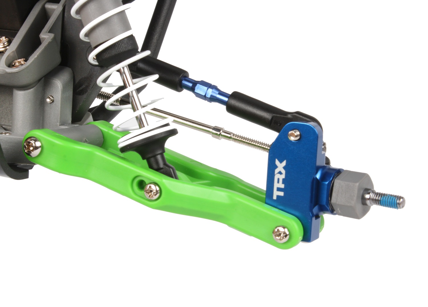

    • 3636A Aluminum steering blocks (blue)
    • 3632A Aluminum caster blocks (blue)
    • 3652A Aluminum rear uprights (blue)
    • 3741A Aluminum turnbuckles (blue)
    • 2075X Digital high-torque metal-gear servo
    • 5862 Big Bore shocks (blue)

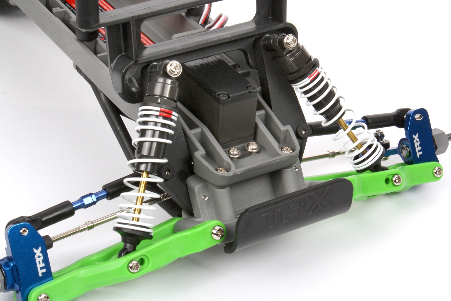

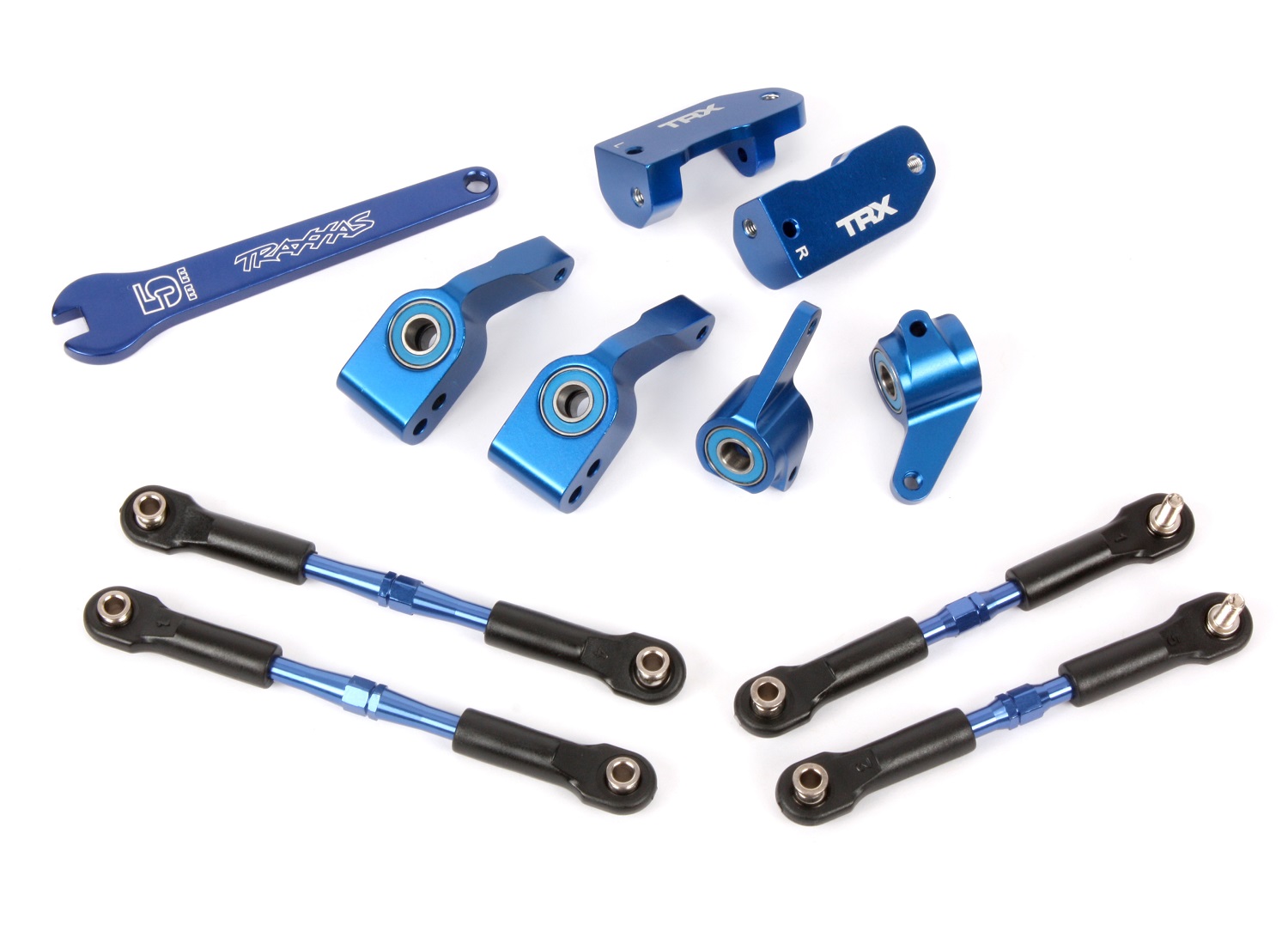

Superior strength and custom style—that’s what anodized aluminum parts are all about. Traxxas’ precision-machined alloy components are direct replacements for the stock plastic parts and will take our Stampede’s toughness up even higher. We’re going with blue steering blocks, caster blocks, and rear uprights to contrast with the green arms, and we’ll swap the Stampede’s one-piece camber links for adjustable, aluminum turnbuckle links. To exploit all that steering- and suspension-upgrade goodness, the steering servo will be upgraded to the 2075X for digital precision, greater torque, and metal-gear toughness.
The vivid blue-anodized finish looks incredibleThe vivid blue-anodized finish looks incredible
The blue aluminum parts contrast nicely with the green armsThe blue aluminum parts contrast nicely with the green arms
The turnbuckles allow custom camber settings using the included wrenchThe turnbuckles allow custom camber settings

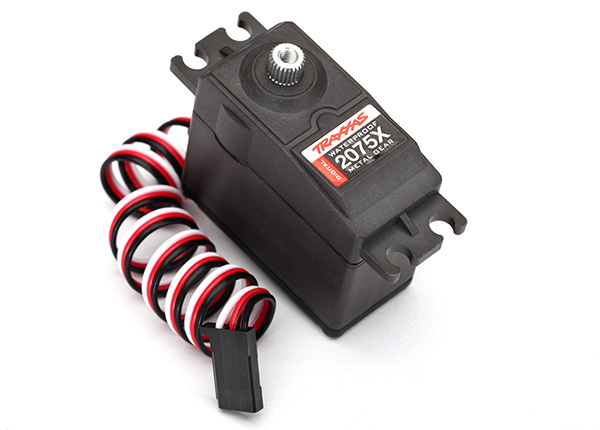

Improved Steering Authority

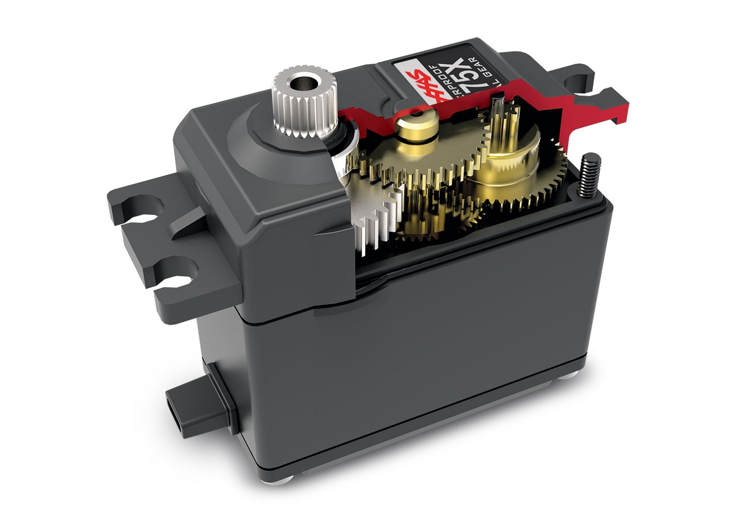

The 2075X is a powerful metal-gear servo, delivering 125 oz.-in of torque (over 50% more torque than the stock servo) to steer the Stampede with authority.
The 2075X is a direct replacement for the stock servoThe 2075X is a direct replacement for the stock servo
Metal gears make this servo extra toughMetal gears make this servo extra tough

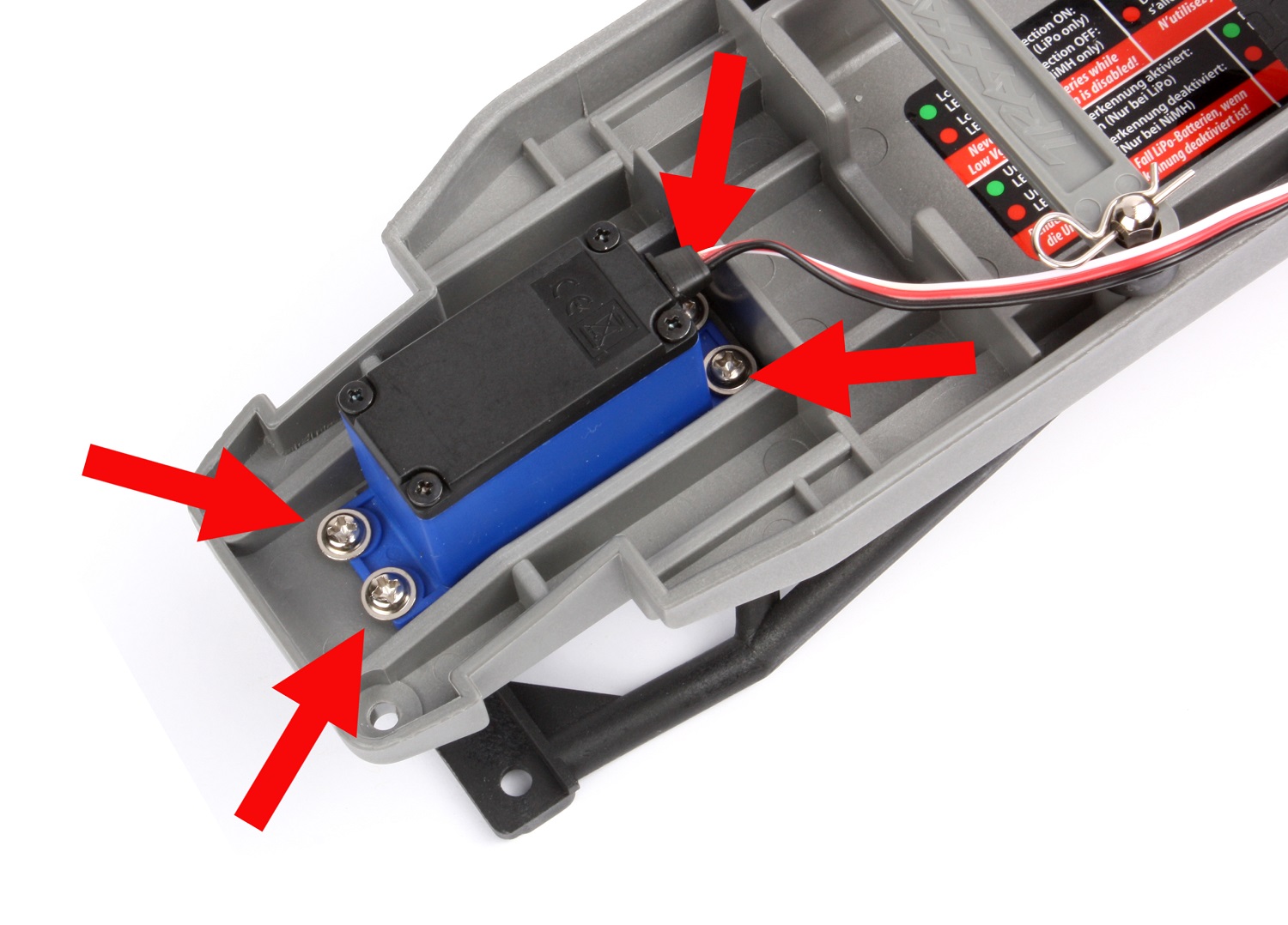

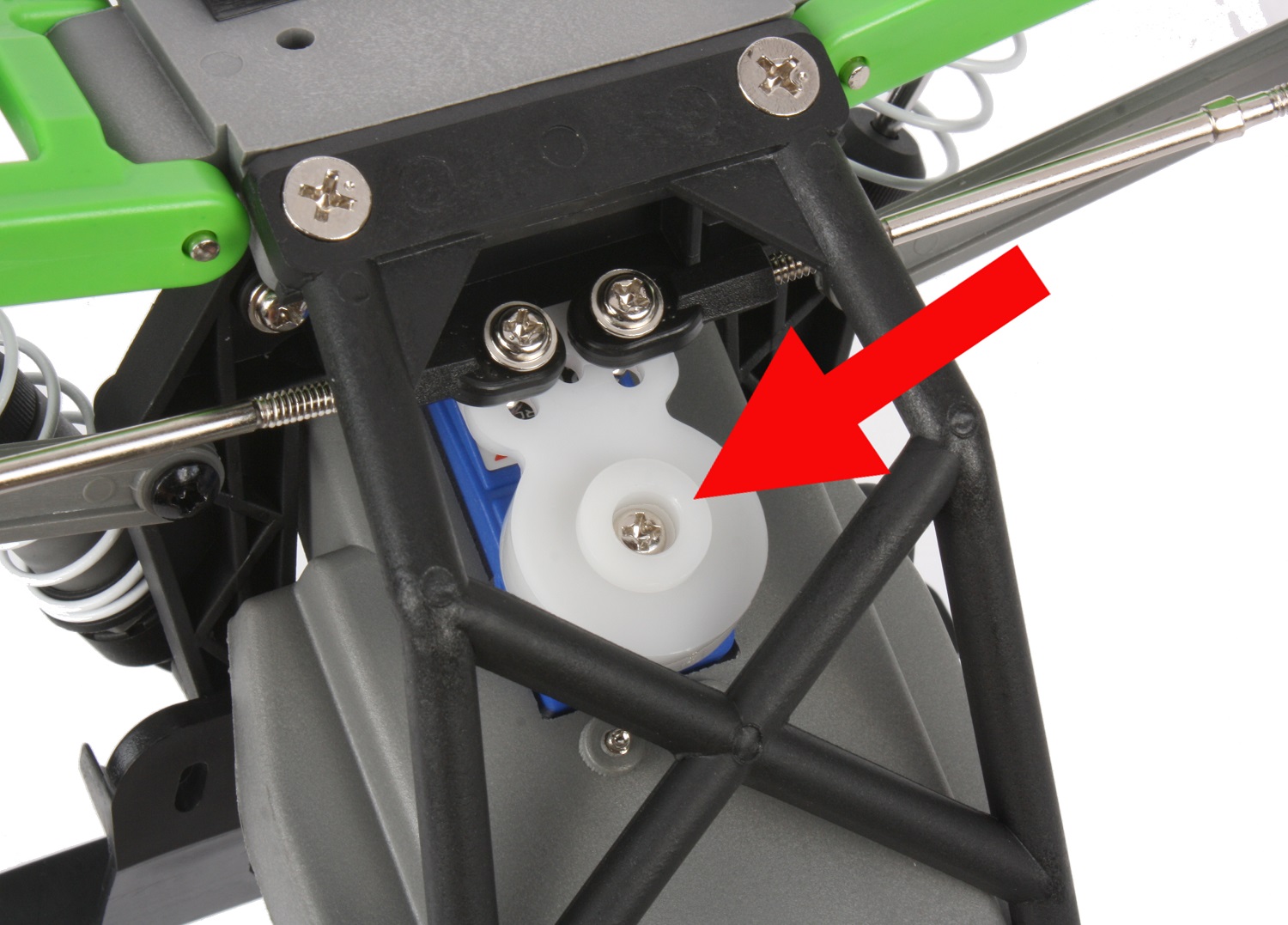

To remove the stock servo, first turn the truck over and remove the servo-saver, then remove the four screws that secure the servo from the top of the chassis (for clarity, we removed the front suspension in the shot below). Reverse the process to install the 2075X servo.
Remove the servo saver firstRemove the servo saver first
Four screws secure the servoFour screws secure the servo

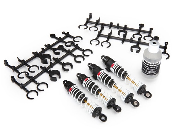

Bonus Upgrade: Big Bore Aluminum Shocks

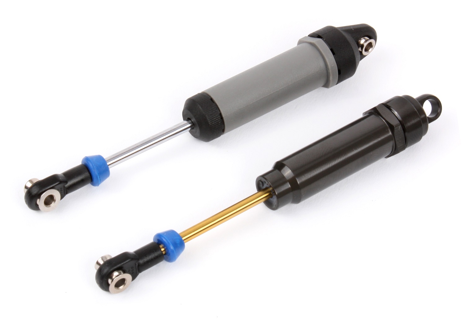

The Stampede’s stock Ultra Shocks are excellent bump-eaters, but for the ultimate in super-smooth suspension action and extra-long wear, the Big Bore Aluminum Shock set is the way to go. The precision-machined bodies are hard-anodized with slick PTFE-coated bores, and scuff-resistant Titanium Nitride-coated shafts reduce friction on the X-ring seals to the absolute minimum. Progressive-rate springs and silicone shock oil are included, just fill ‘em up and bolt them on.
The shocks arrive assembled and ready to fillThe shocks arrive assembled and ready to fill
Ultra Shock vs. Big Bore shockUltra Shock vs. Big Bore shock
That’s a serious-looking front end!

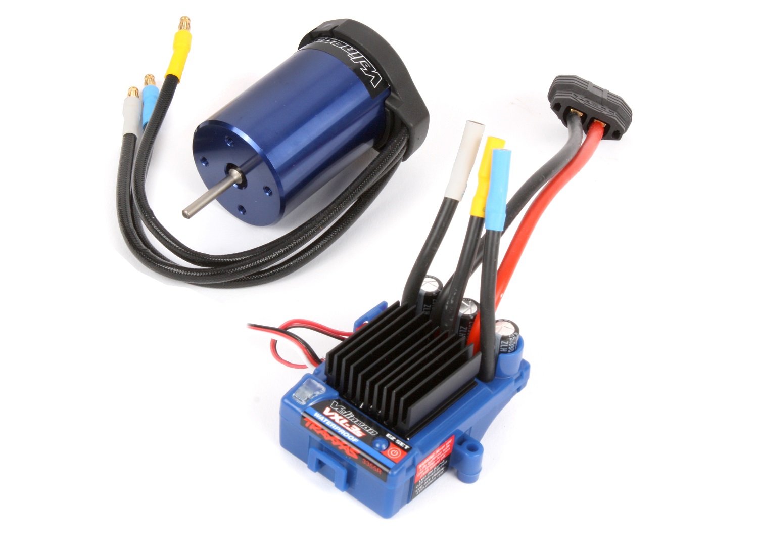

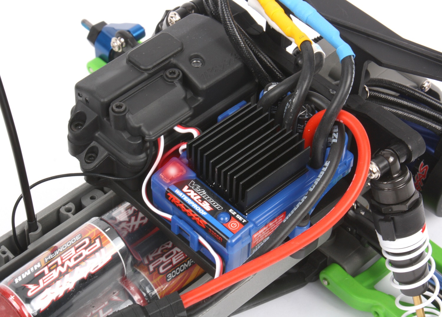

Here’s where we make a giant leap in performance. Upgrading to Velineon brushless power will more than double the Stampede’s speed potential! With the Traxxas Power-Up Program, you can trade in the Stampede’s stock XL-5 speed control and Titan 550 motor for a discount on the Velineon system. You can make the exchange by mail, or at your participating Traxxas dealer—get all the details here.
Velineon box
Velineon brushless system

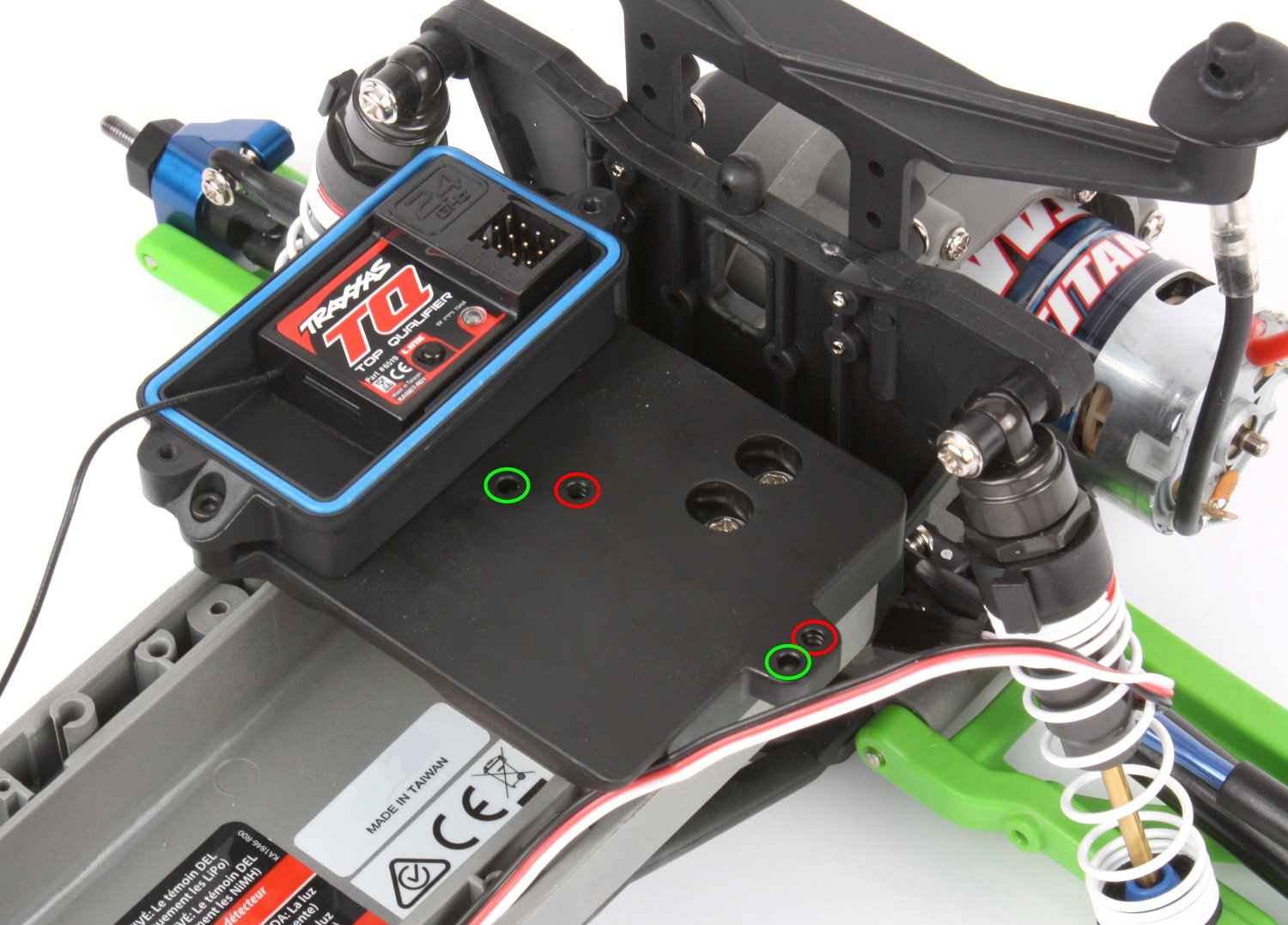

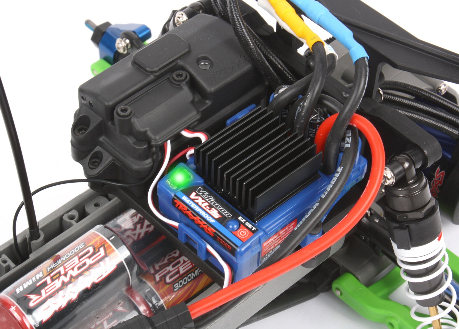

The Velineon system installs just like the stock speed control and motor. Simply remove the XL-5 and Titan 550 motor, and replace with the VXL-3s and 3500 motor. There are extra holes in the chassis’ electronics platform for the larger VXL-3s speed control. You’ll also need to open up the waterproof receiver box to plug in the speed control and the 2075X servo. The Stampede manual includes instructions on maintaining a watertight seal and plugging in the components, it’s easy. The servo plugs into the Channel 1 port, the speed control plugs into Channel 2, and the plugs only fit one way.
Mounting holesThe XL-5 mounting holes are shown in red, the VXL-3s positions are in green.
Stock Gearing Vs Brushless Gearing

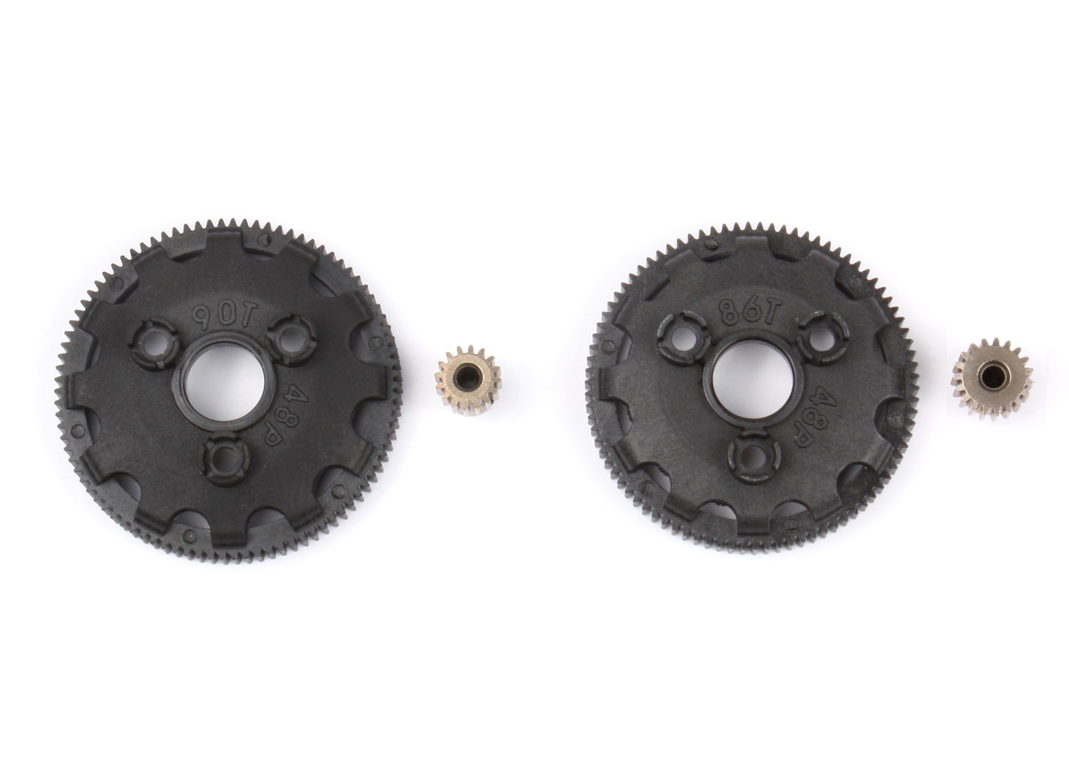

For maximum performance, we’ll replace the Stampede’s 16-tooth pinion and 90-tooth spur gear with a 19-tooth pinion and 86-tooth spur gear, as used by the Stampede VXL. The Velineon system will also work just fine with the stock gearing and your Stampede will still go a lot faster, but not quite as fast as it can go with the VXL gearing.
GearingStock gearing on the left, VXL gearing on the right
Out of the box, the VXL-3s speed control is set up for use with LiPo batteries with Low Voltage Detection turned on, as confirmed by the green LED when you turn the system on. If you’re using NiMH batteries, switch Low Voltage Detection off by pressing and holding the EZ-Set button until the LED turns from green to red.

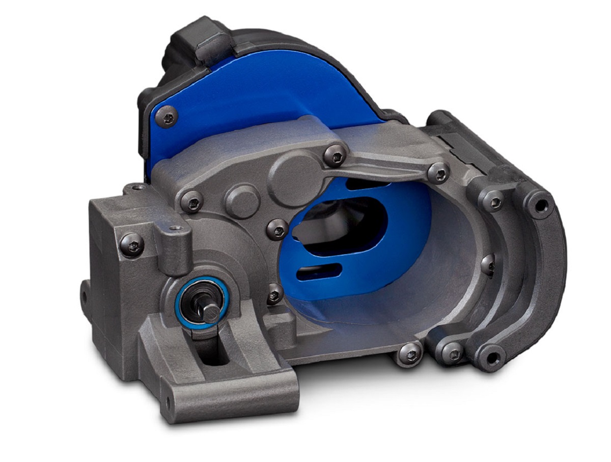

Traxxas Magnum 272R Transmission
Get the most out of the added power of the Velineon Brushless system with the Magnum 272R Transmission. Developed for the hard-hitting Drag Slash, the 272R features a low-profile design, sealed differential, 3.2 mm motor plate, hardened steel top shaft, and more. The Pro Series Magnum 272R represents a complete performance redesign for VXL 2WD Bandit, Rustler, Stampede, or Slash.
Green light = Low Voltage Detection ON, for LiPo batteries
Red light = Low Voltage Detection OFF, for NiMH batteries

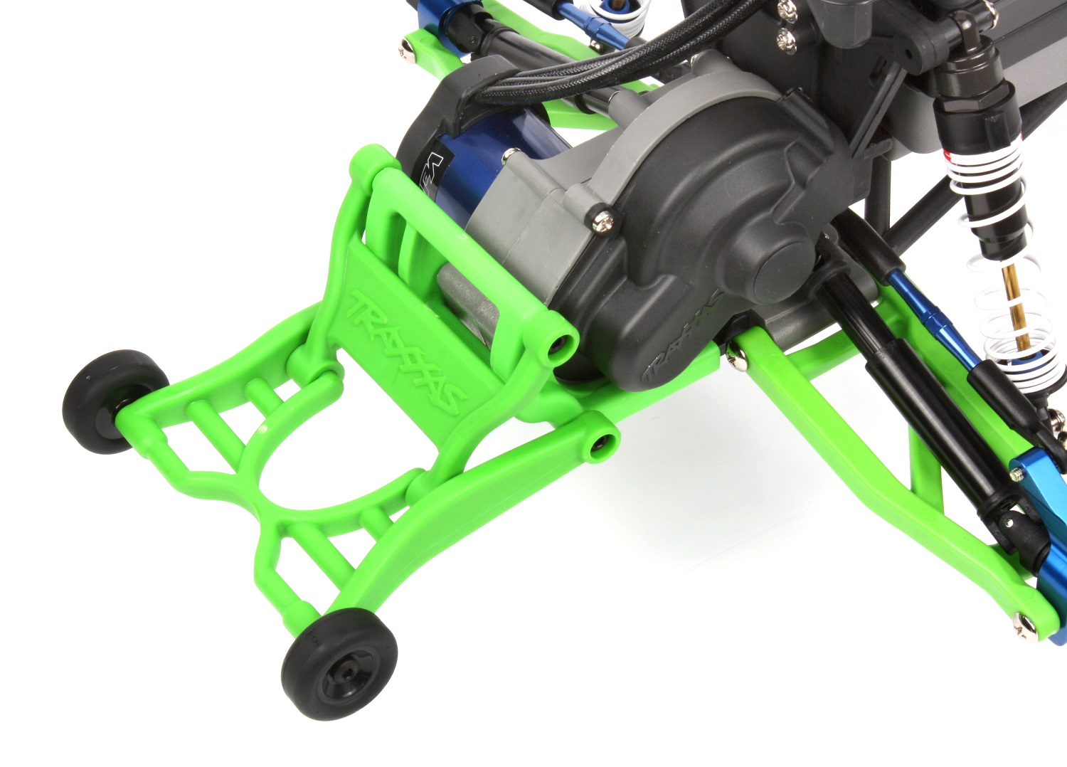

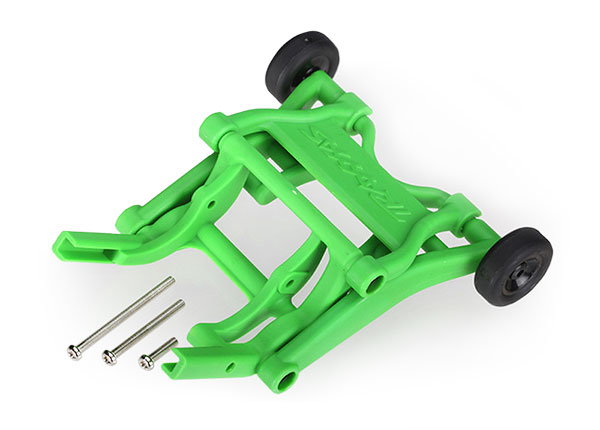

Once you go brushless with the Stampede, a wheelie bar is a must-have. The Traxxas unit installs in just a few minutes, and lets you adjust the bar to four different height settings without tools. Set it sky-high for stunting, keep it low for drag-style launches, or set it in between. Rest assured, the wheelie bar will get a workout!
Mounting hardware is includedMounting hardware is included
Wheelie bar installedWheelie bar installed

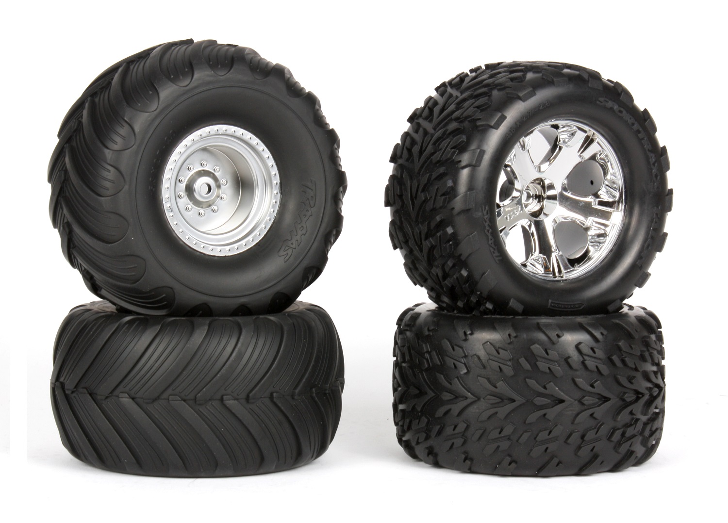

Just for Fun: Terra Groove Tires

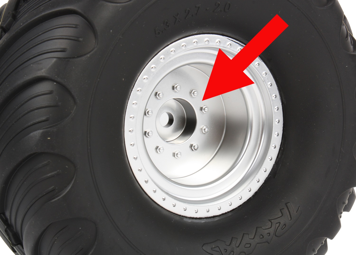

We decided to give our Stampede a new look and swap its Talon tires for a set of Terra Groove tires on satin wheels (you can also get them on bright chrome wheels). The Terra Groove design captures the carved-tread car-crusher look, and they’re molded in a firmer rubber compound that gives the Stampede a little more slide on hard surfaces. The Terra Grooves are also slightly larger in diameter and have taller sidewalls than the Talon tires, which gives a little extra cushioning over bumps and jumps. Note that the front and rear wheels have different offsets. The wheels with recesses for the mounting nuts go up front.
Terra Groove vs. Talon tiresTerra Groove vs. Talon tires
The front wheels have recesses for the axle nutsThe front wheels have recesses for the axle nuts

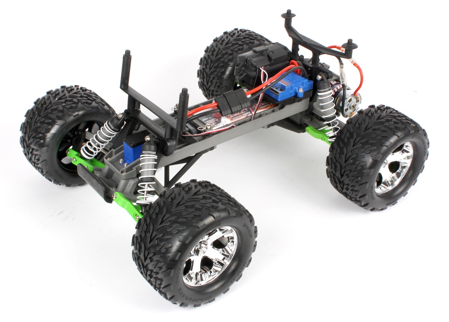

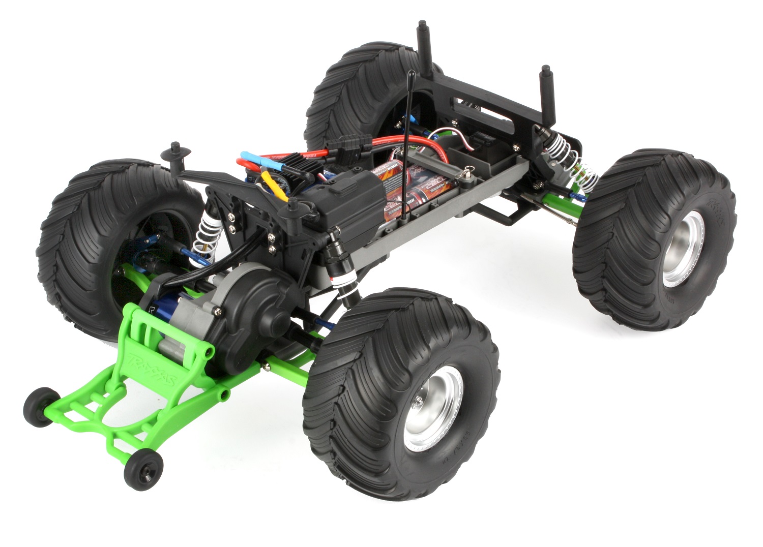

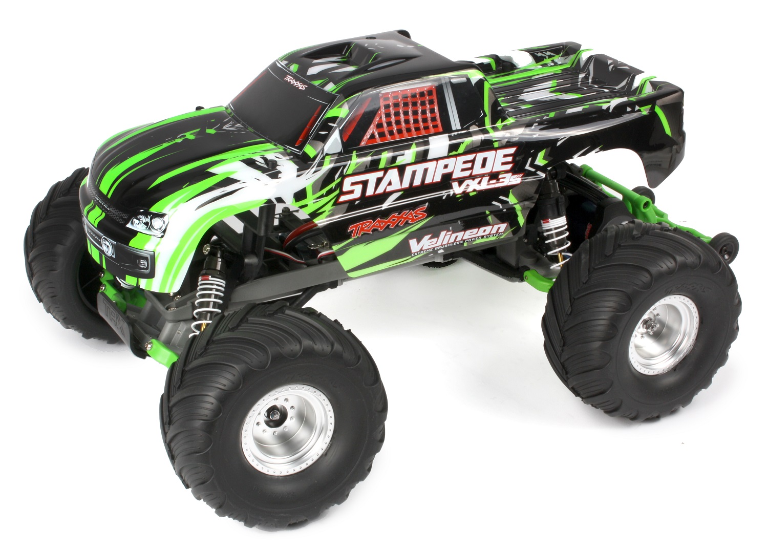

Mean green! Our Stampede is even tougher than before, looking good, and ready for 45+mph with a 3-cell Power Cell LiPo on board—and 65+mph when geared for all-out speed! A brushless Stampede is a wild ride—see for yourself!
Completed Stampede
Completed Stampede
Completed Stampede
