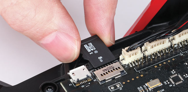

- Insert the microSD card into the card reader
- Copy the file from your Downloads folder to the microSD card
- Eject the microSD card from the card reader

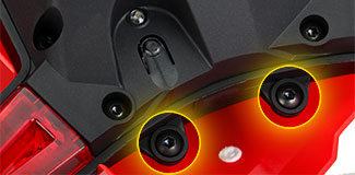

- Use the hex tool to remove the two screws connecting the Aton canopy to the frame and remove the canopy
- Insert the microSD card into the Aton microSD card slot
- Power on your transmitter and plug the battery into your Aton
- Aton will upgrade to the downloaded firmware package automatically.
- Aton contains multiple components which may be upgraded. Before each upgrade, Aton plays the upgrade alert and the status LEDs show the upgrade pattern.
- The upgrade is complete when the status LEDs return to showing the current Aton status.
- Once the Aton has completed the firmware upgrade
- Power off the Aton
- Remove the microSD card
- Delete the .bin file
- If desired, replace the microSD card back in the Aton to log flight data
