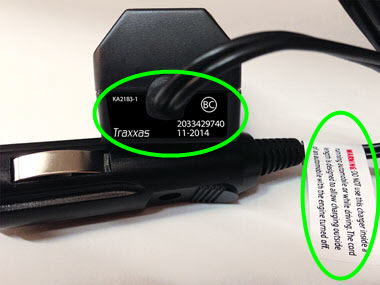

Warning tag applied to the charger cord and/or CEC compliance label on the back of the charger

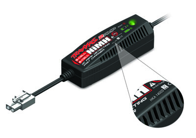

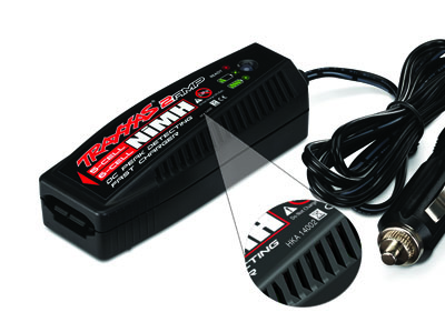

2-Amp Traxxas DC Charger - Main decal contains HKA14002
70054-1 | 1/16 SLASH RTR |
71054-1 | 1/16 E-REVO RTR |
71074-1 | 1/16 E-REVO VXL RTR |
72074-1 | MINI SUMMIT VXL RTR |
4-Amp Traxxas DC charger - Main decal contains HKA14001
24054-1 | BANDIT RTR |
36054-1 | STAMPEDE RTR |
36076-1 | STAMPEDE VXL |
37054-1 | RUSTLER RTR |
37076-1 | RUSTLER VXL |
38104-1 | BLAST RTR |
39036-1 | E-MAXX RTR |
39087-1 | E-MAXX RTR |
56036-1 | E-REVO RTR |
56076-1 | SUMMIT RTR |
56087-1 | E-REVO BRUSHLESS RTR |
57076-1 | SPARTAN RTR |
58034-1 | SLASH RTR |
58044-1 | ROBBY GORDON DAKAR RTR |
58064-1 | FORD RAPTOR RTR |
58076-1 | SLASH VXL RTR |
67044-1 | TELLURIDE 4X4 RTR |
67054-1 | STAMPEDE 4X4 RTR |
67086-1 | STAMPEDE 4X4 VXL RTR |
68077-1 | SLASH 4X4 ULTIMATE RTR |
68086-1 | SLASH 4X4 RTR |
74076-1 | RALLY VXL RTR |
58034-2 | SLASH RTR W/ ON-BOARD AUDIO |

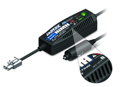

2-Amp LaTrax DC charger – Main decal contains HKA14019
75054-1 | 1/18 LATRAX RALLY RTR |
76044-1 | 1/18 LATRAX SST RTR |
76054-1 | 1/18 LATRAX TETON RTR |
