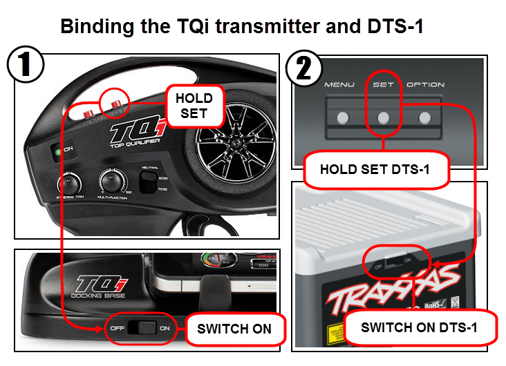

STEP 1: Bind the TQi transmitter to
the DTS-1 Starting Line console
1. Hold the SET button on the TQi transmitter as you switch it on. Release the SET button. The transmitter is now in Bind mode.
2. Hold the SET button on the Finish Line console as you switch it on. Release the SET button. The console is now in Bind mode.
3. Allow the console and TQi transmitter to bind automatically.
4. If prompted, update firmware. See "Updating Firmware" below for more information.
5. Power off the transmitter and console when the update is complete.
6. Repeat Steps 1-5 for the Starting Line console. Note: the Starting Line console's buttons are labeled on the Sun Shade. Install the Sun Shade now if you have not already done so.

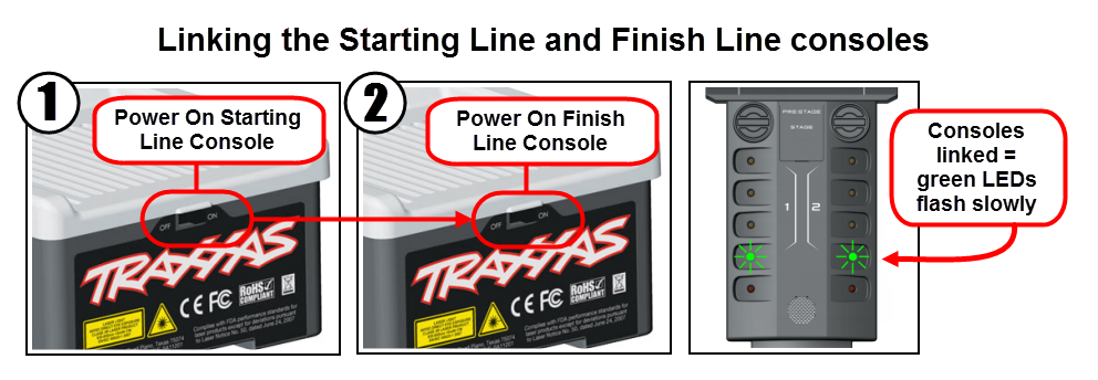

STEP 3: Link the DTS-1 Starting Line and Finish Line consoles
1. Power on the Starting Line console. Press and hold the SET button on the console until the console beeps twice, and then release.
2. Power on the Finish Line console. The two consoles will link automatically. NOTE: The consoles must be switched on within ten seconds of each other or the link mode will time out.
3. When the consoles are linked properly, the green LEDs on the DTS-1 Starting Line console will flash slowly.

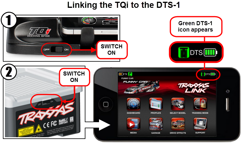

STEP 4: Link the TQi to the DTS-1
1. Switch on the TQi transmitter and launch the Traxxas Link application.
2. Switch on the Starting Line console. Since they have been previously bound, the transmitter and DTS-1 should link automatically, and the DTS-1 icon will glow green in the upper right corner of the Traxxas Link screen.

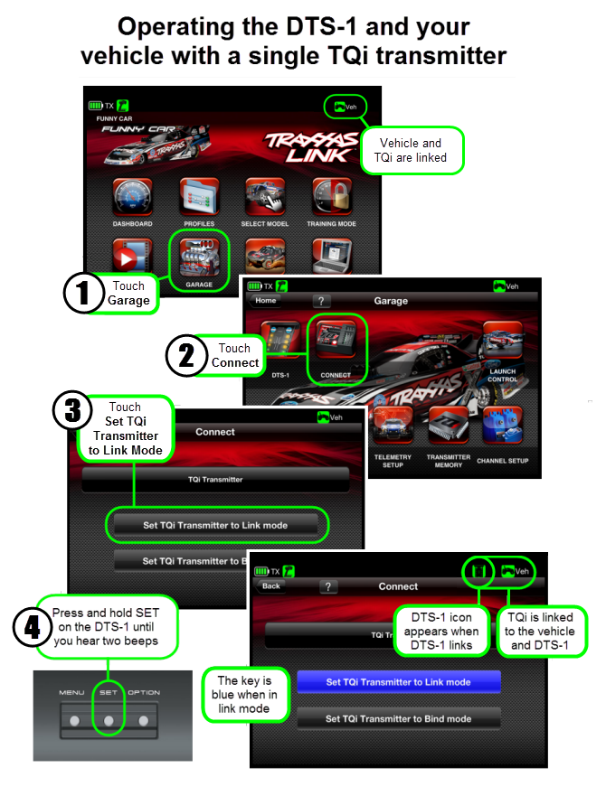

The TQi transmitter can be linked to the DTS-1 and a model at the same time, so you can operate the DTS-1 and race a vehicle with the DTS-1 using one transmitter. If you have not already bound the TQi to your model and the DTS-1, do so now. This will allow the model and DTS-1 to link to the TQi at the same time. It does not matter if you link the vehicle first, or the DTS-1 first. Follow these steps:
1. Power on the TQi transmitter and launch the Traxxas Link application.
2. Power on either your model or the Starting Line console.
3. The transmitter and model or console will link automatically. The DTS-1 icon or Veh icon will show green in the Traxxas Link status bar, depending on what you've linked to.
4. At the Traxxas Link home screen, touch the Garage icon.
5. Touch the Connect icon to access the Connect screen.
7. Touch Set TQi Transmitter to Link mode. The key will turn blue, indicating the TQi is in Link mode.
8. Power on the second device you wish to link to. It will link to the transmitter automatically.
The Connect screen may also be used to bind two devices to one TQi transmitter. Follow the instructions above using the Set TQi Transmitter to Bind mode key instead of the Set TQi Transmitter to Link mode key.

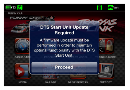

Updating Firmware
When you Bind the TQi transmitter to the DTS-1 console, the Traxxas Link App may ask you to update firmware. Follow the prompts to complete the firmware updates. The App will indicate the progress of each update as it proceeds. Once the update has completed successfully, touch the Leave Update Screen key, and then power off the transmitter and device.
