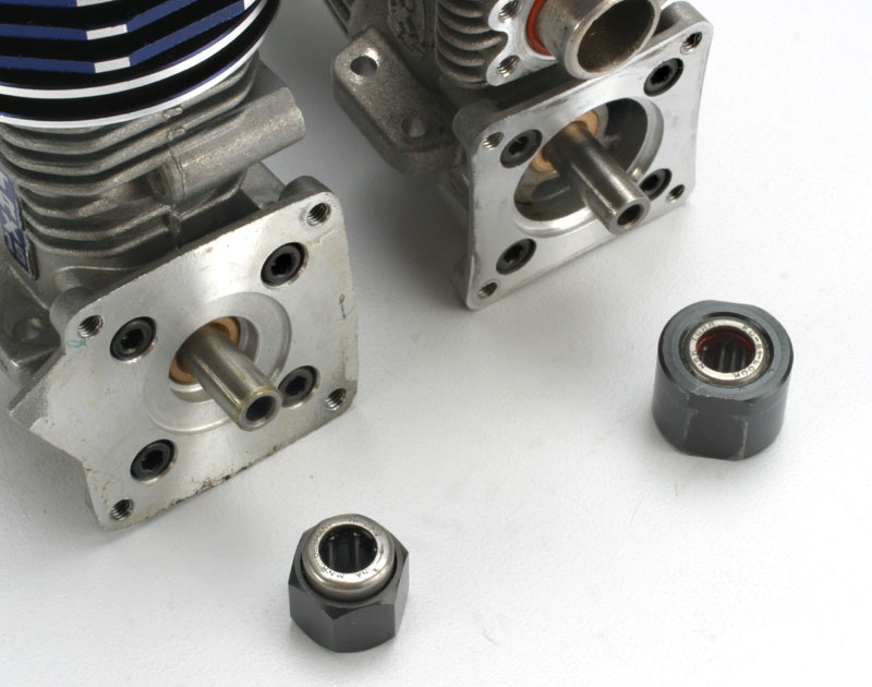

STEP 1: Note that on some models, the rubber exhaust pipe will require removal in order to gain access to the EZ-Start® mechanism. you’ll need to remove the engine from the Revo, Nitro Vee, and all nitro Maxx truck models in order to access the EZ-Start®. Remove the EZ-Start® by loosening the three 3x8mm round head machine screws that thread into the engine back plate. Next, remove the one-way bearing, but first take note at the way the bearing is installed. The text located on one side of the bearing must face the engine case when installed onto the starter shaft.

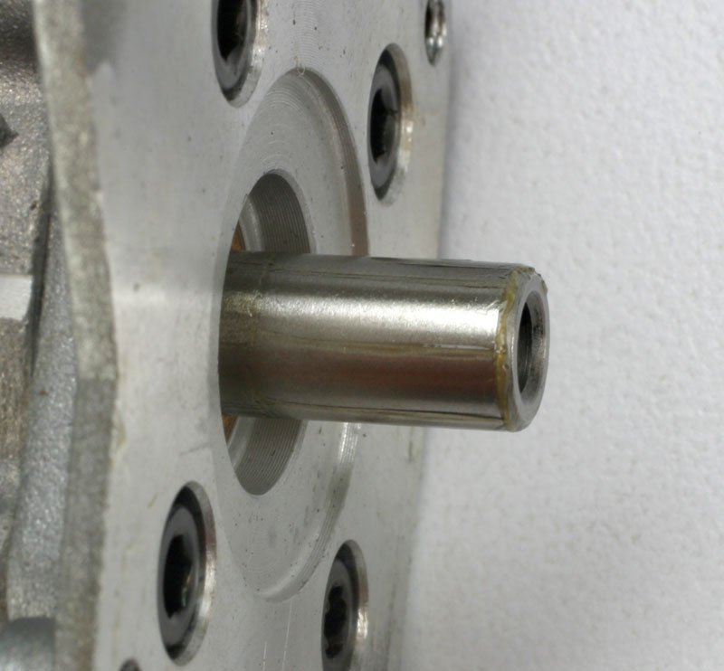

STEP 2: Clean the engine’s starter shaft with a rag. Make sure to remove all of the oil deposits from the shaft and the EZ-Start® back plate. Check to make sure that the starter shaft is smooth (like the one in the photo). If there are any scratches or grooves in the shaft, it should be replaced, or damaged can occur to the one-way bearing as well.

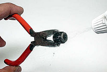

STEP 3: Thoroughly clean the one-way bearing with denatured alcohol, or an electric motor cleaner designed for electric RC model cars. Set the one-way bearing on a paper towel and let it dry before reinstalling it on the starter shaft.

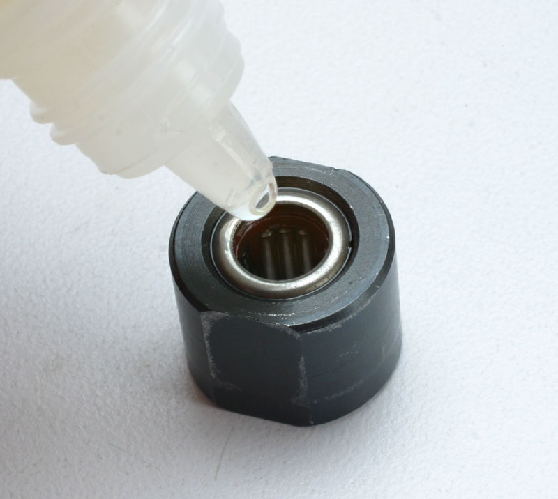

Step 4: Lubricate the roller clutch with a few drops of Mobil 1 5W-30 synthetic motor oil, and place it onto the starter shaft. You may now reattach the EZ-Start® mechanism.

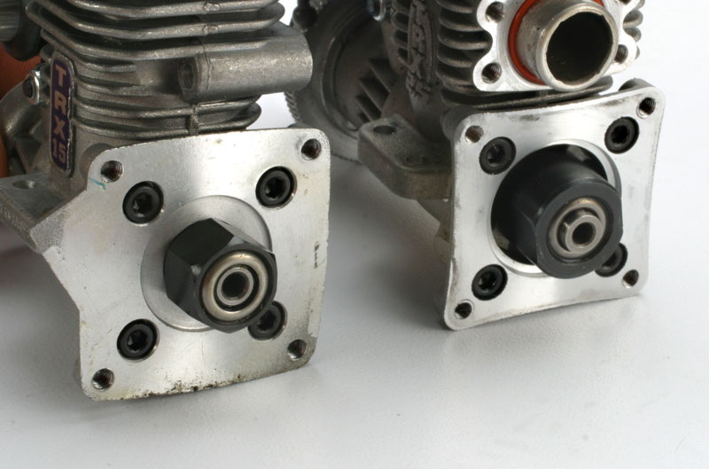

Note: The one-way bearing MUST be installed with the text (shown in picture) facing the engine case for proper performance. Once installed onto the starter shaft, the bearing should spin freely counter-clockwise, and engage the shaft when turned clockwise.
