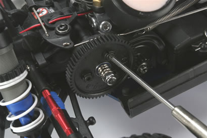

Step 1: Remove spur gear using a 2.5mm hex wrench.

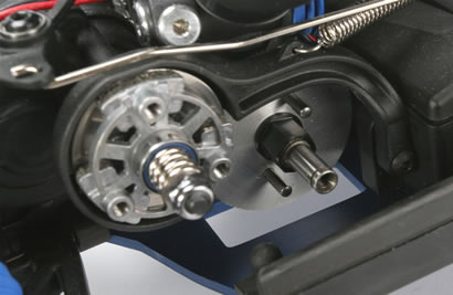

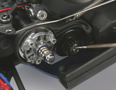

Step 2: Remove clutch bell by popping off the 5.0mm E-clip with a small screwdriver.

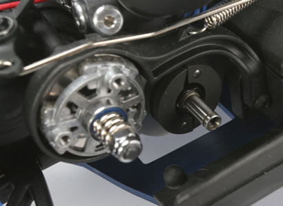

Step 3: Remove the clutch shoes and spring from the flywheel.
