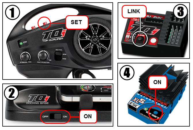

How do I bind the transmitter to the receiver?
The transmitter and receiver are bound at the factory. Should you ever need to re-bind them, or if you wish to bind an additional receiver to the transmitter, all you have to do is press and hold the transmitter's SET button as you turn it on. Press and hold the receiver's LINK button as you power up your model, then wait for the transmitter's and receiver's status LEDs to turn solid green—which only takes a second or two.
