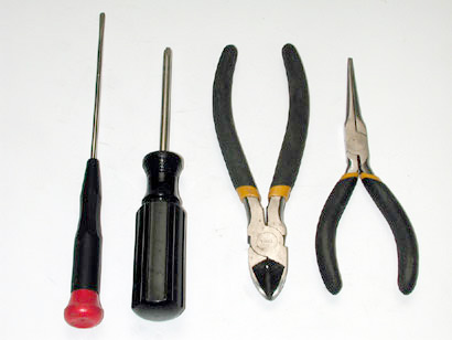

Tools
1. Small flat tip model engine-tuning screwdriver
2. #1 Phillips screwdriver
3. Medium size wire cutters
4. Medium size needle nose pliers

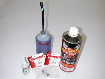

Accessories
1. Spare glow plugs (#3231, #3232, or #3232X)
2. CA glue (for tires)
3. Fuel 10%- 33% (Traxxas Top Fuel™ recommended)
4. Fuel bottle

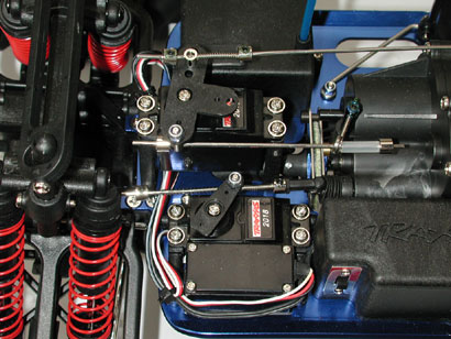

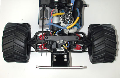

After gluing the tires and installing the radio system batteries, the next step is to perform a radio systems check. Checking the radio system is the first thing that I'll cover and is probably the most important. A malfunctioning radio system can potentially cause more damage than any other component on the vehicle due to a runaway crash. It is very important to perform a radio system check every time that you plan on running the truck. Make sure that all three servos have full range of motion and are not glitching or binding in any manner.

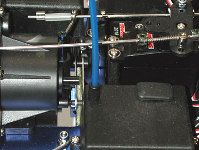

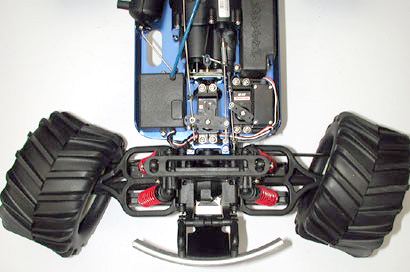

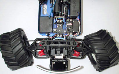

Note that the front of the truck should be lifted up to get full steering range due to the zero-scrub steering design. This design utilizes the centrifugal force of the wheels to help steer the truck. When the truck is rolling the steering has no problem going from lock to lock.

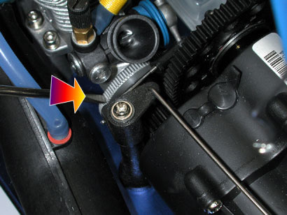

Next, make sure that the slide valve in the carburetor is returning all the way back to the preset idle position and that it is operating smoothly.

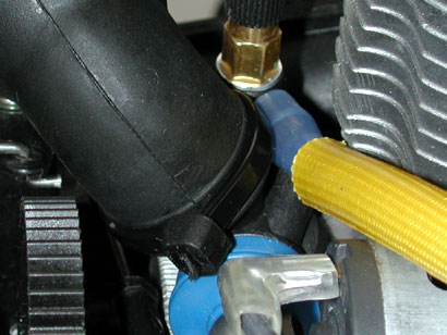

  • Make sure that there is a zip-tie around the base of the airfilter. This will keep the airfilter secured to the carburetor. It is very important that the airfilter stays on the carburetor anytime that the engine is running. Running the engine without an airfilter can and will cause severe damage to the piston and sleeve ruining the performance of the engine.

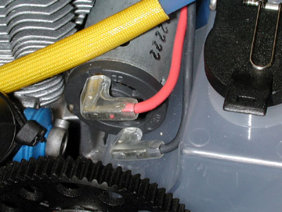

  • Check the connections on the EZ-Start®. Make sure that the positive and negative wires are connected to the proper terminals and are secured to the electric EZ-Start® motor. Also check the connection between the blue glow plug wire and the glow plug. The wire should be snug on the glow plug and then inserted inside the protective slot of the head protector.

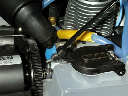

  • Here's a handy tip, slide a zip-tie through the slot at the end of the fuel tank lid so that the long end of the zip-tie is pointing upward. This will act as a handle so that re-fueling the truck with the body on is much easier.

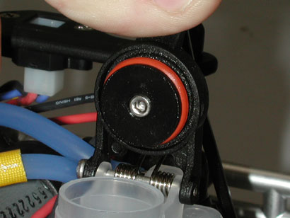

  • The last thing that we'll check before heading out to break-in the engine is the seal between the fuel cap and the tank. This is adjustable with a 2.5 hex wrench. Your lid may not need adjustment, but it's a good thing to check anyway. The orange o-ring that seals the tank should fit snugly into the filler neck of the tank.
    It should also fit all the way down into the filler neck.If the cap closes very easily with out any tension between the o-ring and the filler neck, then the o-ring is set too loose. Turn the adjustment screw clock-wise to tighten. This will spread out the o-ring providing a tighter fit. The opposite is needed if the cap will not retract all the way back into the filler neck.

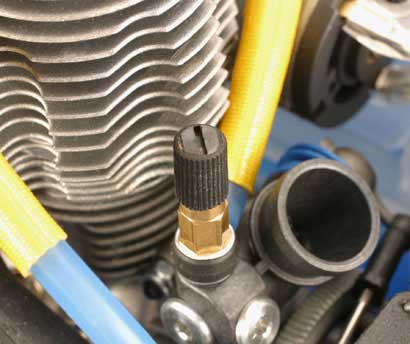

Hi-speed needle
A good starting point for the TRX 2.5 or 3.3 hi-speed needle is 4 turns out (counter-clockwise) from closed.

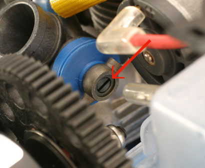

Low-speed needle

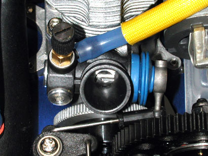

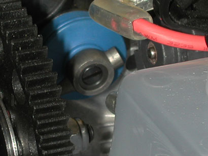

Notice the thin darker gray area between the low speed needle and the throttle arm. This is actually the other end of the slide valve from inside the carburetor. The low-speed needle is threaded into the slide valve and is set flush (even) with the edge of the slide valve. (Roughly 1.5-1.75 turns from closed) Note: This is a good base setting. Adjustments may need to be made to the low-speed needle for best performance in your running conditions.
Idle stop screw
Idle gap
The idle stop screw controls the idle speed by preventing the carburetor slide from closing completely. Turn right (clockwise) to increase idle, and left (counter-clockwise) to decrease idle.
A good starting point for the slide valve to stop at idle is a 0.7mm-1.0mm gap.

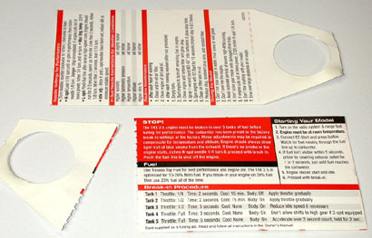

This is a very informative card and will be extremely valuable, especially to those of you that are new to nitro RC. You can tear the card at the perforation and place it in your wallet or pit box. I wish that I had one of these when I got into nitro many years ago. It would've saved me from many hours of frustration.

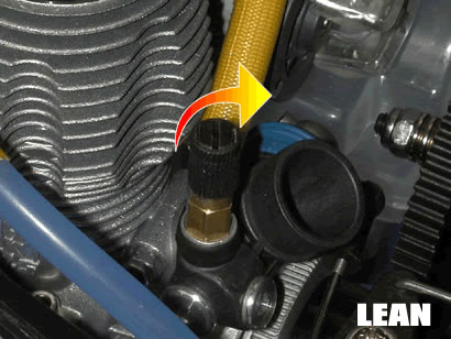

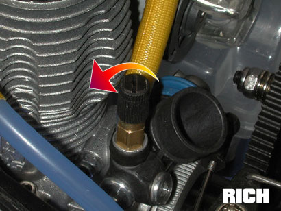

Hi-speed needle adjustment - After running the truck through the five tanks of break-in it is time to tune the engine for performance. The engine produces a lot of power even at a break-in setting, but that's just the beginning. Start the truck up and make a few passes back and forth gradually giving the truck more throttle. Once you've made four or five passes back and forth, the engine should be up to a good tuning temperature, (I'll speak more on engine temperature later in this segment). Lean the hi-speed needle by turning the needle clockwise 1/16 of a turn and make a few more passes.
This should increase the power output of the engine. The engine should accelerate very quickly and rev up to a high RPM without cutting out or running erratically. Remember, more lean doesn't always mean more power. Tune the needle until you reach peak performance.
When you let off of the throttle, the engine should slow down to a reasonable idle without jerking the transmission into gear. Also, the engine's RPM should not jump up and down when sitting at idle. The engine should idle smoothly without engaging the transmission and without dying.
If you feel that the engine has not yet reached its best performance, continue to lean the hi-speed needle 1/16 of a turn at a time and make a few more passes. You must make a few high-speed passes after each needle adjustment to determine what the engine is going to do. As you lean out the mixture setting, the engine may want to idle at a higher RPM. If this happens decrease the engine's idle by turning the idle stop screw counter-clockwise until the idle comes down to a reasonable level as described above.
Remember that you should always see a puff of smoke from the exhaust pipe under acceleration. As the truck builds speed the trail of smoke will become less noticeable, but should always be there. If the smoke is gone, then that means that there is an inadequate amount of lubrication going through the engine and this can cause permanent damage to the piston and sleeve. If this happens, richen the hi-speed needle ¼ turn until you see smoke during your high-speed passes and the engine should get back to running and idling reliably.
If you have found yourself turning the hi-speed needle every which way and have lost track of the setting and you are having no luck with getting proper performance, take a deep breath and relax. Shut off the engine and think of a happy place. Don't feel bad. Believe me, we've all done it at one time or another. Turn the hi-speed needle all the way in just until it stops.
Back the needle out four complete turns. This is a good starting point for break-in, which will put you back to where it was when you pulled it out of the box. The base setting for the low-speed needle is when the adjustment head of the needle is set flush with the metal housing that surrounds it. Always start rich and tune for performance.
Low-speed needle adjustment - Once maximum performance is attained out of the hi-speed needle adjustment, it is time to adjust the low-speed needle.
It is imporant to adjust the hi-speed needle first, before adjusting the low-speed needle. With the hi-speed mixture set correctly, and the engine producing good power and speed, bring the truck in and listen to the engine idle down. If the engine is "hanging up" or taking a while to idle down to a reasonable RPM, then the low-speed needle could be too lean.
Remember to try and get the idle down by adjusting the idle stop screw counter-clockwise first. If the low-speed needle is too lean, then the idle adjustment will not have much of an effect on the idle. Turn the low-speed needle adjustment counter-clockwise a little at a time until the engine RPM is comes down to a reasonable level.
The idle of the engine is affected by both of the needle adjustments and the idle stop screw. The low-speed needle has a greater effect on the idle speed than the hi-speed needle. One of the more common problems that I see with tuning engines is that some people will try and compensate for a low idle caused by rich low-speed mixture setting by cranking up the idle stop screw.
Try to keep the idle gap as small as possible. The gap is usually happy around the 0.7mm to 1.0mm mark. If you find yourself having to go beyond the 1.0mm mark then there is a good chance that the low-speed mixture is a little on the rich side. If you are turning the idle stop screw out so much that the RPM is no longer being affected but is still too high, then the low-speed needle is too lean.
Keep in mind that the above conditions and adjustments are usually found in an extreme situation when the truck wants to kick into gear or the engine is hanging up badly. Once you have corrected these problems or if they just simply do not apply, then it's time to move on to fine tuning the low-speed needle with the low-speed mixture test.
Before you proceed any further, think about what your truck is doing. If you are already getting excellent power and punch out of your TRX 2.5 and the idle is smooth and consistent, then you need not adjust anything. Go have fun. Try not to make a huge deal out of getting that "perfect" setting. The TRX 2.5 produces so much power that it is not as critical to get that "perfect" mixture to have a lot of fun with this truck.
Low-speed test - Once the engine is up to a good running temperature, make a few high-speed passes back and forth and bring the truck in. As soon as the engine idles down pinch the fuel line between the EZ-Start® motor and the carburetor with a pair of needle nose pliers. This will keep you from burning your fingers on the cooling head. The engine should idle up for 3 to 5 seconds then try to stall. Let go of the fuel line just before the engine stalls. If your engine falls within the 3 to 5 second range then it should be good to go.
If the engine immediately stalls, then the low-speed mixture is too lean.
Richen the low-speed needle counter-clockwise 1/8 turn and retest after making a few more hi-speed passes. If the engine idles up for more than 5 seconds then lean the low-speed needle clockwise 1/16 turn and retest.

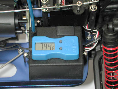

Tuning the Engine in by Temperature:
Tuning the engine by temperature is another way to adjust the carburetor to maximize performance. This is something that should only be used as a guideline and should not be used as the sole tuning method. There really isn't a perfect set temperature for every engine since these are air cooled engines. Weather conditions, fuel type, ventilation and many other variations around the engine will change the "happy" temperature for each engine. I try to discourage nitro owners from falling into this temperature trap.
The best way to tune the engine is to watch and listen to what the engine is doing. When the engine is running strong and reliably with plenty of smoke coming out of the pipe, then check the temperature at that point. This should be a guide to where the temperature needs to be for that particular driving condition. Maximum temp for any condition should generally not exceed 270 F, but some conditions or high revving race operation may require warmer operating temperatures.
The temperature can provide good feedback to make sure that you are going in the right direction. If the temperature goes up but performance doesn't increase, then the engine may be too lean. One way to bring engine temperatures down is to cut a hole in the windshield directly in front of the engine for extra airflow around the cooling fins. The hole should be around 2" to 2.5" in diameter. This is definitely recommended for anyone running his or her truck in a hot climate.
