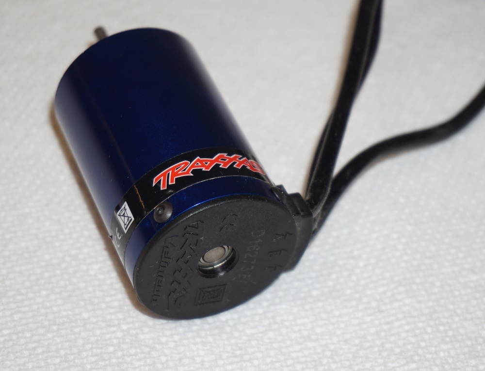

1. Inspect the motor

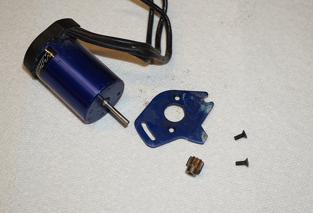

This motor came to our repair lab with symptoms of overheating. Some surface rust is evident on the pinion gear and the motor feels scratchy when you spin the gear by hand. This is typically the sign of a failed bearing.

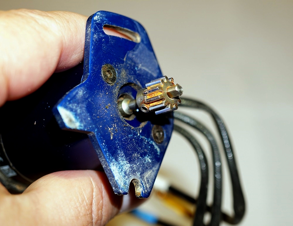

2. Remove all parts
Begin by removing everything from the motor. Use a 2mm hex driver to remove the motor plate screws and a 1.5mm driver for the grub screw on the pinion gear.

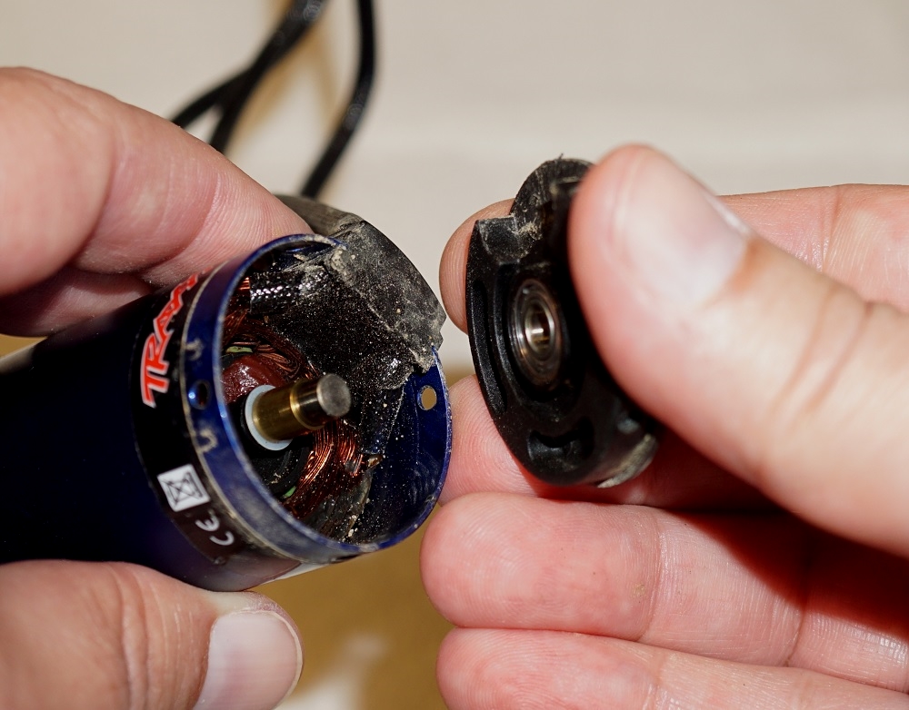

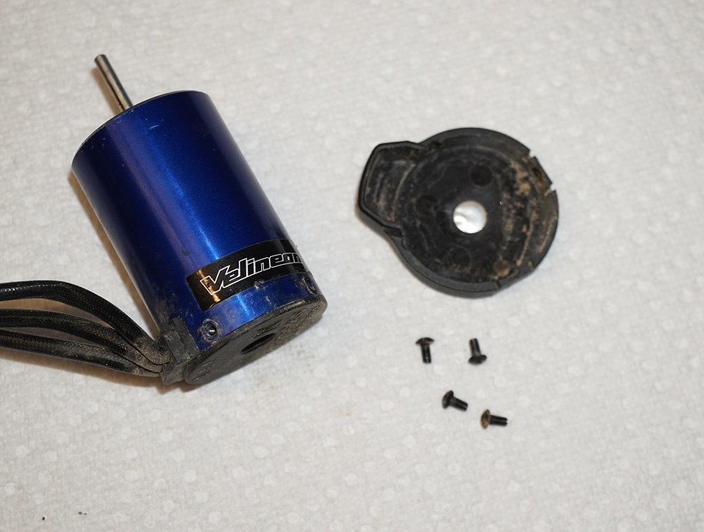

3. Remove the plastic cover
Pop the plastic cover off the end of the motor. Use the 1.5mm hex to remove all four screws securing the end bell.
4. Remove the end bell
Gently pry the end bell out of the end of the motor. It is not necessary to remove the bearing since the rebuild kit includes a new end bell. Do not lose any thin shims which may be on the motor shaft. They will be reused.

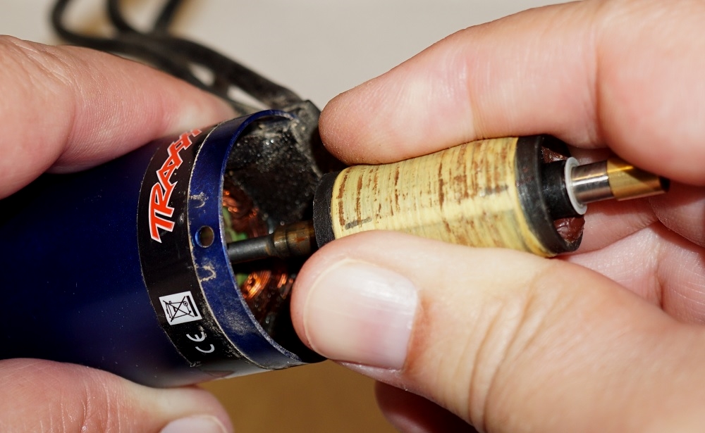

Remove the rotor
The rotor is held in place by a strong magnetic field. Press the motor shaft down onto a hard surface like a table. This will push the rotor through the can. Grip the rotor tightly and pull it out of the can. Be careful when removing the rotor! The magnetic force can cause the rotor to snap back and pinch your fingers.

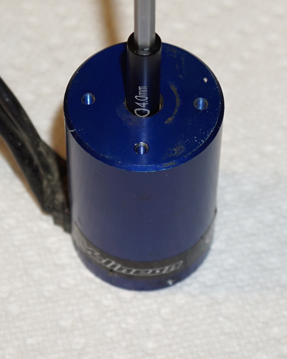

Tap the front bearing out
With the rotor out, it’s time to remove the front bearing from the aluminum can. This bearing can be difficult to remove. The 4mm nut driver from the Traxxas Tool Kit is the perfect size to tap the bearing out without breaking it.

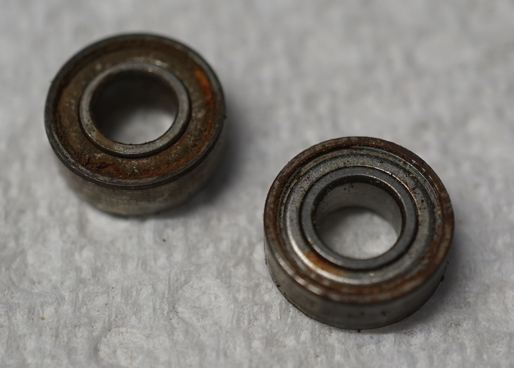

Inspect the bearings
A closer inspection of the bearings reveals the problem. These bearings have almost rusted solid, causing the motor to work harder and overheat. After bearings get wet, it is important to spray them with WD-40 to expel any water. This will keep them healthy and running smoothly. Fortunately this motor can be rebuilt to restore its full performance.

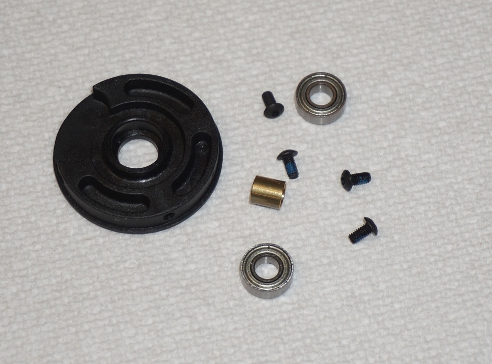

Install the replacements parts
The Velineon 3500 rebuild kit contains all the parts required to rebuild this motor. Spray out the motor can with an electric motor cleaner spray if you have it or compressed air. Be sure to wear eye protection while cleaning out the can. Replace the two bearings and install the new brass bushing on the rear of the motor shaft. Reuse the thin washers on the motor shaft. They should be closest to the center.
