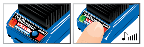

If the LED glows GREEN when the ESC is on, Low Voltage Detection is activated
How to Turn Low Voltage Detection ON
If your Traxxas speed control with Low Voltage Detection displays a red light when switched on, it means that Low Voltage Detection is switched OFF. To turn it ON, first turn on your transmitter and speed control. With the speed control already on, press and hold the EZ-Set button until you hear an ascending tone (if you have a VXL speed control) or two beeps (if you have an XL-5 speed control). Release the EZ-Set button and the speed control's LED will light green to show Low Voltage Detection is ON. If it does not light green, do not operate your model with a LiPO battery. Repeat the procedure. Call 888-TRAXXAS if you cannot activate Low Voltage Detection.
If the LED glows RED when the ESC is on, Low Voltage Detection is DEACTIVATED.
To turn Low Voltage Detection on, press and hold the EZ-Set button until you hear an
ascending tone (VXL speed controls) or two beeps (XL-5 speed control).
