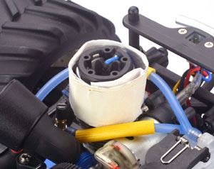

3: You can wrap the cooling head with a paper towel, clean rag or sock to help keep the engine running around the recommended 200 to 215 break-in temp. The idea is to reduce the efficiency of the cooling fins to allow the engine temperature to rise to an acceptable level. Be careful though, if too much heat is contained, the engine can actually run too hot. Make sure that you monitor the engine's temp closely for the first couple of tanks until you get the right amount of cover for the cooling head. This will, of course, depend on your current weather conditions. Adjusting the cover up and down, exposing more or less cooling fins is a convenient way to regulate engine temps.
