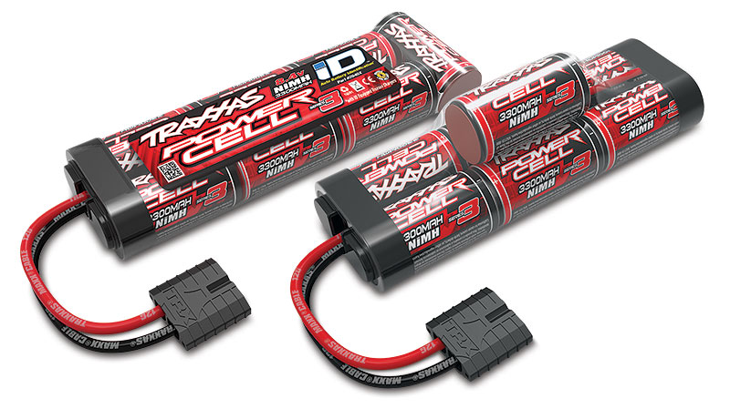

NiMH battery packs are composed of cylindrical 1.2-volt cells, similar to the AA, C, and D batteries that we're all used to installing in flashlights, TV remotes, and other devices. The rolled-metal construction of the individual cells, and the double-welded tabs Traxxas uses to connect the cells, makes them extra rugged. NiMH batteries can be discharged completely without harming the battery, and they do not need to be charged before storage. Traxxas NiMH batteries are offered with 6 cells (7.2 volts), 7 cells (8.4 volts) or 8 cells (9.6 volts).

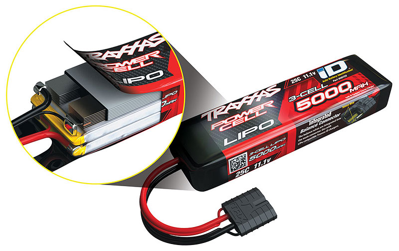

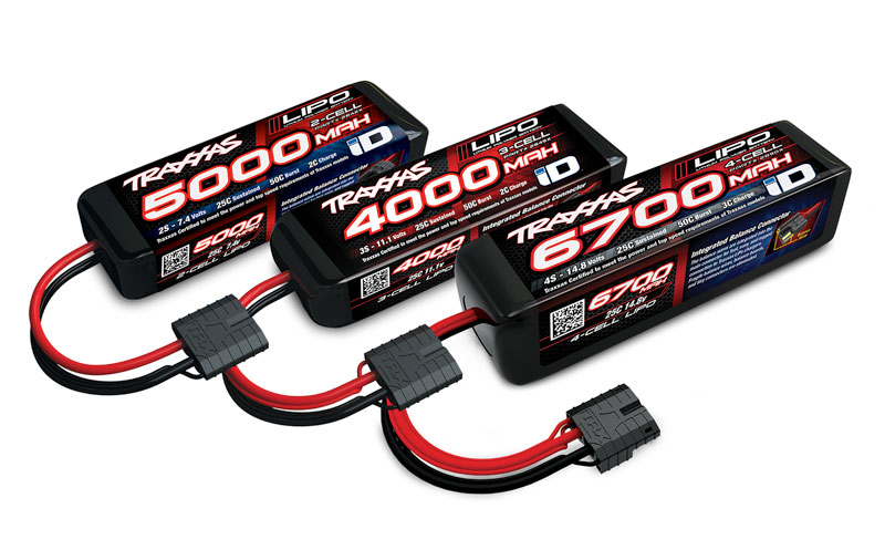

LiPo battery packs are composed of flat 3.7-volt cells. The cells are stacked and enclosed in a tough, semi-rigid wrap. Traxxas LiPo batteries are offered in 2-cell (7.4 volts), 3-cell (11.1v), and 4-cell (14.8v) configurations. LiPo batteries have greater “energy density” than NiMH batteries, meaning they have more voltage and capacity than a NiMH battery would of the same volume. LiPo batteries also sustain a higher voltage for a greater duration of each run, so your model will have more “punch,” go faster, and run longer with a LiPo than it would with a comparable NiMH pack.
NEVER charge a LiPo battery using a NiMH charger (or NiMH charging mode on a combination NiMH/LiPo battery charger). LiPo batteries can be damaged by over-discharging, which is why the electronic speed control on all Traxxas models has built-in Low-Voltage Detection to alert you when LiPo batteries have reached their minimum voltage (discharge) threshold. LiPo batteries should be stored partially charged, and require a LiPo-specific charger.

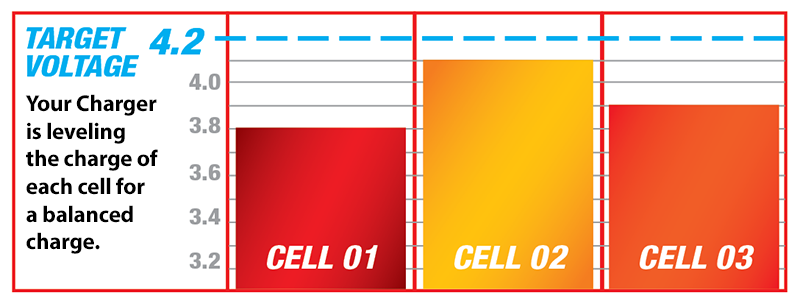

A LiPo battery is said to be “balanced” when each cell is charged to the same voltage. It takes a little longer to balance charge a battery, but doing so ensures that you'll get the longest run time from each charge. Balance charging also helps extend your LiPo battery's overall life by preventing over-discharging. Low-Voltage Detection in all Traxxas speed controls is designed to alert you when the battery's voltage drops below 3.2 volts per cell; however, the speed control reads total pack voltage and not the voltage of individual cells. For example, if you plug a 3-cell LiPo into your speed control, the speed control will alert you if the battery voltage drops below 9.6 volts (3.2 x 3 = 9.6). But if your battery is not balanced, that 9.6 volts might actually represent individual cell voltages of 3.3v, 3.3v, and 3.0v. The 3.0v cell has been over-discharged, which shortens the life of the pack. Balance charging your LiPo packs assures each cell is equally charged so their voltages will match as the cells discharge.

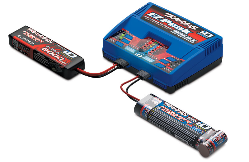

Inspect your batteries after every use to make sure they have not been damaged. Wipe your batteries down and check for frayed wires, missing insulation, and other signs of damage. Store your batteries in a cool, dry place. If you used LiPo batteries in your vehicle until the Low-Voltage Detection activated, your batteries will be nearing their low-voltage threshold. LiPo batteries should not be left in this depleted state. If you plan to reuse the LiPo batteries that day, recharge them soon after using them. If you do not plan to reuse the batteries immediately, use the Store Mode on your Traxxas iD® charger to prepare them for storage. For optimal performance and long battery life, you should place your batteries in Store Mode once a month.
