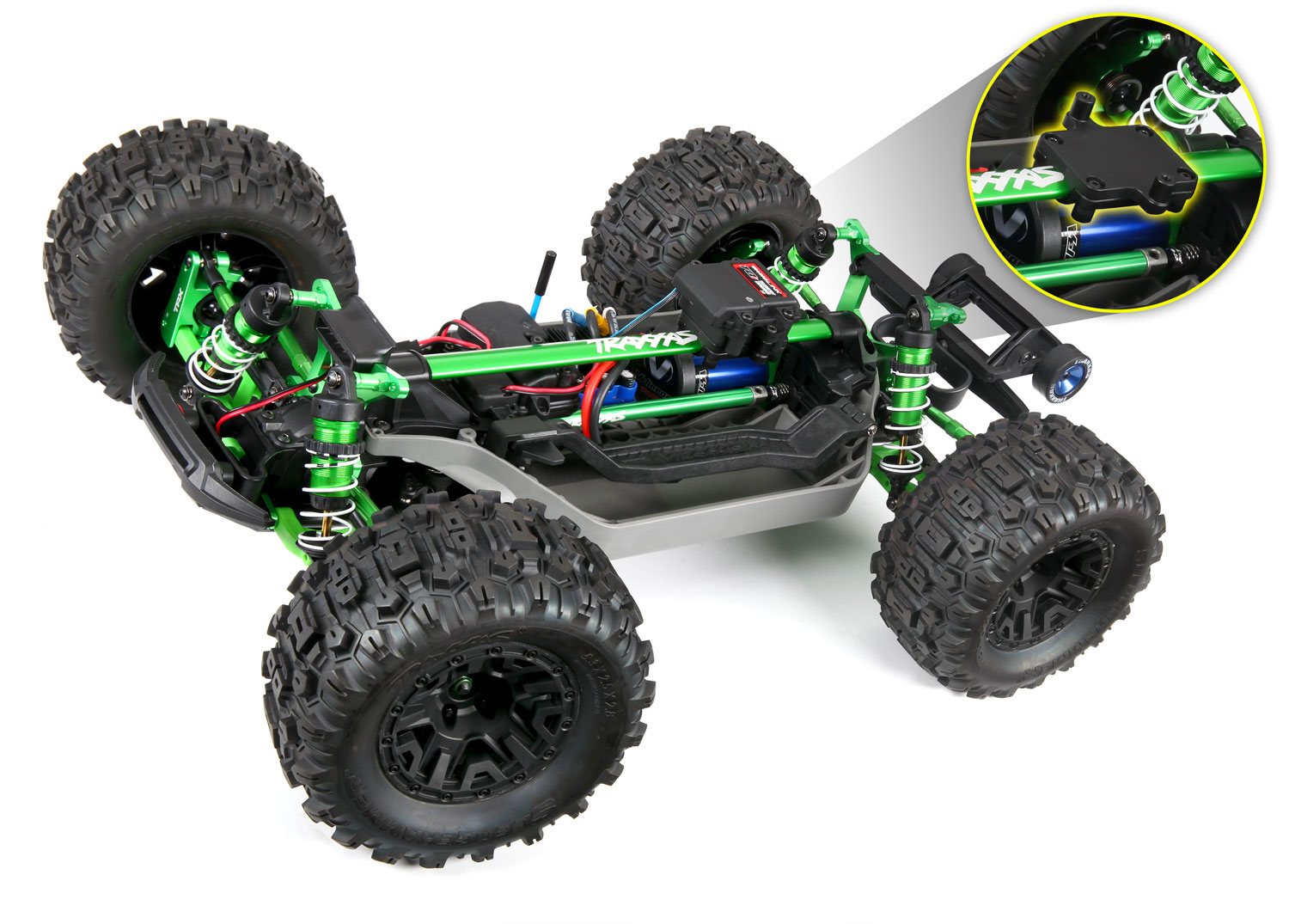

Whether you’re sending it at the skatepark or bashing full-bore on a construction site, a Heavy-Duty Chassis Brace can make all the difference. If you’ve already added one of these super-stiffeners to your low-CG Slash 4X4 or Rustler 4X4, you’ve probably been wondering if it’s possible to add the optional Telemetry Expander. Of course it is! Let’s find out how.

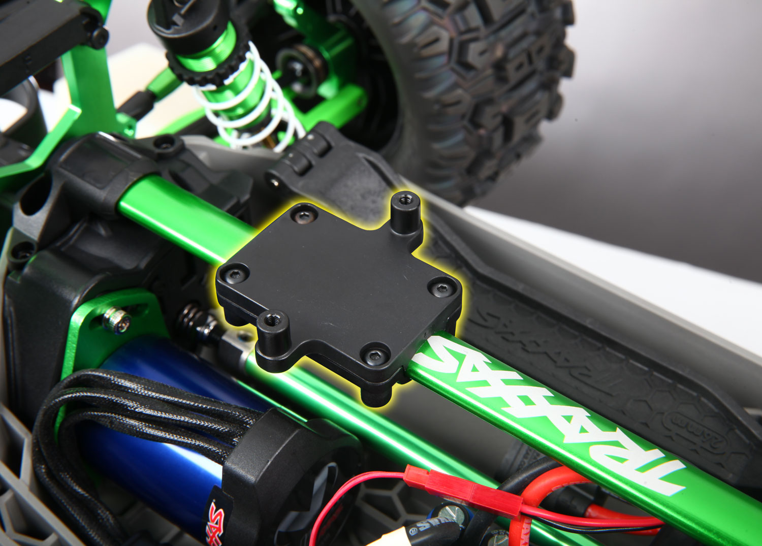

The expander mount includes all the parts to secure it to the braceThe expander mount includes all the parts to secure it to the brace.

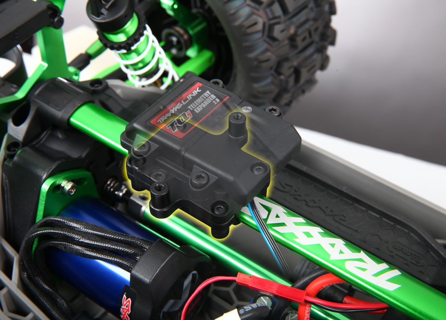

Secure the upper and lower halves of the mount to the brace with the solid half oriented on the top. Before you tighten the mount completely, do a test fit of the expander to make sure all the wires will reach and the body cage clears the expander. Once you are satisfied with the location, tighten the two halves down to the mount and then fix the Telemetry Expander 2.0 to the mount with two screws. If you want to learn more about the full potential of the Traxxas TQi telemetry system, GPS Module, or Traxxas Link check out this link.
Choose the location for your mountChoose the location for your mount.
Tighten the mount and secure the telemetry expanderTighten the mount and secure the telemetry expander.
