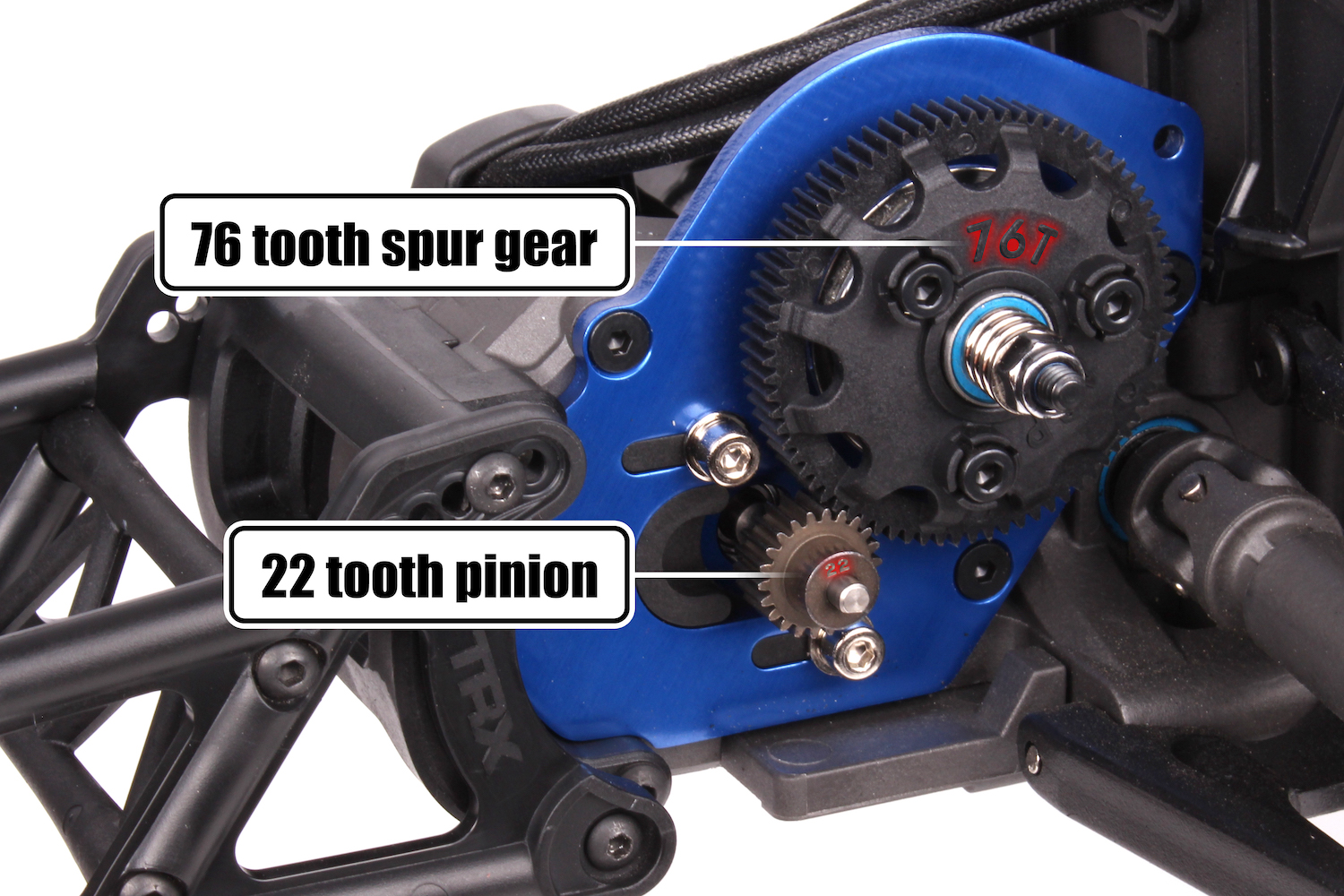

Out of the box, the Drag Slash is equipped with a 22-tooth pinion gear and a 76-tooth spur gear for a total gear reduction of 9.38:1 when combined with the transmission’s 2.72:1 gear ratio. This gearing offers a good combination of acceleration, top speed, and battery life for all-around driving and operating your Drag Slash continuously.
The Drag Slash’s standard 76/22 gearing is perfect for all-around driving fun.

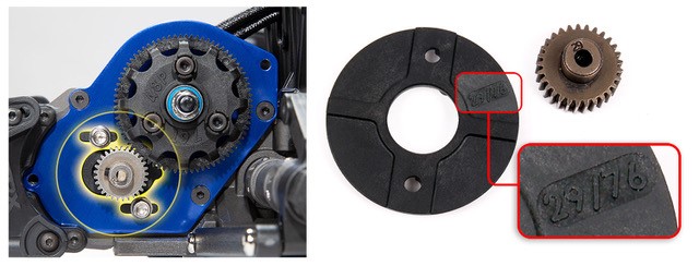

For competition with 2S LiPo power, install the optional 29-tooth pinion supplied with your Drag Slash. Extensive testing has determined the 29-tooth pinion offers the ideal mix of acceleration and top speed for a 132-foot track, the standard length for no-prep RC drag racing. Use this gearing for competition only, not continuous driving. Continuous driving with the competition gearing will overheat the power system and may damage the motor, just as a full-size funny car would surely overheat if you tried to drive it in rush-hour traffic.
The included 29-tooth pinion and matching Fixed Gear Adapter are for competition use. The adapter ensures perfect gear mesh and prevents the motor from moving in a crash or impact.
