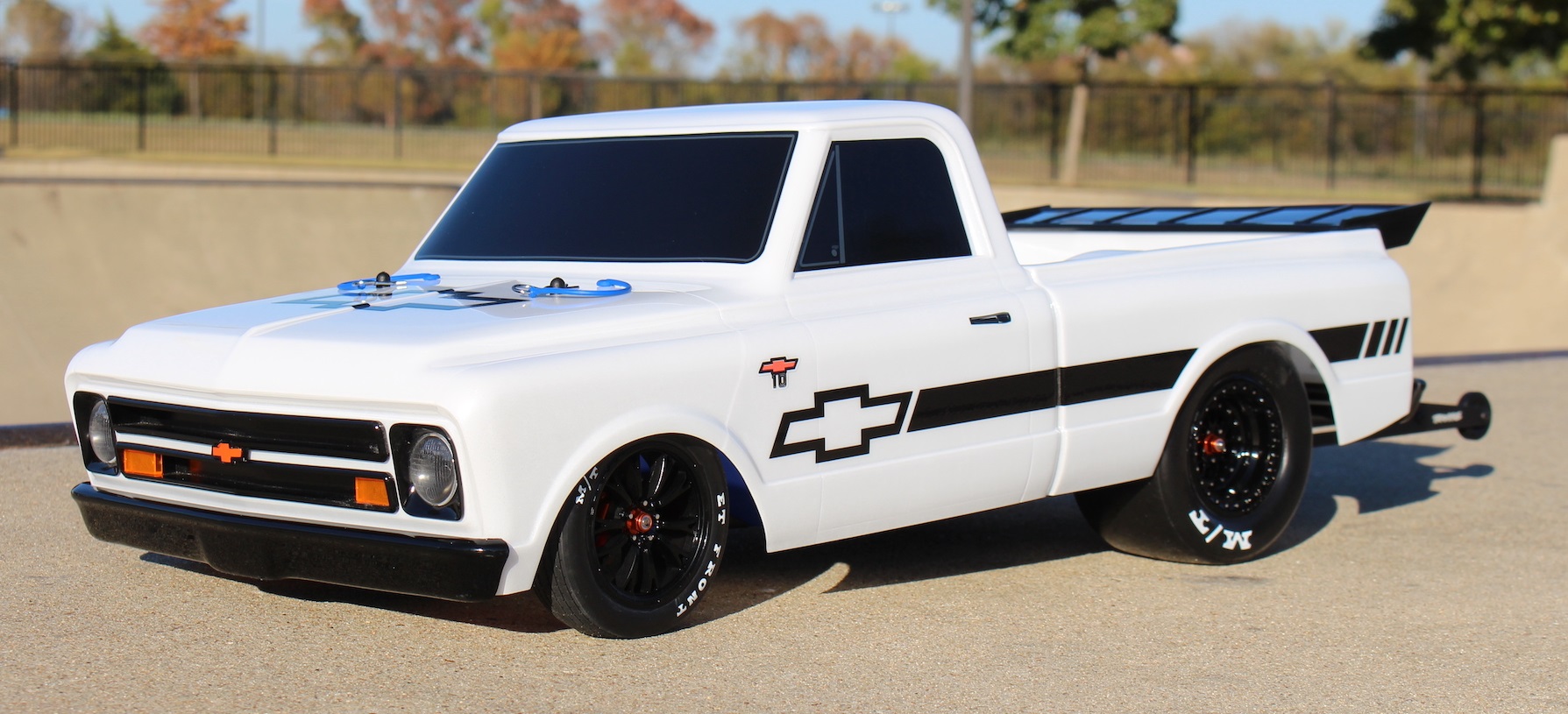

Completed Drag Slash
Here's a sneak peak at our finished Drag Slash. Now let's see how to customize it yourself.

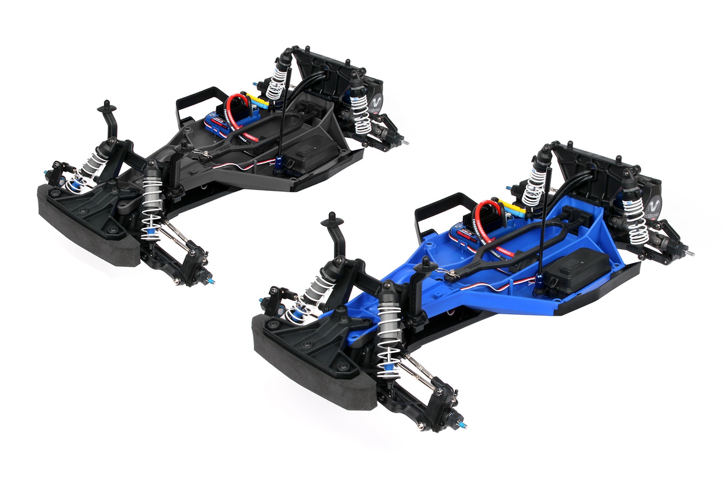

The Drag Slash is already equipped with the low-CG chassis that’s offered as an optional conversion kit for the standard “lifted chassis” Slash, so we’ve already got the best-performing setup. Strictly for style, we swapped the dark gray main chassis for the blue version. In the wheelie bar department, the options are a black-chrome bar (identical to the stocker accept for the black chrome finish), or a pair of anodized aluminum plates to replace the stock molded parts. We went with the aluminum plates for maximum rigidity.

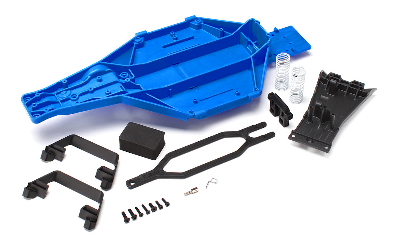

Low CG conversion kit
Since the Drag Slash is already equipped with the LCG chassis, we don’t need the full 5830 conversion kit just to get the blue main chassis. If you’re converting a standard 2WD Slash for greater track performance, the kit is the way to go.

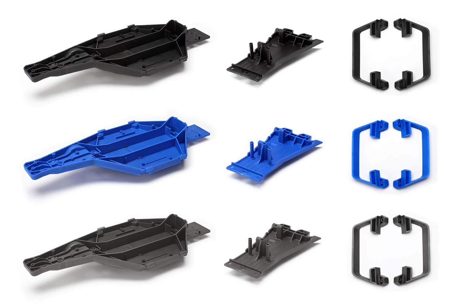

Available LCG colors
The LCG kit’s main chassis, lower chassis, and nerf bars are each available separately in black, blue, and gray to mix and match as you like.
Chassis colors
The bright blue chassis gives our Drag Slash a big pop of color, and it’s only going to get more colorful from here.

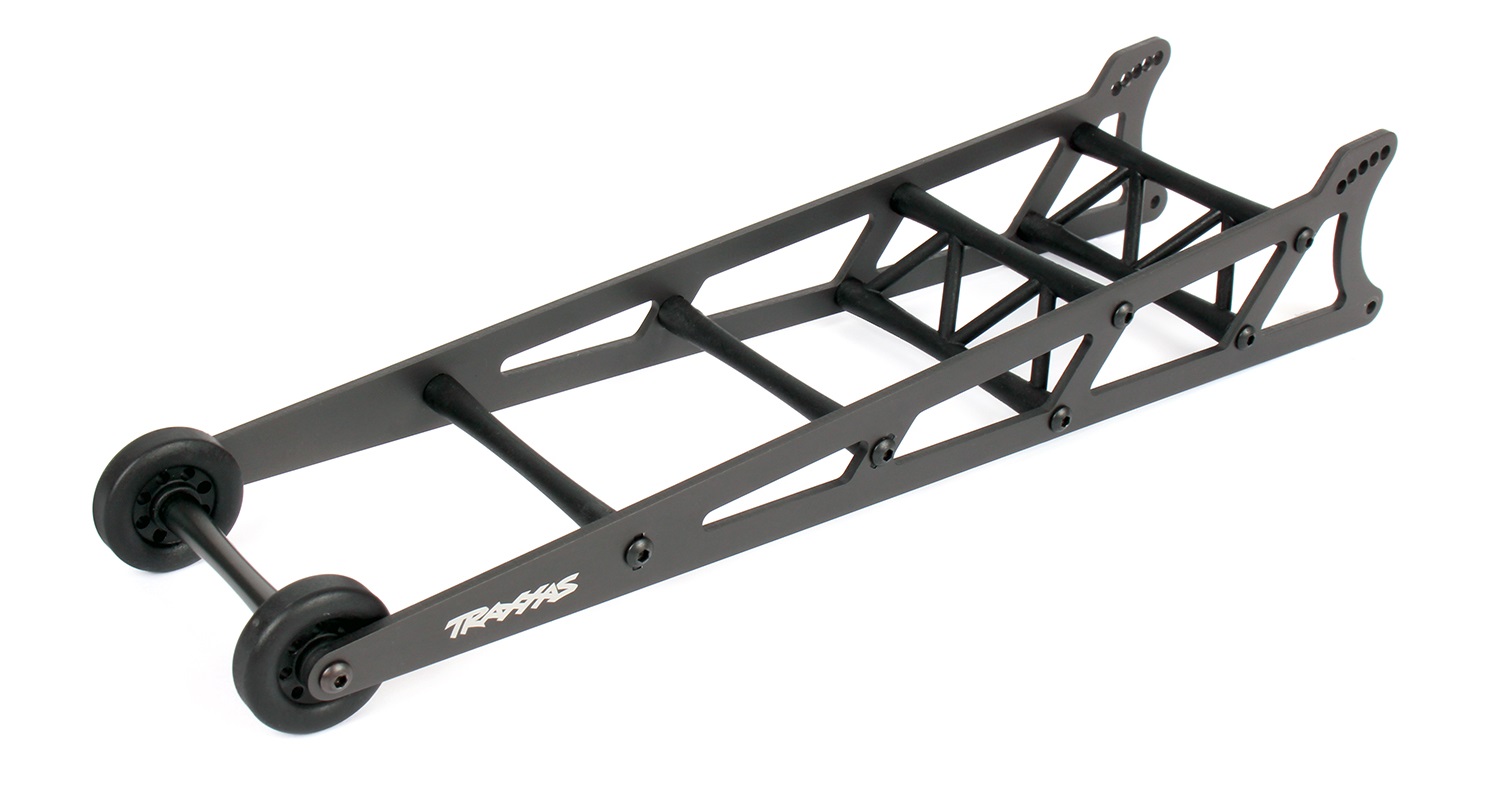

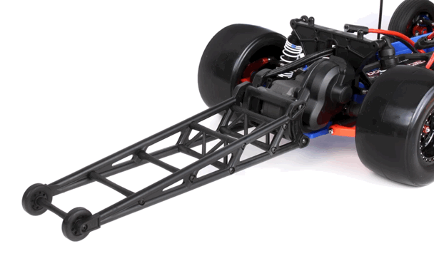

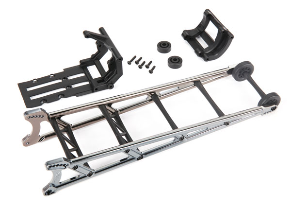

Black chrome wheelie bar
The 9460X wheelie bar adds a black chrome finish to the sides of the ‘bar and includes all the parts and hardware required for installation on a Bandit, 2WD Rustler, or a 2WD Slash with the LCG chassis. You can also install the Drag Slash wheelie bar on the Slash 4X4 and Rustler 4X4—learn how here.
Wheelie bar plates
Another option for the wheelie bar: 2.5 mm aluminum side plates to replace the stock molded parts. We chose the charcoal gray finish, you can also get the plates in anodized orange, blue, green, red, and pink.

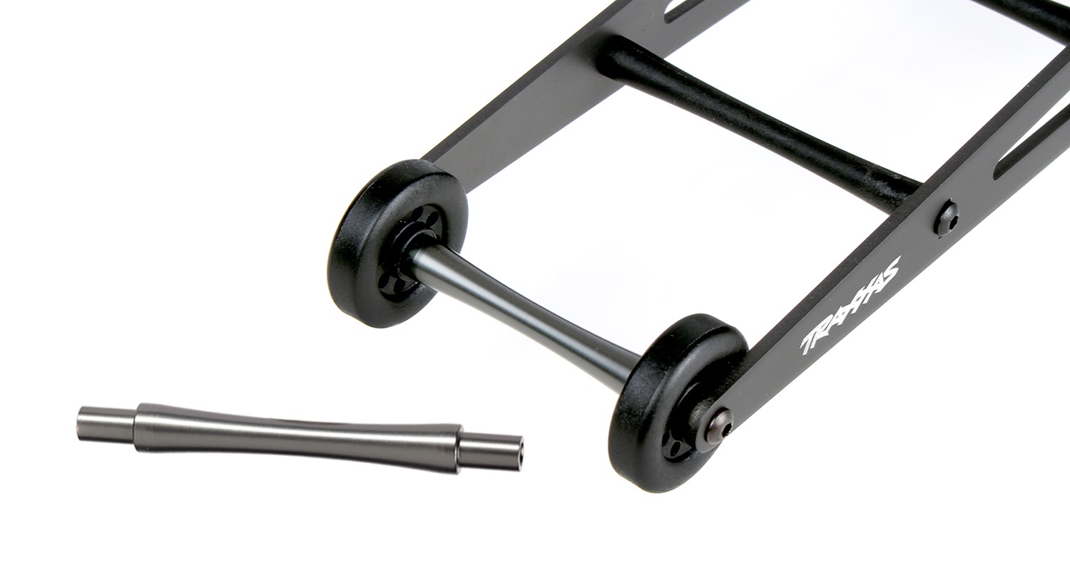

Aluminum axle
We also installed the optional machined aluminum axle in charcoal gray.
Wheelie bar optionsHere are the wheelie bar options installed: stock wheelie bar, black chrome, and the aluminum plate setup.

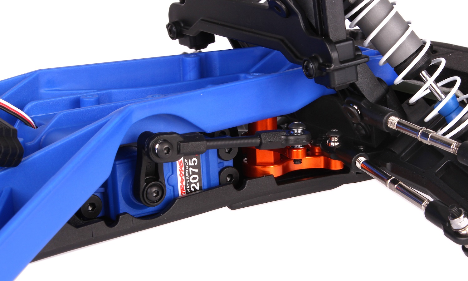

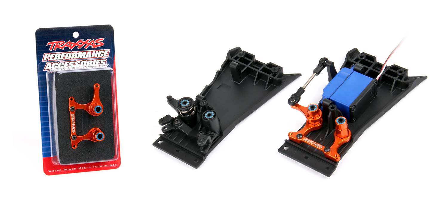

The Drag Slash’s stock servo-saver-equipped bellcranks protect the servo’s gears from impact damage. For maximum steering precision on the strip, we traded the servo-saver-equipped ‘cranks for rigid machined aluminum bellcranks. If we need a servo saver, it’s only a 5-minute, 2-screw job to install the 3744 servo-saver, which mounts directly to the servo in place of the rigid arm. The stock servo’s 125 oz-in of torque is plenty, but if you want more torque and metal gears you can choose the High Torque 330 (330 oz-in) or High Torque 400 (400 oz-in). In the suspension department, we reached for aluminum-body Big Bore shocks, Heavy Duty (HD) arms in orange, and aluminum hub carriers, caster blocks, and steering blocks. The Big Bore shocks’ PTFE-coated bores and scuff-resistant TiN shafts deliver the ultimate in smooth damping, and the combination of HD arms and aluminum upgrades boosts our Drag Slash’s durability rating to “bombproof.”

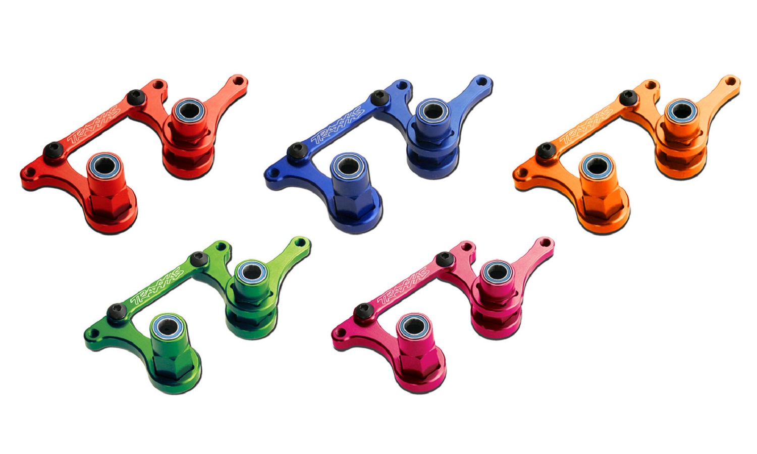

Aluminum bellcranks
The optional aluminum bellcranks are a direct replacement for the servo-saver-equipped ‘cranks. Hardware with pre-applied threadlock is supplied to attach the steering links.
Bellcrank color options
Like other Traxxas machine-aluminum parts, you can also get the bellcranks in red, blue, and green. Even pink, for some parts.
Completed steering
Here’s the completed setup with a sleeve of heat-shrink over the linkage for a blackout look. The orange bellcranks look great with the blue and black parts.

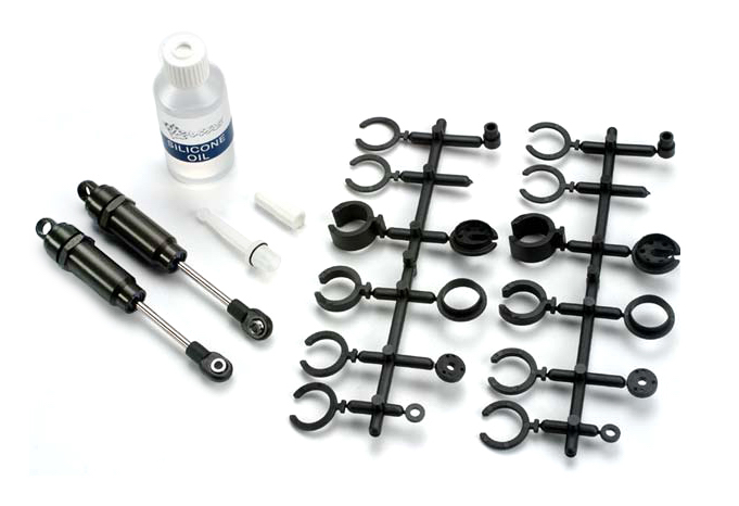

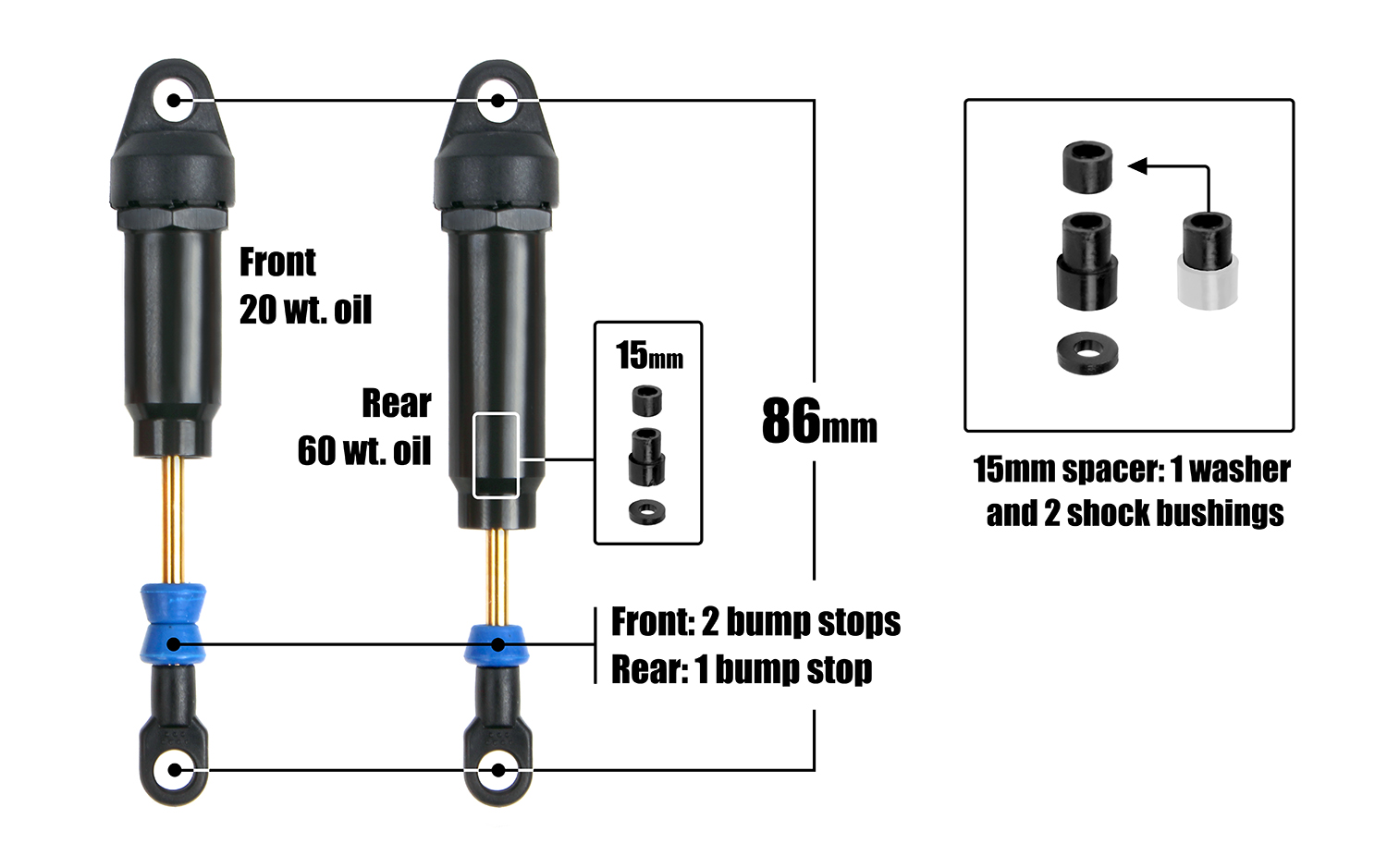

Big Bore ShocksBig Bore aluminum-body shocks feature a hard-anodized finish, PTFE-coated bores, and titanium-nitride treated shafts for minimum friction, maximum life, and peak performance. An off-road Slash uses “long” front shocks and “XX-long” rear shocks, but the Drag Slash uses “longs” front and rear. Two pair of the “long” 2660 Big Bore shocks are what you need to fully outfit a Drag Slash.
Big Bore Shocks

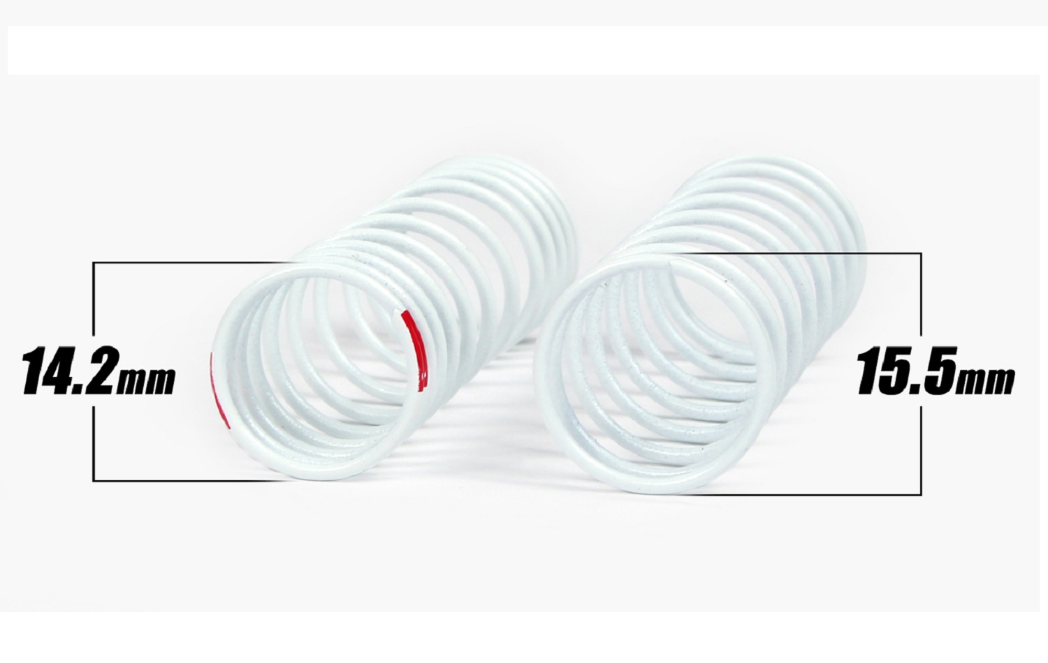

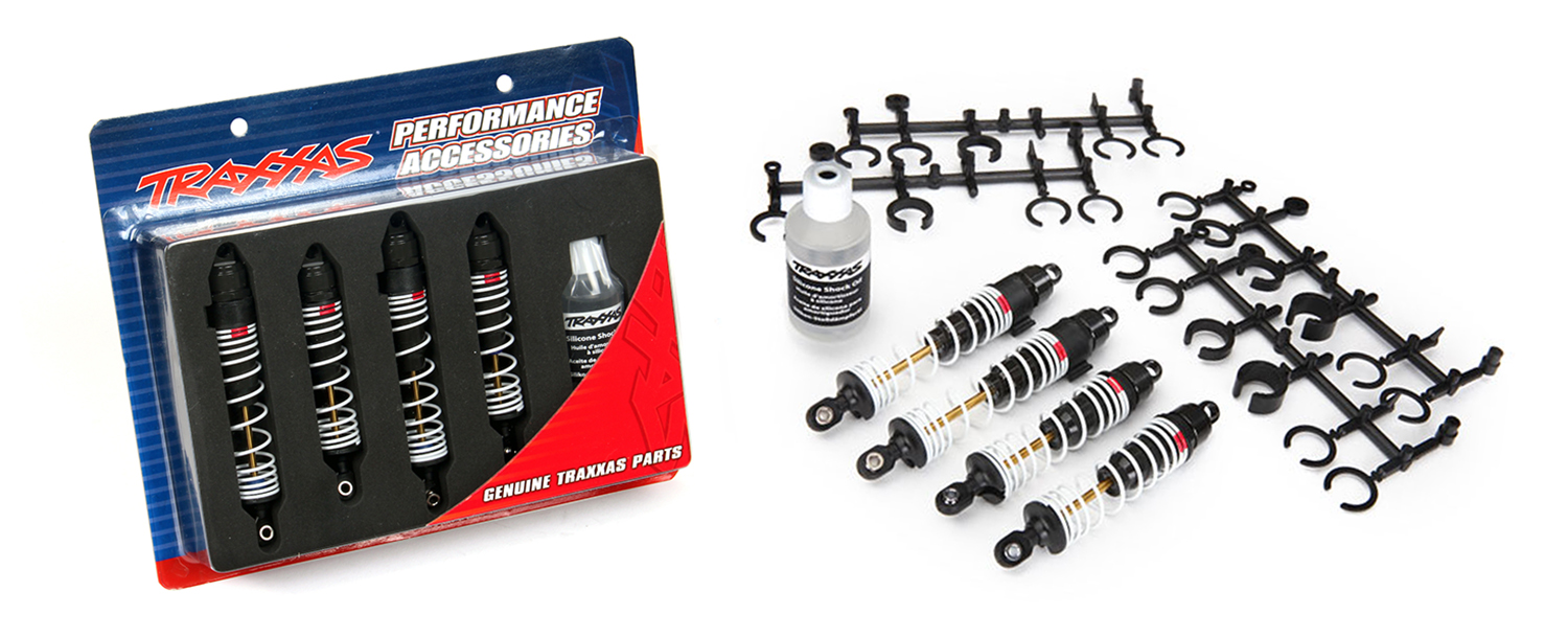

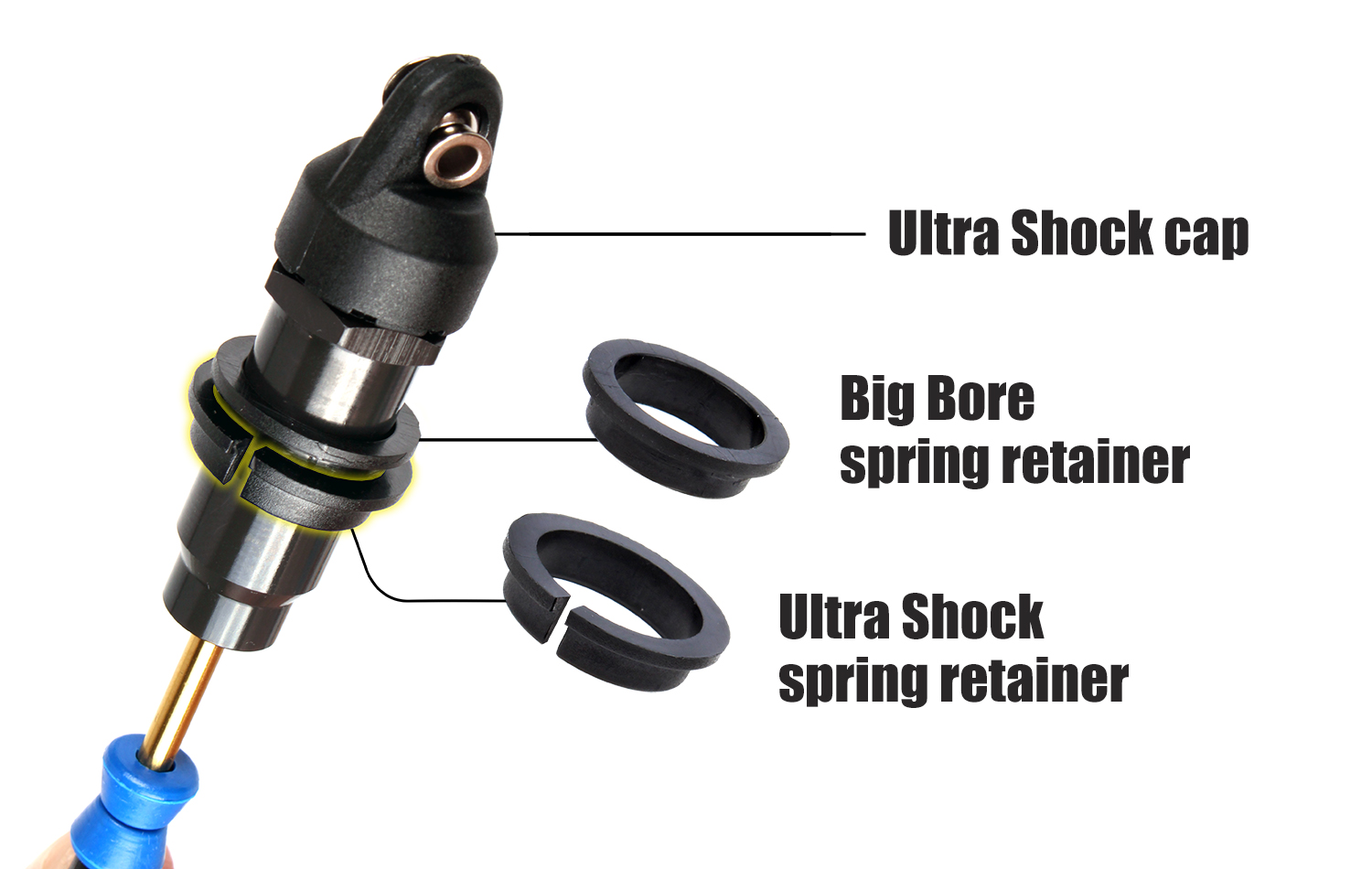

Big Bore shocks use springs with a 14.2 mm inner diameter (left), while the Drag Slash’s Ultra Shocks use larger 15.5 mm diameter springs. Swapping the Ultra Shocks springs over to the Big Bores without modification will result in a loose spring fit, but we can easily adapt the shocks to properly accept the larger springs. The Ultra Shock’s lower spring retainers can be installed on the Big Bore shocks, so just swap them over. For proper spring fit on the upper retainer, just snip the Ultra Shock retainer and fit it over the Big Bore retainer. Now the Ultra Shock springs will fit perfectly. We also used the Ultra Shock’s composite caps on the Big Bore bodies (don't try this with the aluminum caps because the threads won't tighten properly). This eliminates the need for shock bushings and the pivot ball in the cap allows the more freedom of movement.
Spring diameters
Ultra Shock springs are slightly larger than the Big Bore Shock springs.
Swapping spring retainers
Swap the Ultra Shock retainers over to the Big Bore shocks.
5862 Big Bore shocks
If you’ve already got a 5862 Big Bore shock set, you can adapt it for the Drag Slash by installing 15 mm of spacers under the rear shock’s pistons.
Spacer setup
To space the rear shocks, you can cut segments of fuel tubing to 15 mm, or use the washers and shock bushings from the Big Bore parts tree. One washer, one bushing, and the tip of one bushing will give you 15 mm. Remember to install two bump stops on the front shocks and one on the rear.
Shocks installedHere’s the finished Big Bore installation.

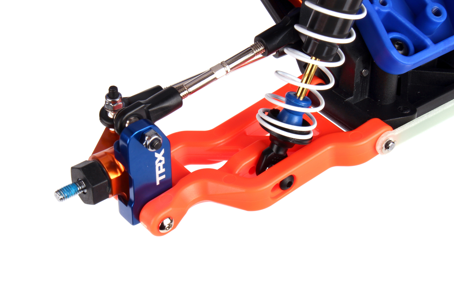

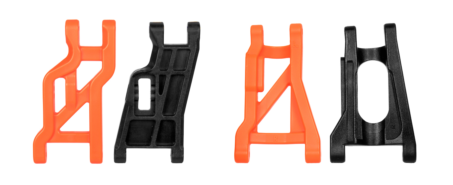

HD arms
The Heavy Duty arms are made of a high-strength composite formulation that’s extra resilient, especially in cold temperatures that can make traditional molded arms brittle. You can get the arms in orange, green, red, blue, and black.

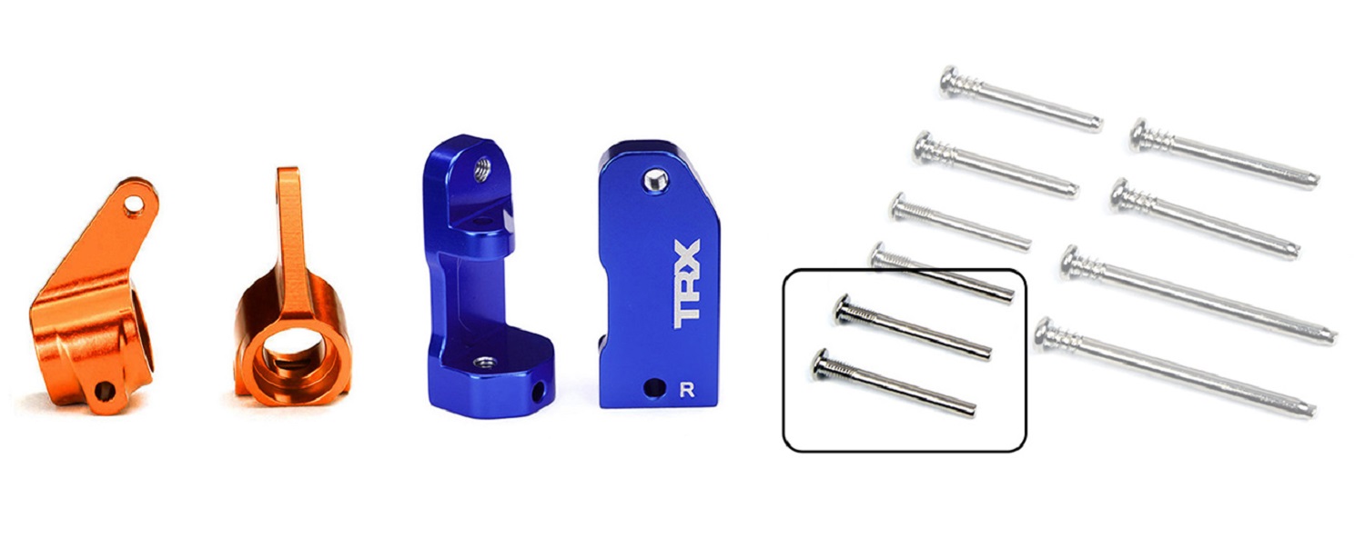

Suspension pin set
We’re pairing the HD arms up with machined aluminum caster and steering blocks for the ultimate in front-end durability. This combo requires the 3640 suspension pin set, which includes the 2.5 mm pins that fit the caster blocks.

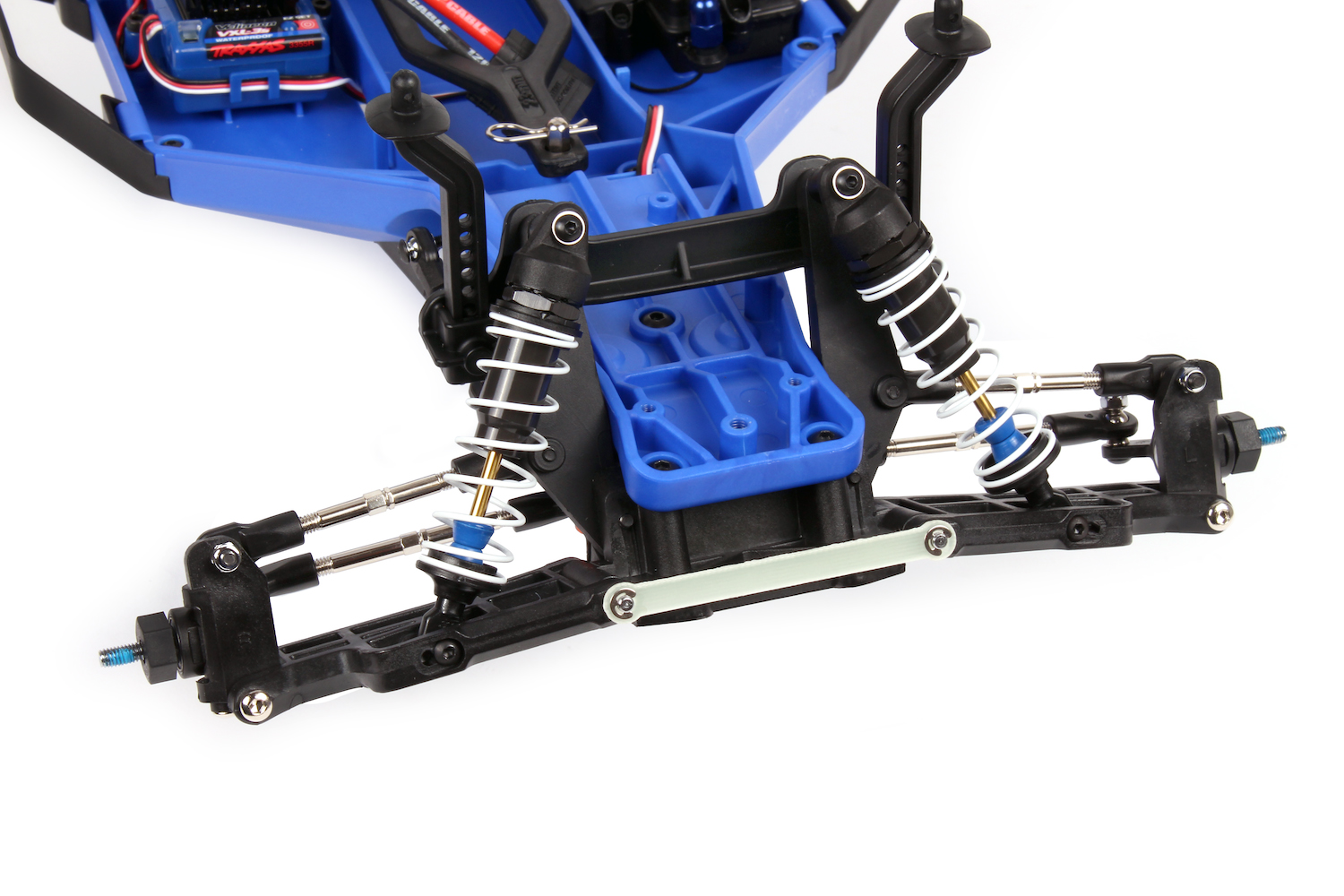

Completed front endHere’s the completed front end. Orange and blue are a hot combo.

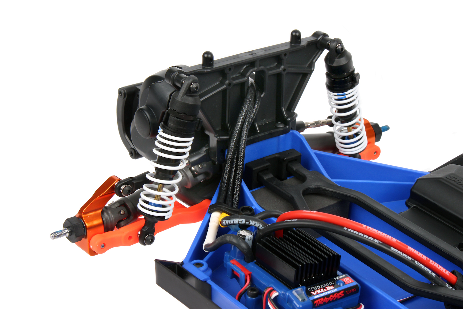

Completed rear suspension
The rear suspension is also fortified with HD arms, plus machined aluminum axle carriers.
