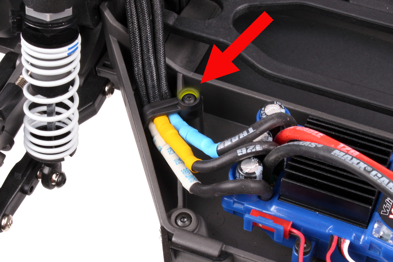

1. Remove the wire hold-down and disconnect the motor wires.

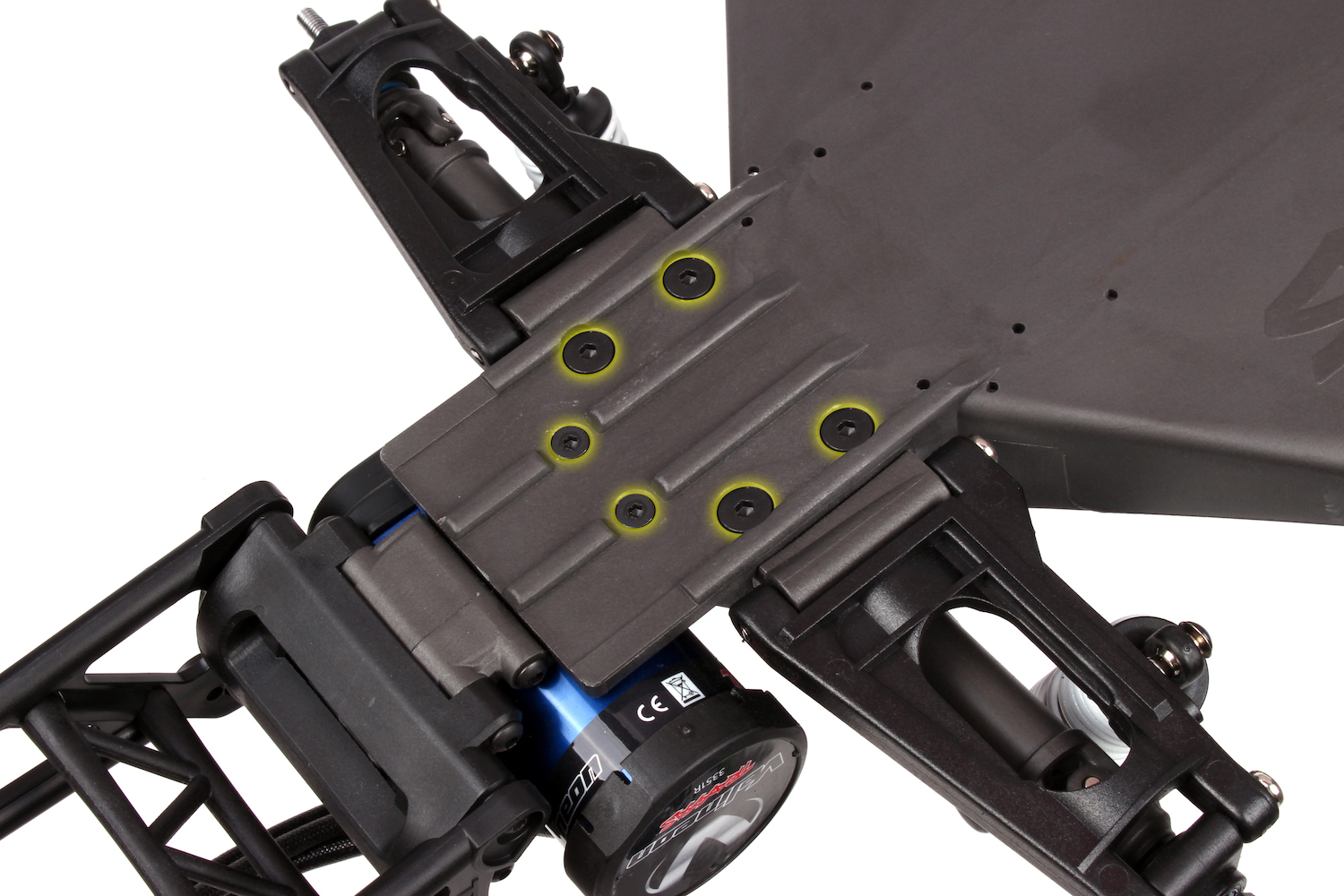

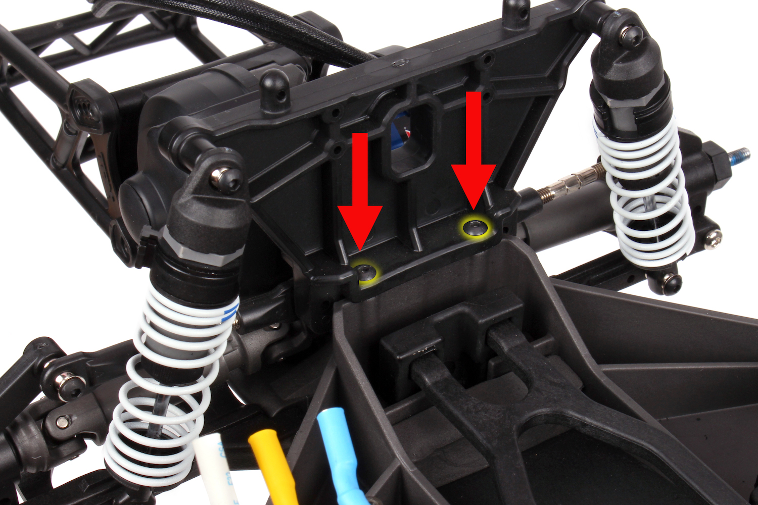

2. Remove the two screws from the front of the shock tower. The screws behind the tower can remain in place, we’re going to remove the entire rear suspension as a module.
3. Flip the chassis over and remove the six screws that secure the transmission. The entire rear suspension and transmission can now be removed from the chassis.

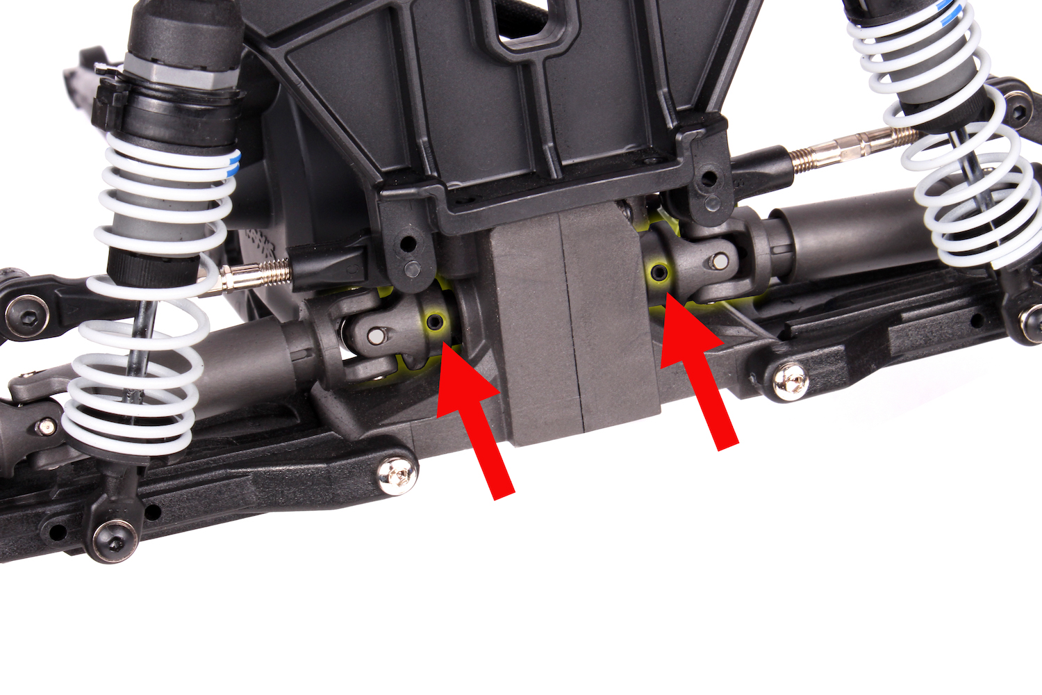

4. Remove the male driveshaft halves by taking out the screw pins and sliding the universal joints off the differential outputs.

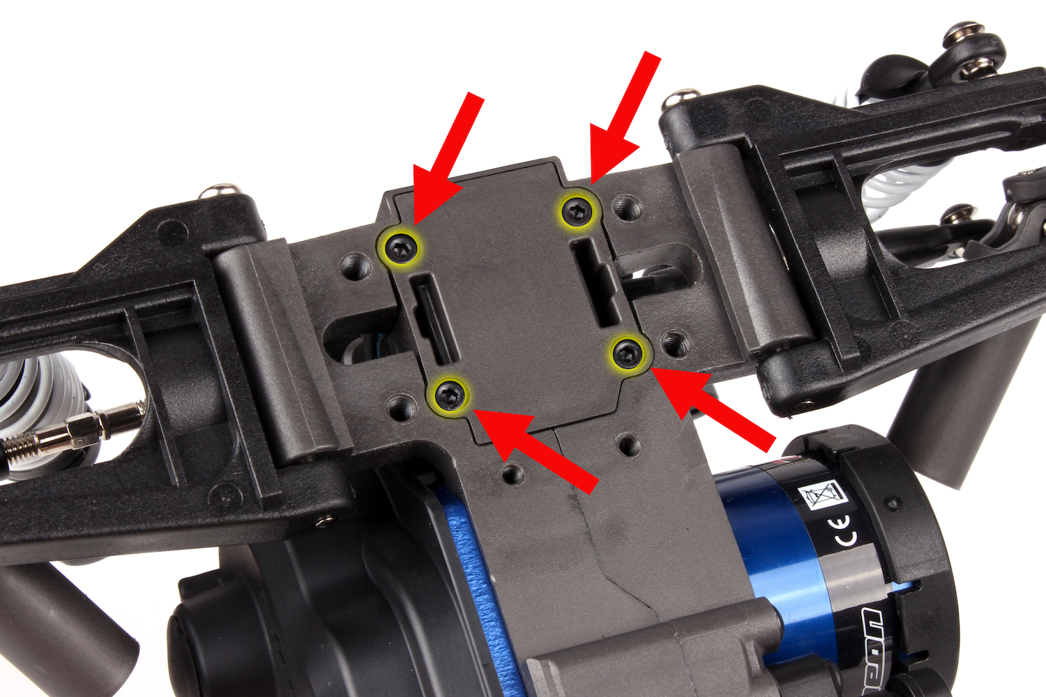

5. Turn the transmission over and remove the four screws that secure the differential cover.

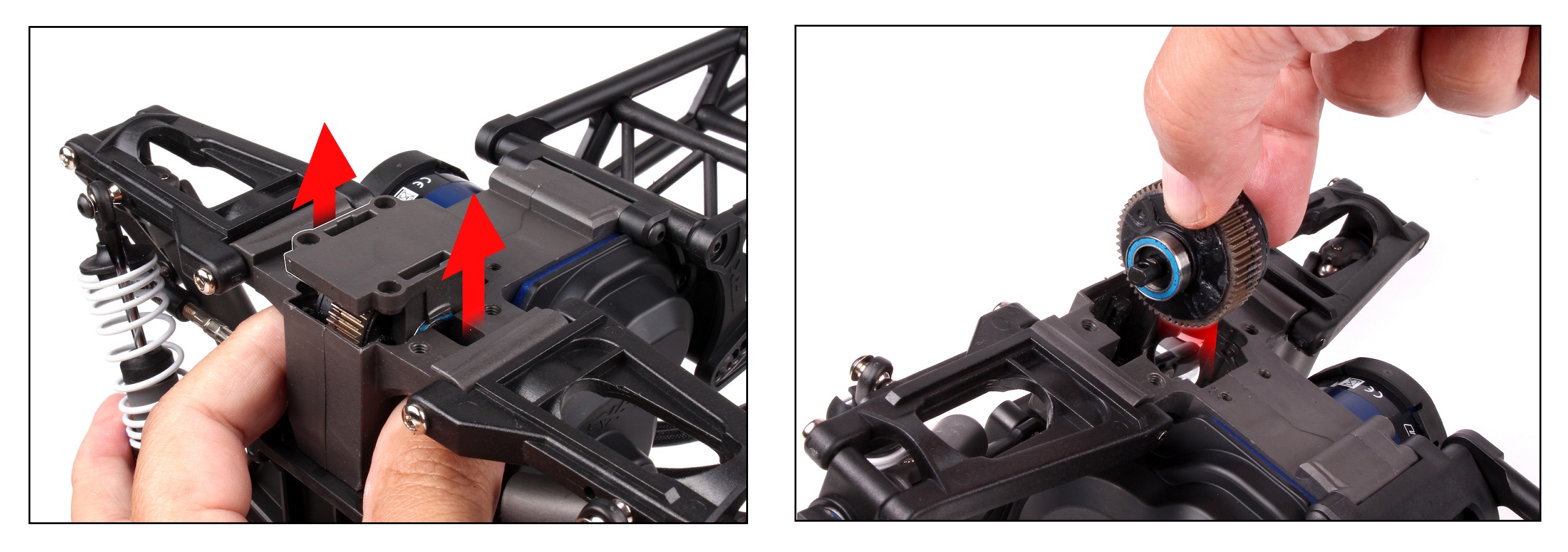

6. Push up on the differential outputs to raise the differential and cover out of the transmission. Remove the bearings from the diff so they don’t fall off and roll under your bench. Wipe any grease off the diff to keep your hands cleaner in the steps ahead.

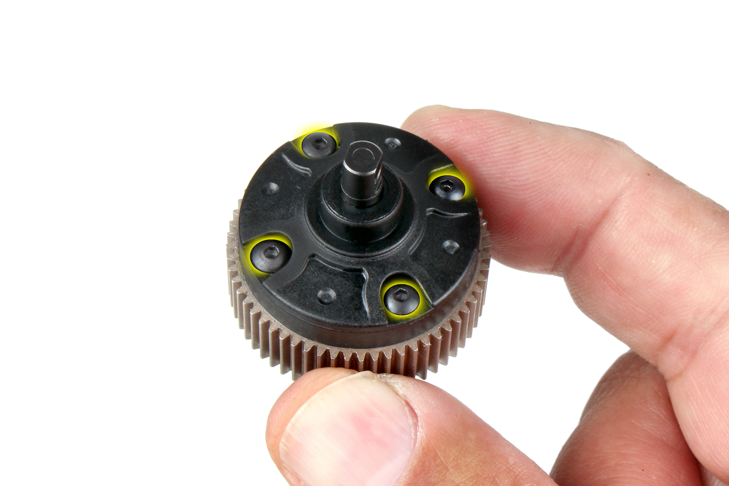

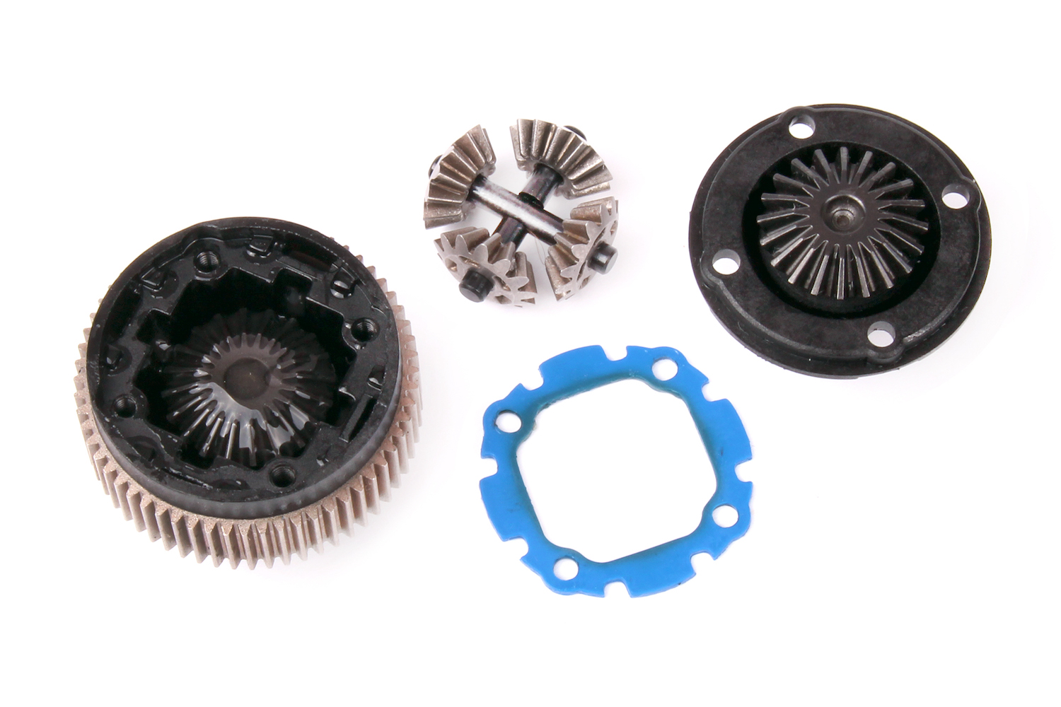

7. Remove these four screws to open the differential. You may need to wiggle the cover a bit to free it, it’s a precise fit and the tacky diff fluid inside also has some holding power.
8. Lift the blue silicone gasket off of the housing, remove the spider-gear assembly, and wipe the diff fluid off the gears. For easier cleaning, you can also push the output gears out of the housing halves. Any fluid left on the gears will dilute and mix with the new silicone fluid you add, but if you’d like to have completely clean gears before refilling the differential, you can scrub them with isopropyl alcohol and a toothbrush.

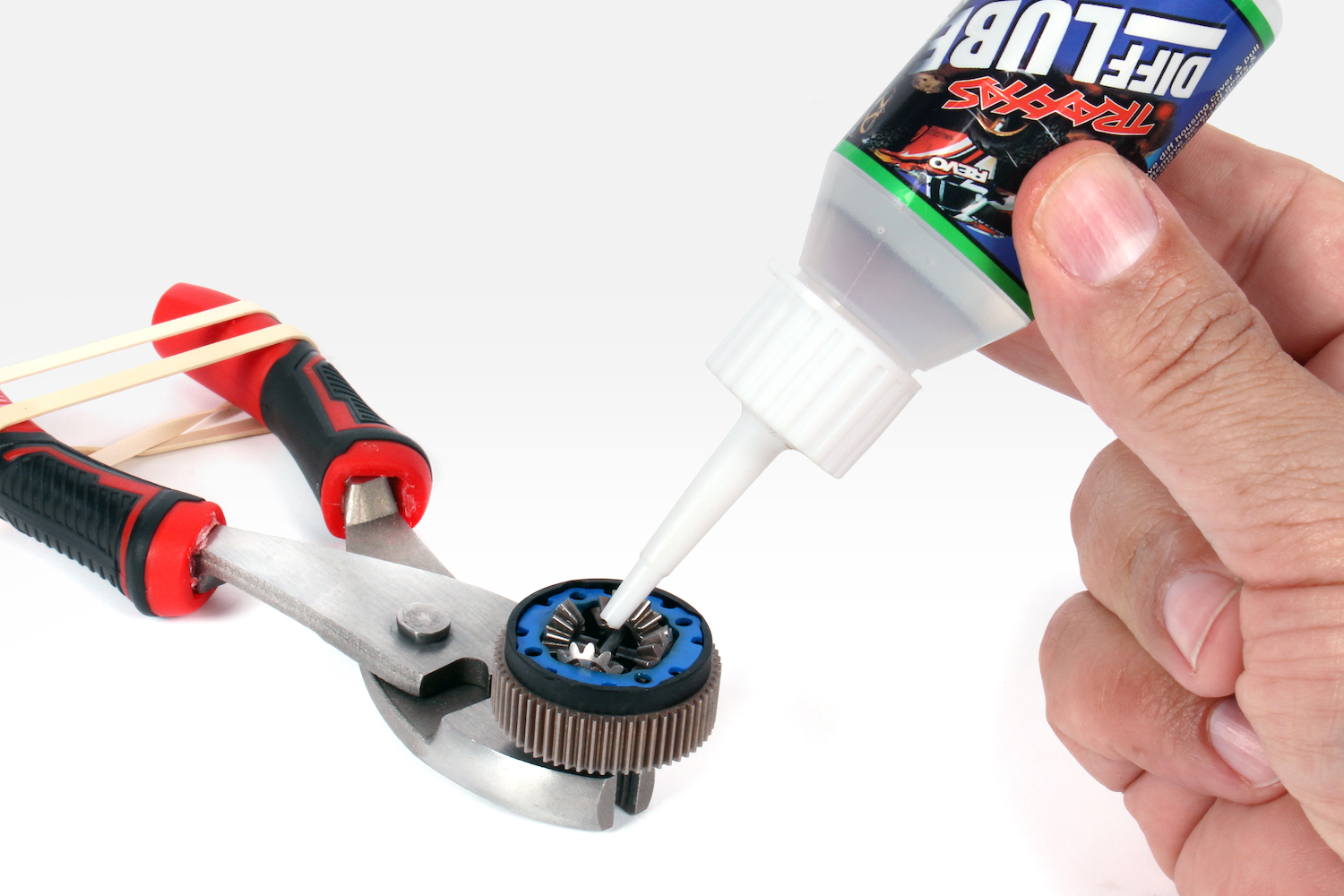

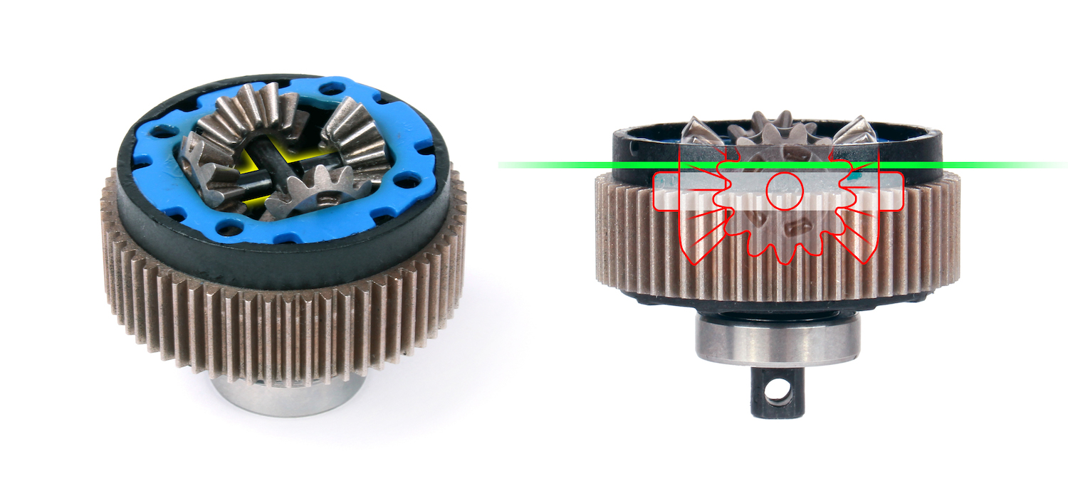

9. Fill the differential with your choice of fluid. Even “thin” diff fluids are pretty thick, so give the fluid time to flow and disperse through the differential housing. A rubber band and a pair of pliers makes a useful third hand to hold the diff upright and keep the housing from sliding down the output gear’s shaft as you work.
10. When the diff fluid submerges the spider gears’ cross pins, the diff is full and you can close it back up. Make sure the holes in the rubber gasket and case halves are precisely aligned before installing the screws. The screws only need to be snug. Over-tightening will make diff action notchy and may strip the screw holes, so don’t overdo it.
