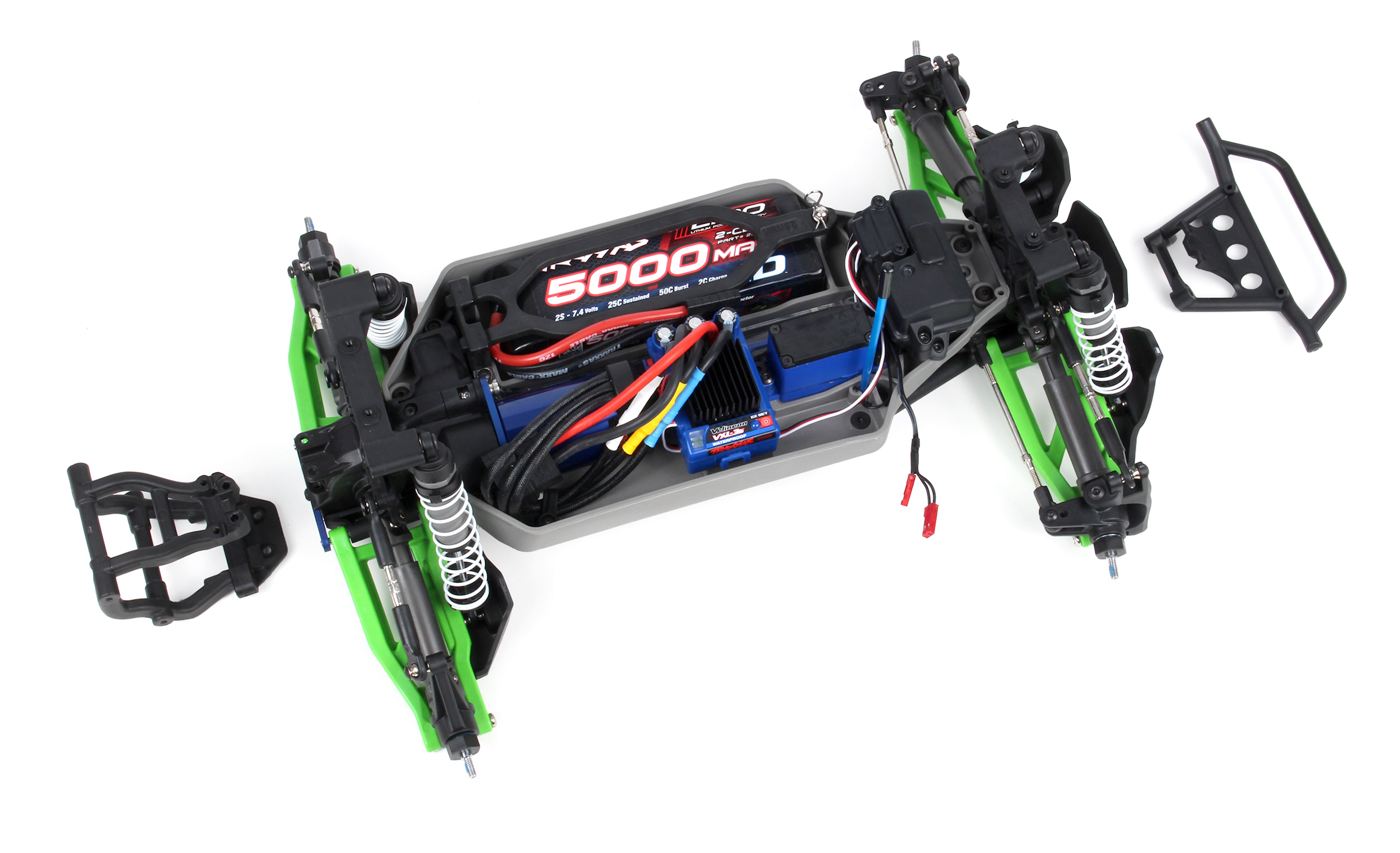

Step 1: Open the Receiver Box
Open the Receiver BoxUse a 2 mm hex wrench or driver to remove the screws that secure the clamp and lid.

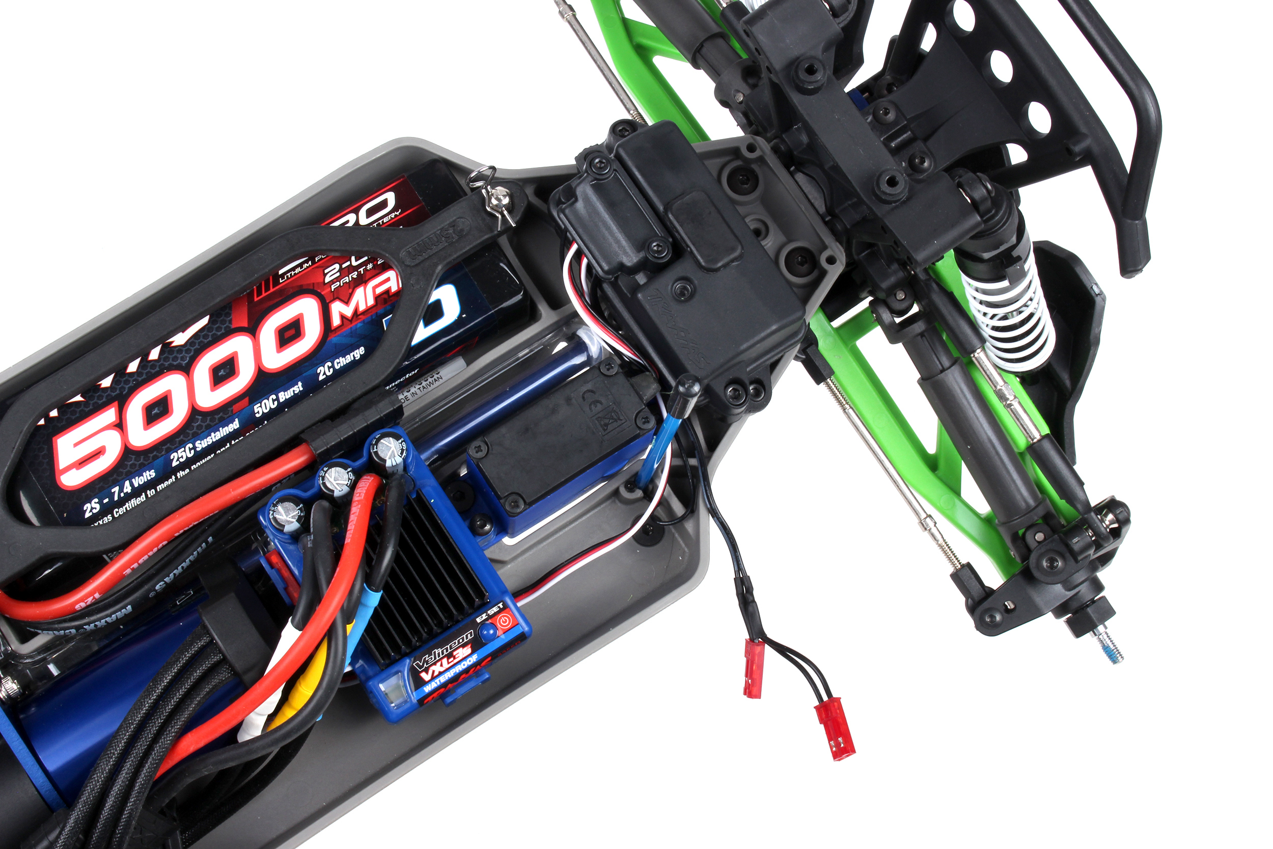

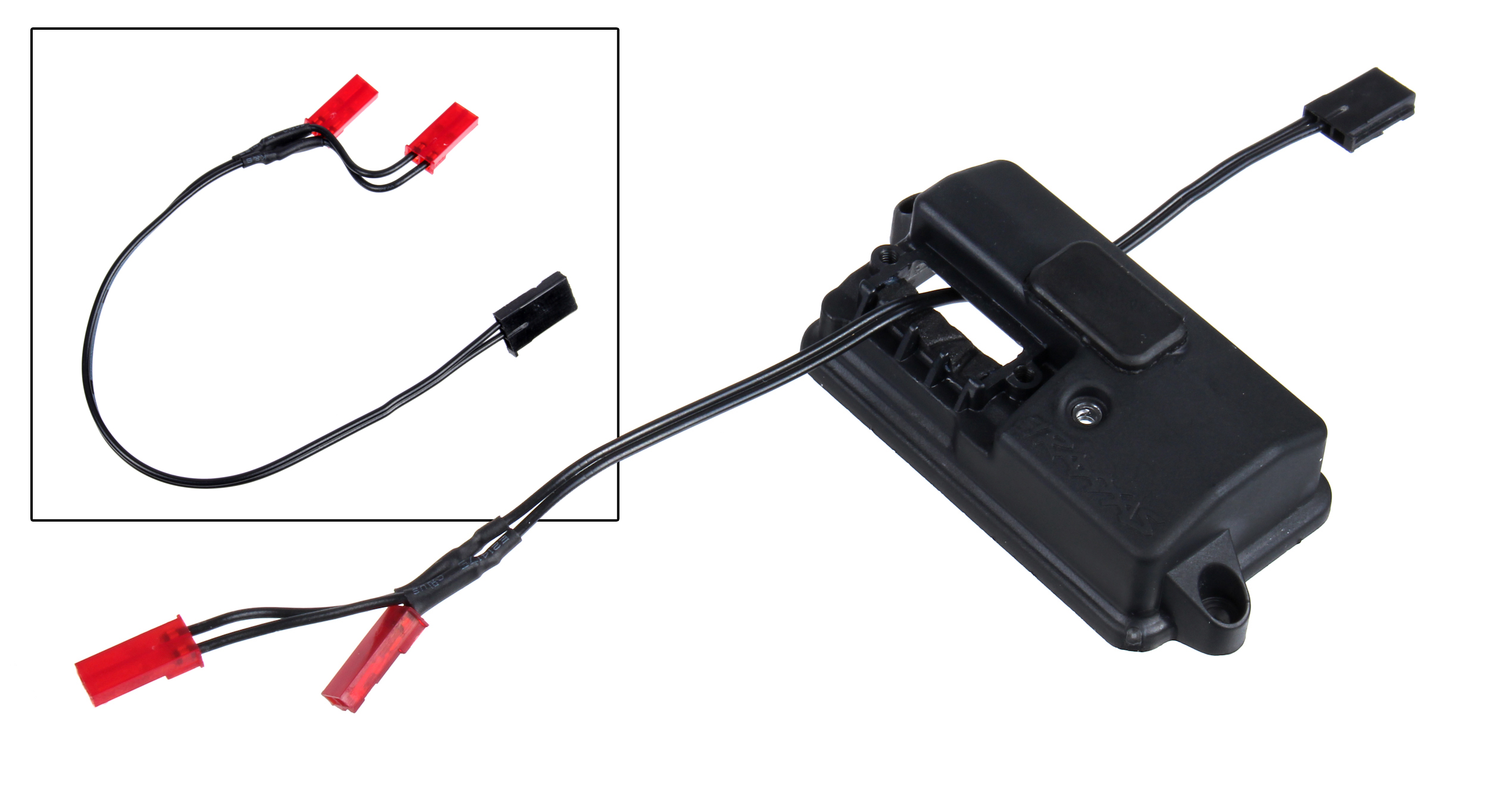

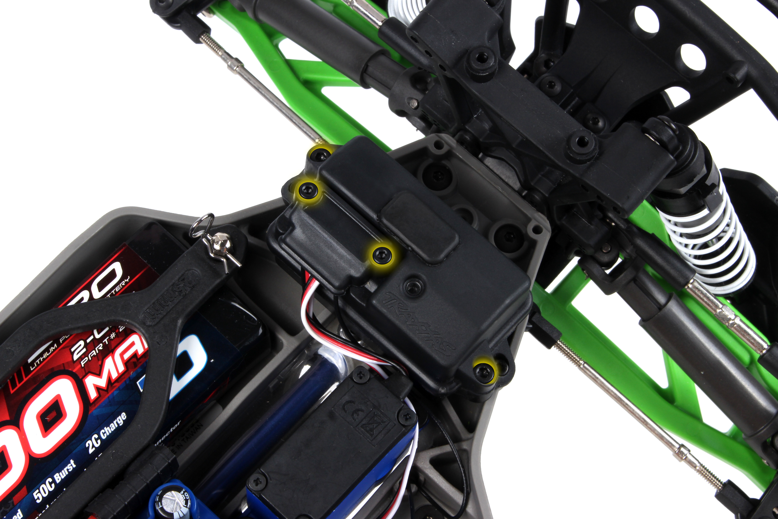

Step 2: Plug the Harness Into the Receiver
Plug the Harness Into the ReceiverPass the power wire harness through the receiver box lid and plug it into the receiver. The black plug goes into the receiver, the red plugs remain outside the bow. We’ve removed the antenna, speed control, and servo wires to clearly show the power wire harness, but you don’t need to take disassembly this far yourself.

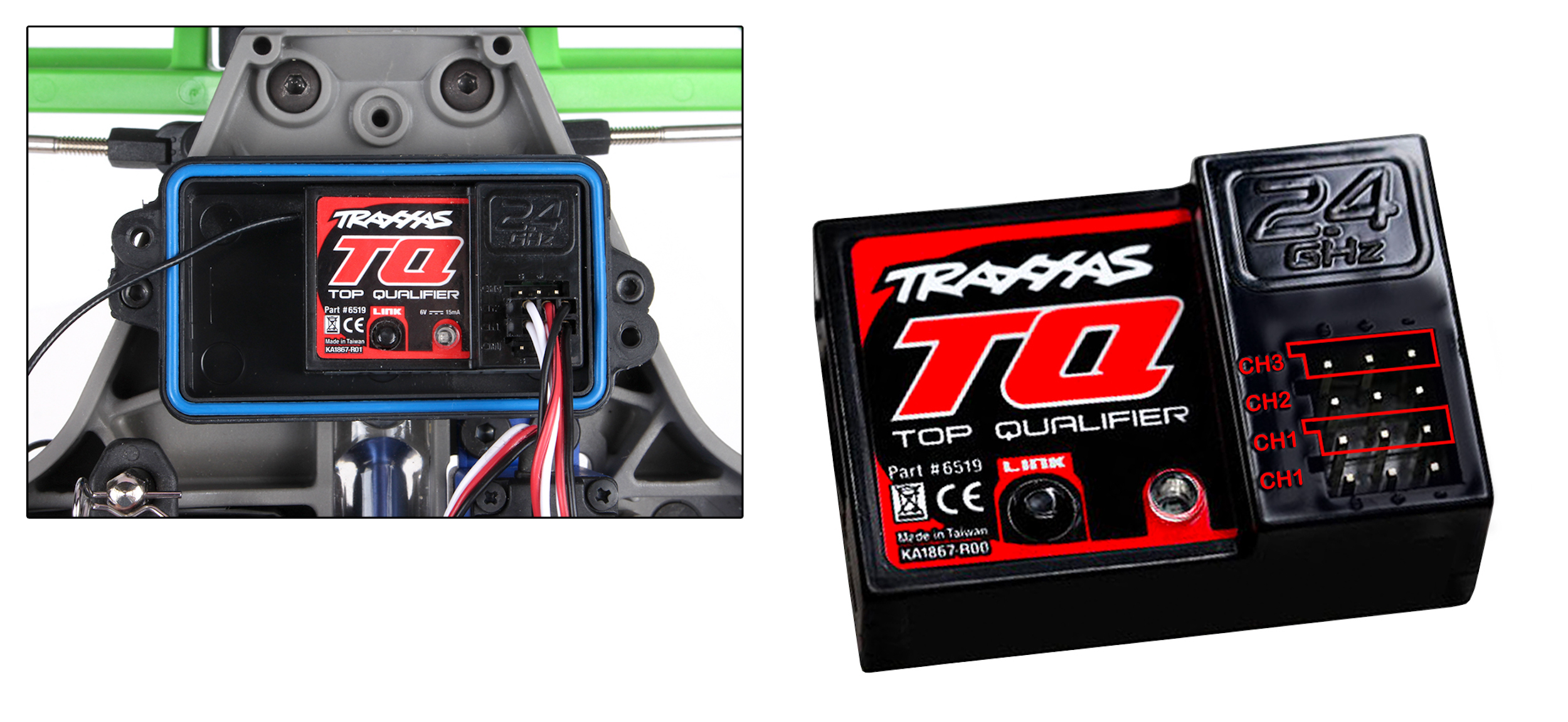

Plug the Harness Into Channel 1
Whether your model has a 3-channel receiver as shown or the 5-channel TSM receiver, you’ll find it has two Channel 1 (CH1) ports. The power wire harness can be installed in whichever CH1 port isn’t being used, or the CH3 port. Do not connect them to the V/T or RPM slots on the TSM receiver.

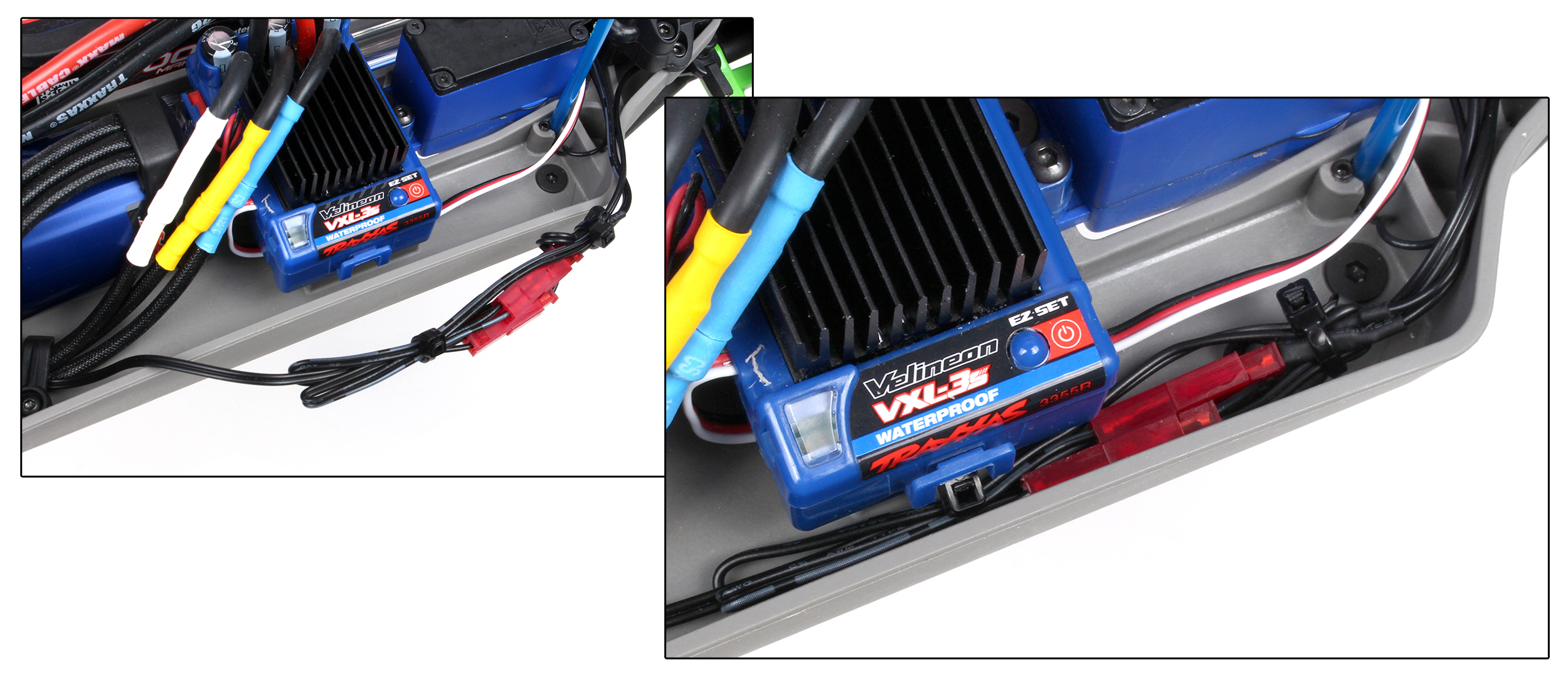

Step 3: Route the Power Wire Harness
Power wire harness routing varies with each model. For our Stampede 4X4, we’ve tucked it between the servo and receiver box. Make sure the blue O-ring seal seen in Step 2 is properly seated and no wires are pinched between the receiver box and lid before tightening it in place.

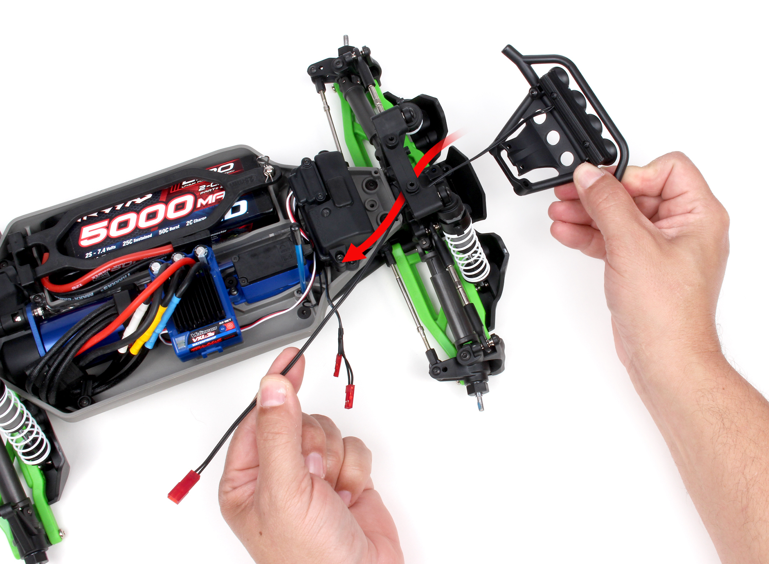

Step 5: Install the New Bumpers
Route the power wires through the shock towers. Reuse the screws you removed from the original bumpers to install the LED bumpers. There may be additional hardware included for bumper assembly, depending on the bumper set your installing.

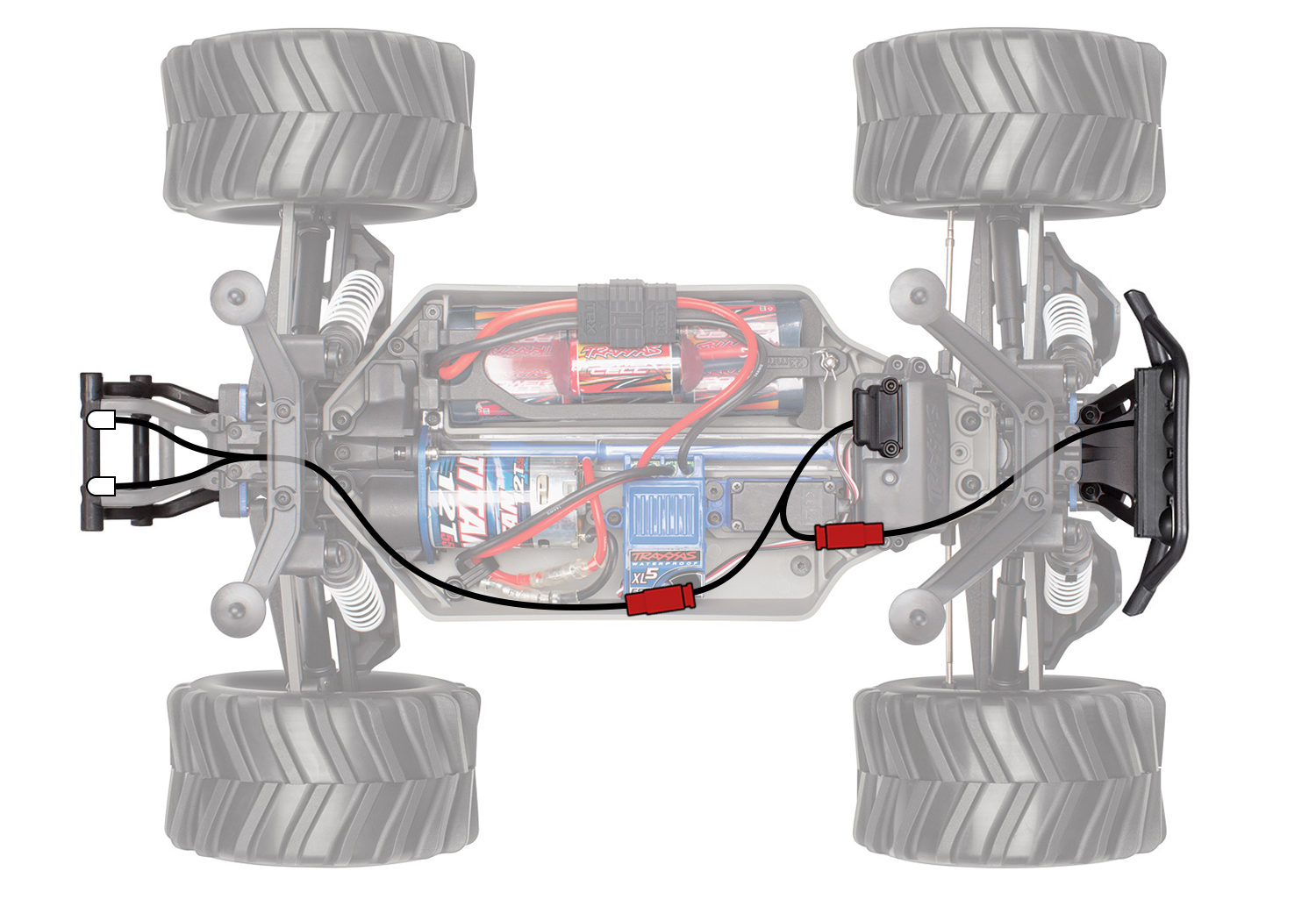

Wiring Diagram
Simply match up the red plugs to connect the bumper lights and power wire harness. Either male plug can go into either female plug, they aren’t specific to the front or rear bumpers.
Step 6: Bundle Excess Wire
Bundle Excess Wire
Make sure the wires don’t interfere with any moving parts, and leave a little slack to accommodate chassis and bumper flex.

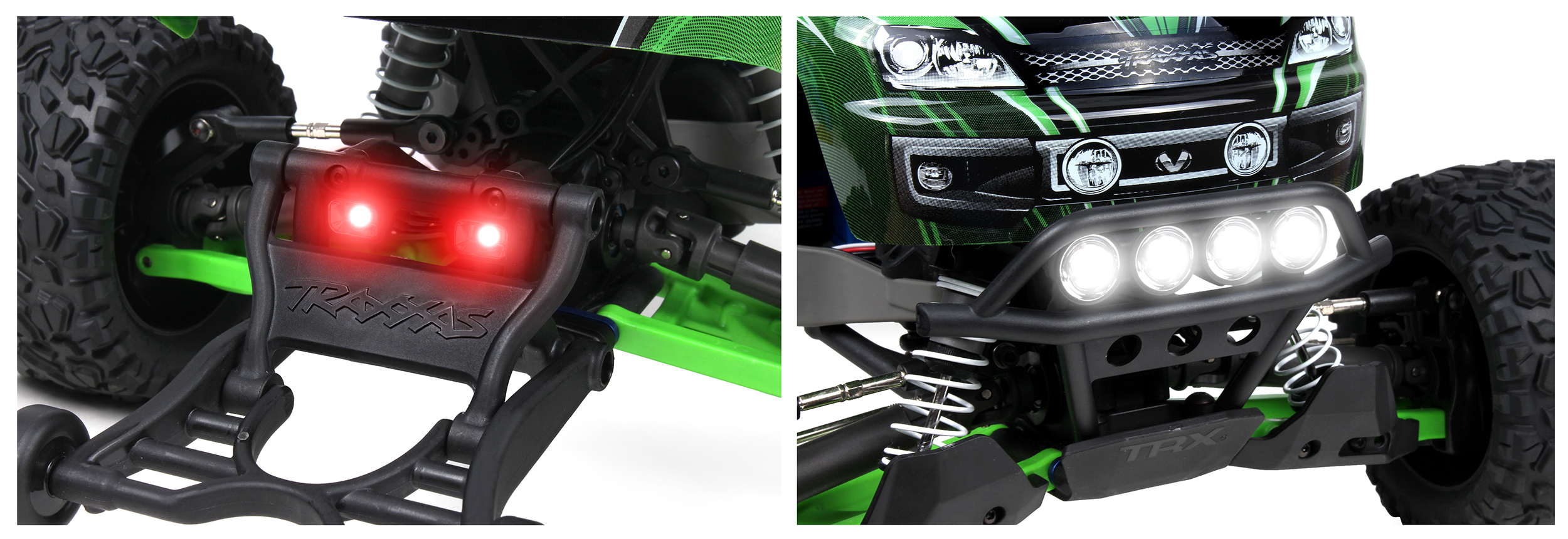

Step 7: Power Up!
Power Up!
Install a battery and power up your model. The LEDs switch on when you power up and switch off when you power down. The powerful LEDs glow brightly for even more exciting and authentic RC action.
