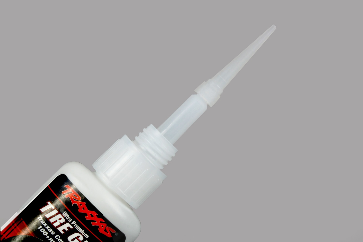

The Right Stuff: Ultra Premium Tire Glue
When Traxxas was developing the record-shattering 100+mph XO-1, one of the engineering hurdles was getting the tires to stay on the wheels at the outrageously high RPM required to reach triple-digit speeds. None of the available glue formulations were getting the job done, so Traxxas worked with experts in the field to develop a super-strong cyanoacrylate adhesive that was up to the task. The result? Traxxas Ultra Premium Tire Glue, the ultimate bonding solution for high-performance tires. Only Traxxas has it, and it’s the only one rated for extreme Velineon horsepower.

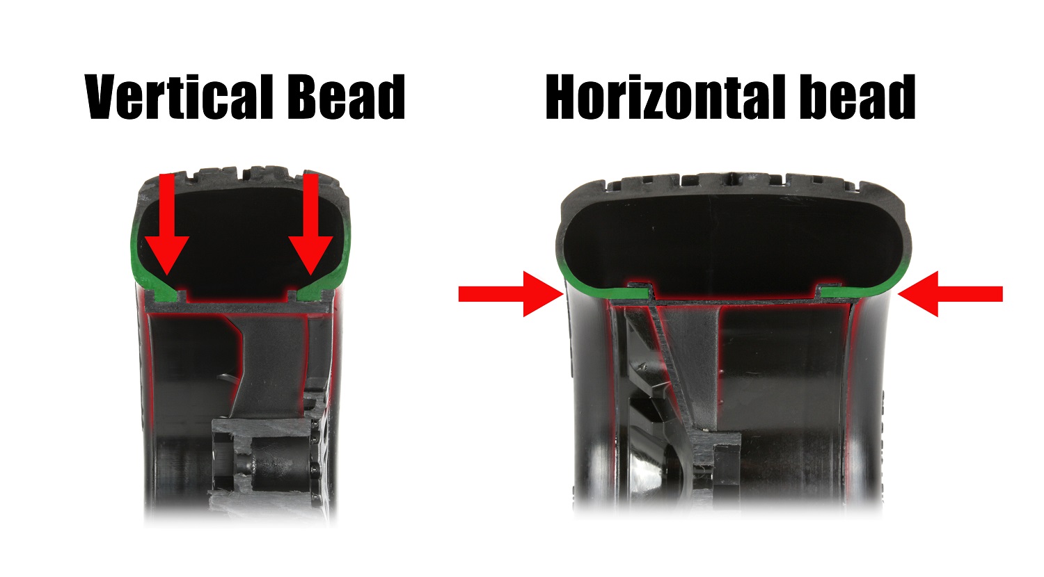

The parts of the wheel and tire that actually interface are the bead and the channel, as shown in the cutaways. Depending on the wheel and tire combo you’re working with, the bead may simply drop into the channel vertically, or it may press in from the side. Horizontal beads offers maximum resistance to tire separation due to centrifugal force, which is why this design is the choice for all Traxxas wheels and tires that equip brushless and brushless-ready models.
Traxxas tire beadsVertical beads are typical. Traxxas uses horizontal beads for applications that require maximum tire-holding power.

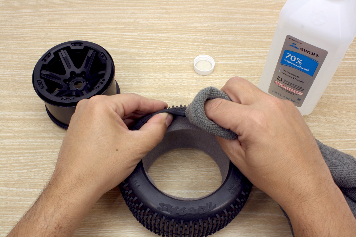

Even though the tires and wheels are fresh out of the package, we’re going to clean them to ensure the strongest, most complete bond. Only the mounting beads and channels need to be cleaned, not the entire tire and wheel. Isopropyl (rubbing) alcohol is all you need (and you probably already have some in the medicine cabinet). Eyeglass cleaning wipes are another option, their cleaning agent is alcohol. The alcohol will remove any mold-release agents from the manufacturing process that might interfere with the glue bond, and it evaporates without leaving any residue behind.
Clean the wheelsClean the wheel channels and tire beads with alcohol to ensure maximum bonding power.

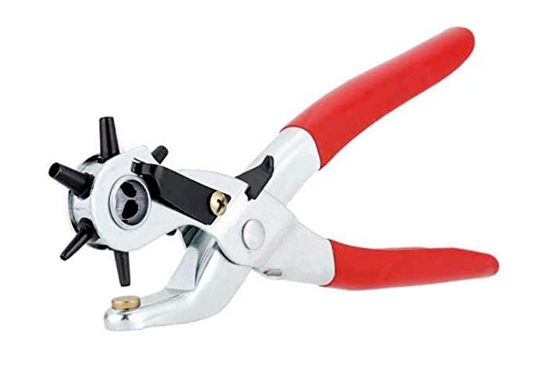

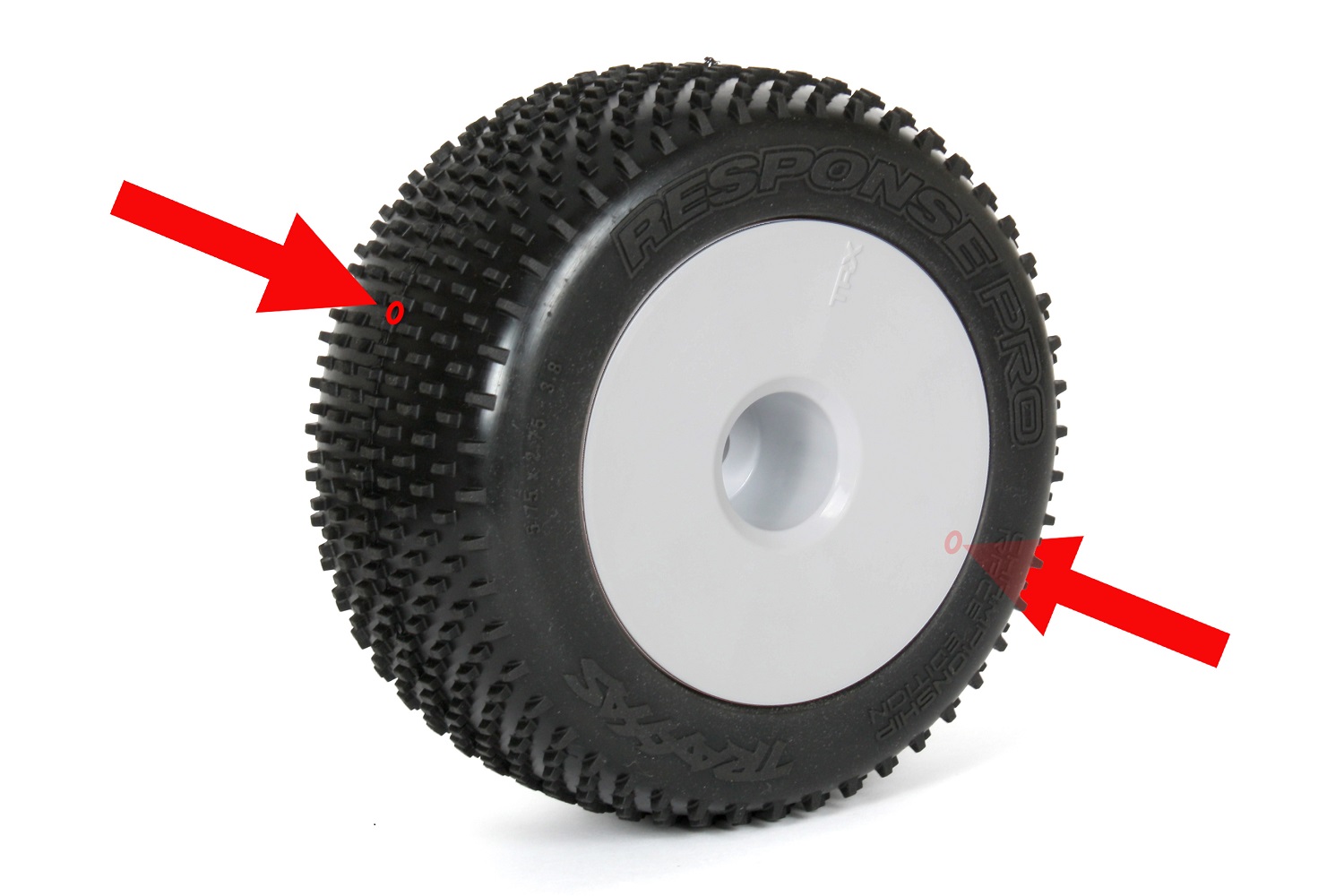

Venting allows air to flow in and out of the tire so it can deform easily to grip surfaces without fighting the spring effect of air trapped in the tires. Vents may be small holes in the tires themselves, or holes in the rim. Traxxas puts the vents in the rims, which makes it easy to seal them with poster putty if you’d like your wheels and tires to be watertight. Some drivers also like to vent the tires for even more airflow, or if they are going to be running in wet conditions. This is easier to do before mounting the tires, and a leather punch is the ideal tool. These can be had for around ten bucks. Make two tire vents in the tread’s centerline, with the holes opposite each other. The vents will allow a little dirt or water to enter the tire, but it will be flung out by centrifugal force.
Use a punch to vent tiresA leather punch is perfect for venting tires.
Vent the center of the tireVent the center of the tread, on opposite sides.

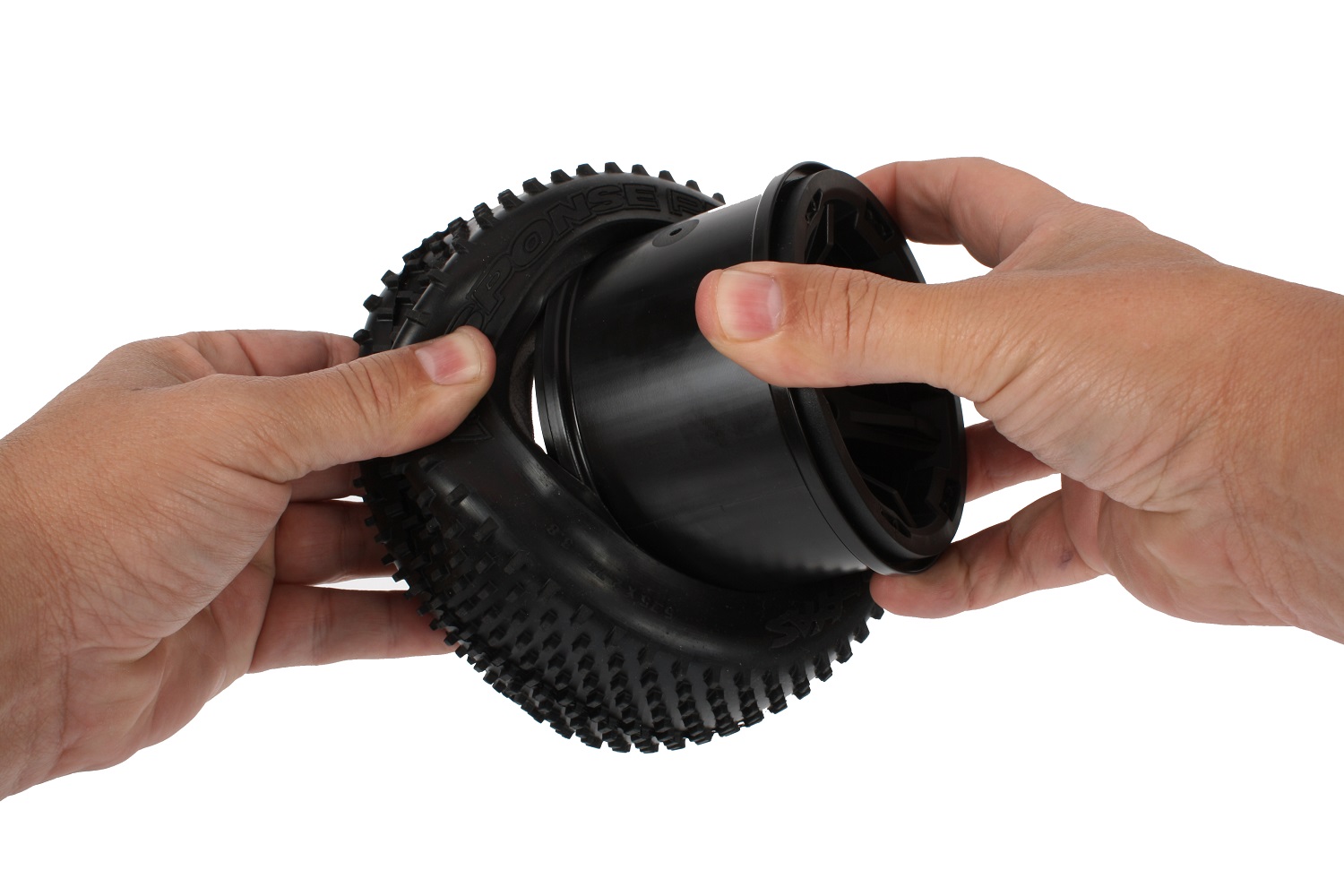

Step 2: Dry-Mount the Tires

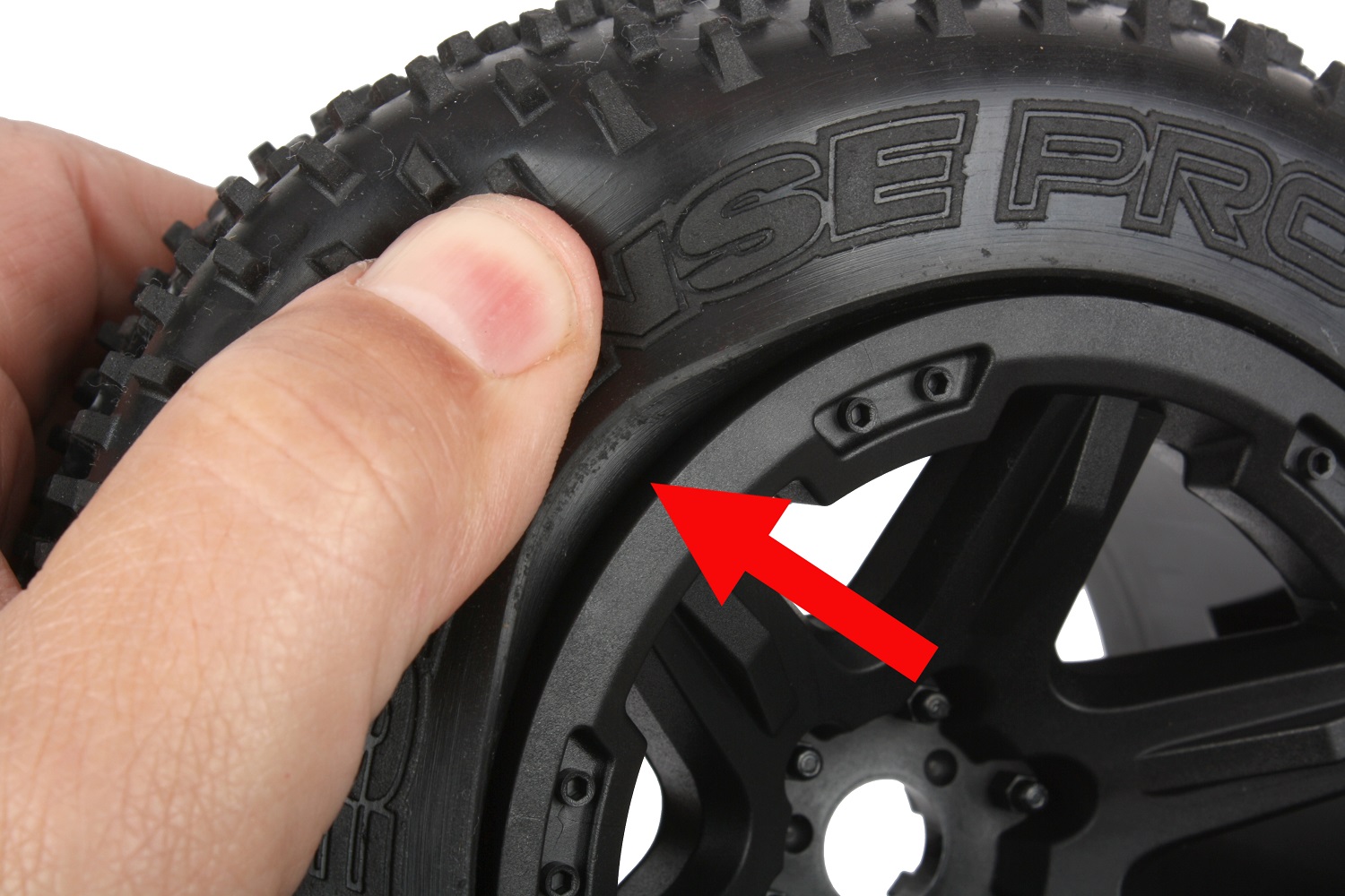

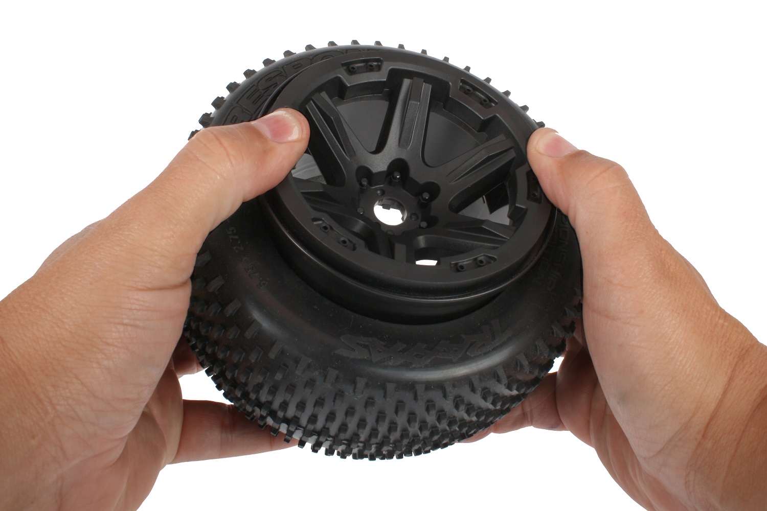

Push the wheel into the tire and fit the beads into the channels. Work the sidewalls as needed to fully seat the tire so there are no high spots where the rubber meets the rim face. If any sections won’t seat, there may be a bit of foam insert trapped between the tire and wheel, or you may need to trim a bit of excess rubber that’s interfering with the fit (rare, but have a look). If there are any fit issues, now is the time to fix them, not halfway through the gluing process. Traxxas wheels and tires generally seat easily and completely without extra fuss.
Tuck one edge of the tire into the wheelTuck one edge of the tire into the wheel.
Push and pull the tire over the rimPush and pull the tire over the rim.

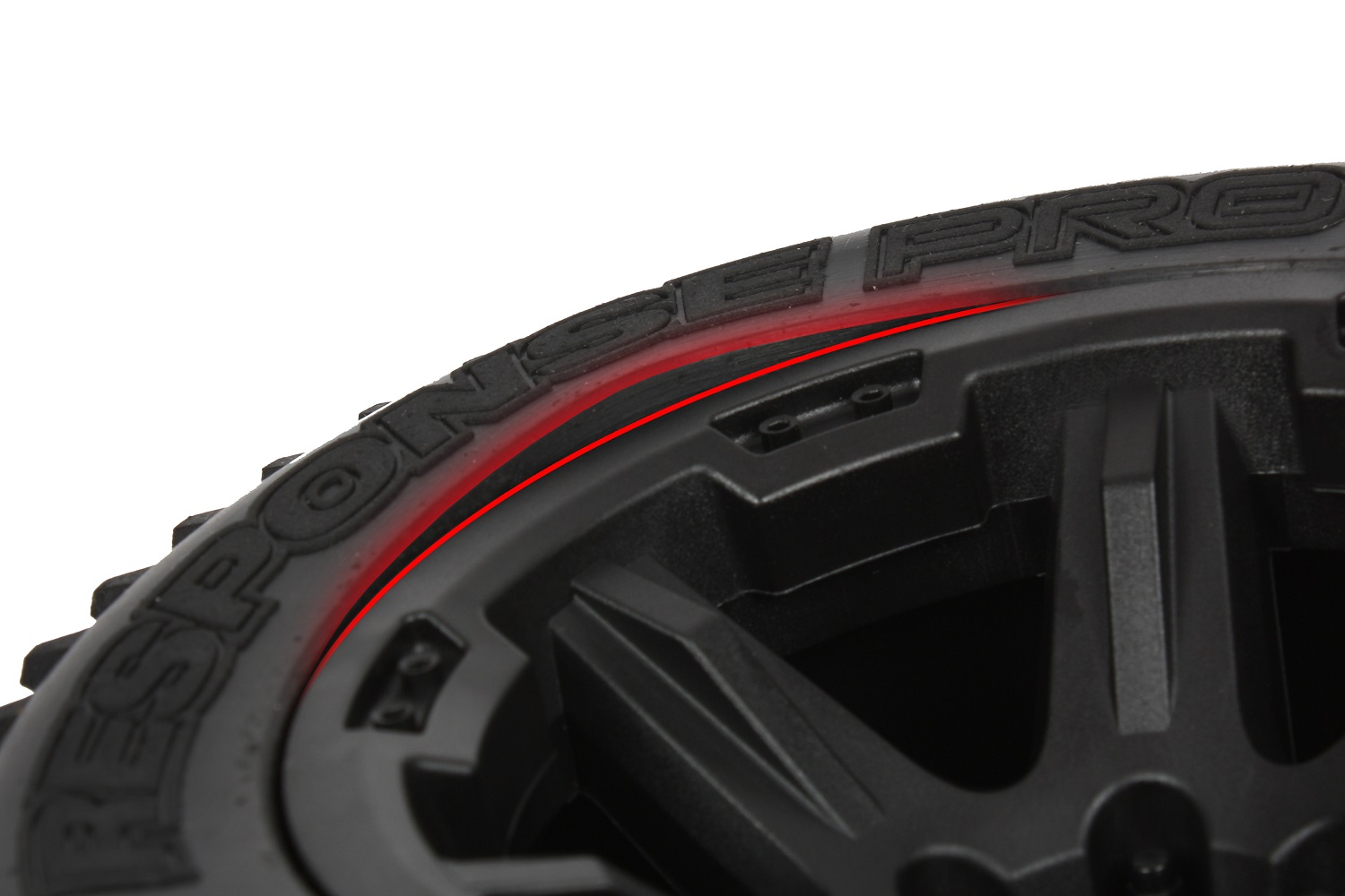

Make sure the beads seat fully in the rims.
Avoid high spots
High spots are unattractive and may come loose.

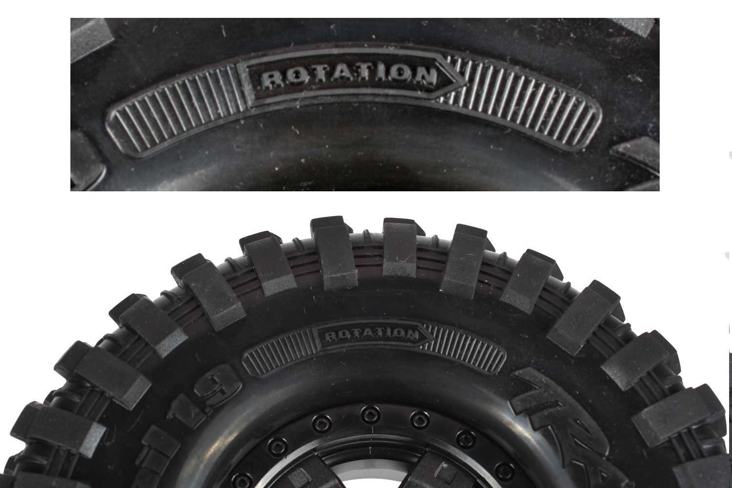

Ensure directional tires are mounted the correct way
If you’re mounting directional tires such as the Canyon Trail, Canyon AT, and Talon designs, make sure you assemble the wheels and tires as lefts and rights before you glue.

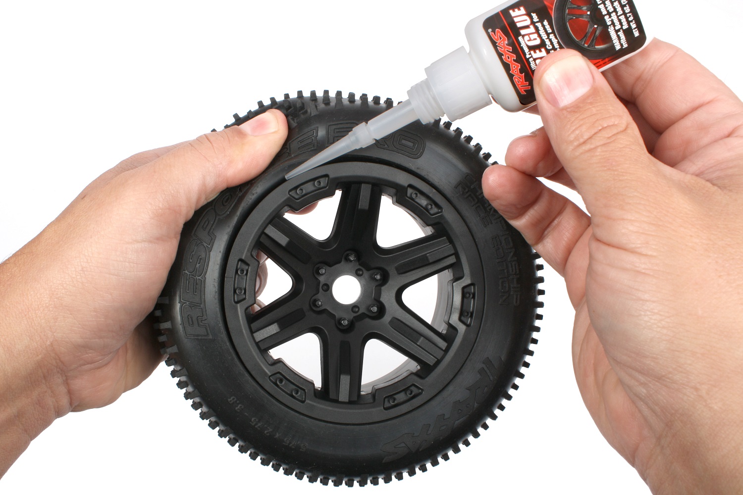

Step 3. Apply Glue

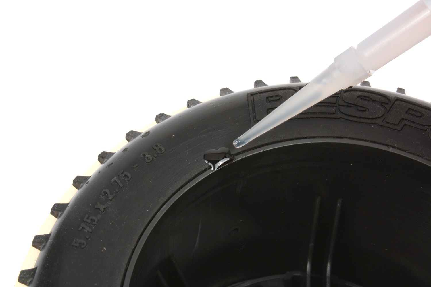

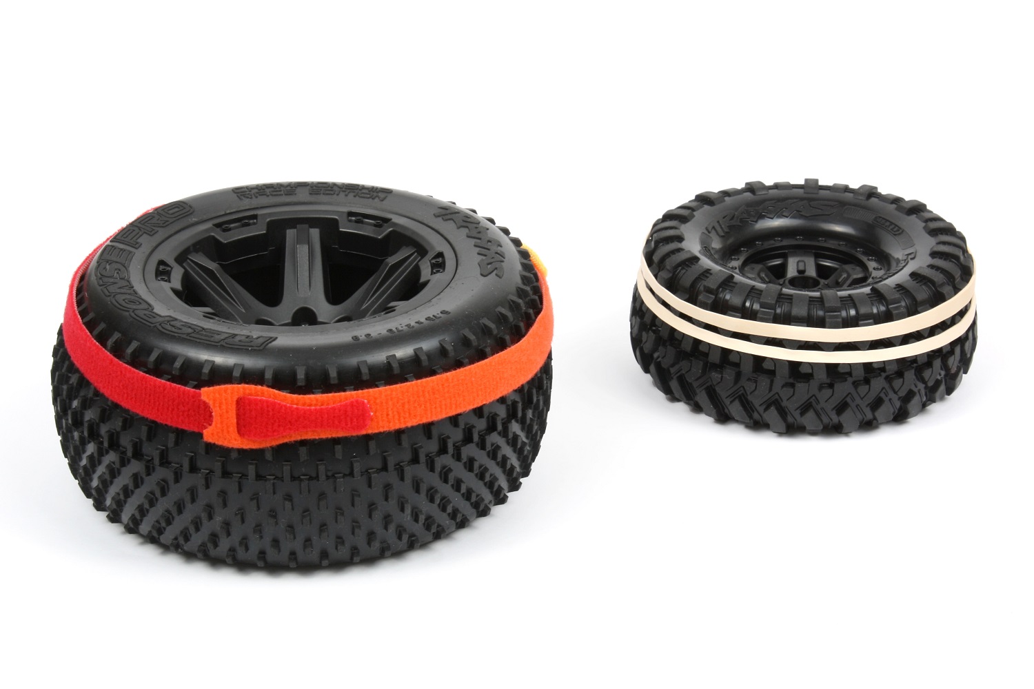

Safety glasses on. Pull a section of bead away from the rim and apply a drop of glue to the channel, then lower the bead back into the channel. Avoid letting the bead snap into place, which may cause the glue to spatter (and that’s why you’re wearing safety glasses). Seat the bead fully, then repeat with another section of bead until you’ve gone all the way around the rim. Use hook-and-loop cable wraps or rubber bands to hold the joint between the tire and wheel closed until the glue cures. You only need enough tension to keep the tire fully pressed to the rim, don’t overdo it. Move onto the next tire and repeat the process until you’ve glued the front of each wheel and tire. Then, go back to the first wheel and tire and repeat the process for the back halves.

Applying glue
Peel the tire away from the wheel and apply the glue a section at a time.
Applying glue
With CA glue, more isn’t better. One drop per section is all you need.
Wrap the tiresHook-and-loop cable wraps are perfect for gluing tires. Rubber bands will also do the job.

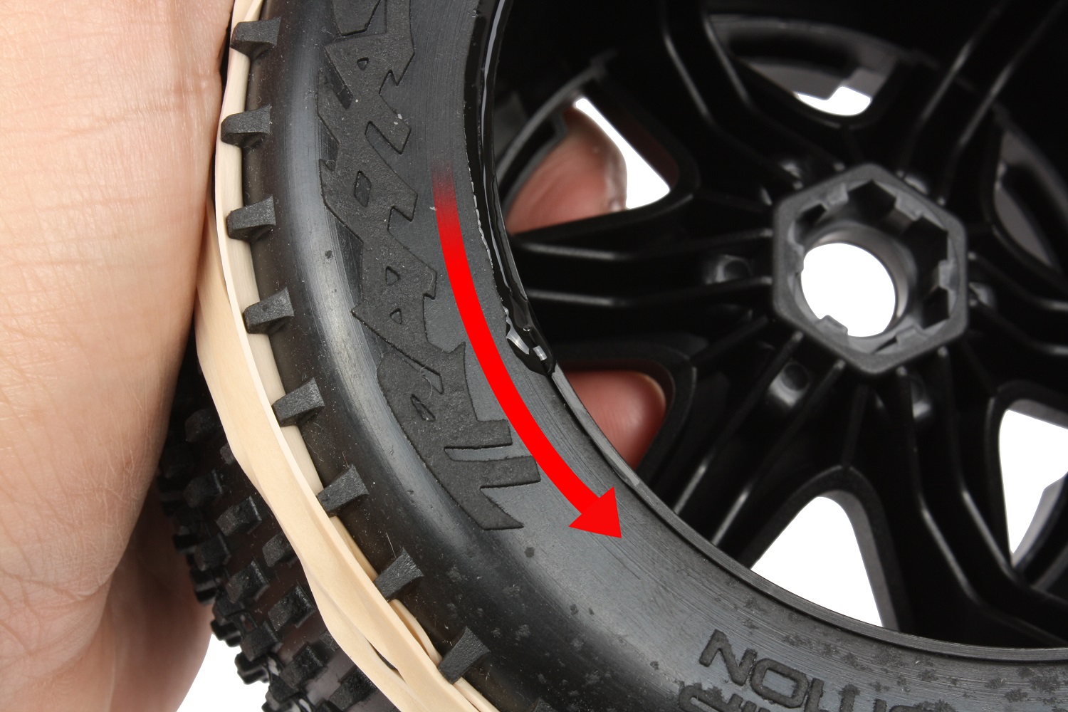

Optional: Apply a Sealing Layer
To seal the joint between the tire and wheel, apply a drop of glue to the joint and then gently tilt and rotate the wheel so the drop runs around the joint like a track. Use the tip of the glue bottle to help move it along if it gets stuck. Repeat as needed to spread the glue all the way around the tire. This allows glue to wick into the joint for extra holding power, and will help prevent dirt from packing into the joint when you drive. The only down side to this extra step is appearance, as the glue will leave a shiny trail on the tire and be visible on the rim—but you’ll only notice it up close. From a few feet back (and anytime you’re driving), you won’t see it.
Apply a drop of glueApply a drop of glue.
Tilt the tireTilt the tire so the glue drop runs along the joint.

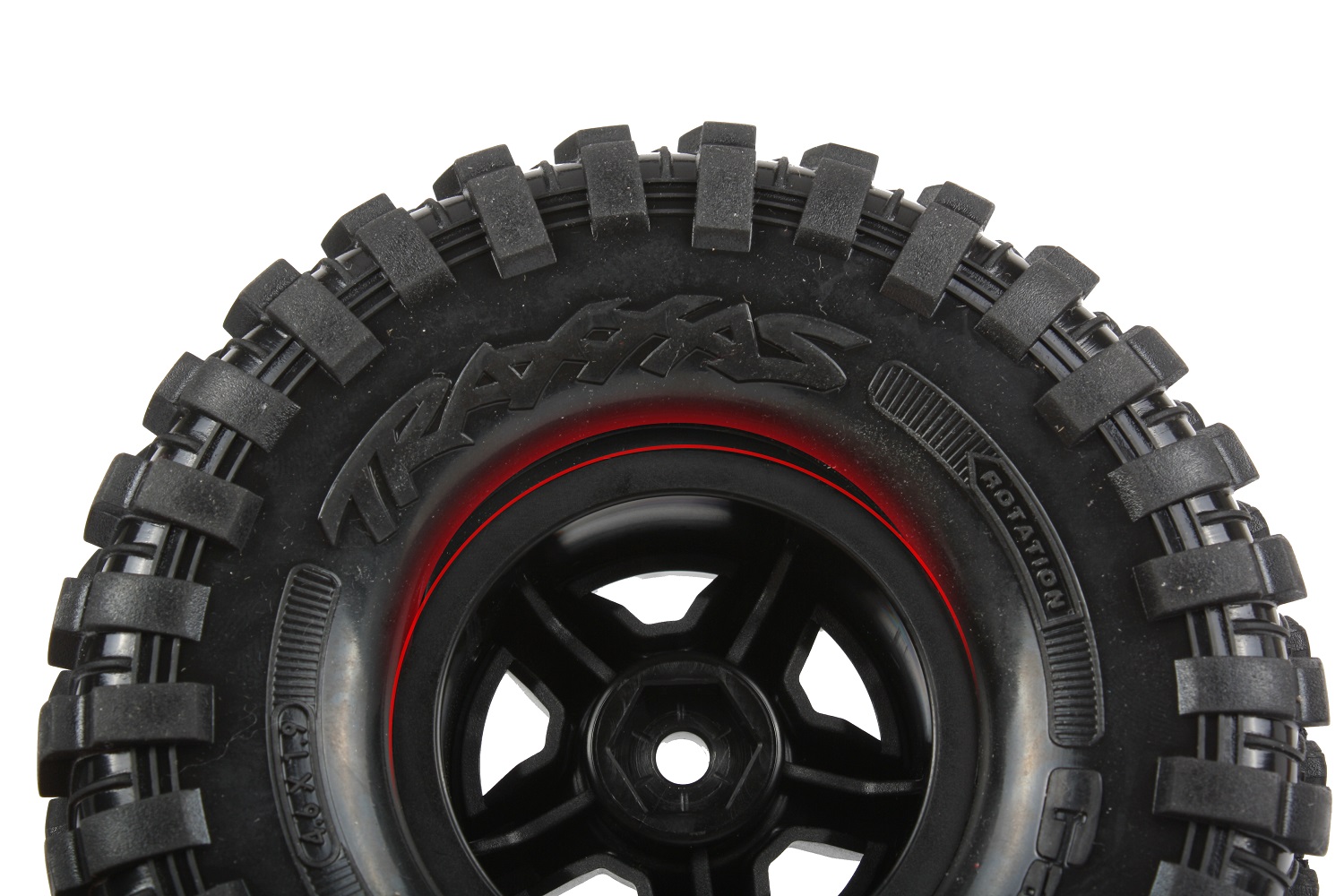

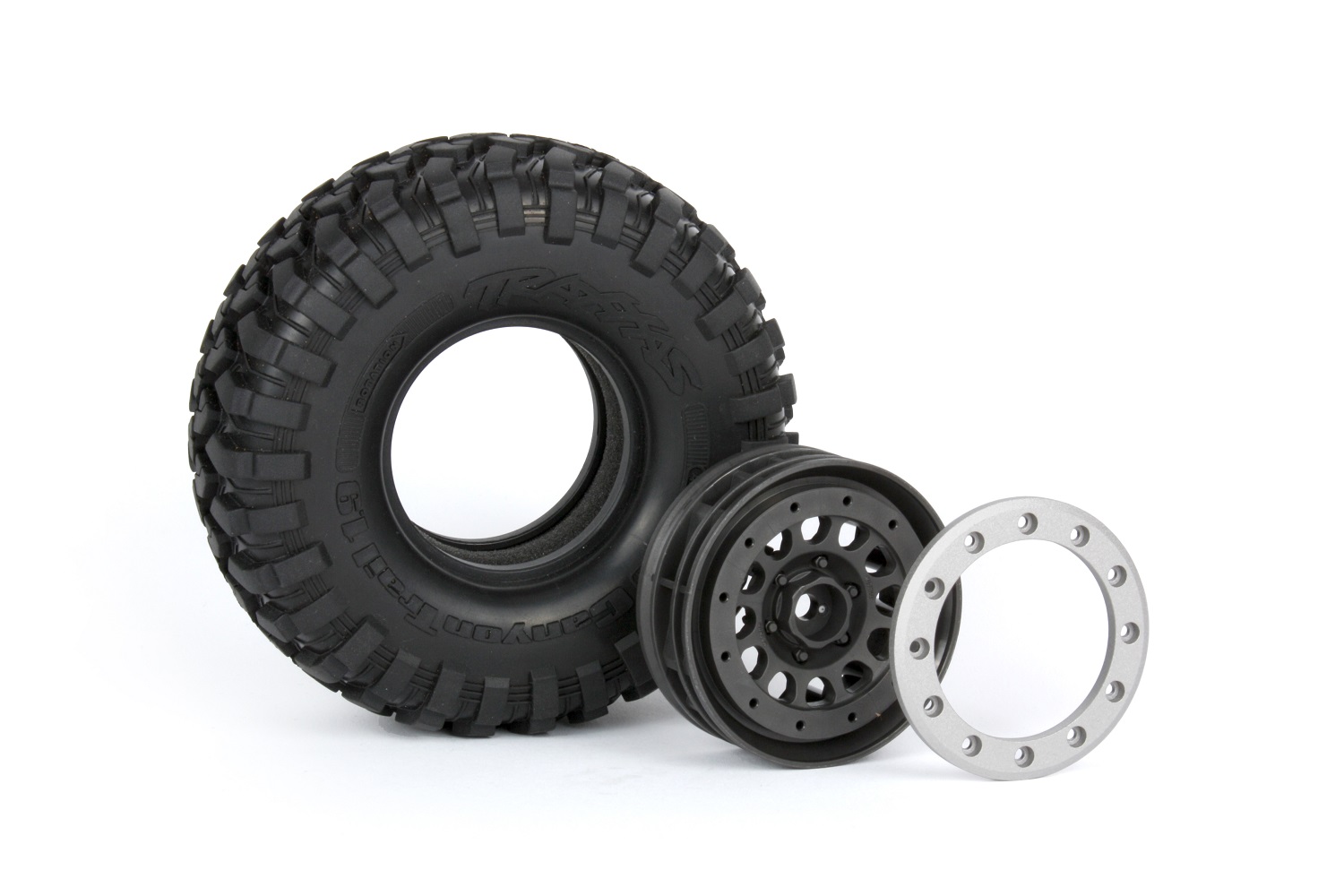

Trail Trucking? Go Glueless

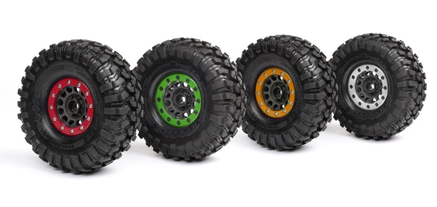

Though more expensive up front, outfitting your TRX-4 or TRX-6 with beadlock rims will save you money by allowing you to reuse the wheels instead of purchasing new ones when it’s time to replace your tires or you just want to try a new tread. Beadlock rims also give you more options for customizing your truck with color, and making modifications like adding weights. You can get Method 105 replica beadlock wheels in 1.9″ and 2.2″ sizes in a variety of finishes and choose your own ring colors, or get them pre-assembled.
Beadlock rimsBeadlock rims hold the tires mechanically, no glue required.
Change your ring colorYou can choose different ring colors to match or contrast your machine.
