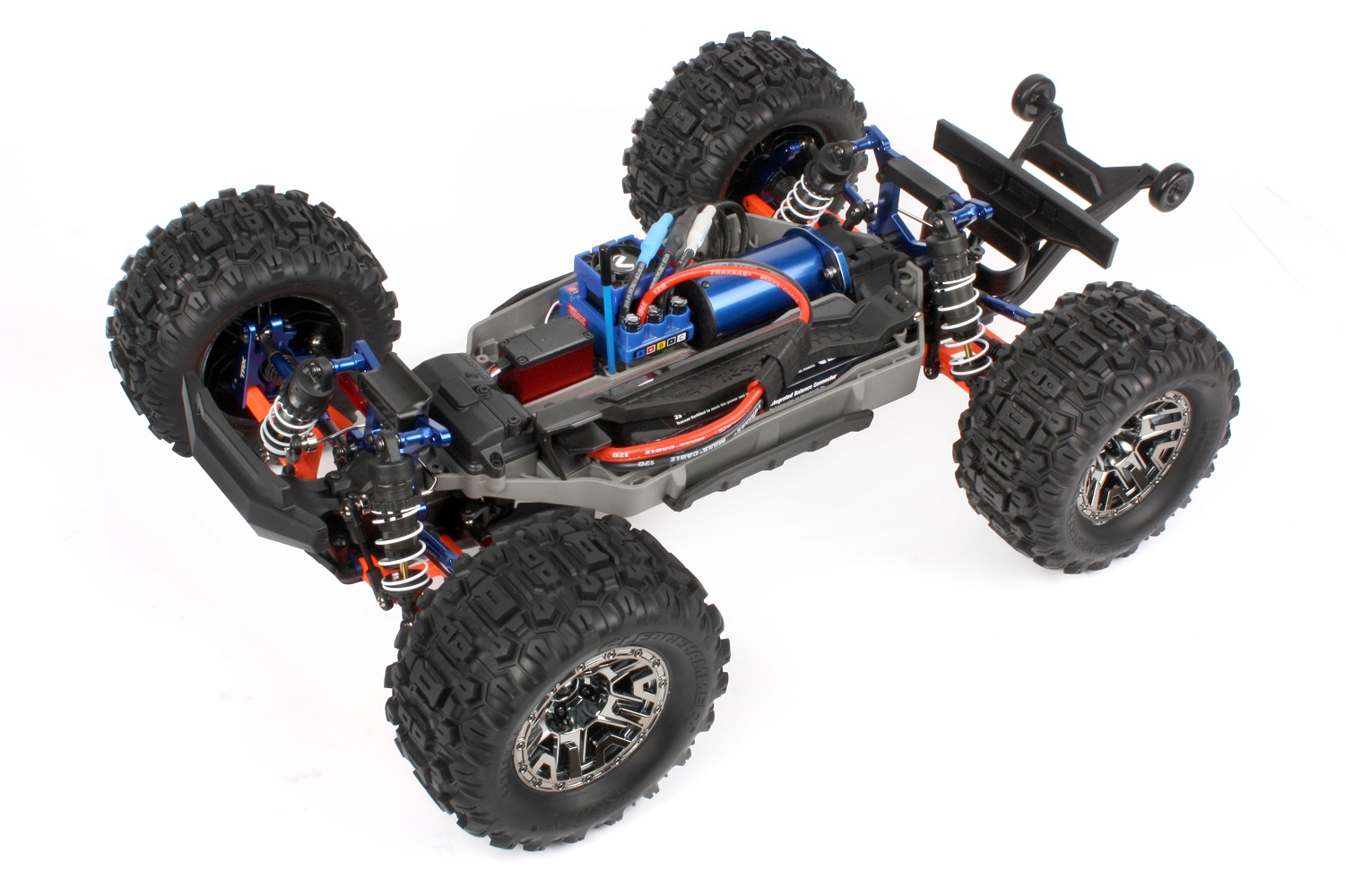

If you’ve been following our Ultimate Hoss 4X4 VXL project (Part 1, Part 2), you know we’ve gone for extra beef with the build, but didn’t go deep into suspension tuning changes. We replaced the Ultra Shocks with higher-capacity GTRs, but stuck with spring and oil selections aimed at preserving the stock handling feel. Front and rear sway bars were added, but we stayed conservative and installed the thin bars instead of the fatter, stiffer versions included with the set.
While our project Hoss will be a tougher truck with its steel CV shafts and aluminum components; offer greater shock-oil life and more consistent damping with its bigger, slicker shocks; and deliver snappier steering inputs with its 400 oz-in servo, it should not drive dramatically differently. And from there, we’ll be able to put a setup on the truck and really dial it in. That’s the theory, anyway—let's drive.
