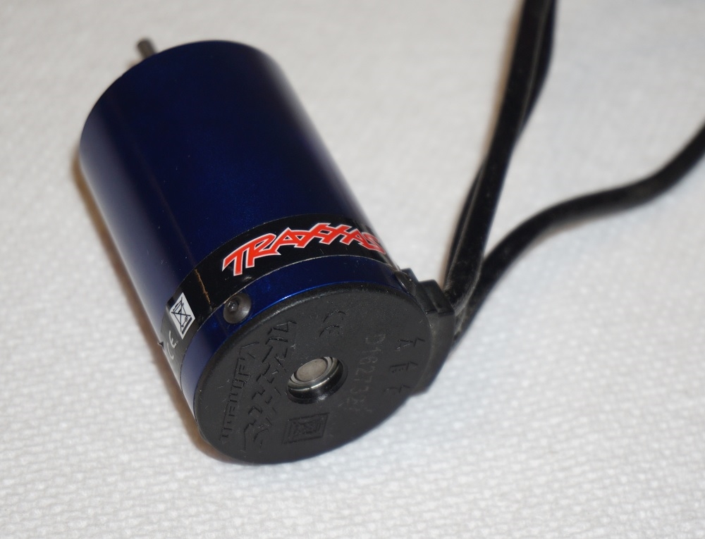

Brushless RC motors like the Velineon® 3500 provide superior performance and efficiency compared to their brushed counterparts. Brushless motors can also be rebuilt to keep them running for years of high performance fun. Bearings are the typical failure point for brushless motors. Failing bearings usually cause the motor to run hot and may reduce performance and run time. They may also cause the motor to feel rough and scratchy if you turn the output shaft by hand. This article will demonstrate how to rebuild the Velineon 3500 brushless motor by replacing the bearings and other common wear items.
This motor came to our repair lab with symptoms of overheating. Some surface rust is evident on the pinion gear and the motor feels scratchy when you spin the gear by hand. This is typically the sign of a failed bearing.
