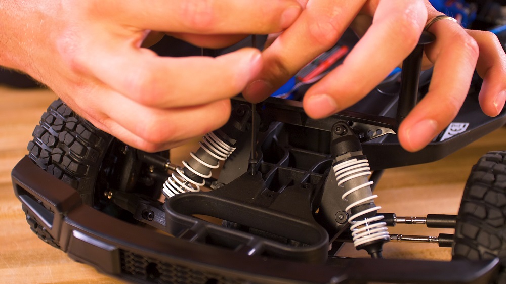

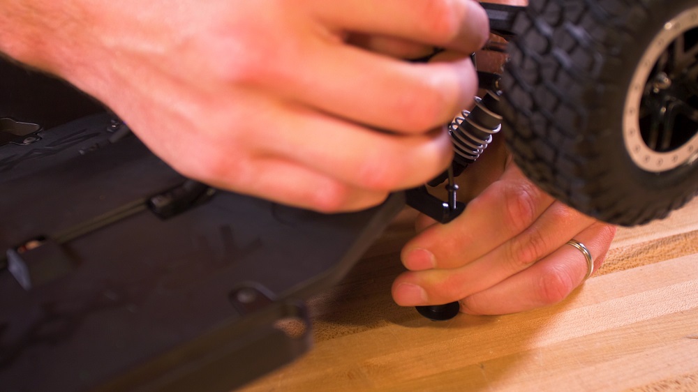

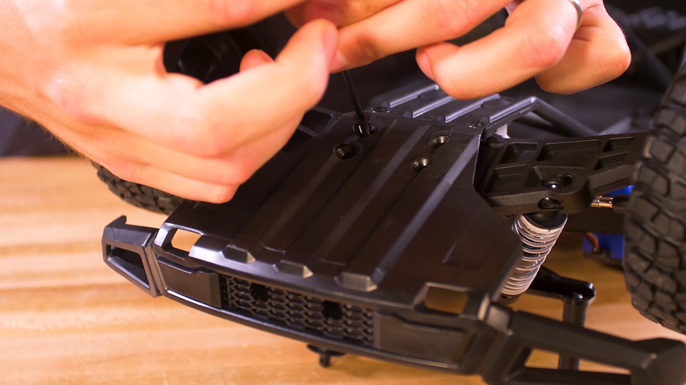

Step 1. Remove the Front Bumper & Body Mount
You’ll need 2 mm and 2.5 mm drivers for this step. Remove the four screws from the underside of the bumper, and the three screws that attach the upper bumper support to the chassis. Set the bumper aside so you can go back to short-course mode in the future. To remove the body mount, take out the 2 mm screws that pass through it into the shock tower. You can flex the shock tower for easier driver access, it’ll spring back into position.
Remove lower screwsRemove lower screws
Remove upper screwsRemove upper screws
Remove body mountsRemove body mounts

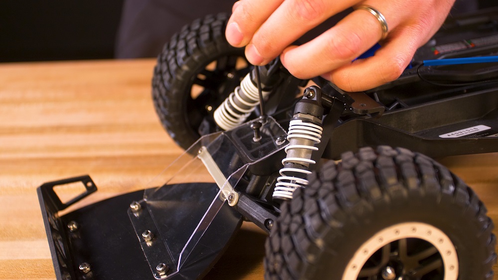

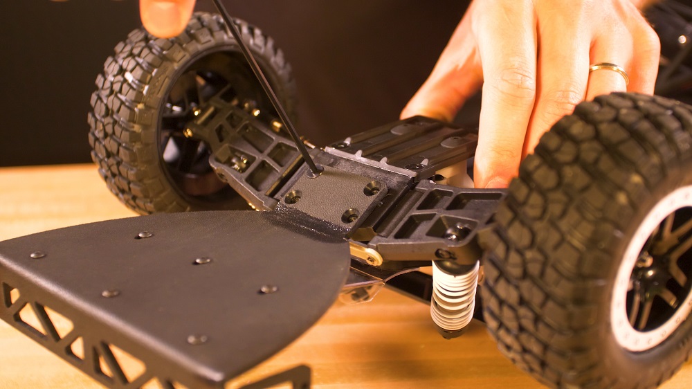

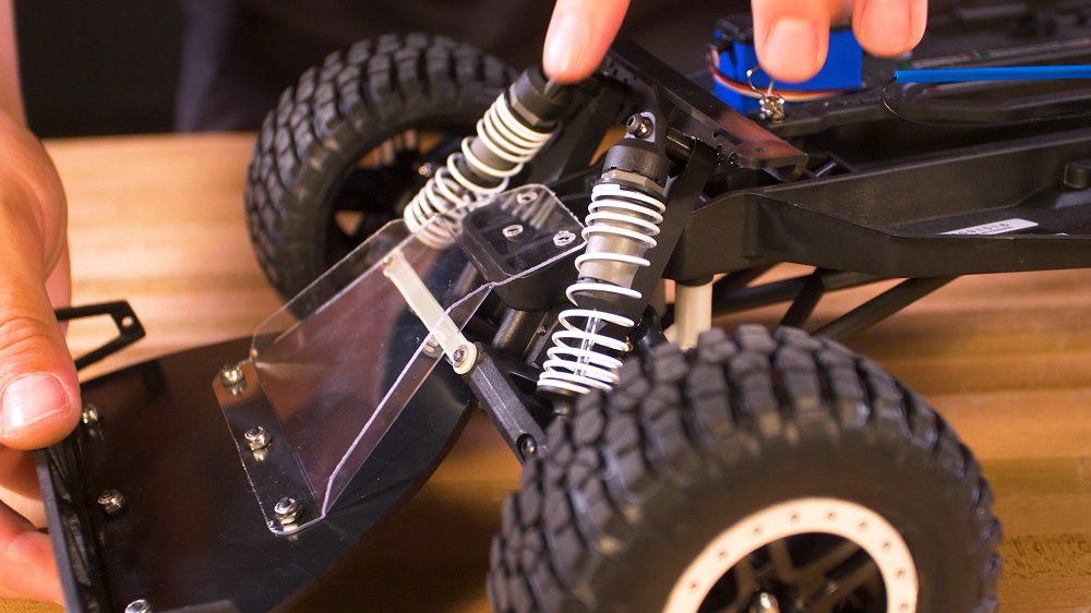

Step 2. Install the Avenger Front Bumper
The Avenger bumper installs with four screws under the chassis like the stock bumper The top support fastens to the bumper with nuts and screws and into the chassis using the body reamer to create holes for the stock locations. The screws only need to be tightened until snug, don’t overdo it.
Attach lower bumperAttach lower bumper
Attach bumper supportAttach bumper support
Mount support to chassisMount support to chassis

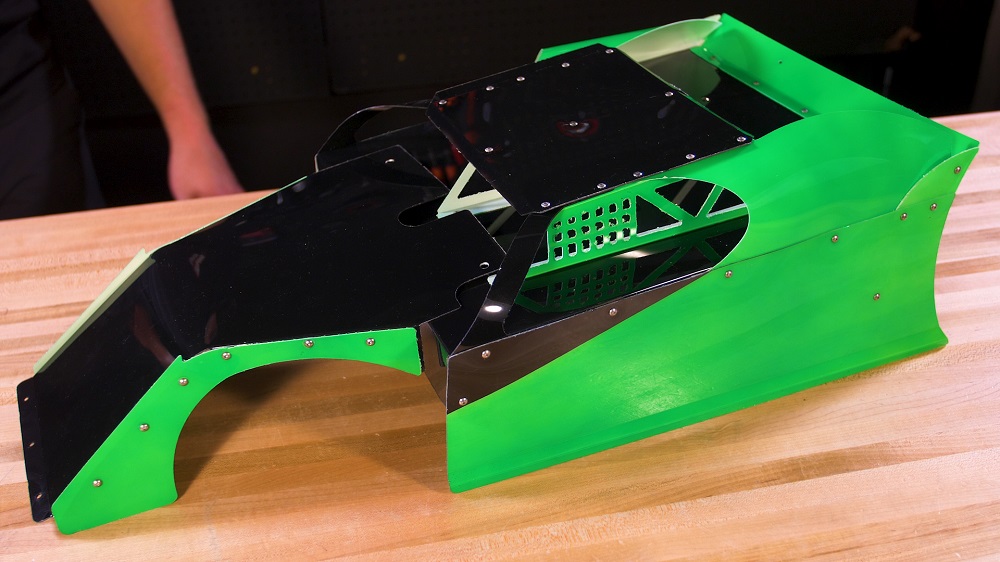

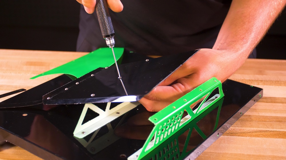

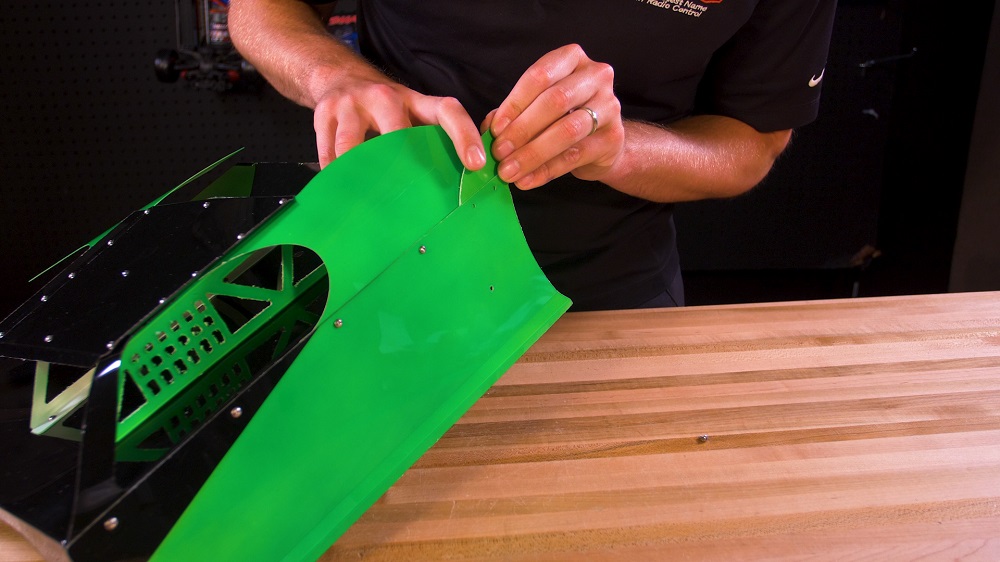

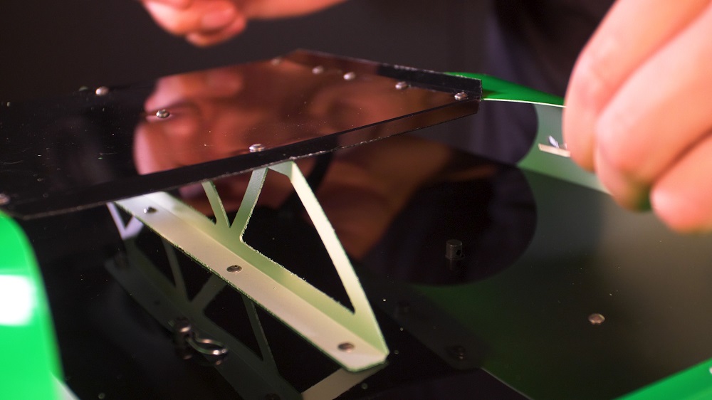

Step 3. Paint & Assemble the Body
The body is comprised of separate flat parts that must be assembled with screws and nuts (so many screws and nuts…), and instructions are not supplied—it’s a “look at the picture” type of thing. Assembly isn’t difficult, it just takes a some time and patience to paint and assemble. Paint the body panels before assembly, or to help you along, we’ve documented the assembly and paint process in this build video. Note that you’ll need a 1/16″ hex driver and �″ nut driver, as the body does not use metric hardware.
Assemble the body 1
Assemble the body 2
Assemble the body 3

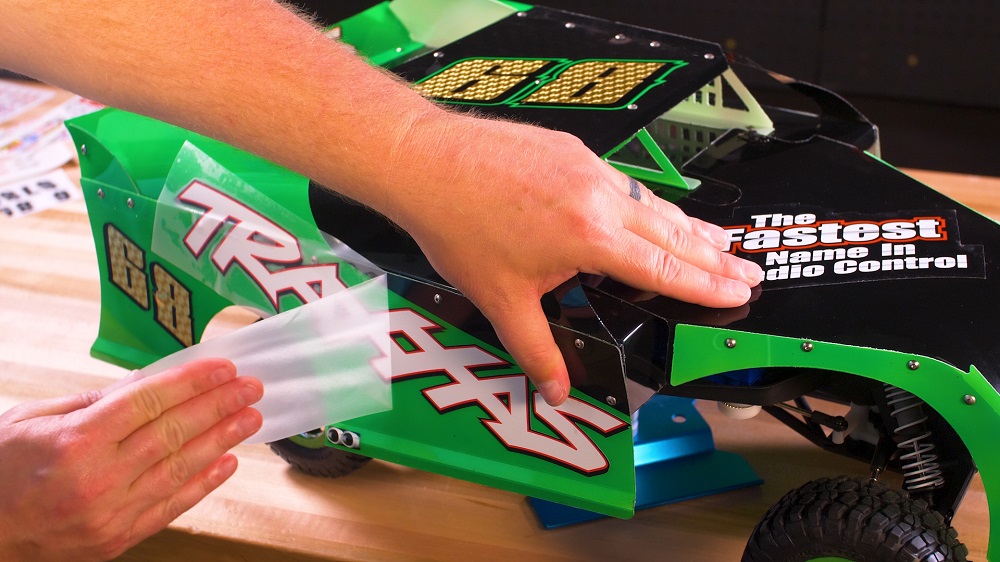

Step 4. Install the Body

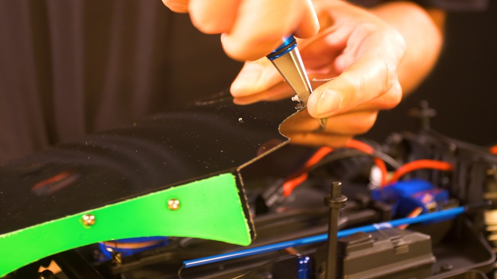

Position the body so the “nose” is up against the bumper and the body is centered properly from side to side, and adjust the body post heights so the body’s rocker panels are level. It will be a little high since it’s sitting on the tips of the posts, which is fine. To mark the post locations, shine a flashlight through the body from its underside and mark the post at the dark spot where it touches the body. Or, dap the tip of each post with grease and carefully lower the body onto the posts, then make your holes where the grease has made a dot on the body.
Ream front body holesReam front body holes
Ream rear body holesReam rear body holes
Apply decalsApply decals
