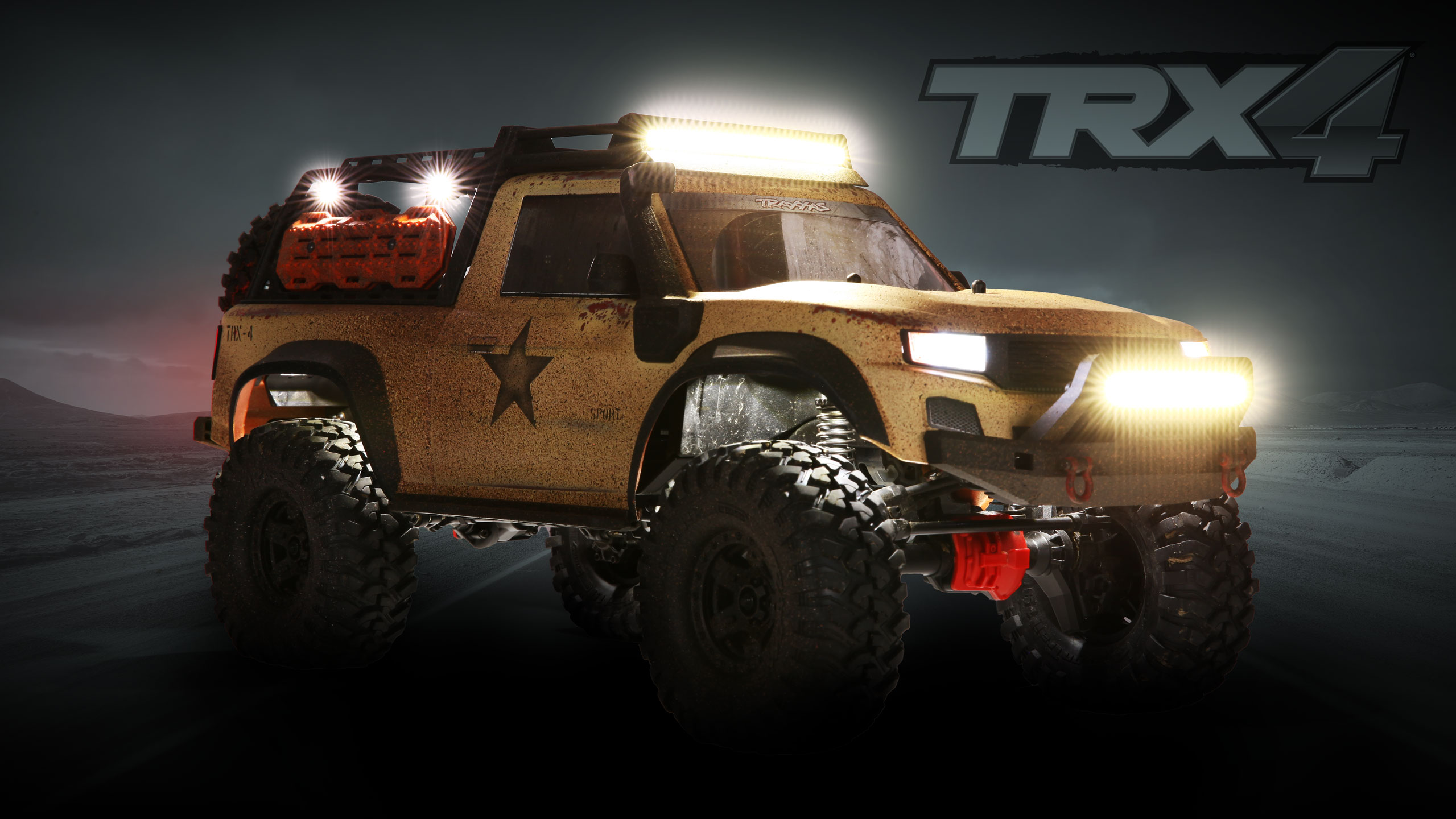

Zombies? Alien invasion? A planet where apes evolved from men? No matter what the reason society went to heck in a handbasket, it pays to have a reliable set of wheels when all the roads have grown over and you can’t get from A to B without encountering the undead / xenomorphs / talking gorillas. With just this mission in mind, our man Jeff (who also shot the photos for this piece) has equipped his personal TRX-4 Sport for surefooted wasteland-wheeling with plenty of LED candlepower to keep the baddies away after dark, and finished it off with a well-weathered patina paint job. Let’s take a closer look at Jeff’s “Apocalypse Edition” TRX-4 Sport.

The Sport’s flat finish is on the outside of the body. The rust color is a base coat, and the rust spots were masked off using salt before applying the desert tan final color. It’s an easy technique; moisten the area where you want rust to appear, then sprinkle with salt (it will stick to the water). Allow the salted spots to dry fully; paint your final color; then knock off the crusted salt. Presto—instant rust with a realistic, organic look.
TRX-4 apocalypse three-quarter
TRX-4 apocalypse rear three-quarter
The simulated dirt was created entirely with paint, and you can even feel it on the body. Jeff used Textured Black, Textured Dirt (a medium brown) and Textured Sand (light tan) paints to create the effect. For maximum realism, Jeff referenced photos of full-size muddied trucks to see how mud and spray actually coats them. Note the relatively clean areas behind the mirrors and snorkel, which block the spray. Jeff alternated dirt colors to vary the pattern and tone, and applied heavier sprays behind the tires and on the rock guards.

Finished truck
Bonus Upgrade: LED Lighting!

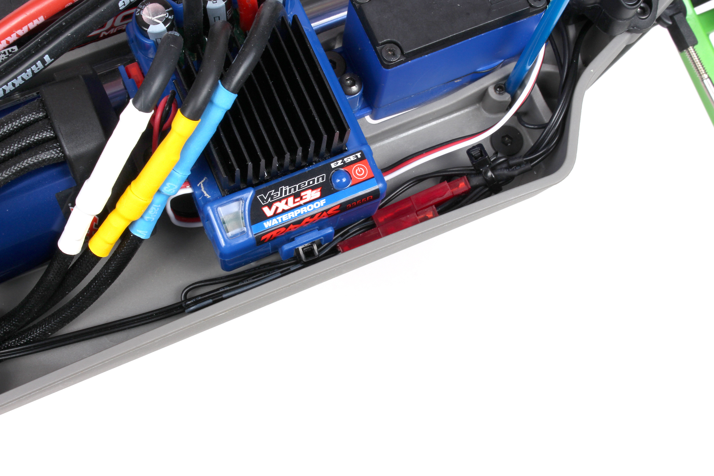

Jeff installed all the LED lights offered for the TRX-4 Sport: headlights and tail lights; roof and bumper light bars; rock lights in the fender wells; and scene lights on the Expedition Rack. The 8085 headlight and tail light set includes the required 8028 3-volt / 0.5 amp power supply, which the other light sets plug into. You can also get the power supply separately, if you’re installing any of the light kits but don’t have the headlight / tail light set in your model.
Light accessoriesJeff installed every light Traxxas offers for the TRX-4 Sport.
The 8028 LED power supply makes sure light output is bright and steady with any battery you choose, and makes hookup simple. The power supply is included with the 8085 TRX-4 Sport Light Kit, and also available separately.
Power tap
