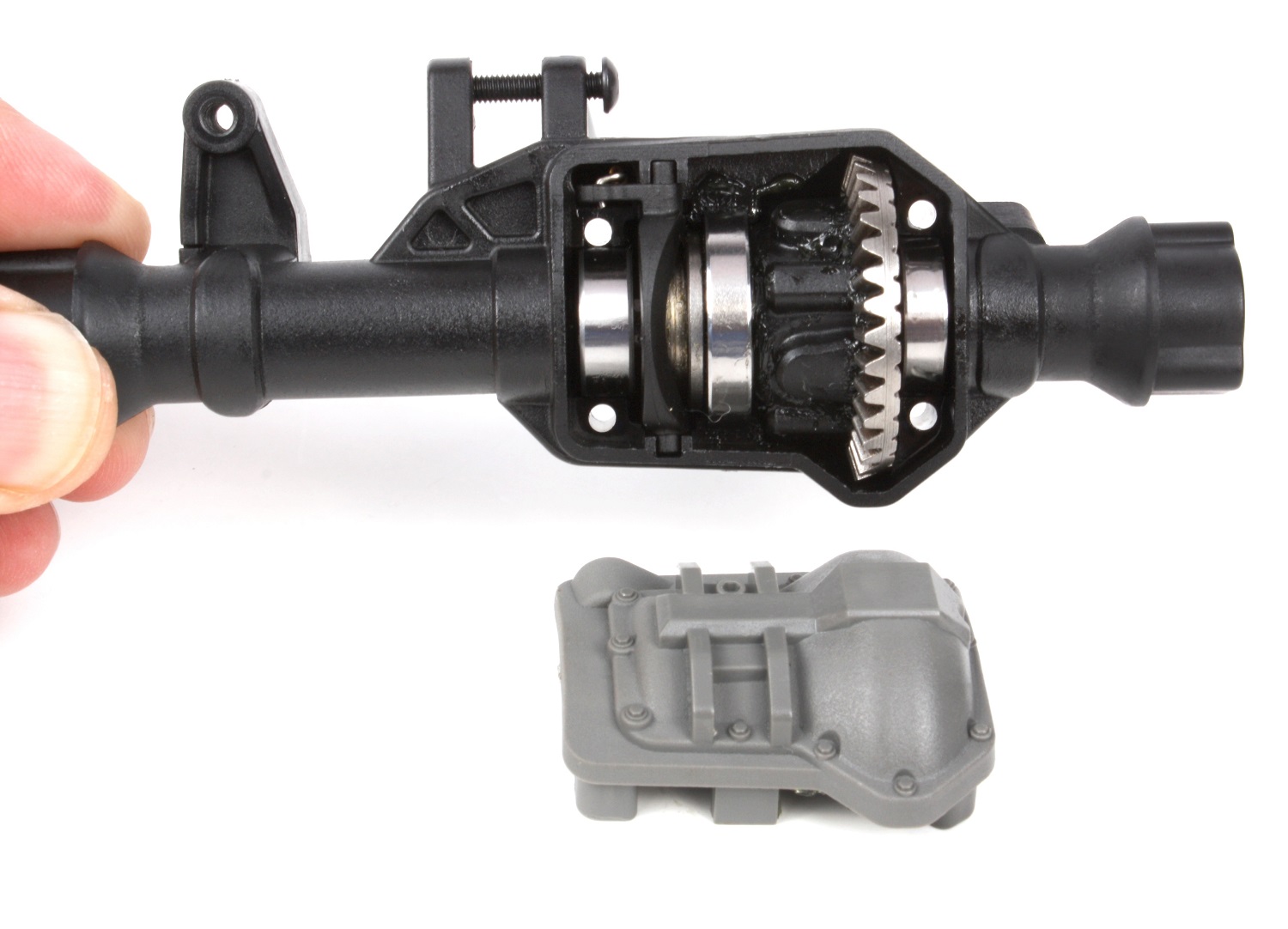

Stock Ratio

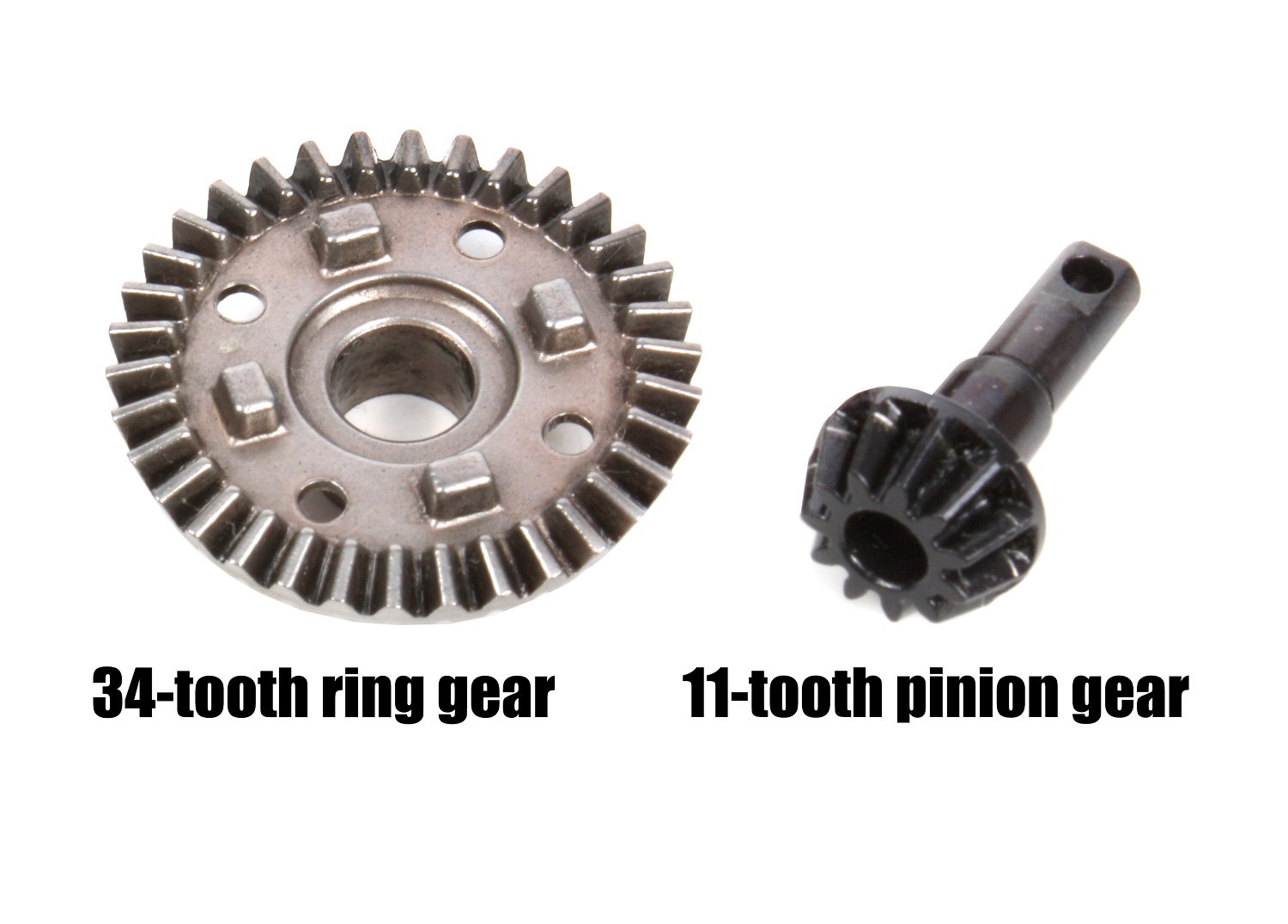

Each TRX-4 axle has an 11-tooth pinion and a 34-tooth ring gear for a 3.09:1 ratio. Here’s the breakdown on where that figure comes from, if you’re not familiar with the concept of a gear ratio: 34 divided by 11 is 3.09. For every 3.09 revolutions of the pinion, the ring gear makes one complete revolution. The ratio between the pinion and ring gear is “3.09 to one,” or 3.09:1.

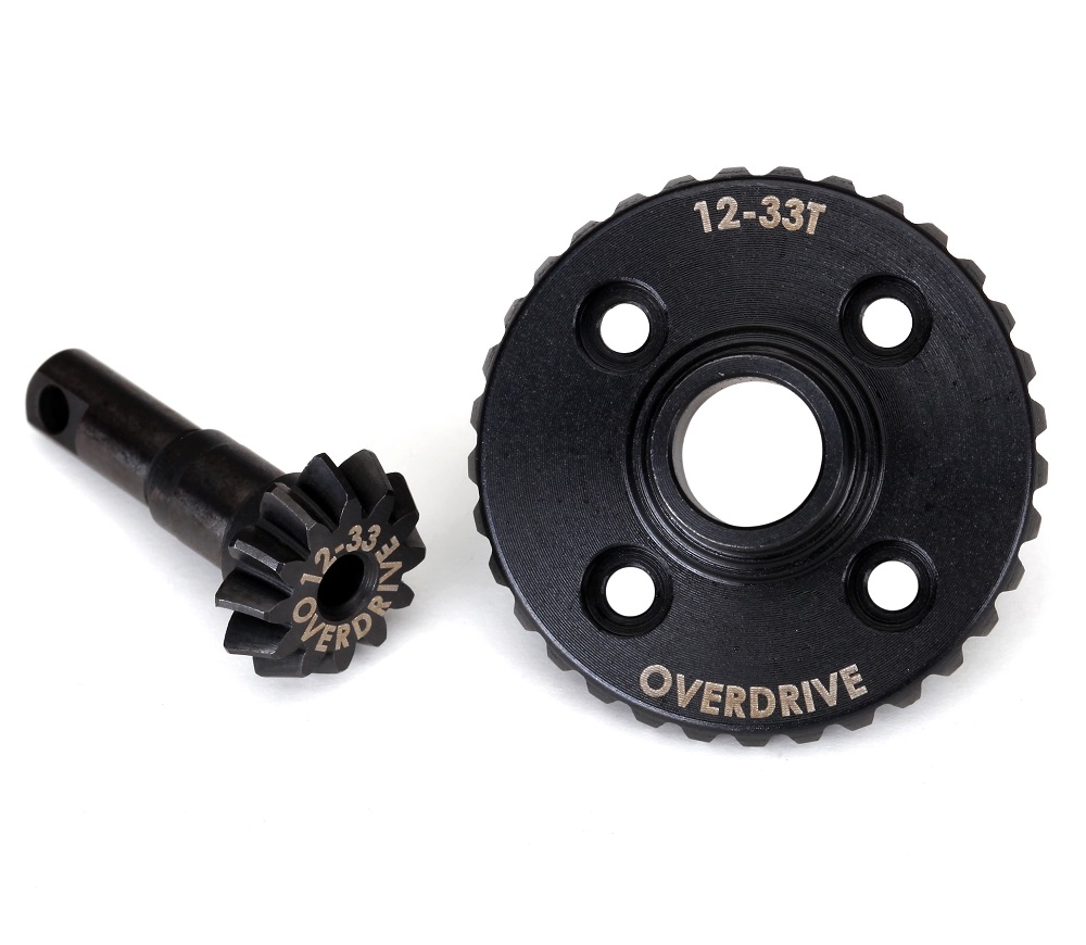

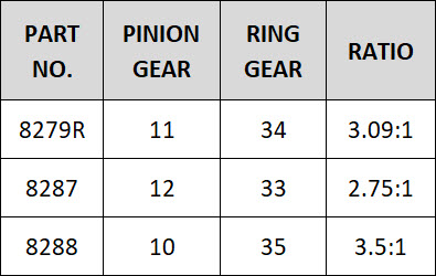

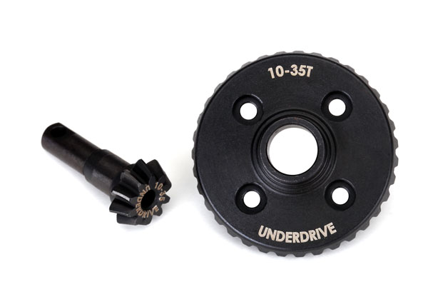

In order to overdrive the front axle, we can install gears with a numerically-lower ratio in the front axle, or a numerically-higher ratio in the rear axle. Traxxas offers optional differential ring and pinon gears just for this purpose. Not only do they allow us to change the gear ratio, but they're machined from high-quality steel for extra strength and durability.
gear chart
Note that 8279R duplicates the TRX-4’s stock axle ratio. But since overdriving the front axle places extra strain on the drivetrain, the machined-steel construction of 8279R is recommended.

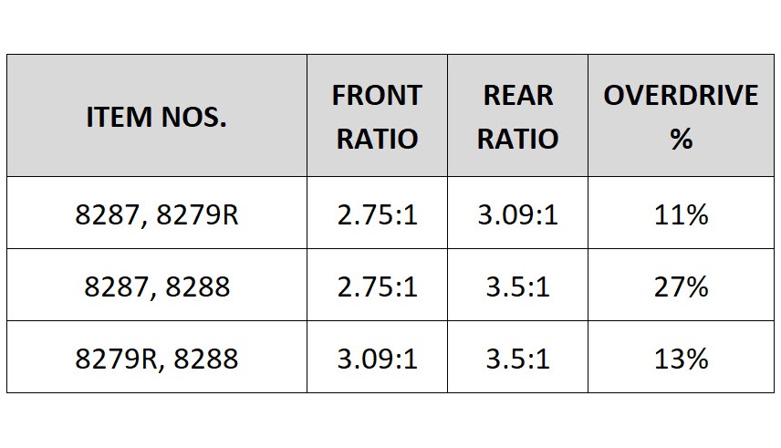

Depending on how you gear each axle, you can achieve 11%, 13%, or 27% overdrive. That percentage reflects the greater speed of the front axle; for example, if you set up your TRX-4 for 13% overdrive, and your rear axle is spinning the tires at 100rpm, the front axle will spin its tires at 113rpm. This chart shows the gear combinations required to achieve each overdrive setup:
Overdrive chartOverdrive chart
