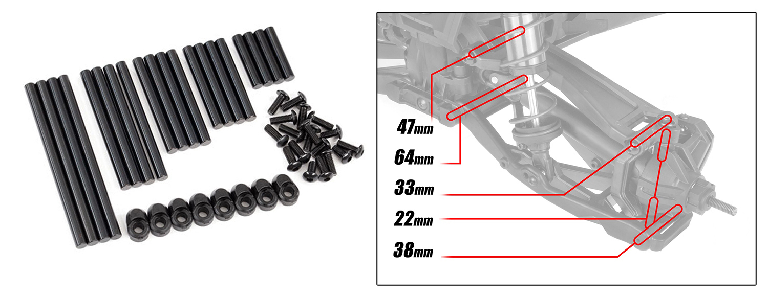

    • 8940X Hardened steel suspension pin set
Our first modification is strictly for style. Black suspension arms are standard for the Maxx, and we’re swapping them for identical pieces in green. You can also get them in red, blue, and orange if that’s your preference. No matter which color you choose, the arms are molded in Traxxas’ proprietary high-strength, cold-resistant composite—tough stuff. To make the suspension even tougher, we’re replacing the stock screw-in pins with the 8940X hardened steel pins. In addition to incredible strength and increased precision, the pins feature a low-friction finish for ultra-smooth suspension action.
Suspension arm orientation
The Maxx’s suspension arms can be installed as lefts, rights, fronts, or rears depending on how you position them. This photo shows the correct orientation for each upper and lower arm, and the five available colors.
hardened steel pin set
While swapping arms, we’ll install the 8940X hardened steel pin for maximum strength and smooth suspension action.

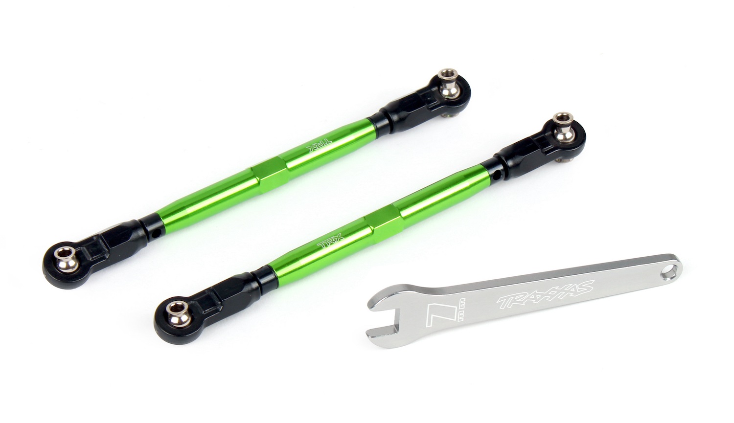

Green TUBES toe links
TUBES use threaded steel ends with large-diameter aluminum bodies. The included 7 mm wrench makes quick adjustments without marring the finish.

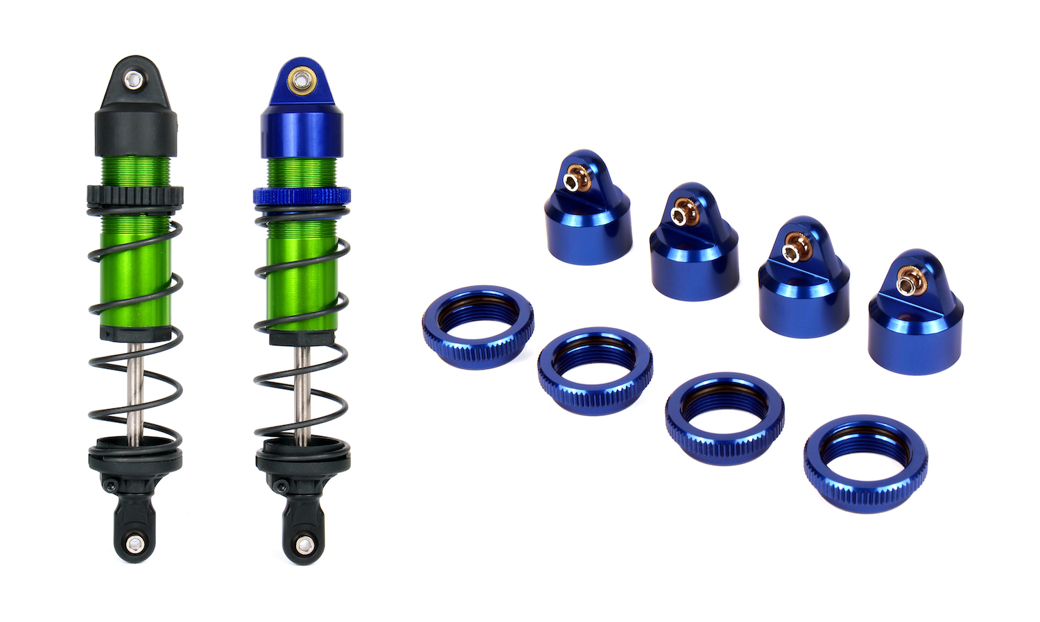

Aluminum shock caps
The blue-anodized shock caps and spring retainers look fantastic on the green shock bodies.

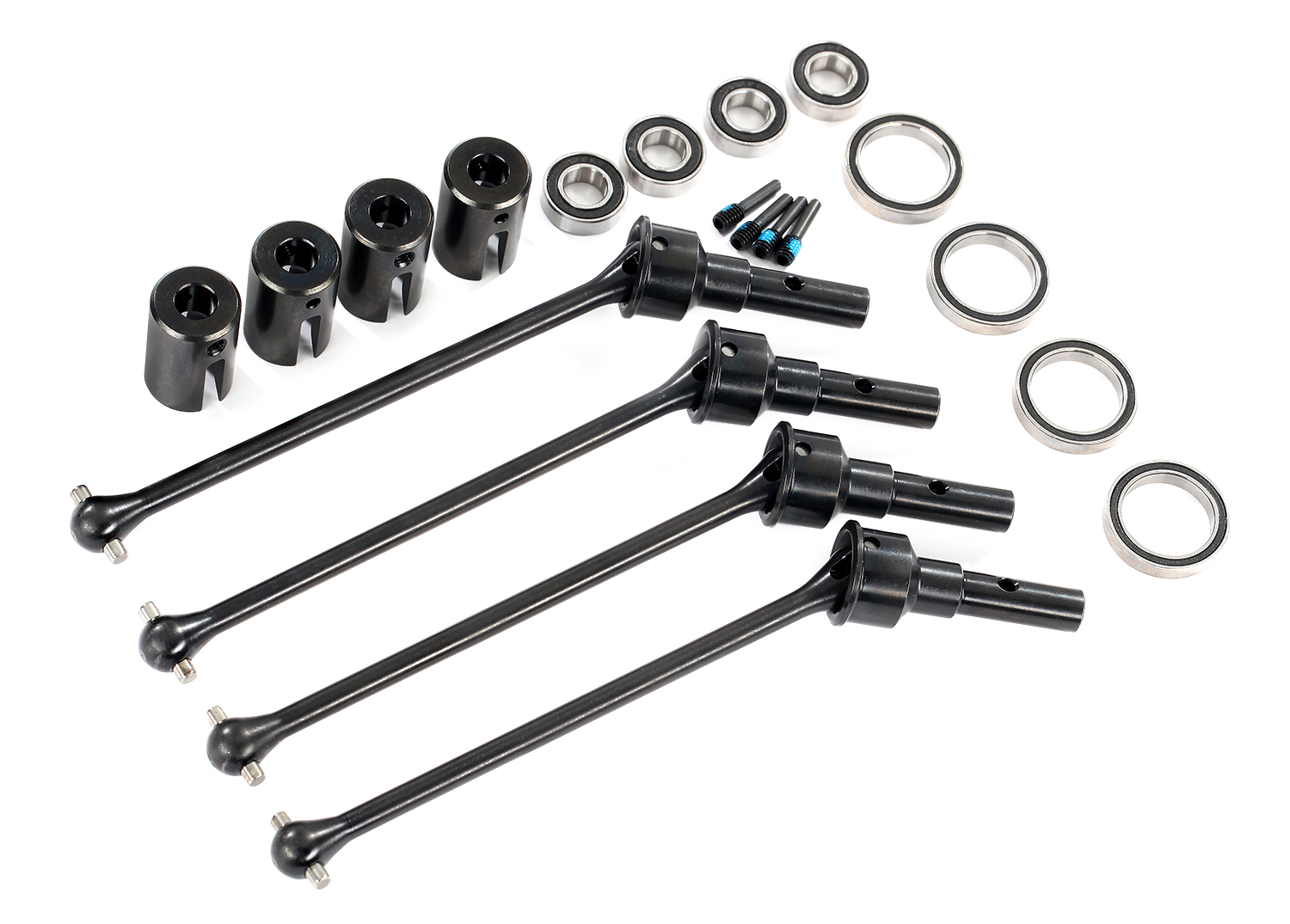

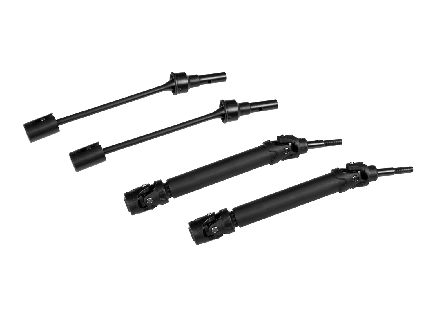

We're trading out the Maxx’s factory telescoping driveshafts for the optional steel CV-style shafts, which are even stronger than the composite shafts and transfer power more efficiently under load. The CV axles are designed for use with the optional aluminum 17 mm hubs and nuts, which you can get in orange, blue, red, green, and black. For a complete installation how-to, click here.
Driveshaft comparison
Steel CV driveshafts are much slimmer, yet stronger than standard driveshafts.
The CV shaft set includes all-new sealed bearings and screw pins.

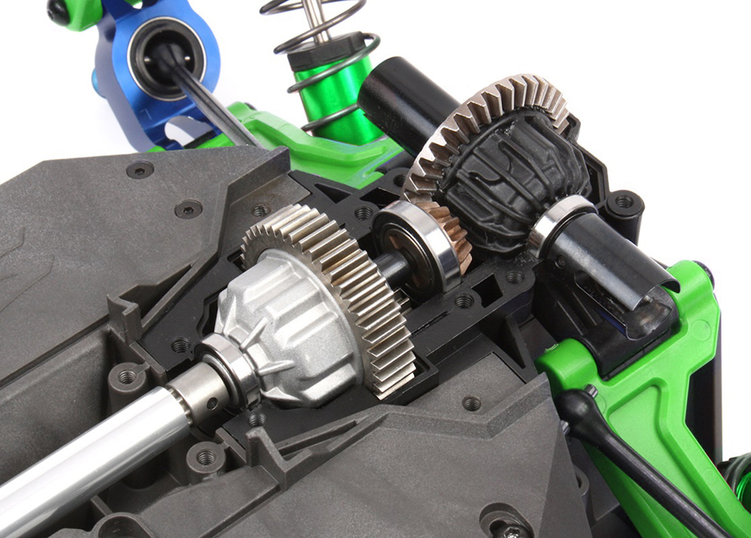

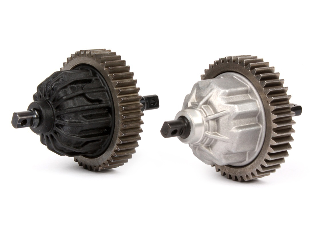

We’re replacing the stock Torque Biasing Center Drive with the 8980 metal center differential. This upgraded unit comes fully assembled with the same heavyweight oil as the stock one, but you can always tune its performance with a lighter weight oil. The differential’s rugged alloy housing sheds heat and resists flex for lasting performance and durability.
Differential comparison
Stock composite case (left) and optional alloy. The alloy case sheds heat and resists flex.
Differential installation
The differential installs from underneath the chassis. Access is easy, and making the swap only takes a few minutes.

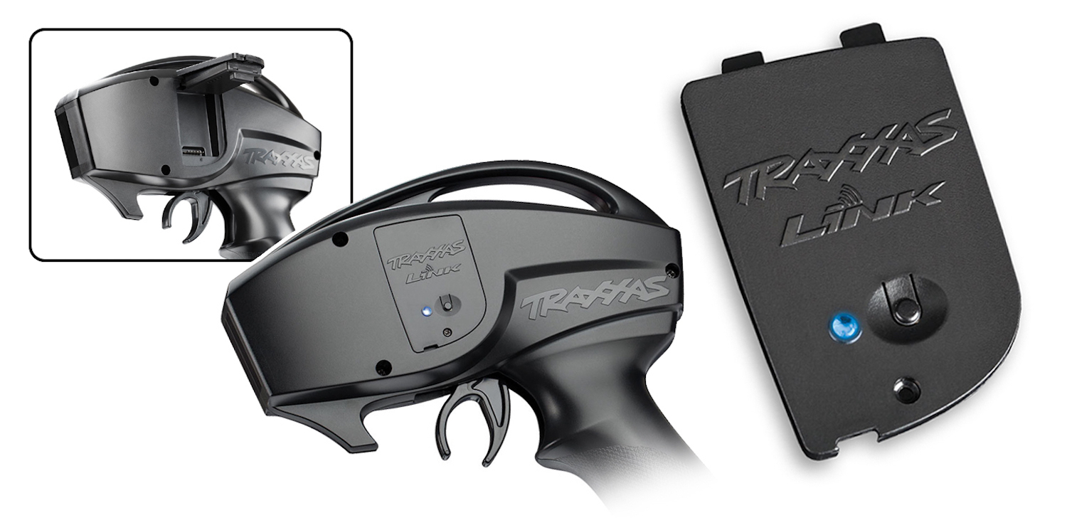

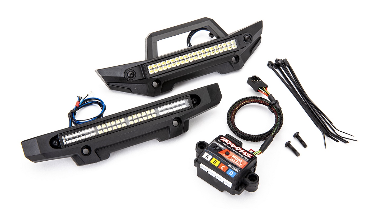

Now we’ll give our Maxx a dramatically different look and a blazing set of LED lights for after-dark action. The High-Intensity LED Light Kit features a power amplifier that plugs directly into the speed control for steady light output regardless of battery voltage, with no draw on the receiver. We’re adding the Traxxas Link Wireless Module to our TQi transmitter to control the light set remotely via the free Traxxas Link app. The Wireless Module allows us to add the Telemetry Expander and GPS speed sensor to our Maxx for the most accurate speed reading. Traxxas Link also enables remote adjustment of all the TQi’s settings and real-time telemetry data viewing and recording including speed, voltage, and temperature. To learn more about what you can do with Traxxas Link and the TQi transmitter, check out How to Become a TQi Power User.
The high-output LEDs are integrated into the bumpers for unobstructed illumination, and everything you need to install the lighting system is included.
Install the rear body mount
The Traxxas Link module plugs into the back of the TQi transmitter and enables your iOS or Android device to communicate with the transmitter and model via Bluetooth.

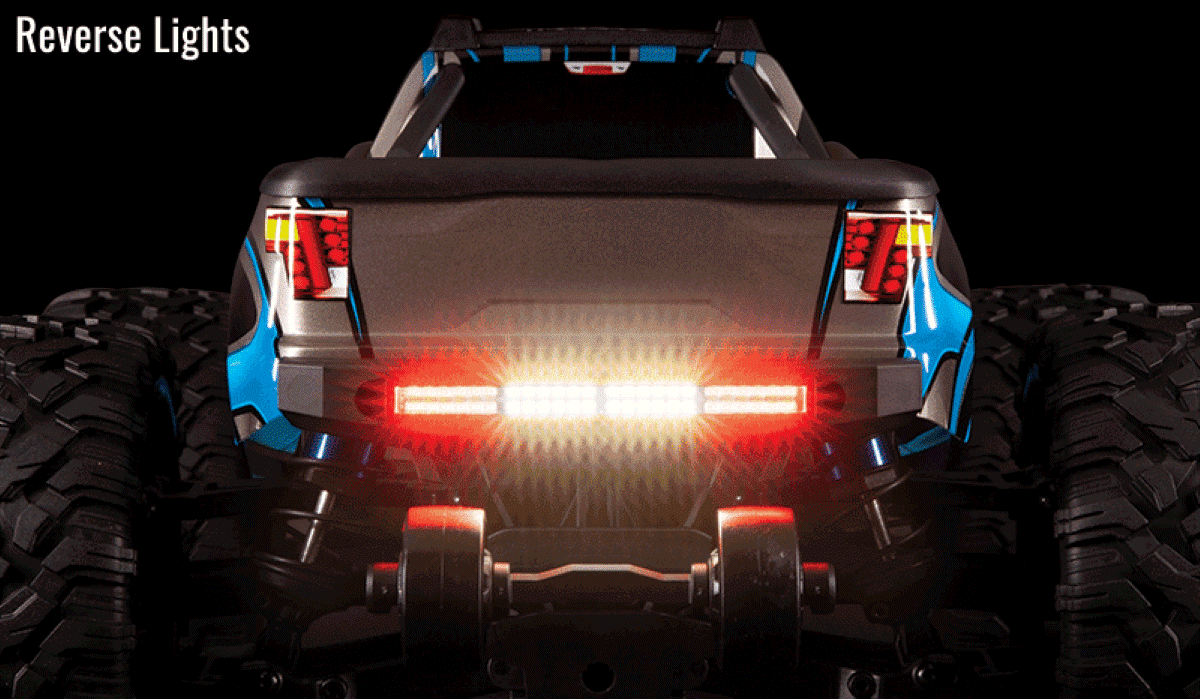

LED functionalityThe rear LEDs respond automatically to trigger inputs with full brake- and reverse-light functionality.

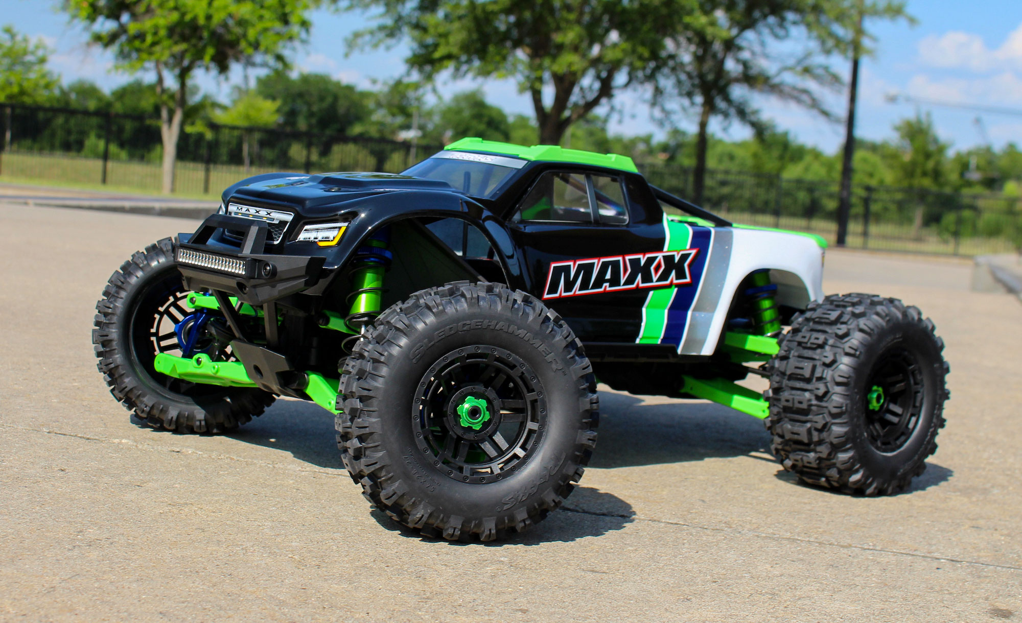

Now for the finishing touch: a fresh body
We’re fans of all the Maxx color options, but we decided to turn things up to eleven with a custom paint job on the optional Maxx clear body. For even more color, we swapped the black roof skid and tailgate protector for green versions.
Clear Maxx body
Prefer to paint your own? Get the 8918 clear body.
Green body accessories
We made our Maxx even louder with a green roof skid and tailgate protector.
Finished Maxx
Finished Maxx
Finished Maxx
Here’s our finished full-option Maxx, ready to rock and roll—complete with custom graphics.
