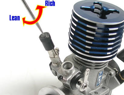

If your factory preset carburetor adjustments have been tampered with, use the
following settings:
1) Set the high-speed needle to 4 turns out from closed.
2) Set the low-speed needle so the screw head (red in Fig. A) is flush (even)
with the end of the slide (yellow in Fig. A).
