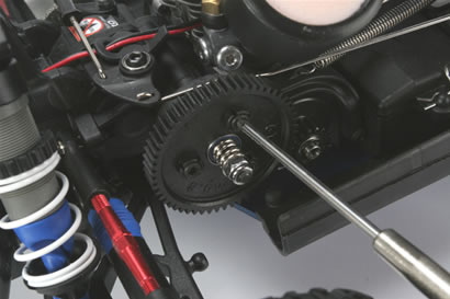

For electric vehicles such as the Rustler, Stampede, or Bandit, spur gear replacement is quite easy. Simply remove the gear cover on the transmission and replace the spur gear by removing the three 3mm CS screws that hold the spur gear onto the slipper hub.

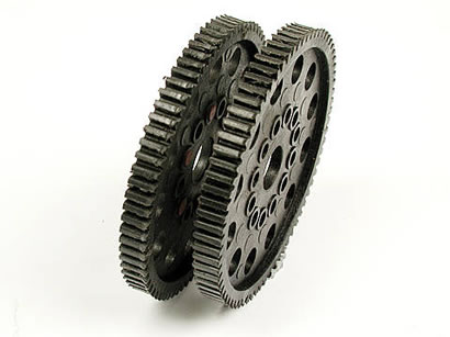

The two spur gears shown here, show signs of excesive wear and should be replaced before running the model.
